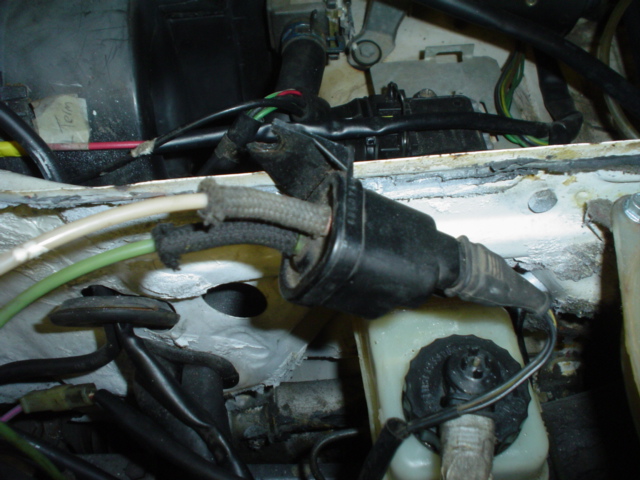

I've got the 1.05L HZ with Pierburg 1B3 Carb & Automatic Choke. If I pump the gas a few times and start the car, the engine will run and then stall. The more pumps I give before ignition, the longer it will run. The fewer, the shorter. If I don't pump the gas at all before turning the key, the car won't fire at all.
The auto choke and cutoff solenoid both have power when the key is on.
The two way valve (idle speed boost control) has a plug going into it, but no power at either pin. Should it? It is pictured here:
Any advice? Thanks in advance!
