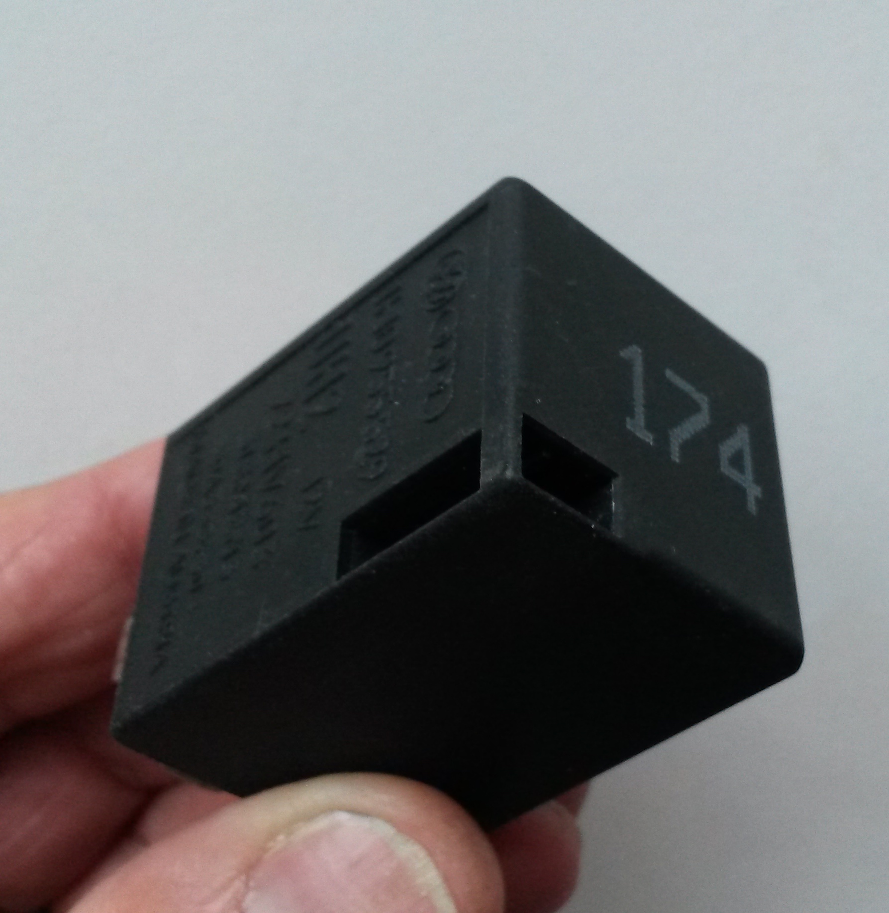

The relay in question that controls the rear wiper and in fact it also has an effect on the front wiper too is numbered 174 . From the main agents, NLA, but when it was it was in excess of £50 !
It is unusual in that it has a a "tail"..... a black wire which plugs in to the back of the relay , i.e. the opposite end from where it plugs into the relay board. The 4 terminals are numbered 53 ( which I think is live ) 31 and 15 and just a letter "L " against the last tag which seems to work the front wipers to my surprise.
The two numbered 31 and 15 are the wires that go to the rear wiper I THINK, but am unable to get to the back of the relay board without serious disruption to the underneath dashboard area of my car which I'm reluctant to do.

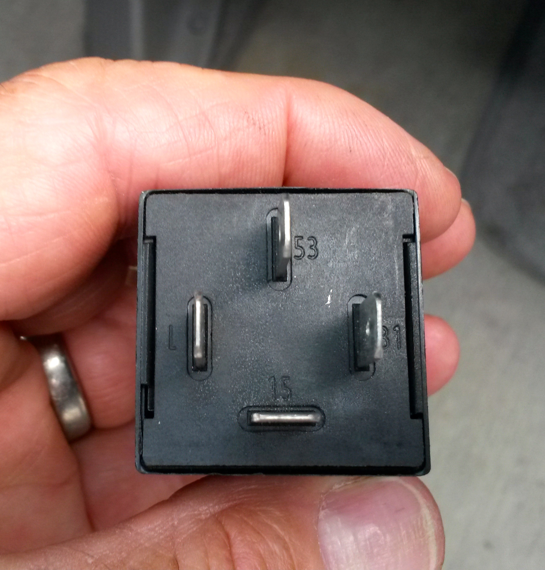

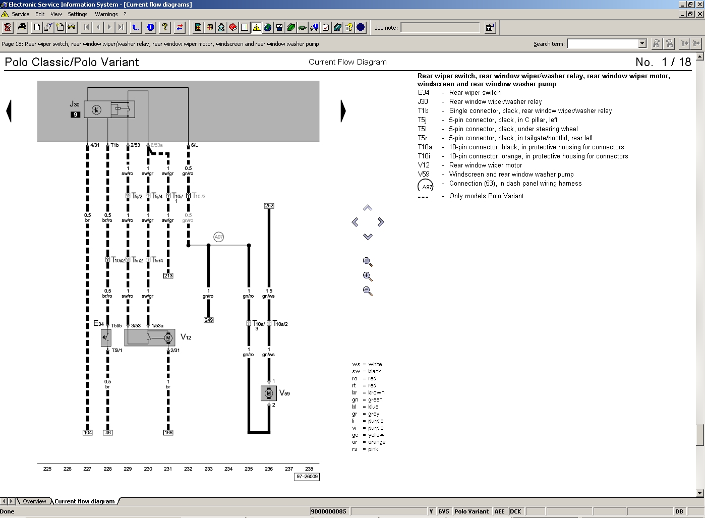

What you need is a wiring diagram and understanding of DIN terminal numbering.
I can't help with the former for now, but try this
http://www.vintagebus.com/wiring/defs.html or https://www.autoelectricsupplies.co.uk/ ... nal_coding
15 is live
31 is an earth route
53 is live to the motor

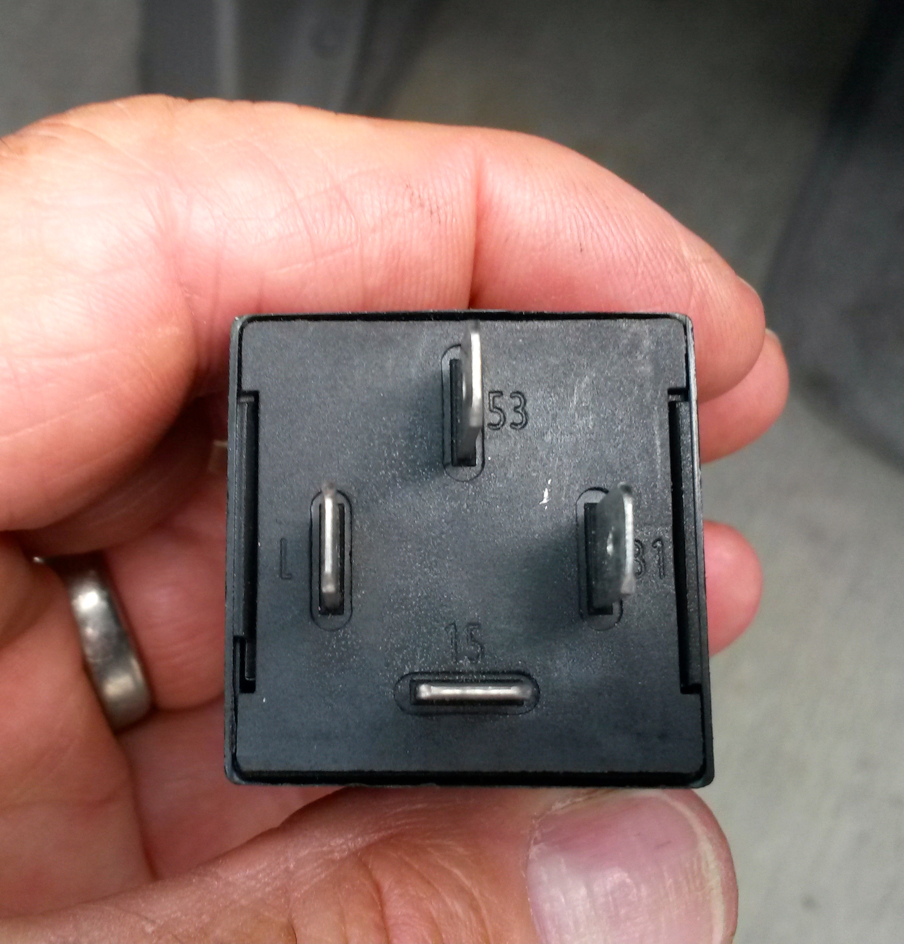

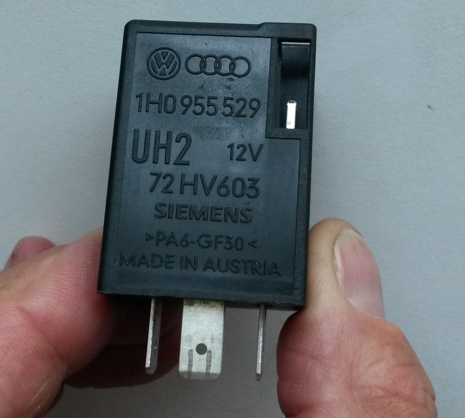

Are you sure you have the correct relay and in the correct location - not someone else's mistake ?
Can you post a photo of the relay, with either terminal numbers or better if there is a wiring diagram on the side

Post by 937carrera »

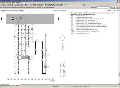

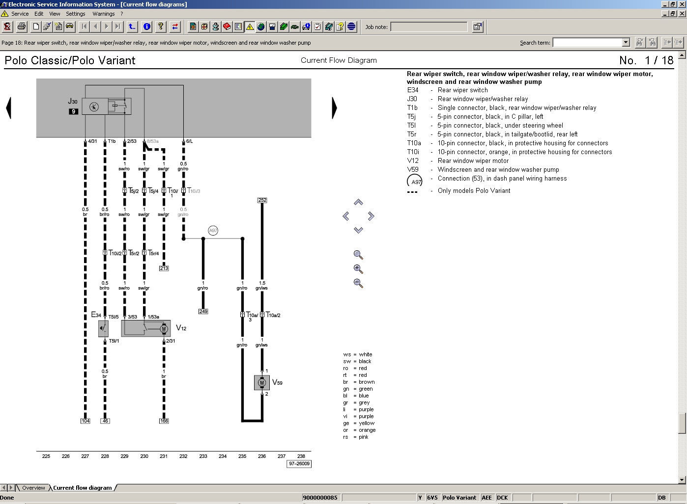

Maybe this helps - I haven't come across the Polo Variant before

Wow, thank you so much for all that information, and especially that wiring diagram as it certainly matches with the wire colours on the rear wiper motor.
Also the description of the relay and the terminals.
I cannot be sure but suspect this is the correct relay as the small wire that comes from the back of the relay box is obviously meant to be there....there is a special plug that fits into back of it and of course is removable to allow the relay to be replaced. My only fear is that the relay I purchased from eBay may in fact have the same problem that is on the car now.....hence why it was "available".
Not quite sure how to post pictures on this web site , but certainly will try a bit later. Sadly there is no wiring diagram on the side of the relay , altho' I know what you mean as some do have a small schematic printed on to them.
Will see what I can do with attaching pictures of the relay.......

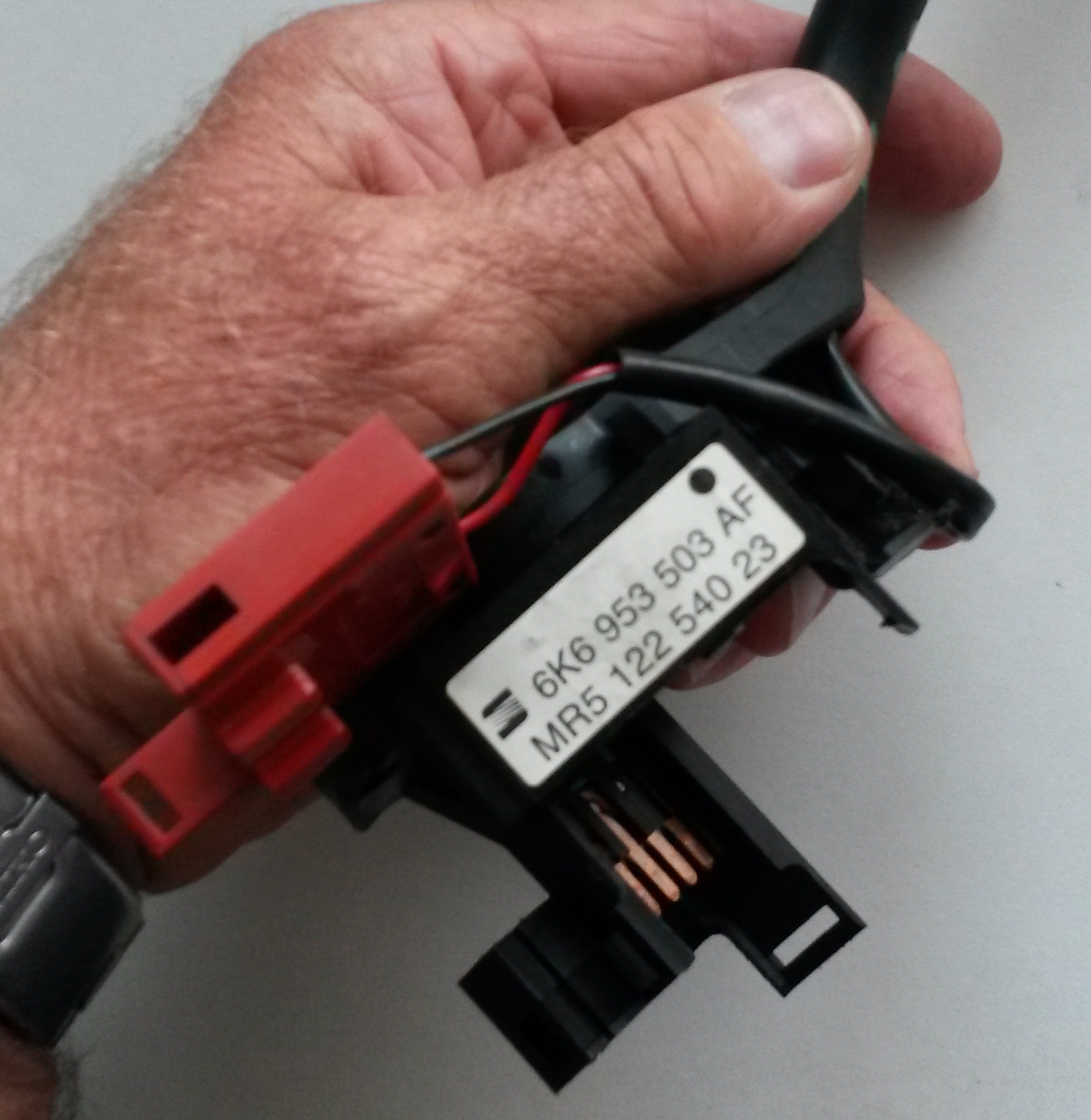

Hoping these will come out.

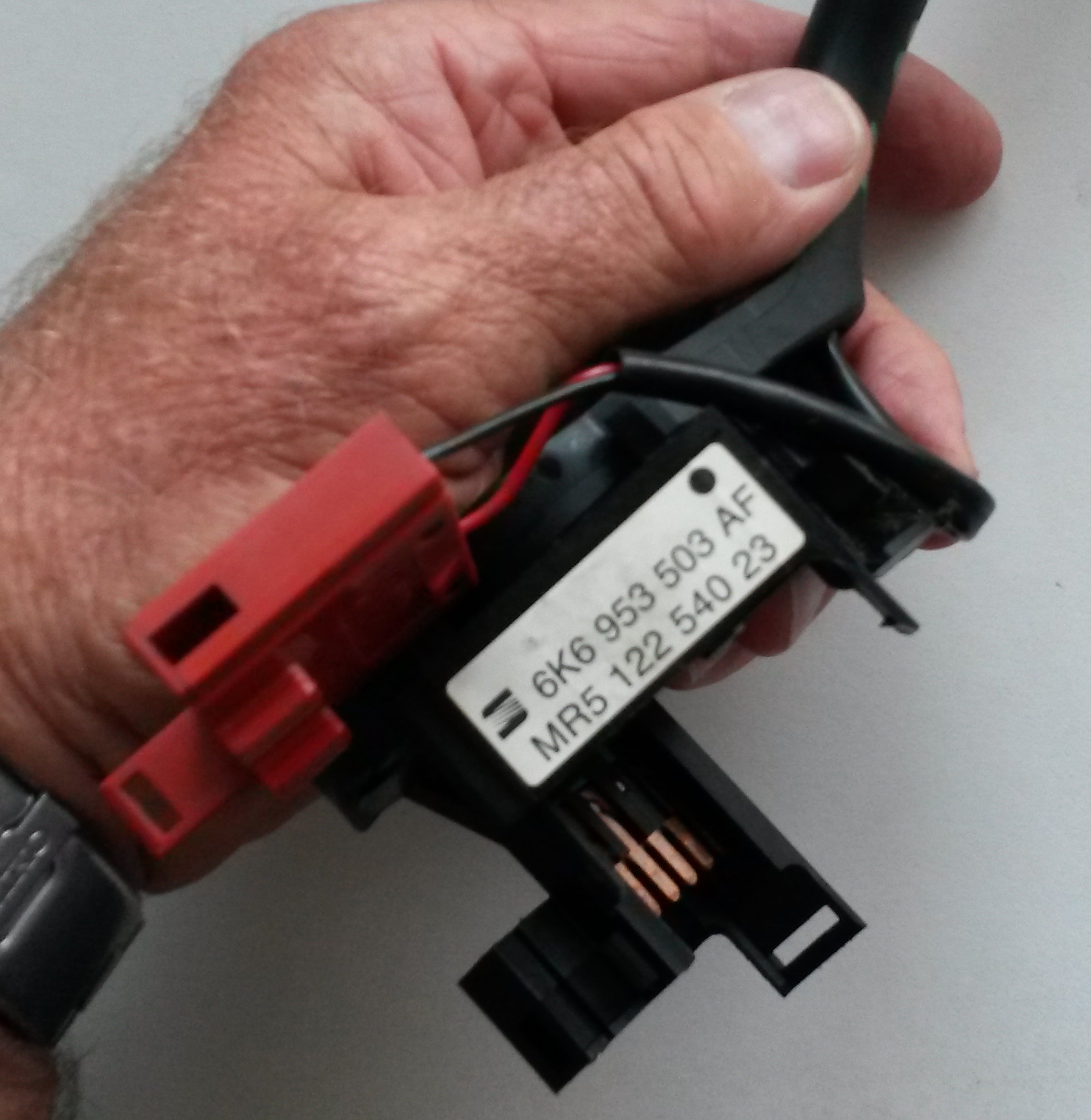

Ah seems to have worked, the first picture is of a second hand wiper switch showing the red connector that takes the signal from the button on the end of the switch to the relay. That is working correctly on the car so I don't think the problem lies with the wiper arm switch.

Looking at the wiring diagram, i'm thinking of connecting a test light to the output wire ( Black and red ) at the wiper motor end to see if I get a fluctuating pulse there , I'm presuming it has to be a fluctuation to give the intermittent wipe feature whilst the other wire ( black and grey )returns the wiper back to the parked position......I don't remember seeing the wiper working continuously or am I mistaken ?

I'm glad that helps - does this make sense to you ?
The relay should be in the centre of the bottom row of the relay block
So the wire from the switch goes to the connector T1b - correct ?, that provides low current 12v to the relay
Terminal 31 / position 4 on the relay provides an earth for the low current side
Terminal L / position 6 on the relay provides power for the rear window washer pump
Terminals 53 /position 2 on the relay provides the high current connections for the motor
Terminal 15 provides high current connection to the relay
If so you can test the relay with a 12v source and a multimeter.
First of all check the resistance on the relay coil by testing between the connector and pin 31
+ve to the connector at the top
pin 31 to -ve should engage the relay
With the relay engaged you should have continuity between pins 15 and 53, maybe you will need to wait a few seconds if it is an intermittent function
The relay shows a transistor within the scematic. This is probably a small IC which provides the intermittent wipe functionality

On my polo my front wipers completely failed to work on all speeds. Only rear wiper and washers both front and back would work. Turned out the contacts in the wiper stalk were all worn out and shorting across each other. May not be the same in your case though with just the rear not working. Slough I guess if this was happening to you your fuses would be blown.

Appreciate the suggestion, but having bought a second hand unit and connected the stalk up to the bit that triggers the relay, it still fails to work so I "think" that eliminates the wiper stalk on the column.
Worth a thought.
Have tried testing the relay, but unable to produce any reactions, so sadly the reality is I need to take the car to an auto-electrician who understands electrics which is certainly not what I do.

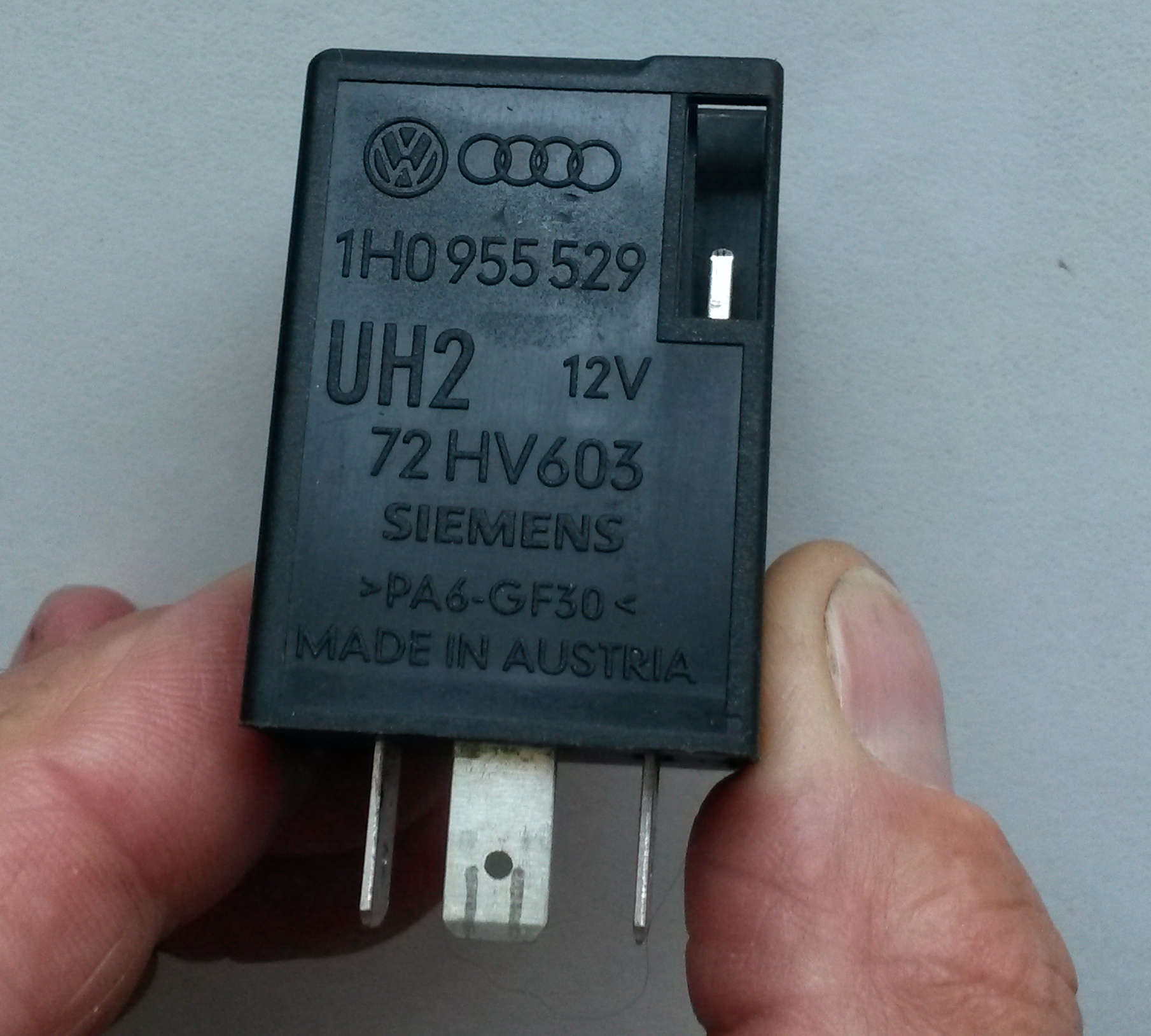

If the relay isn't engaging and closing the high current side that's your problem. New relay and all should be good, remember these are used on the T4 as well as other vehicles.
Try here https://www.stevensvwspares.com/vw-vari ... number-174 or ebay for a used one as new ones seem to be difficult /expensive to get.

Anyone need a couple of 174 relays ?
tried two now thinking that the second hand one I bought from fleabay might also be suspect. No such luck and the new relay clicks away like the other two so definitely not the relay. Convinced now its a break in the wire between the relay and the rear motor which I know works if connected directly to a battery.
