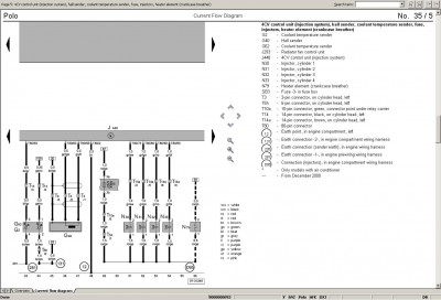

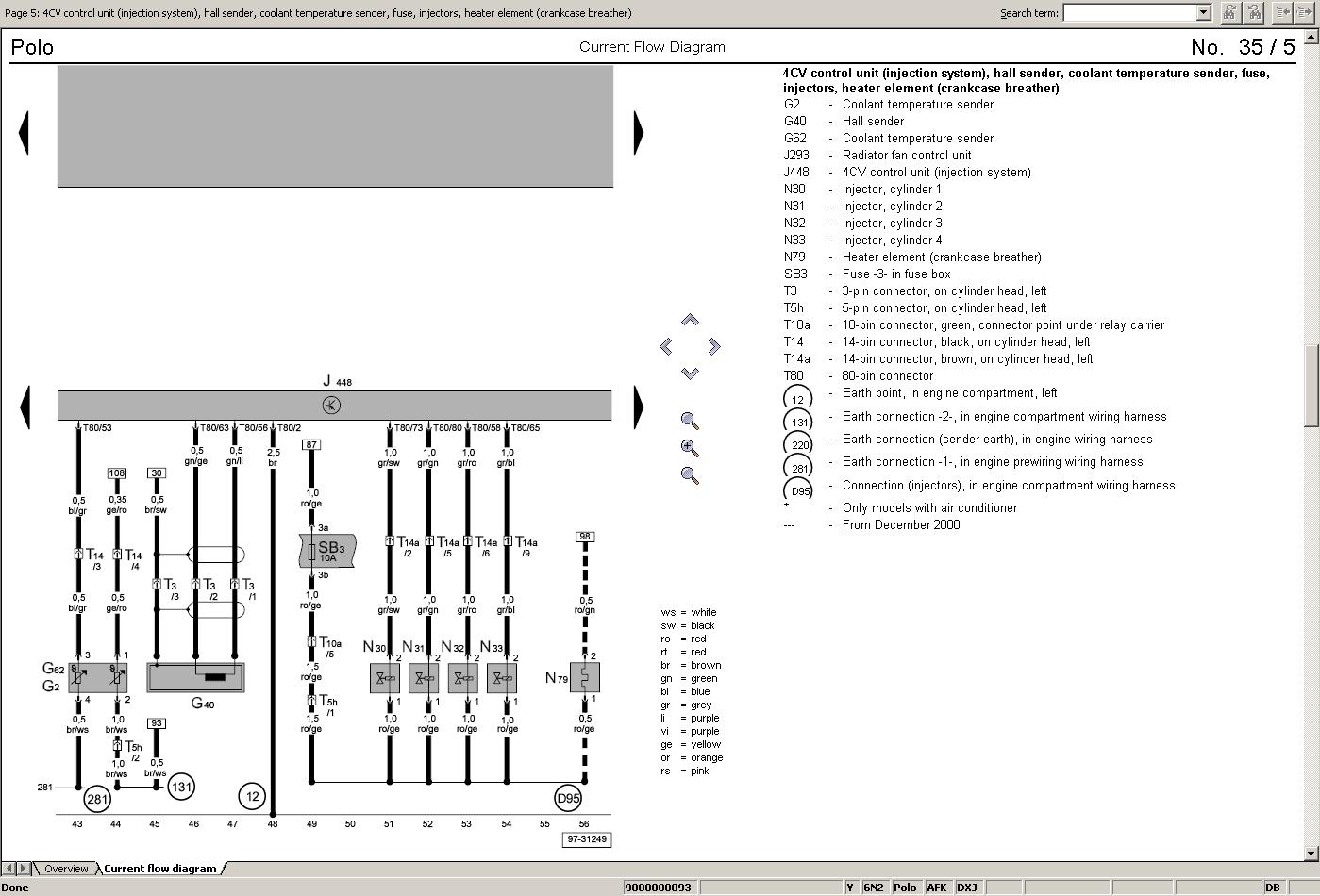

Re: 6N2 misfire.... end of life help!
Well, there are two approaches:
Continuity - resistance for each connection (fuse to injector, injector to ECU) should be no more than 1.5 ohms.
The other way is to actually measure the voltage being delivered to the injector. The approved procedure talks about using an LED test lamp and measuring with the engine cranking so will probably need an assistant. Using a meter I would expect to see something like 11v as there will be voltage drop due to the starter operating.
An alternate way is to have the engine running, then pull each connector off in turn and measuring the voltage, engine running. Terminals 1 to a good earth.
From the above checks you can deduce that the duty cycle pulse for the injectors is provided by the switching of the earth route within the ECU.
Once those checks are done, I would also inspect the two block connectors between the fuse and the injectors. Measure first, inspect, re-measure & run. If you fix it you want to know why !
There's a few diagnostic tips for you to do now, I assume the error codes will return shortly so could you please get those read and posted. If you don't have access to a reader then you can get a generic one for £10-£15 off ebay or if you have a laptop you can buy a lead and download VCDS-Lite
