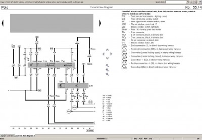

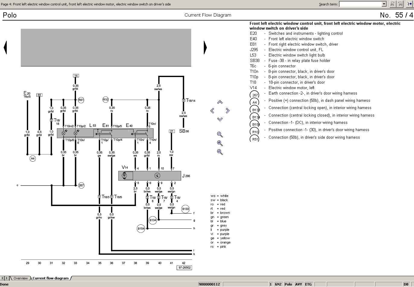

Here's a wiring diagram in case you don't have one.
By all means swap the motors around to test, but I have two thoughts for you:
1. The motor is where the current draw is showing. It's possible this is just current tracking through poor insulation or a build up of dirt on the outside, maybe carbon on the inside ???
2. However that "short" can only occur if power is being provided. With ignition off there should be no feed to the window switches. Is it possible the tracking is further back in the circuit, at the fusebox / fuses for example
Not much I know, but maybe it will help in your though process

Re: Parasitic Drain - Windows
I pulled out the same diagram after the last posting and studied it along with the next page for tracks 43 to 56. Not sure if the ignition needs to be on for supply though it’s probably coming from a relay given the 2.5mm wire. The window motors would draw a bit when working. On the ground side the window control units go to two V69s (the key doesn't say what they are, will investigate further), and J393 which is the ‘Convenience system control module’. The connector I’ve been pulling off the window control unit J295 is probably the T18 which would stop current flow through the unit to the V69s and J393 (same thing if the bellows is disconnected). My theory now is that the fault is in one of these and that it’s pulling 18mA through each window control unit.
I’ve had a quick look for the J393 before. It's supposed to be above the drivers footwell. Couldn’t see it but will have a good look tomorrow and leave the passenger door alone for now.

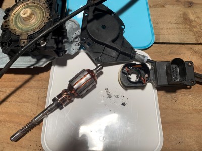

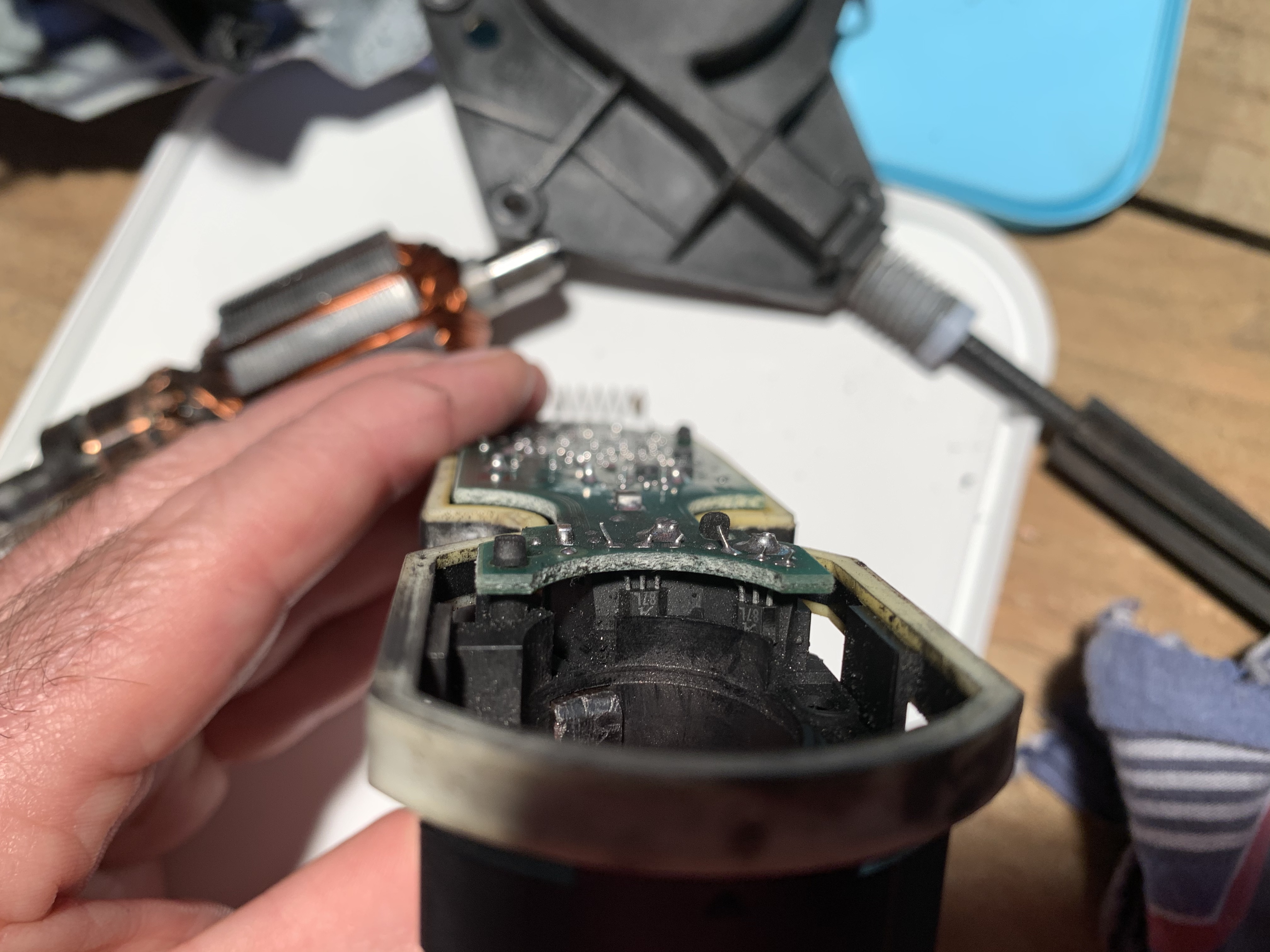

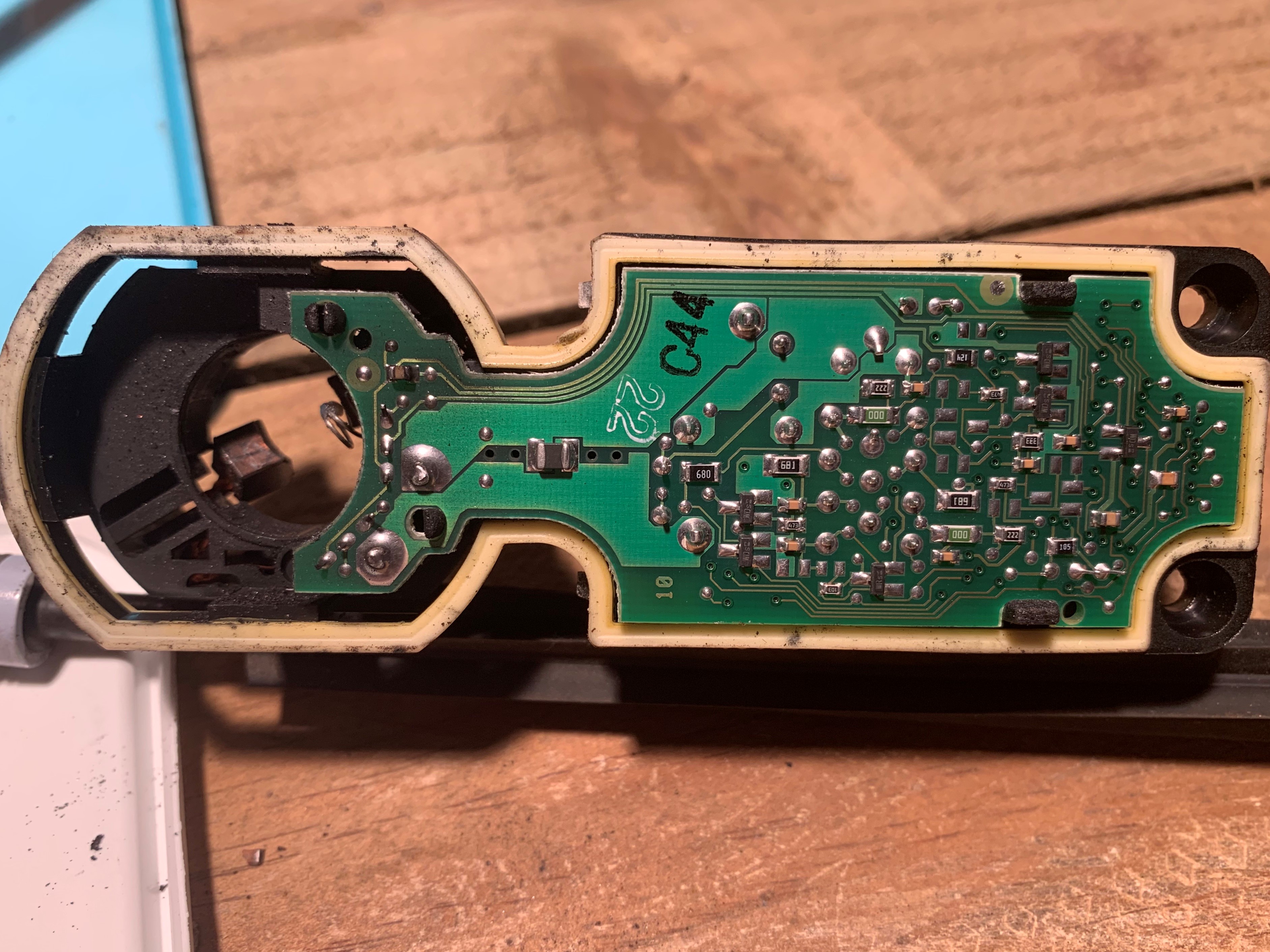

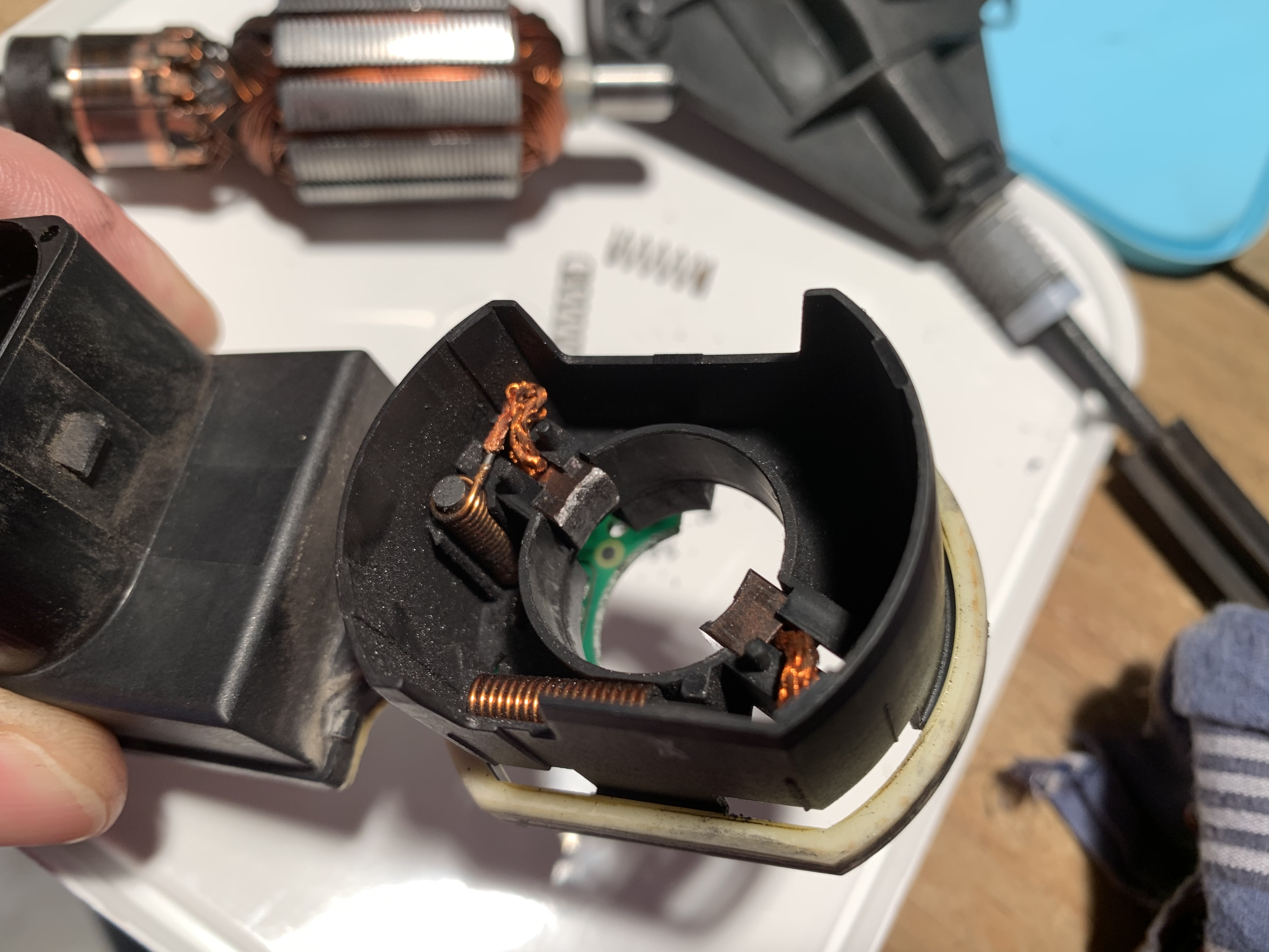

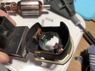

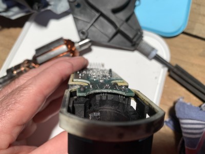

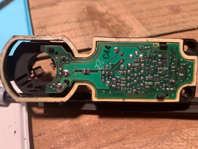

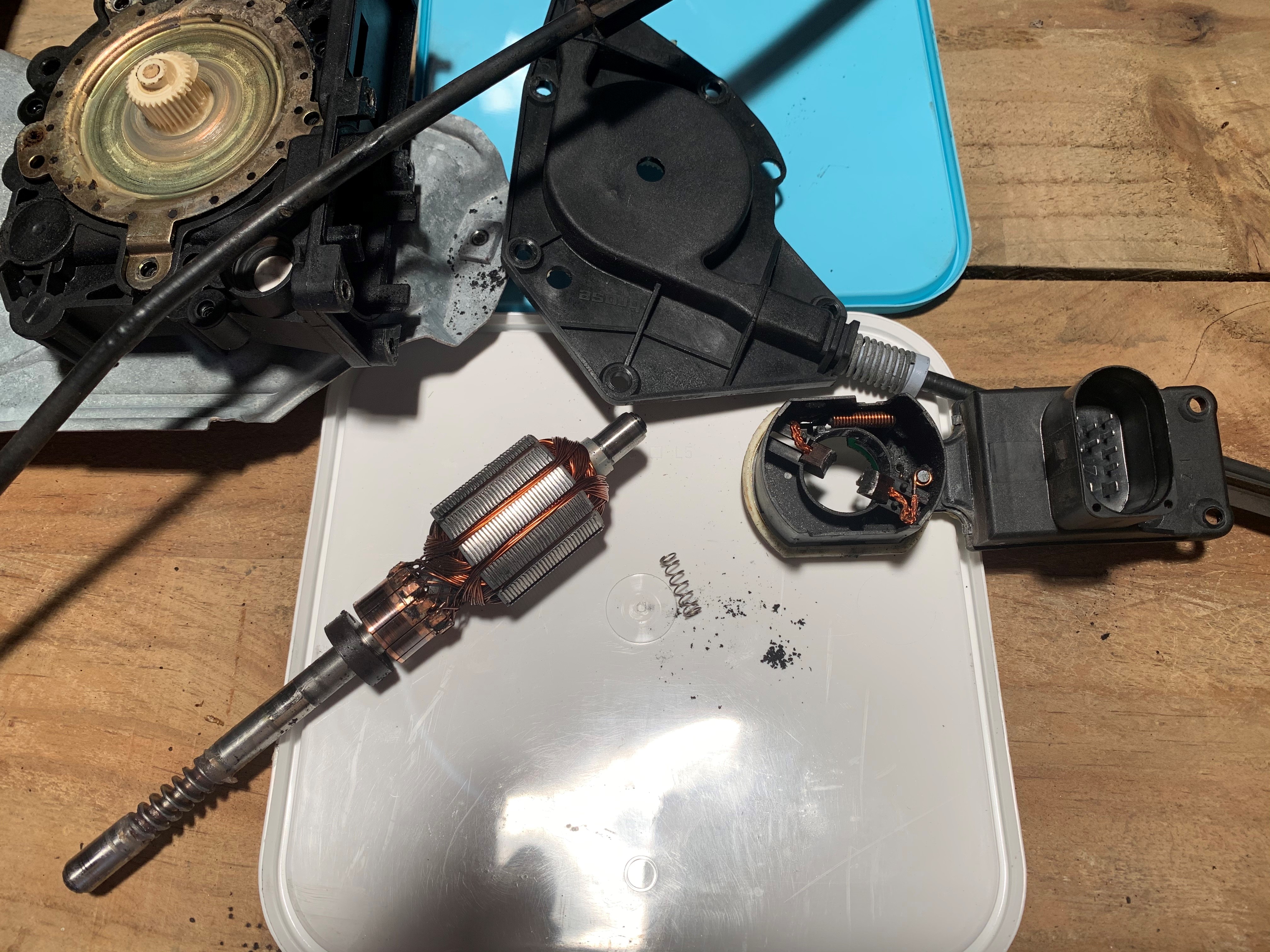

Hey man. Sorry about the hiatus. Life's been getting in the way. I couldn't get at the loom to window motor connector in the driver's door so I removed the whole regulator assembly. Then I pulled the window motor apart. It's the standard fixed magnet, brushed rotor, worm drive arrangement but with a fairly complex circuit board integrated into the case. I think this confirms what Christian6N said. You can only see the bottom of the board and would have to desolder 6-pins to lift it off and see the components on the other side. Photos attached. This is beyond my ken so I decided to stop at that point and put everything back together. Given that there's an even 18mA per side I suspect the draw is by design, but who knows. It's small enough to live with as long as the car gets a regular drive. I appreciate your interest and help with this. Thanks. On with the next project. Cheers.

Thanks for posting back, and glad you have got to a conclusion on this.
Come back again next time you have a problem
