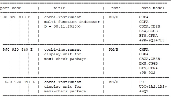

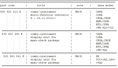

Alternatively I have found a 5J0 920 840 E IC which is produced the same year as my car.
I attach images from my current cluster,
the 5J0 920 841E I have now
and this 5J0 920 840 E I am thinking to get.

The info I can find for the ICs are
Also my IC 810E has 24C32 eeprom
and 841E has 24C64 eeprom
Does this matter in a way that 841E is not compatible to my car?
I understand that I have to go to locksmith. I don't have the experience to move on myself.
I am asking cause I try to understand/collect all the info I can.
spacewalker
Posts: 85
Joined: Sat Jul 15, 2017 11:39 am
Drives: Just a VW
Location: PL
Re: Retrofit Maxidot instrument cluster on Skoda Fabia 5J 2010 model
Post by spacewalker »
exantas wrote: Mon Sep 23, 2019 10:24 pm The info I can find for the ICs are
no, no matter
immo type is compatibile.... no matter if 24C32 or C64 ...both are ok

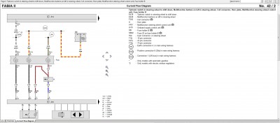

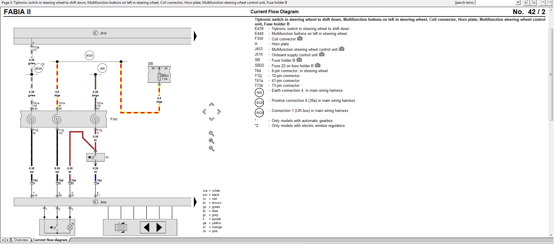

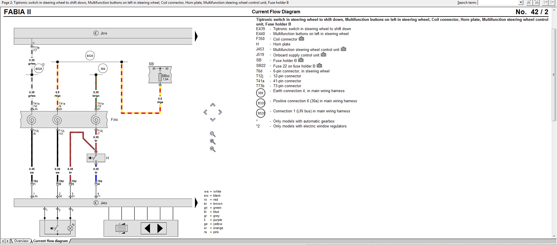

I don't have installed a MFD cluster yet in my car (I will update the thread when I have some progress), but my mind is already on the next change for the car.
I want to install cruise control on my model 2011 Fabia 5J 1.2 TSI, and I am collecting the parts that I think I will need.
My car came with trip computer stalk 6Q0 953 503 DQ
but the only reasonably priced new OEM kit that I could find was one that is including 6Q0 953 513 AL
Instead of finding a stalk with cruise control and trip buttons, I am thinking to install a MFSW from an 2010-11 Octavia or Superb that has the trips function buttons on the steering
But I am also thinking, is it possible to fit a steering wheel from a later model fabia 5J instead ?
More specifically, will the existing slip ring (6Q0 959 653 B) work with the new type of steering wheel?
I try to find the connector type and the pin out for the newer type of steering wheels but elsawin I have access to, has no data for cars after 2013.
Does anybody with more up to date elsa win can pull the diagram for me ?
Here is the diagram for my car
Thanks in advance

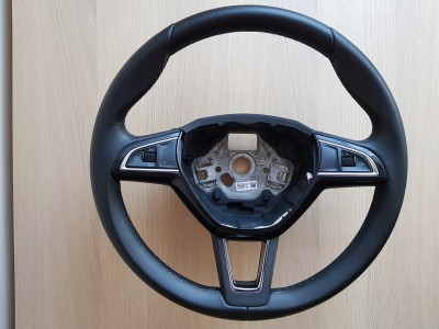

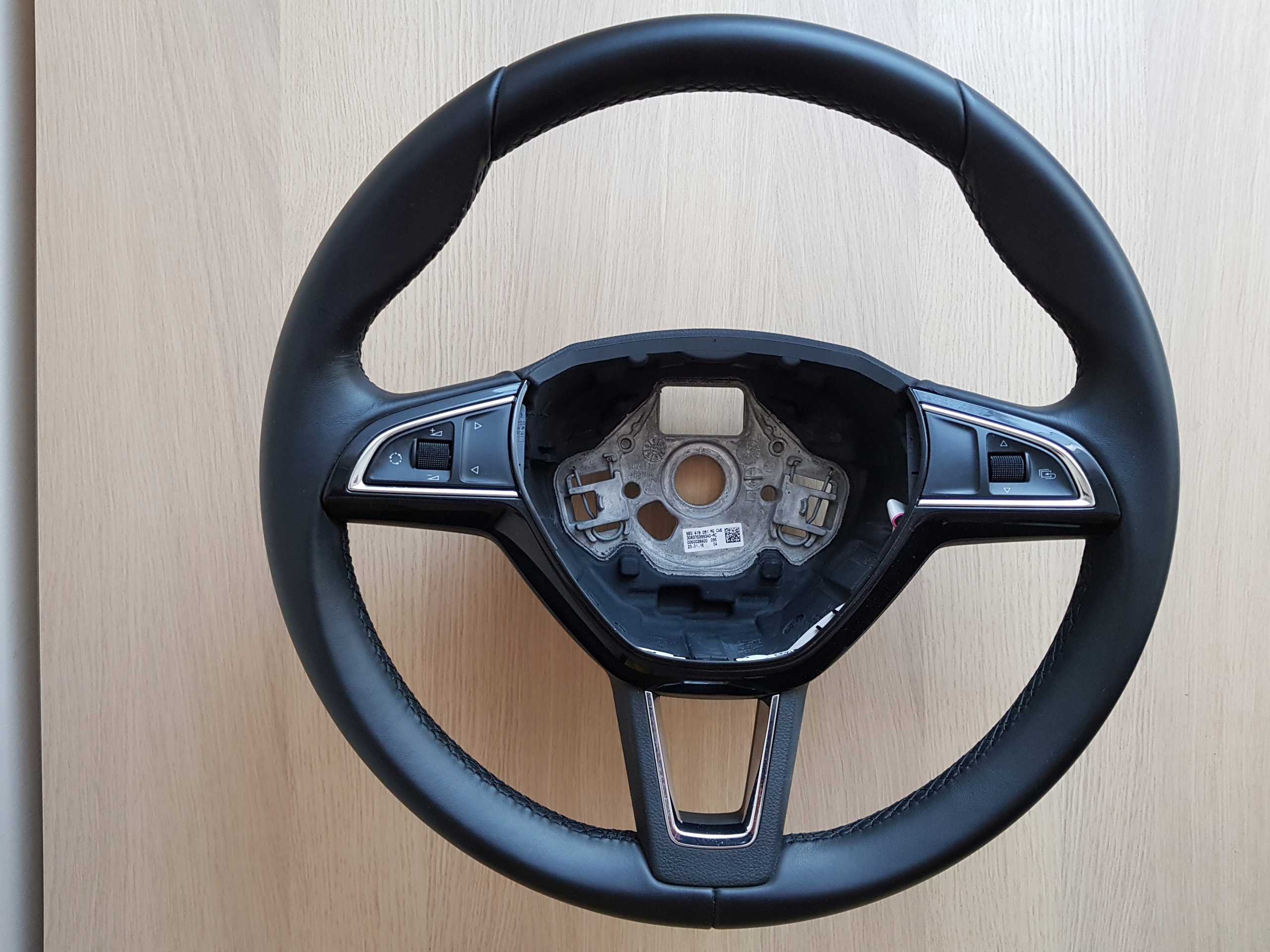

On the later model MFSW matter, I did some research on internet and ETKA/ElsaWin.
5J FL Fabia came with 4 interchangeable slip ring models:
>>27.05.2012
6Q0 959 653 B
6Q0 959 654 D (for ESP)
28.5.2012>>
6R0 959 653
6R0 959 654 (for ESP)
>>09.12.2013
6Q0 959 653 B
09.12.2013>>
6R0 959 653
I have a read about a user where he has successfully retrofitted a old style MFSW while on Fabia with 6Q0 959 653 B slip ring
Also I read about a user who retrofitted MFSW buttons on a car that came with 6Q0 959 654 D, using airbag wiring loom with part# 5E0971584A
So I come to the conclusion that 6Q0 959 653 B might/should work with 5E0971584A airbag cable. Now I have to actually verify it on my car.
In the process, I found out that:
[*]Not all button models from new style steering wheel will work on 5J FL Fabia.
From this post https://www.briskoda.net/forums/topic/4 ... nt=4862593
I came to the conclusion that it has to be one of the followings
- 5E0919719C (Fabia2, Rapid, Roomster)
- 5E0919719D (Fabia2, Roomster)
- 5E0919719E (Rapid, MK2 FL Superb, FL Yeti)
- 5E0919719F (Rapid, MK2 FL Superb, FL Yeti)
- 5E0919719G (MK2 FL Superb, FL Yeti)
[*]The buttons on the right side of the steering wheel will function as replacement of the trips buttons on the wipers stalk, only if the car has a Maxi Dot IC.
If the car has the lower spec green screen, the trips buttons on the wipers stalk is the only way to go through the indications on the IC.
Once again, all my conclusions/notes are theoretical to this point and I will have to verify them on my car, in order to confirm them.
