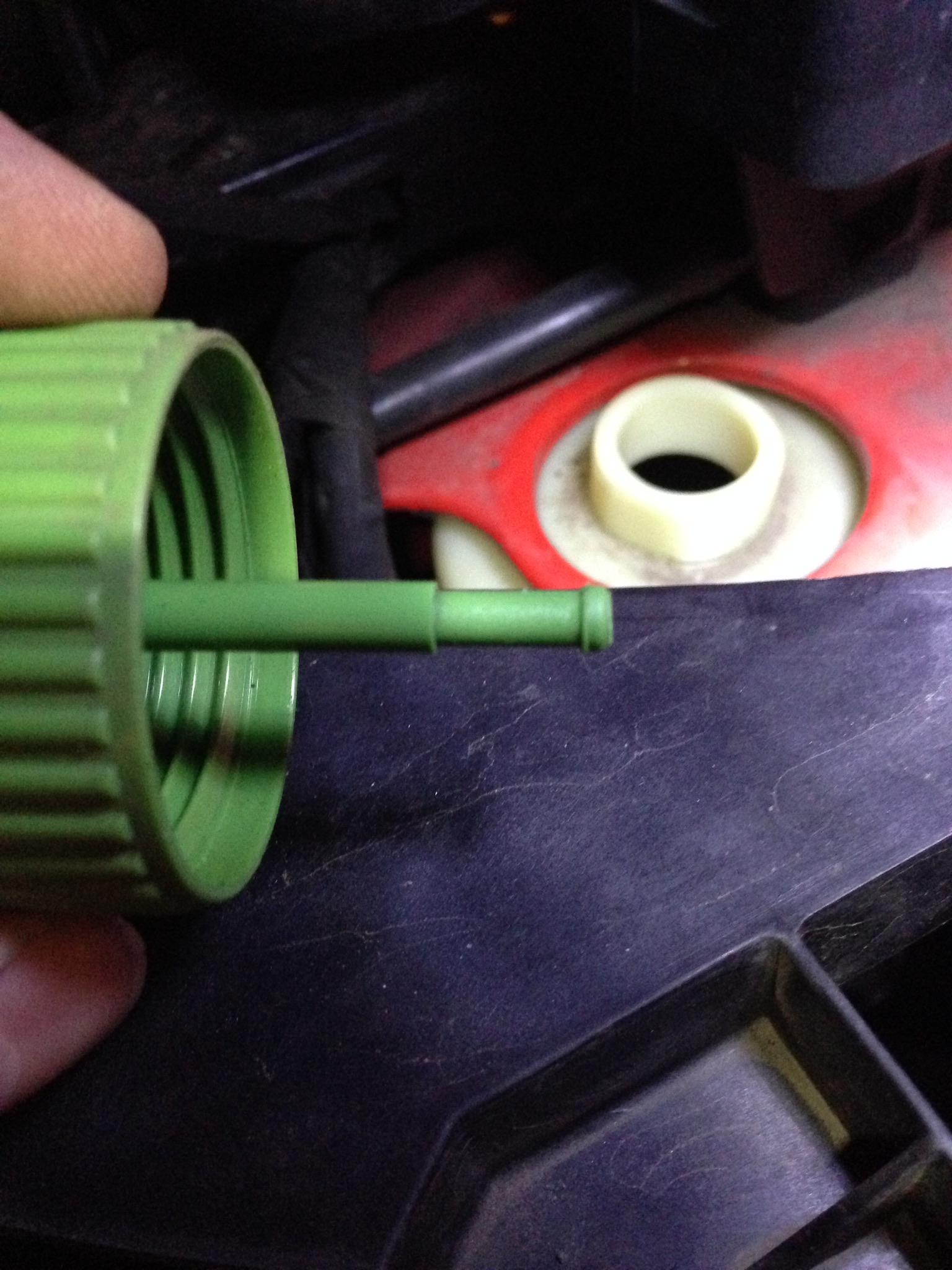

I just managed to remove a headlight and unscrew the green lid. The “dipstick” was wet but I dried it and put it back on and off a few times and it didn’t get wet! Looks to me like it is a little low on fluid.
Does anyone know what fluid it should take? I think I need to give it a shot before major work.

I get what you mean but a 10 quid bottle of fluid is worth a punt instead of a new unit! The light hasn’t been on all this week despite the car covering a couple of hundred miles.
I have googled images of the reservoir and some have min max lines others have dots. Mine is become below the bottom marker which looks like a dot. How do I figure out what fluid to use or would regular power steering fluid work?

Only use a power steering fluid that complies with VW spec G 004 000 M2, that is why I just bought it from VW, but by now I'd think that there will be cheaper aftermarket suppliers, do ECP not sell it?
