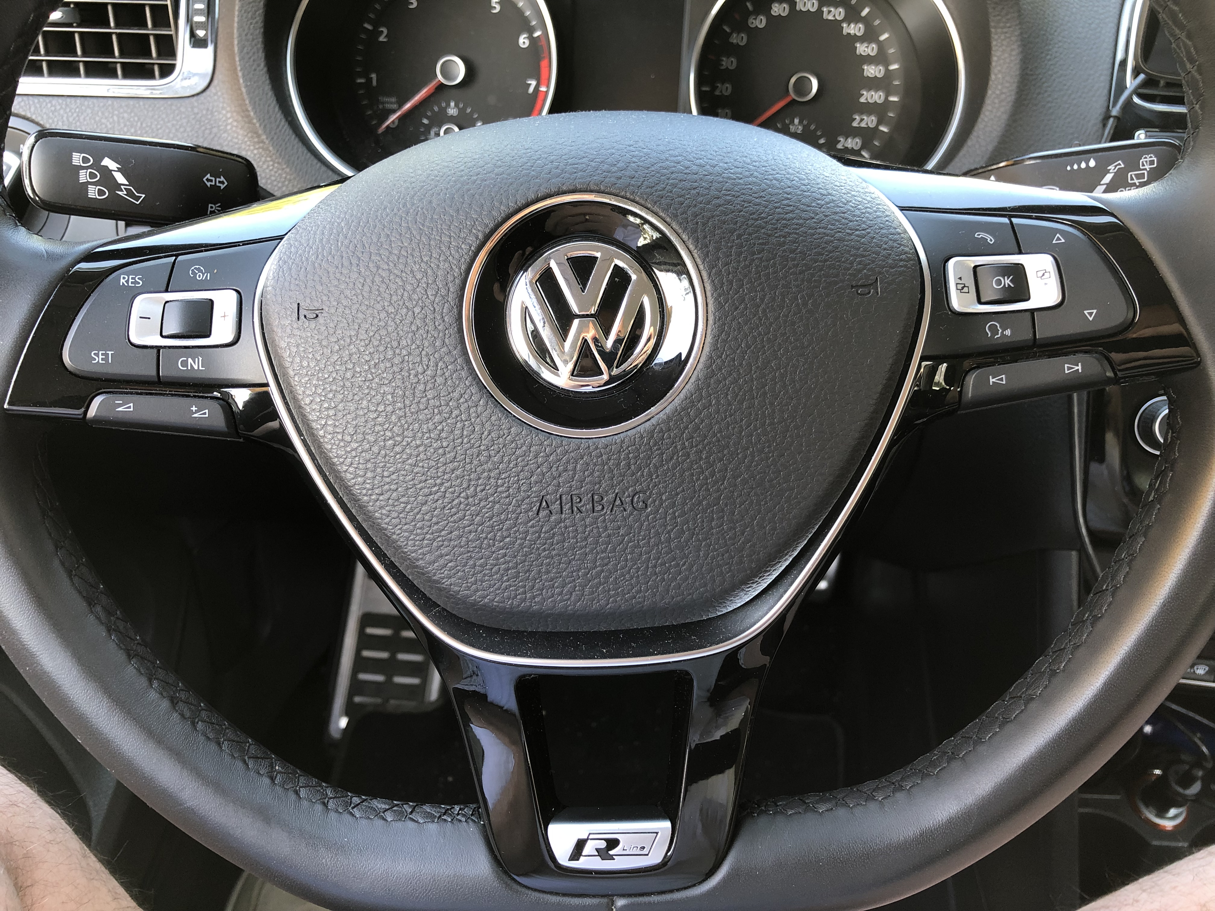

Hi Shappers, Do you have a pic of the "additional buttons" fitted to the steering wheel please as I'm considering this upgrade for my motor and for 300 sheets (including a potential new steering wheel lol) it is worth considering. I have an SE bluemotion with trip meter and the phone/dash buttons on my wheel...
- Posts: 9
- Joined: Wed Nov 07, 2018 10:51 am
- Drives: 6c 1.4 TDI SE
- Location: North Yorkshire
Re: Polo 6C Cruise control retrofit
If they're added below the MFSW buttons with the addition of a new shiny black trim piece then I think I've just seen them...

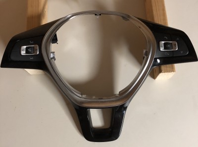

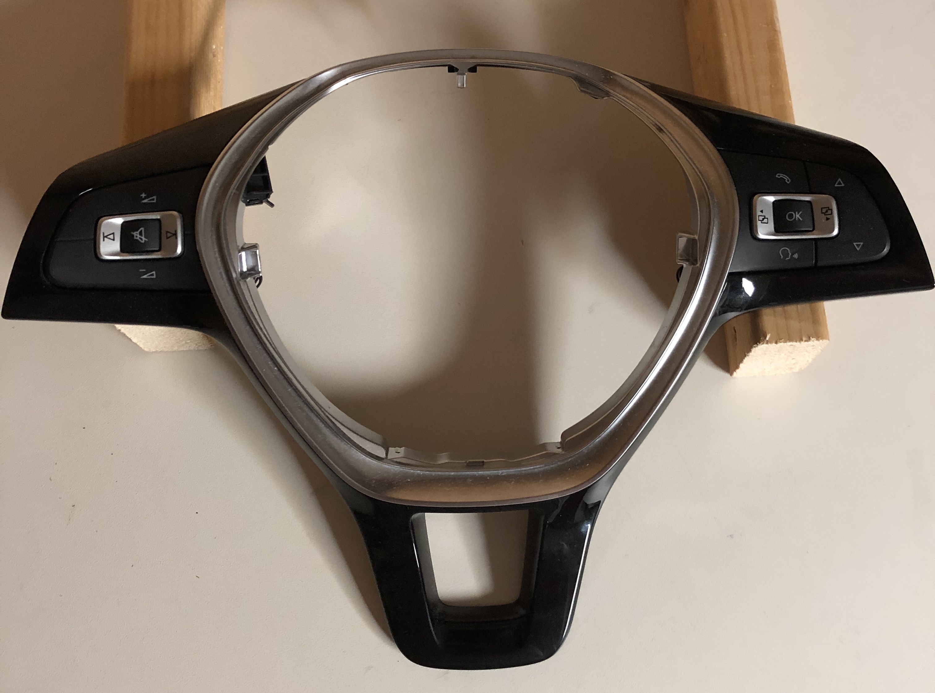

Hello, I'm sorry for my slow reply. I've been having some extensive cancer surgery. Hoping to drive my Polo again soon
Here is the part removed from my car:
Here is the new switchgear:
And here is my work sheet (In Finnish) but it clearly shows the new part number is 6C0054690A. Parts €175, labour €205:
Brgds, Shappers
