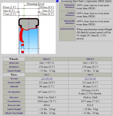

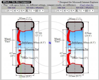

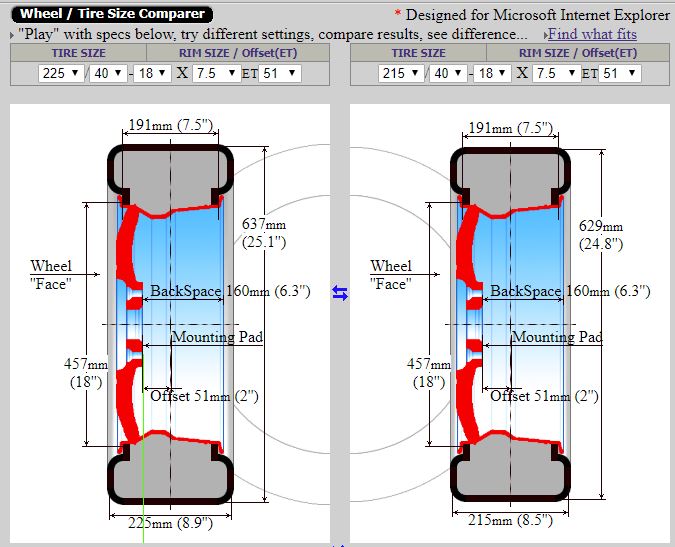

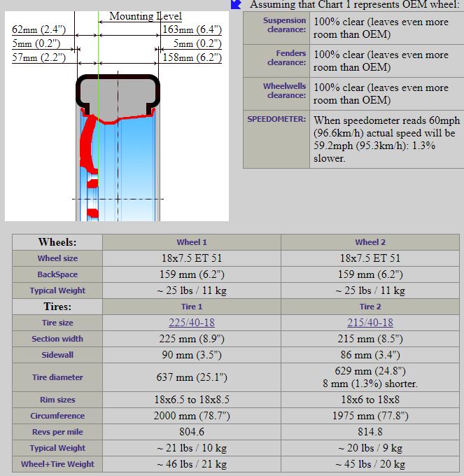

Found a website that offers some technical explination in the images below:
- the speedometer is going to mark correctly the speed?
[from what I've read there will be an approx. 1.4% difference in reading, so not really that noticeable]
- what pressures are the correct ones?
[no idea but guess same as owners manual recommends]
- Tyre pressure loss indicator is going to work properly?
[I doubt there will be a problem with the device/sensor]

The rolling circumference of the wheel will increase by 8mm as you say, but this results in an increase of approximately 1.27%, contributing to 1mph under-read on your speedo at 70mph. As the speedo over-reads by about 3% vs GPS anyway and there is an allowable tolerance of (can't 100% remember) something like 2.5% then we're fine. The difference in rolling diameter between new and fully worn 215/40 R18 is about 12mm - to put your 8mm into context!

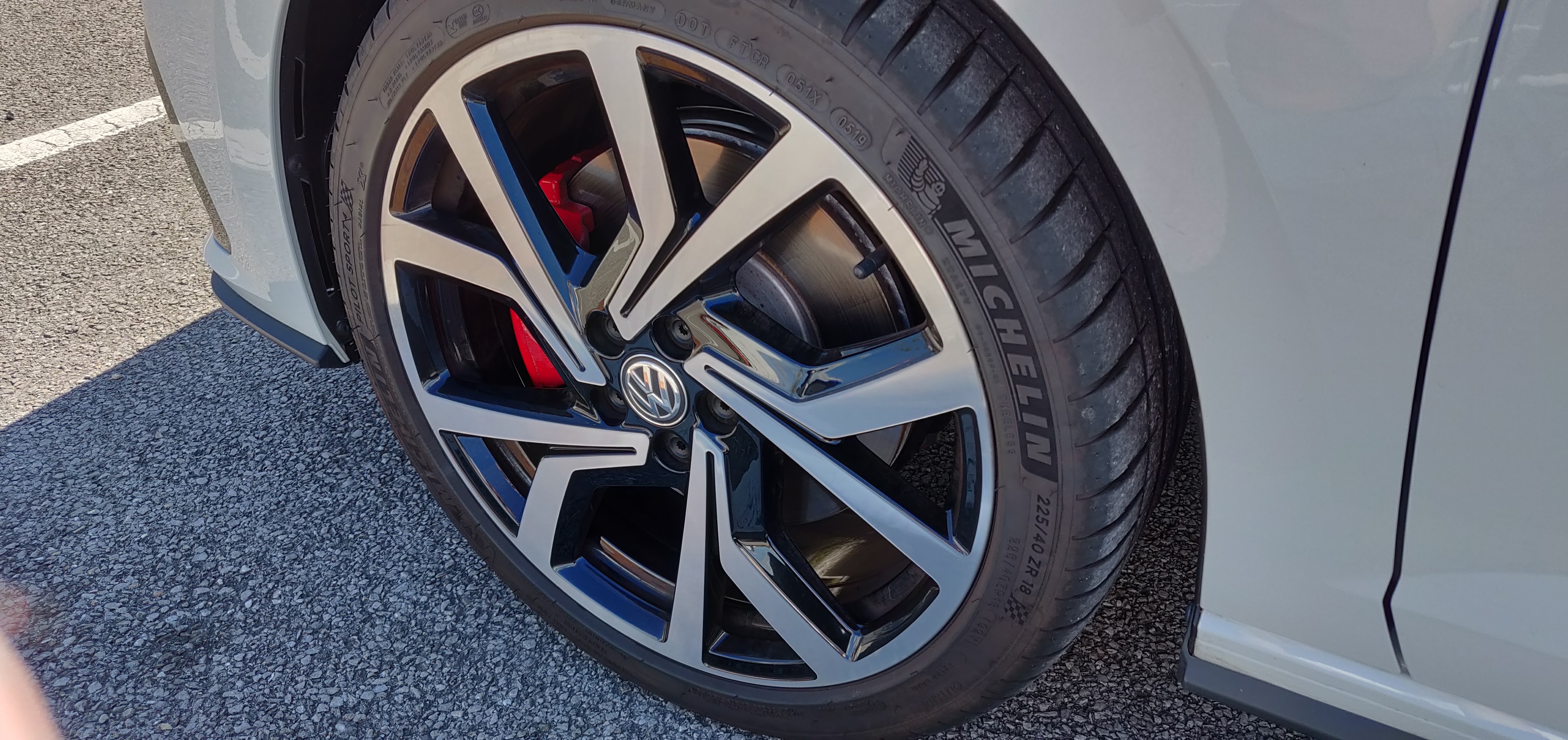

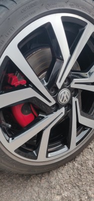

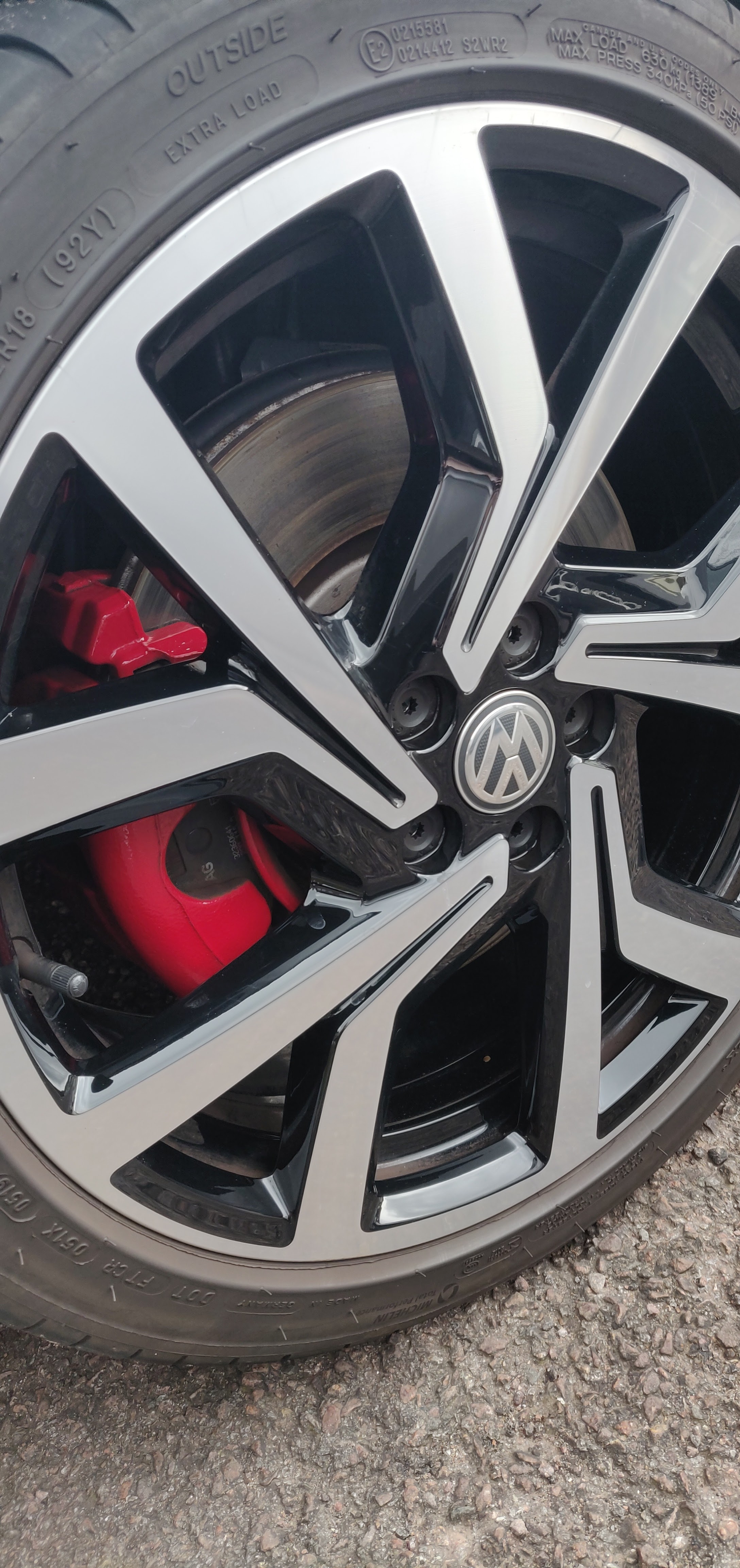

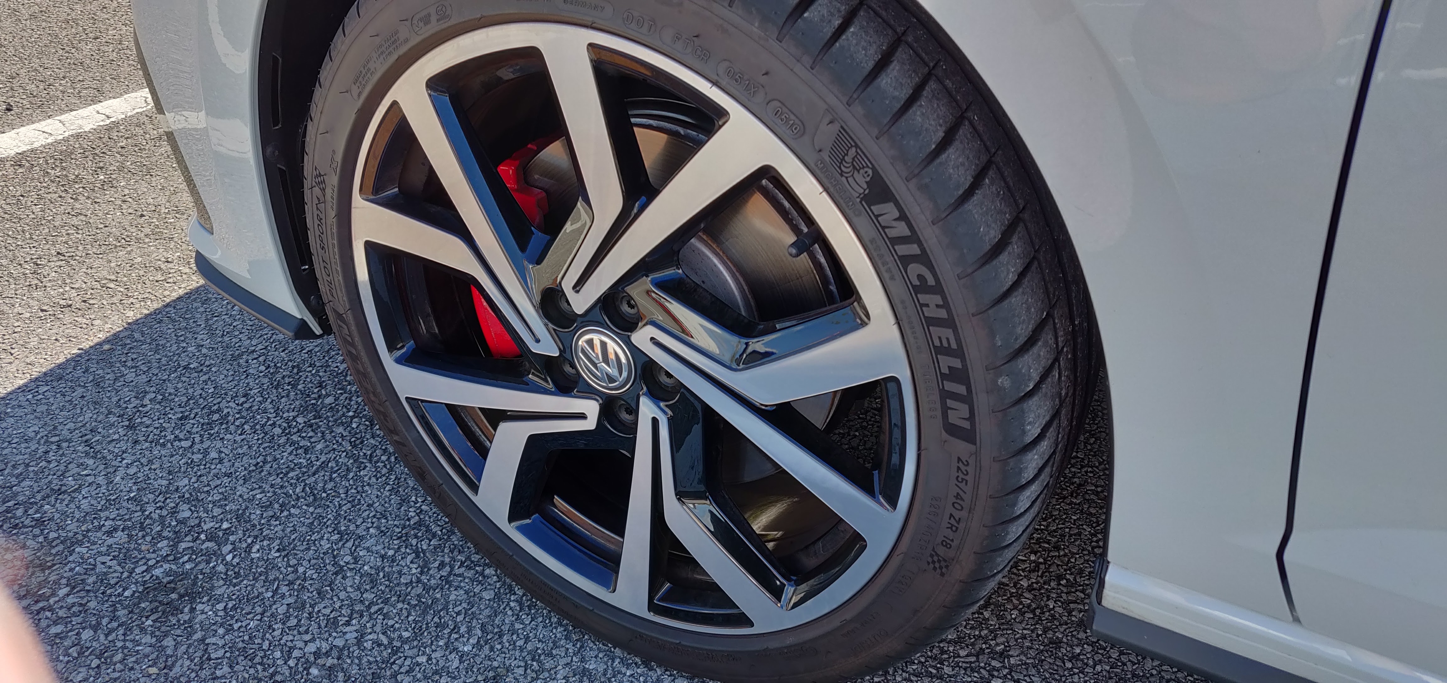

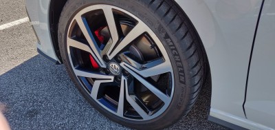

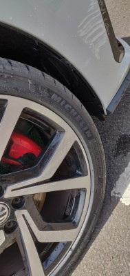

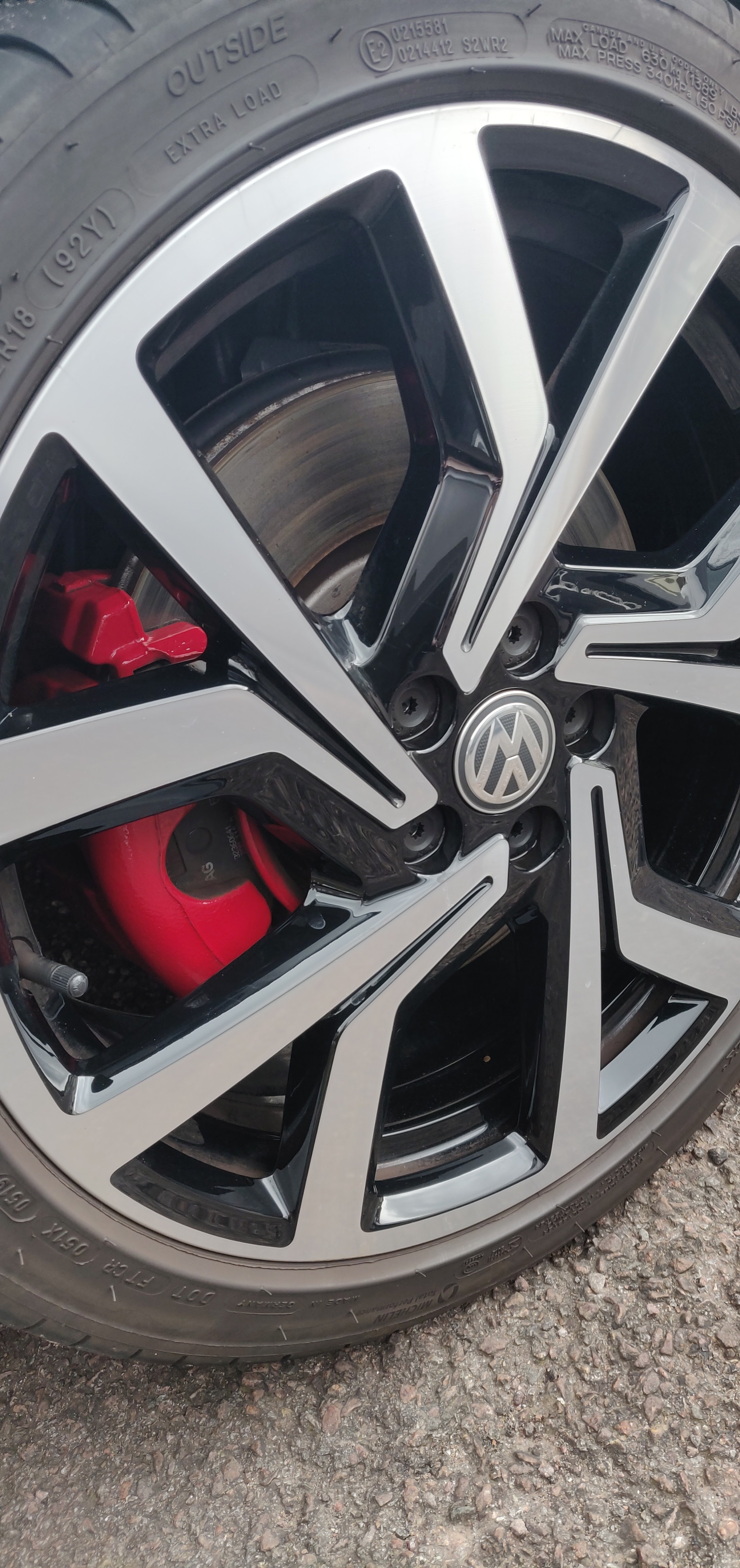

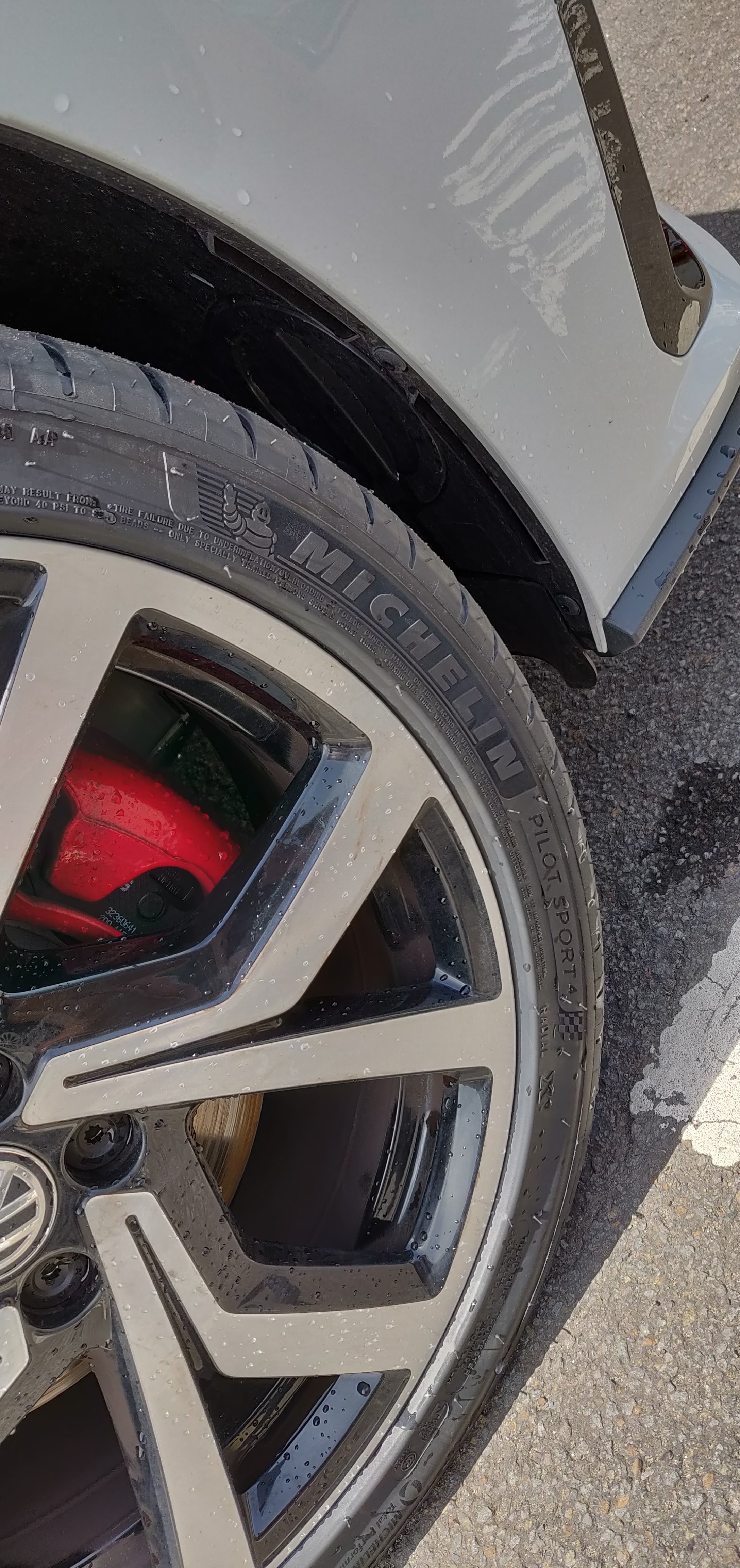

Got some pictures at hand if that helps.
I bought the PS4's on monkeyhanger's recommendation. Would recommend anyone else do the same, they have improved the car ten fold. And having the protective lip is a benefit!

Thanks for all the information
Re: 215-40-18 or 225-40-18 tyres on Polo GTI
Thank you so much!!:)S_94 wrote: Mon Mar 30, 2020 2:28 pm Got some pictures at hand if that helps.
Great pictures. The rim protection looks great. Price for 4 looking good too. Thanks for the advice .
