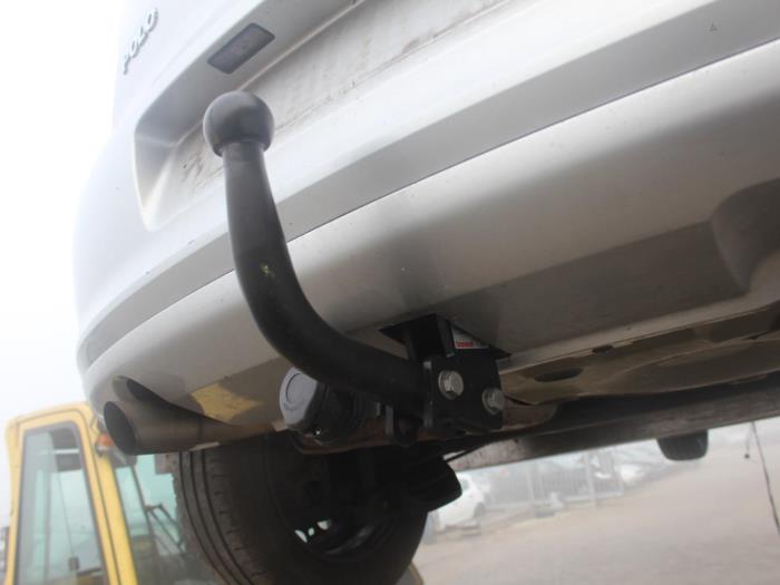

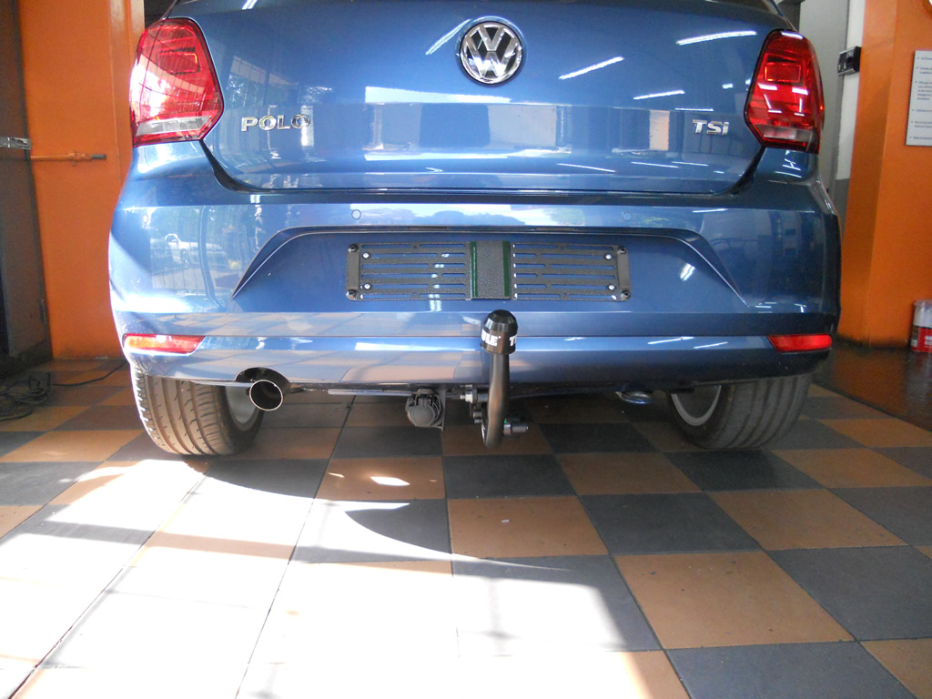

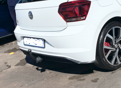

Hi
Has anyone fitted a tow bar to their GTI? or R-Line.
Here is example of FIXED towbar fitted by a dealer. I was hoping there is not need to cut the rear plastic.

Plastic must be cut

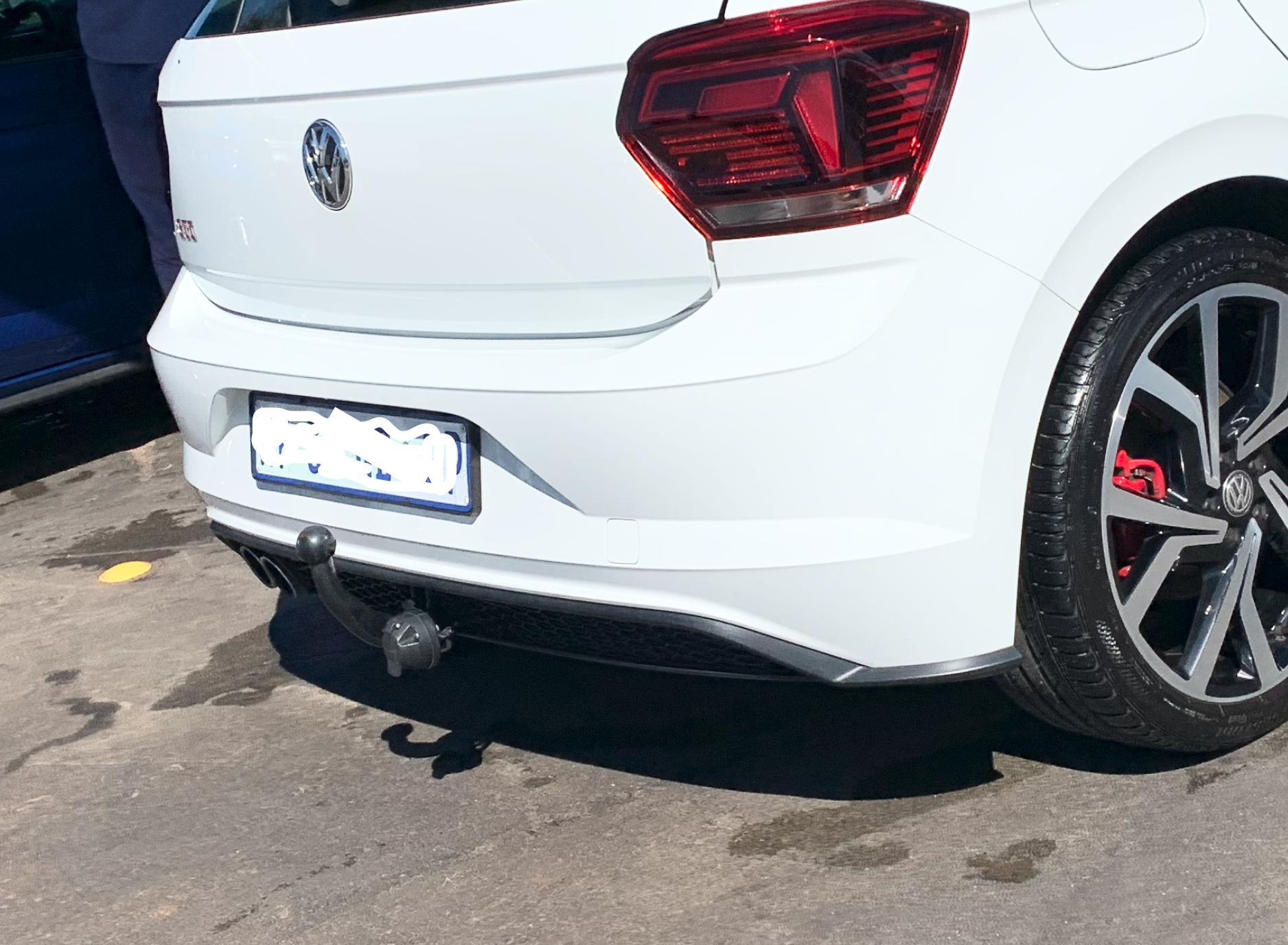

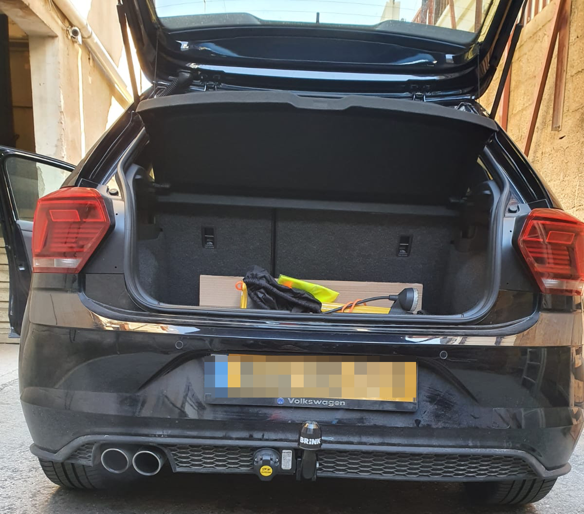

Re: GTI Towbar
Post by grim007 »

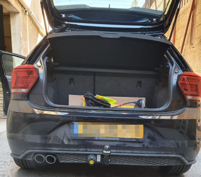

I have one installed.
Had the Aragon permanent towbar installed. Unfortunately there are no removable models from any brands that I could find.
Plastic has to be cut.
This is what it looks like.
It doesnt look too bad, and if you change ur mind at some point the plastic isnt that expensive to replace.

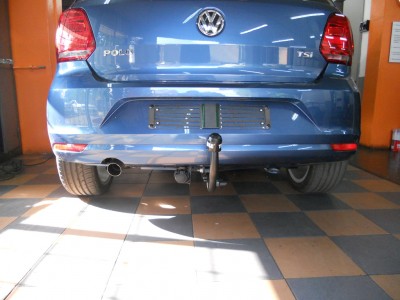

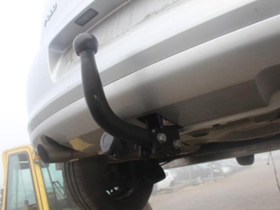

I am waiting to hear from places that install tow bars. Hopefully after lock down.
I am hoping i can get something that comes out from the bottom of the bumpers with a longer swan neck.
towbar2
towbar2
towbar1
towbar1
