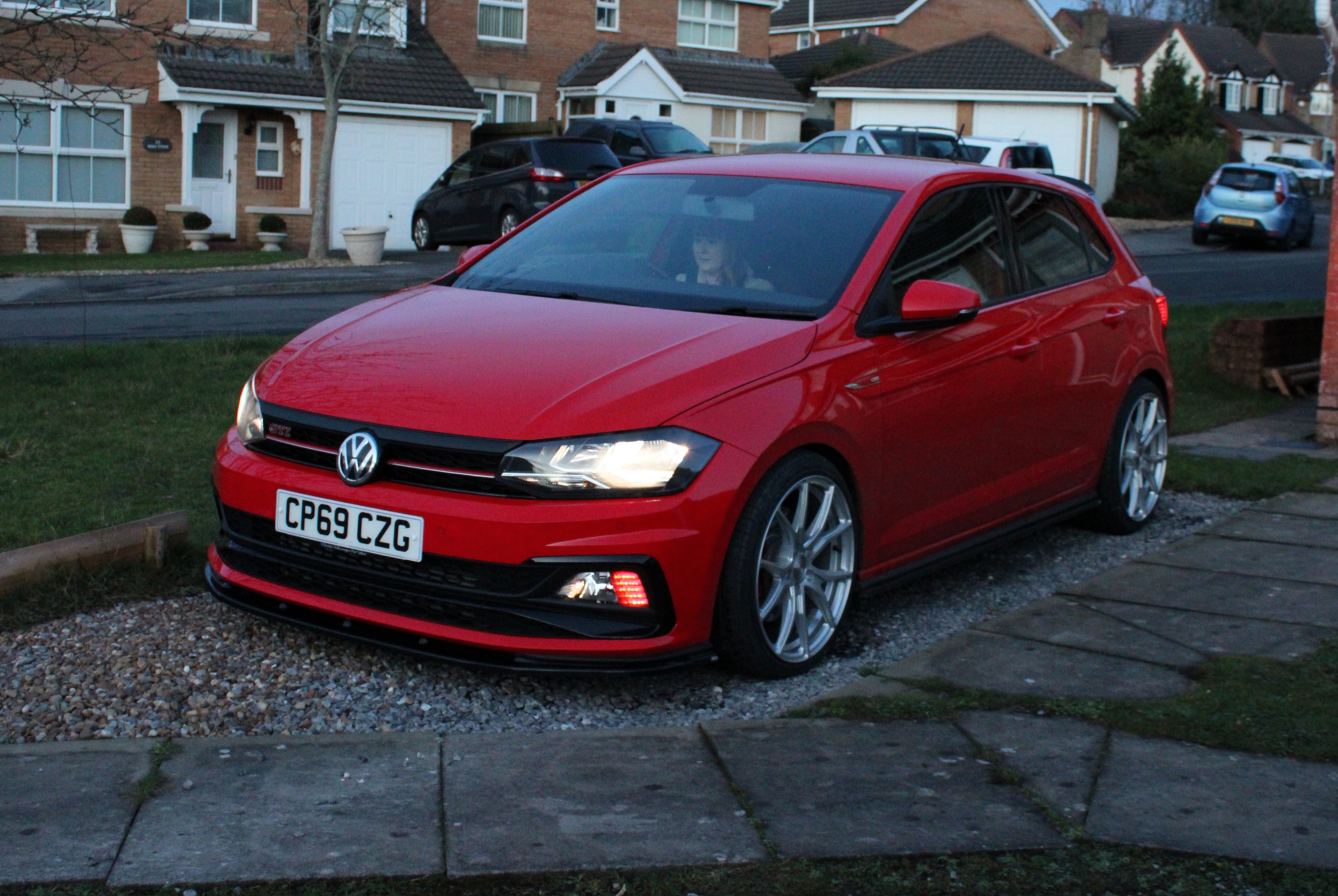

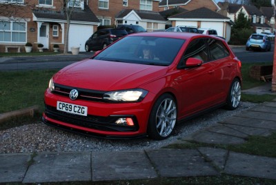

Thanks again for all your help guys, wheels are now on with no problems

That looks good RichTea

Re: Alloy wheel help
Loving the drls.
Are they a different colour LED, or have you put a colour filter on there ?

They look a lot better in person as well. I bought red tint film from ebay and cut them to shape. I also stuck two sheets on top of each other as it looked to pink with just the oneMattHGR wrote: Fri Jan 10, 2020 9:24 pm Loving the drls.

They look good. Which wheels are they and what size and offset did you eventually go for?RichTea wrote: Fri Jan 10, 2020 6:53 pm Thanks again for all your help guys, wheels are now on with no problems
As for your coloured front DRL’s; please be careful. If you’re stopped by the police, they may prosecute you as it’s illegal under the Road Vehicle Lighting Regulations 1989 to have front facing red lights, and I wouldn’t want to think a fellow forum member received a ticket / fine for changing the colour of their DRL’s to red. The Regulations actually state;
No vehicle shall be fitted with a lamp which is capable of showing a red light to the front
Whether or not fitting a red filter would be considered the same as fitting a lamp that’s capable of showing a red light is unclear, but I think there’s a fair chance that if you’re stopped and your car has front facing red lights, at the very least you’d be asked to remove the filter there and then.

Why do you want red DRL's in the first place, I think you'll find SRGTD correct in his post. get a copper on an off day, not only will you have to remove the red plastic film, but end up with a fine.
You could be coming round a bend with a "T" junction and your going straight on. And he see's only one of your DRL's he might mistaken that as your indicator (though it's not flashing). Although the driver should wait for you to start turning before he starts pulling out (some don't) you have an accident, who's going to get the full blame, him for pulling out, or you with a red/orange DRL?
