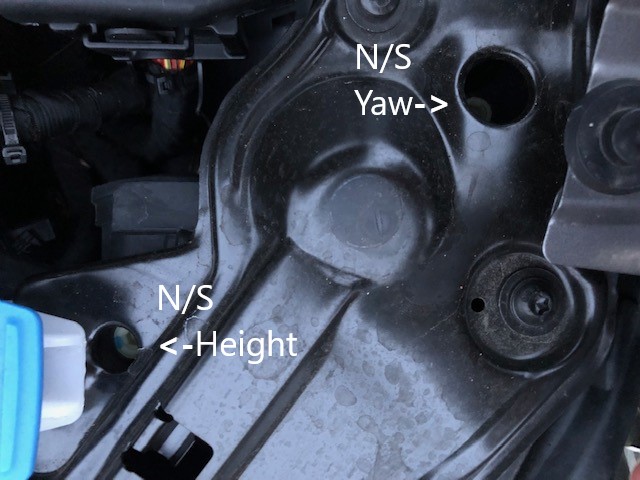

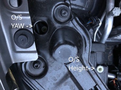

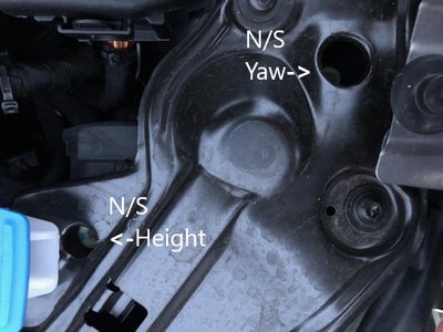

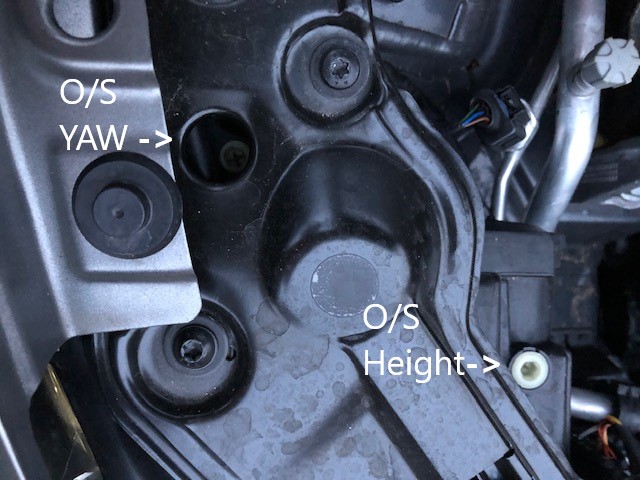

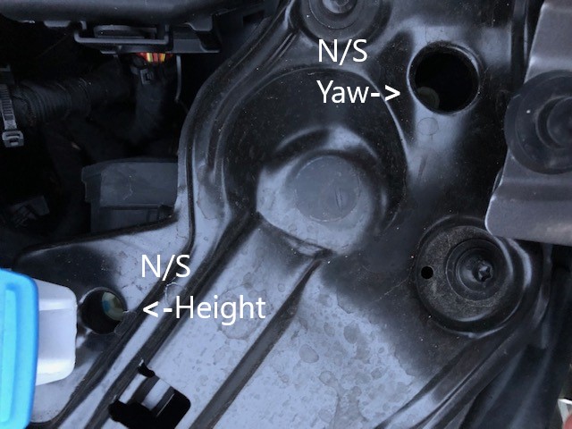

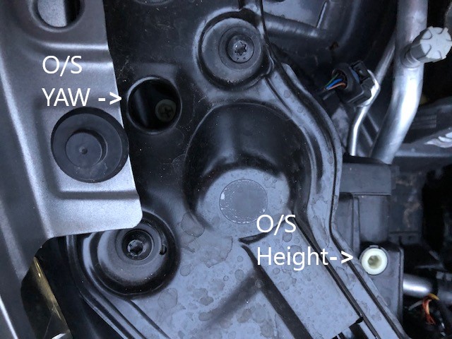

Tweaked mine up a bit today. Here's a picture of said 6mm hex screw including recessed cross screwdriver slots. This is on a GTI+ with LED Headlights.
Using a 6mm Hex T-Bar I rotated both the N/S and O/S height screws an initial 180 degrees anti-clockwise to raise and will monitor the results.
Edit. It still felt a bit low after 180 degree turn on the height screws, a further 180 degree, so a full turn anti-clockwise in total on each headlamp height screw, and the beam pattern seems good after a road test.

I can confirm that I made no adjustment to Yaw. Adjustments made with lights pointing towards a wall so I could watch the movement, with a subsequent road test on unlit country roads with opportunities to switch between low and high beam. As it transpires, half a turn still felt too low with a marked cut off line to the beam pattern and unlit road ahead, and with a full beam that felt like it was aimed downwards rather than ahead. I have subsequently raised the height another half turn (so a full turn in total on both) and it now appears to be much better, and not so high that it's affecting other drivers.
