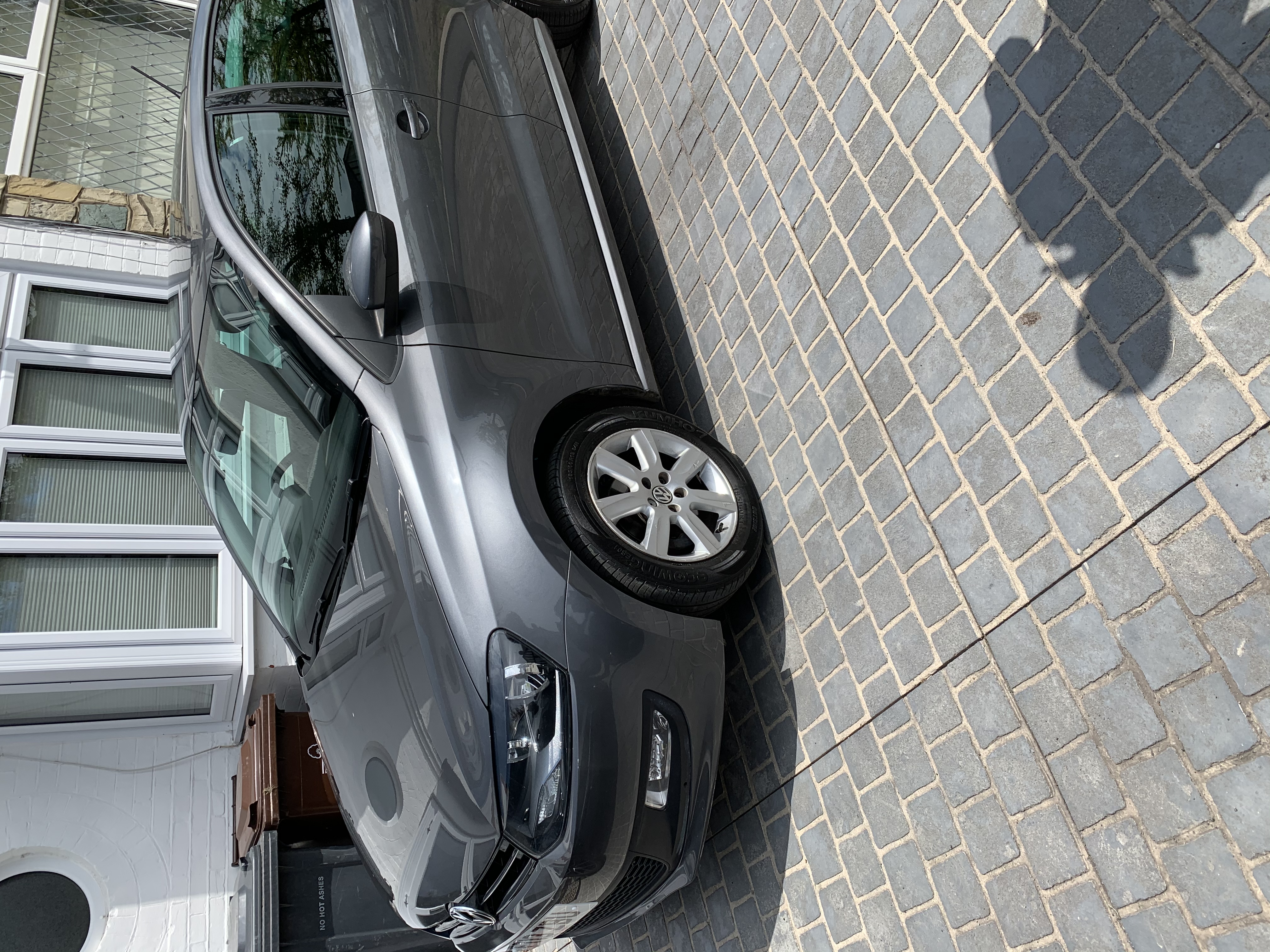

They must look well small in the arches? Have u got a side view pic?

Haha yeah exactly they are tiny hence want to buy some bigger ones!
The pics a bit old but it’s the best side one I’ve got at the moment

She looks well clean
Nice, i think 17” will look nice ,
I edited my last messege with tyre size which mine has etc , should give you an idea where to start .
