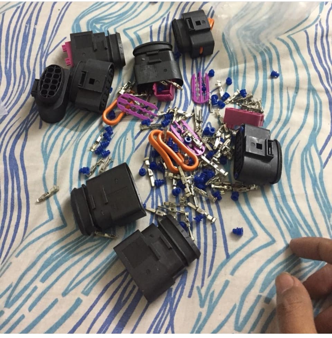

Can anyone please help me to source the new conversion pins from single barrel to dual barrel headlights?

Conversion pins? The plugs are the same. Literally just change the headlight unit

Thanksalexperkins wrote: Tue Sep 22, 2020 1:48 pm Conversion pins? The plugs are the same. Literally just change the headlight unit
I currently have H4 single barrel headlights with just one connector to the headlight, one for the parking light one for the turn indicator.
I have purchased the dual barrel headlights but the connectors it has is totally different
For referance I have attached the image of the needed connectors.

Re: Twin Headlight and Single Headlight System
I see
You can order these from your local VW dealer. You'll need details from ETKA to get the plug part numbers and associated pins however
Ciclo on here may be able to assist you

I tried to approach the VW dealer here in India but no luck, will try to contact Ciclo.alexperkins wrote: Tue Sep 22, 2020 2:14 pm I see
Thanks for help

Can you please show the old plug and new plug? Including wires/colours?
