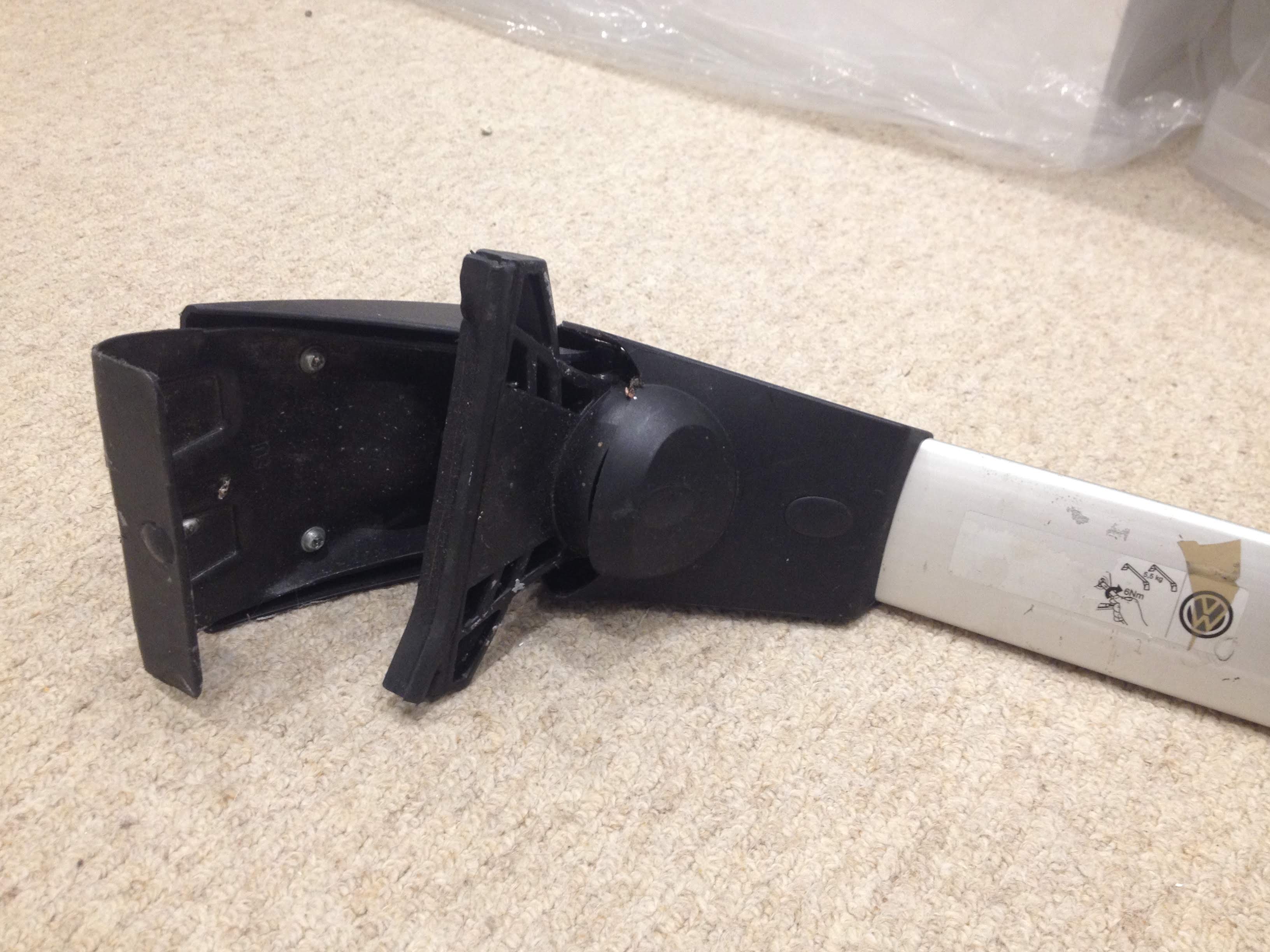

Is it those little guides?

Hi Alex,
Thanks for your reply. Yes on your photo I think those little guides on the roof bars match up and follow the roof lines on the cars body. I have these present on my roof bars. It does seem from the fitting instruction manual that they come with these extra rubber inserts from new which fit into the door and allow the bottom of the roof bar bracket to sit on them as to not damage the paintwork / door rubber sill.

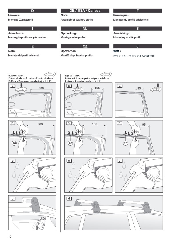

Can you post a pic of the page on the manual? Sadly they don’t sell those parts separately though we might be able to find something that’ll work

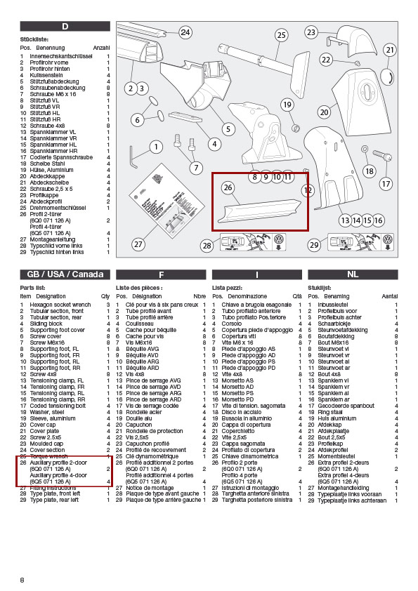

Re: Genuine VW Polo 9N3 roof rack - auxiliary profiles?
Hi Alex,

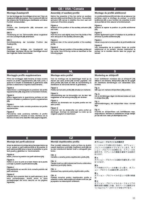

No problem, attached are the pictures of the manual and I've highlighted red the parts it comes with.
Interestingly they didn't really refer to the additional parts on the Australian post. Its difficult to know whether they are actually essential or not.
Many Thanks
Jody

Can you post some pics of how yours look like what I have posted?

Yes certainly - I will take some photos this evening when I am back from work. But yes it does the look the same as what you have posted.

- alexperkins
- Site Admin
- Posts: 14866
I see what you are saying now about the rubber aux profile. I dont think it will make a huge difference if its only here and there you are using the roof bars. I imagine you will fit and remove as necessary?

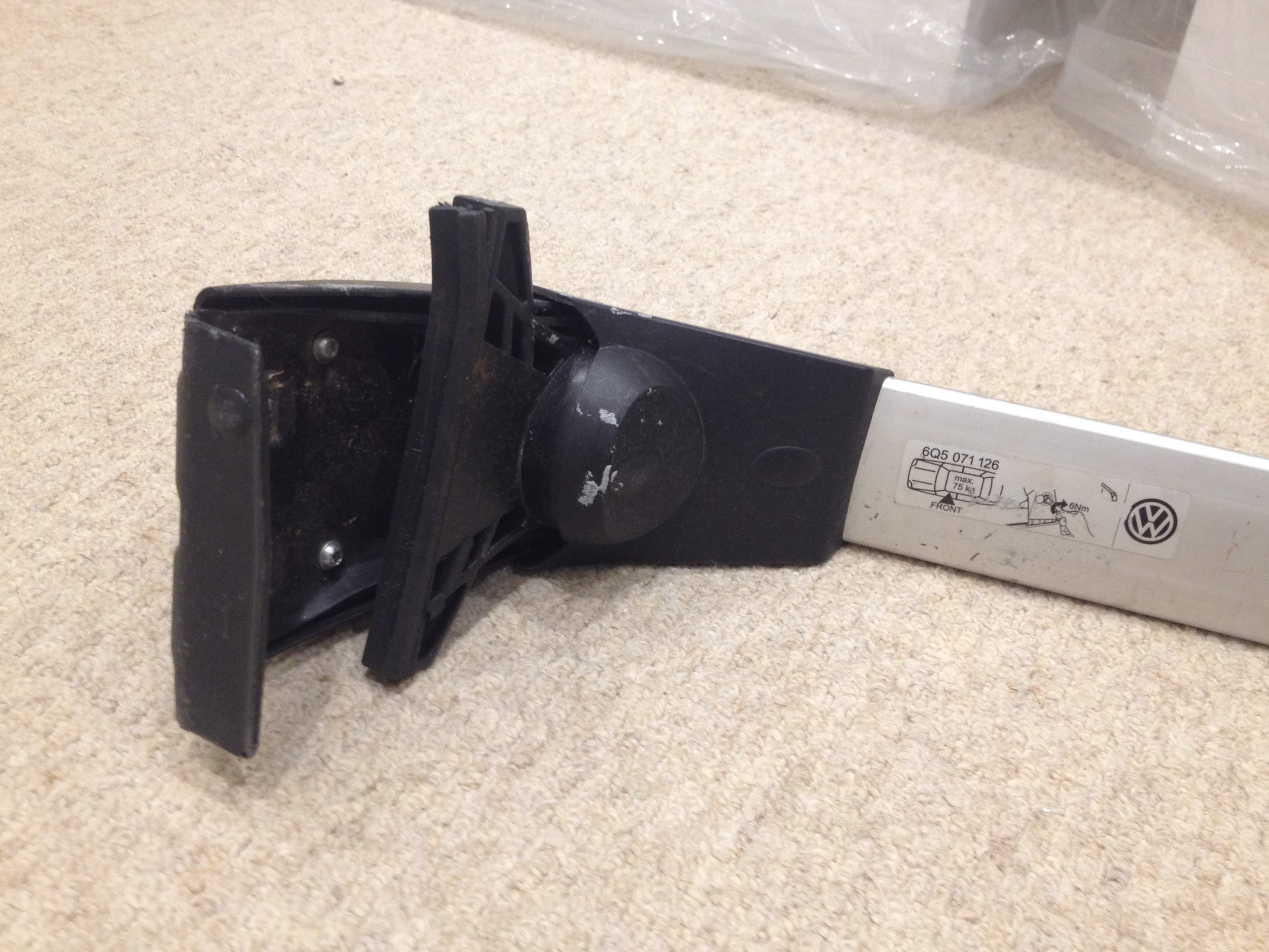

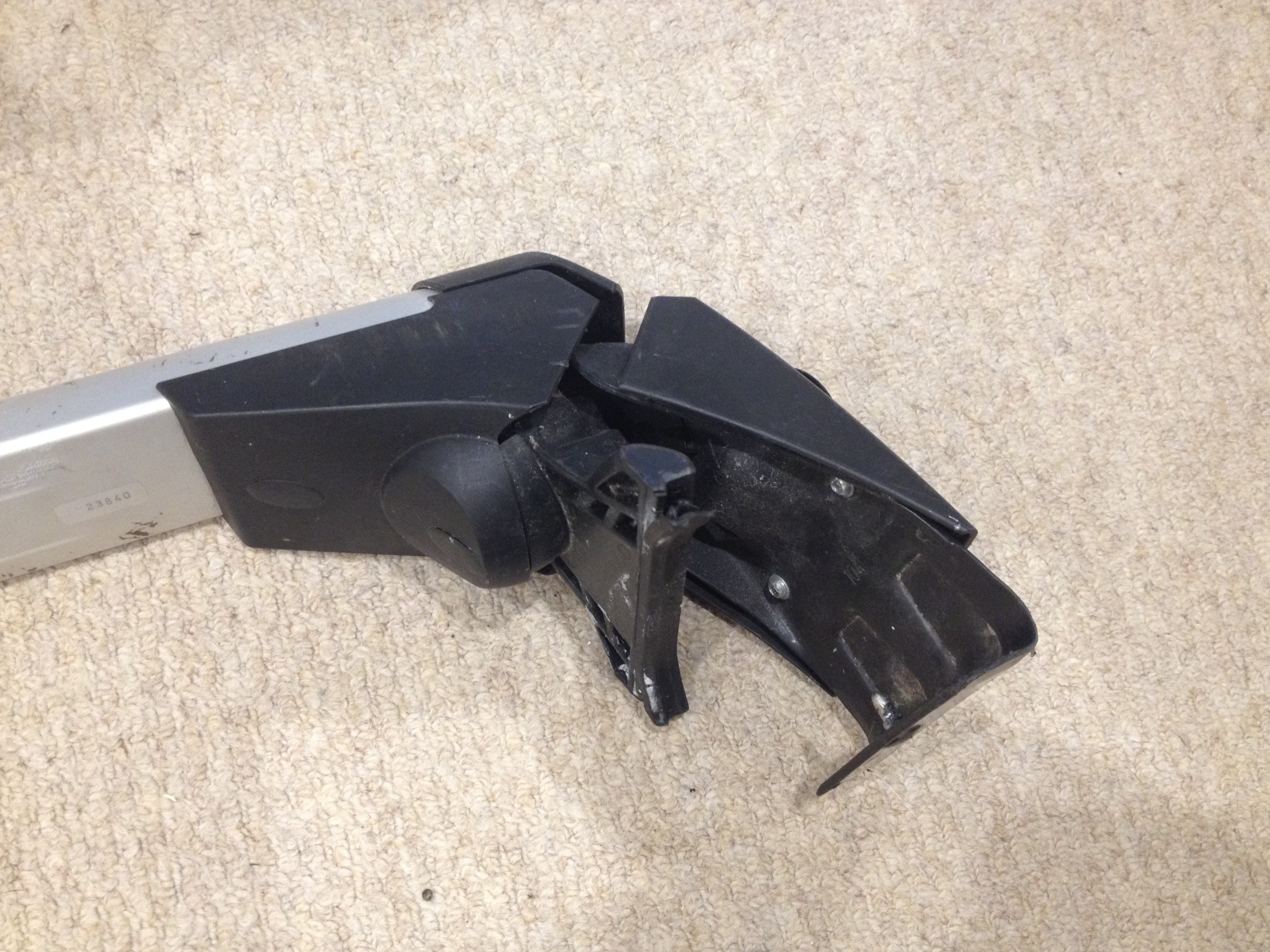

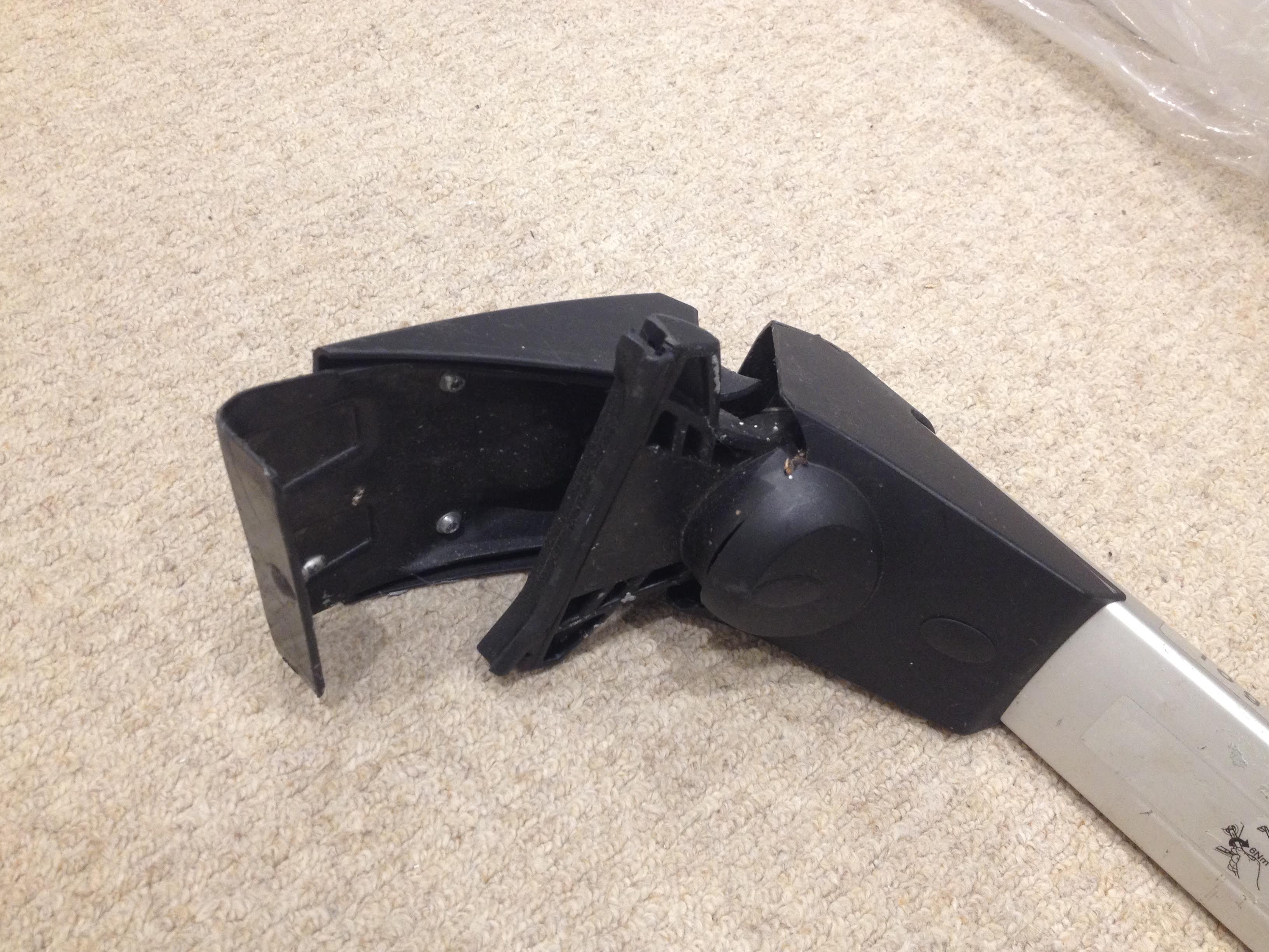

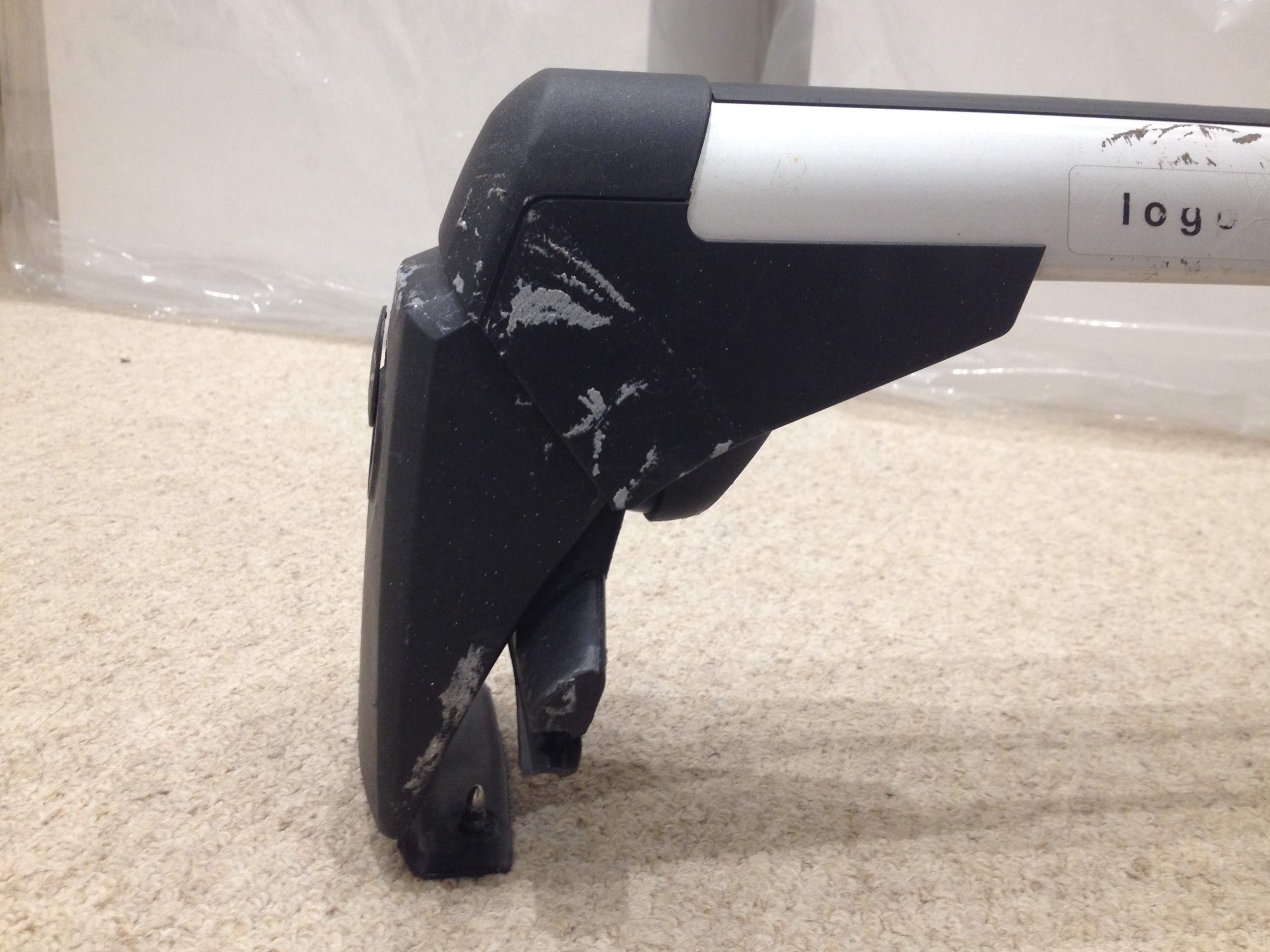

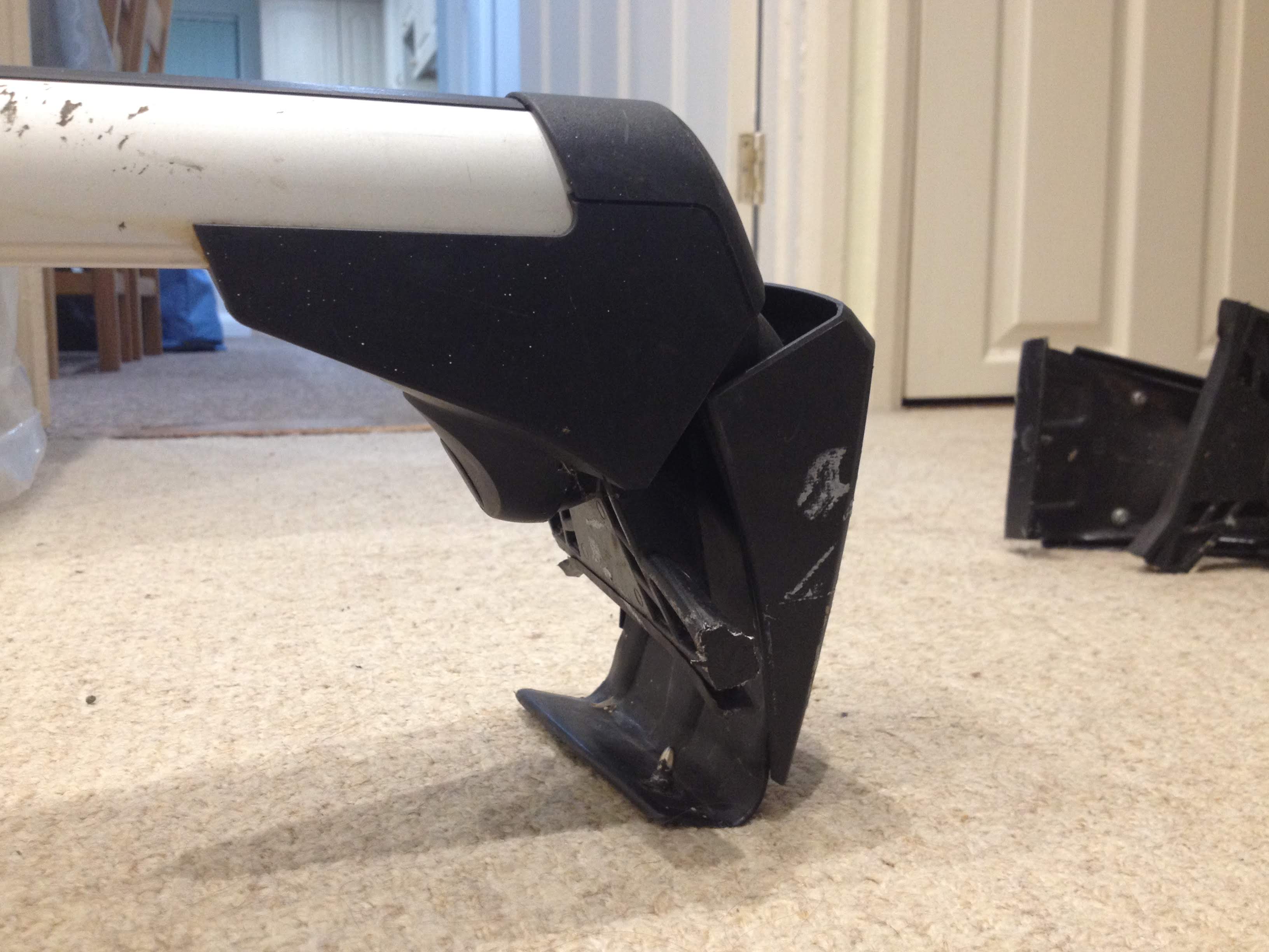

Evening Alex,
Sorry for my slow reply. Attached are some pictures of my roof bars.
Like you say - I hope not having the aux rubber profiles will make too much difference. I don't intend to use the roof bars alot, just when going away for the weekend or picking up the odd item. They won't be on the vehicle all the time.
Do you think it would be worth mocking up some rubber inserts to sit between the metal roof and pins? It looks as though it could scratch the roof otherwise.
Many Thanks
Jody

- alexperkins
- Site Admin
- Posts: 14866
Yes id maybe suggest some very thin rubber - perhaps stick on neoprene or rubber sheet to cover the inside of the feet to stop it damaging the bodywork
Hi both,
Thank you for your replies. I think that's what I'll try - just sticking some thin rubber to the underside of the roof-bar brackets and see how that goes. As long as somethings between them and the roof so its not metal on metal contact but still nipped up tight when fitted obviously then it should work
I'll tackle this the weekend, need to order the rubber strips first, and let you know how I get on.
Cheers
Jody
