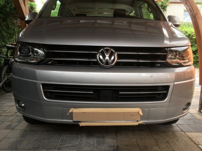

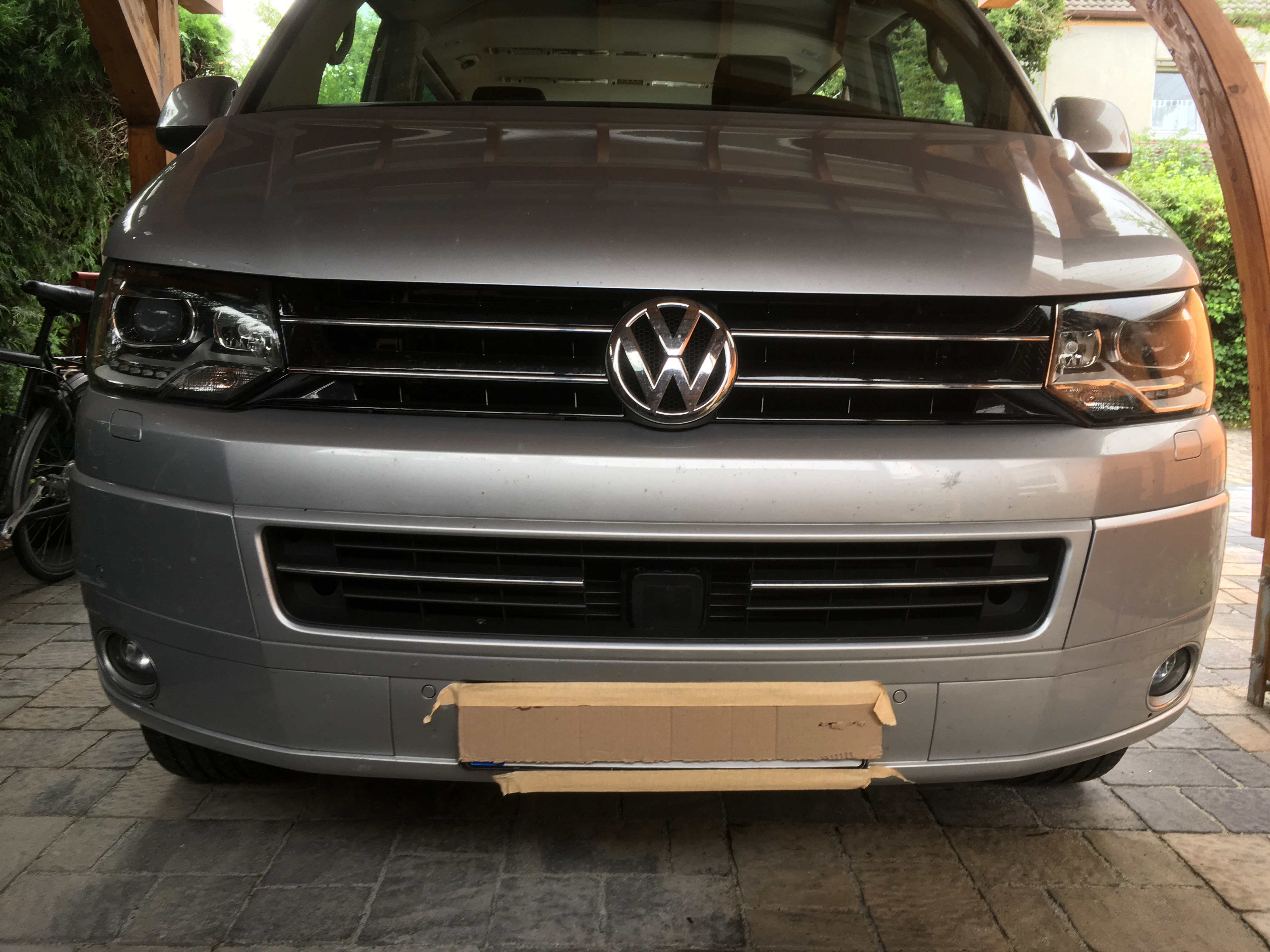

Short Update:
Fittet T6 ACC Radar on my T5.2
Nothing works :shock:
But:
- CP and SWAP for Radar are done
- Radar fittet
- Cluster changed
- ABS changed
- Airbag Controller changed
- Stalk changed
- Steering Wheel changed
- BCM changed
==> Only 1 Error in ACC and 1 Error in ABS when ACC is enabled
==> 0 Error with FrontAssist without ACC
FrontAssist is probably working, because with FrontAssist alone the ECU is not involved.
But with ACC enabled there is a CAN Message from ECU missing, or the message is to slow.
Need more digging.
