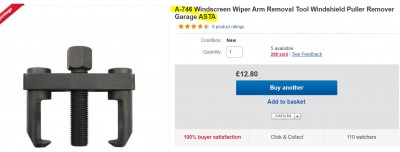

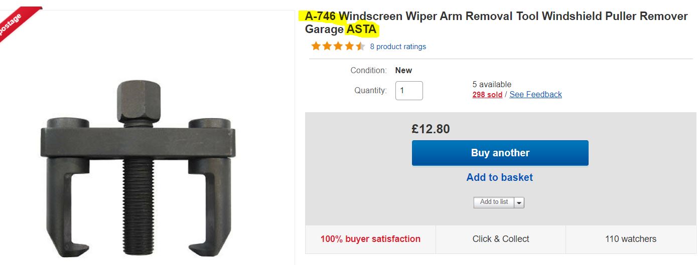

Hi Veteran, I think the second one Ive ordered is one of the ones you have suggested, so hopefully this one will perform better

Yes, that looks like the one. The price asked for that on eBay at present seems very good.
You'll find that, on that A-746, each of the outer 'claws' can be slid toward the centre-bolt, giving you lots of accommodation. The tool's made from tough forged steel. The slim and chamfered sides of the claws fit more easily into the restricted space you have around the spindle, on the Polo.
You'll find it fiddly and a bit floppy as you first offer the tool over the wiper spindle, but once you've screwed down the bolt to some degree it'll all become rigid and then you can get a spanner on the bolt's hex end to further tighten down. Don't forget to temporarily put the spindle nut loosely back on to the spindle before you apply the tool, as that helps keep the bolt centred, preventing it from 'wandering'.
Good luck with the job. Let us all know how it works out in the end.

It should have been something like Plus Gas that you initially applied to the dry seized splines, now that oil has wetted that area release fluid will not want to creep down and do their job. One other thing, once you get the new type of puller, maybe load it up "quite well" and leave it for an hour or so, instead of trying to apply huge amounts of torque to the lead screw until something gives.

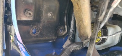

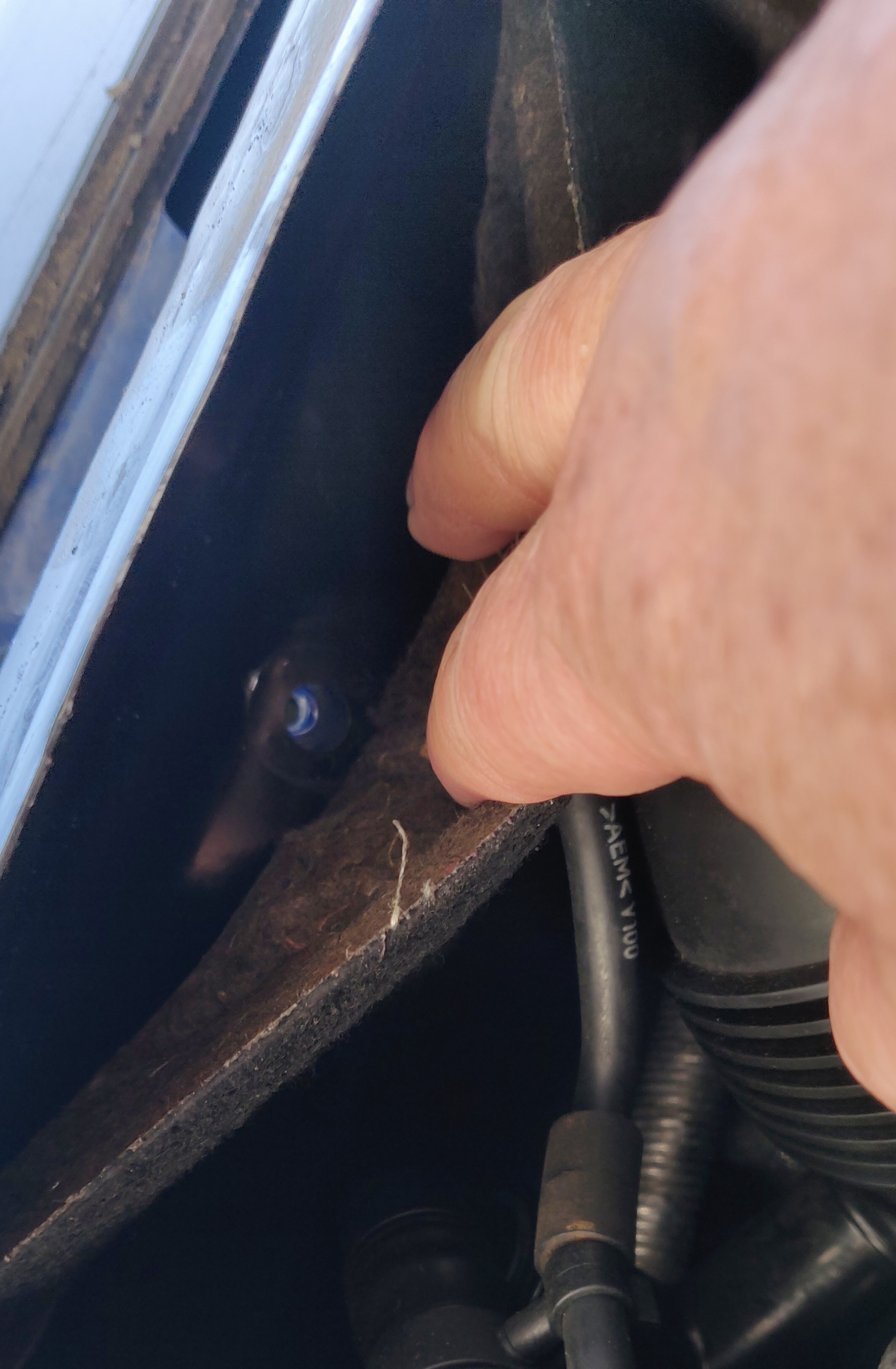

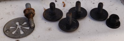

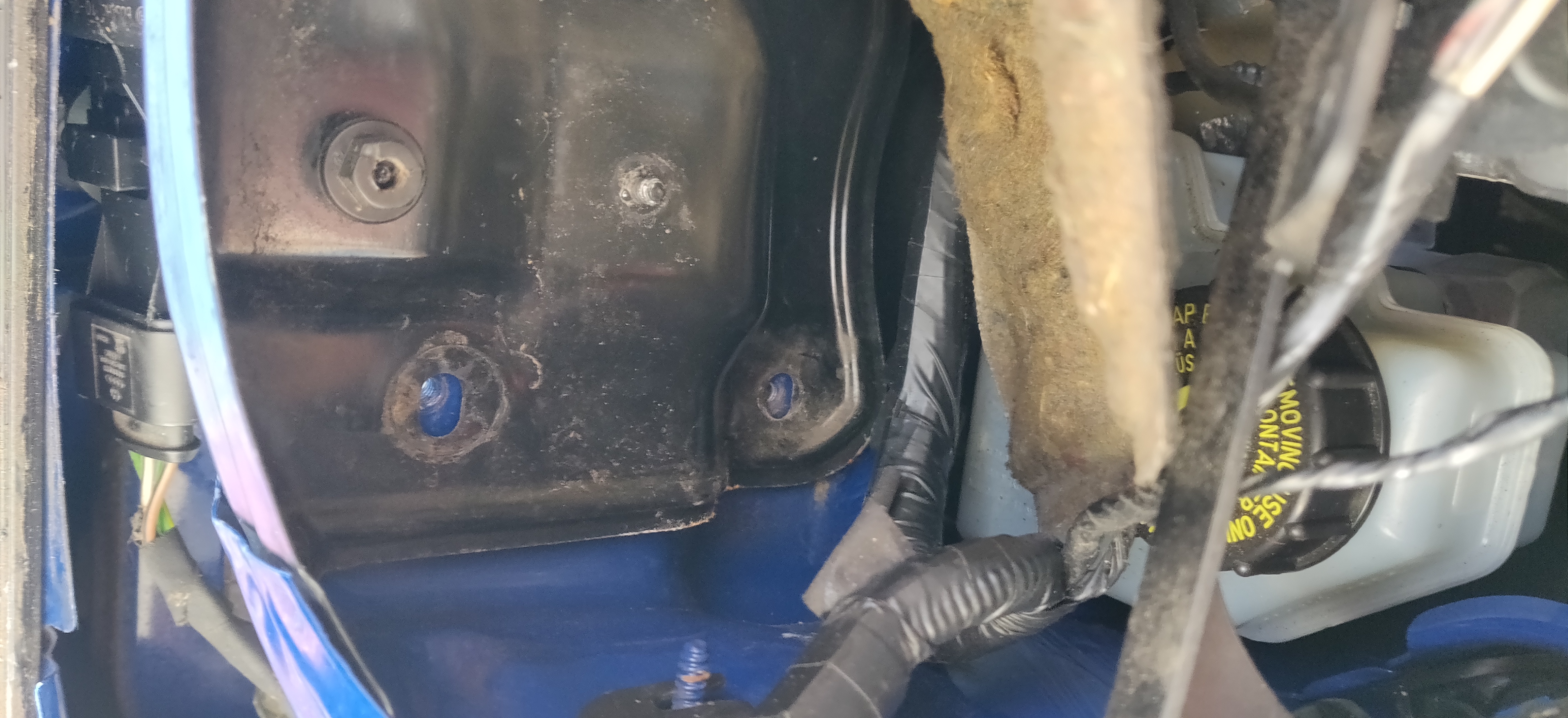

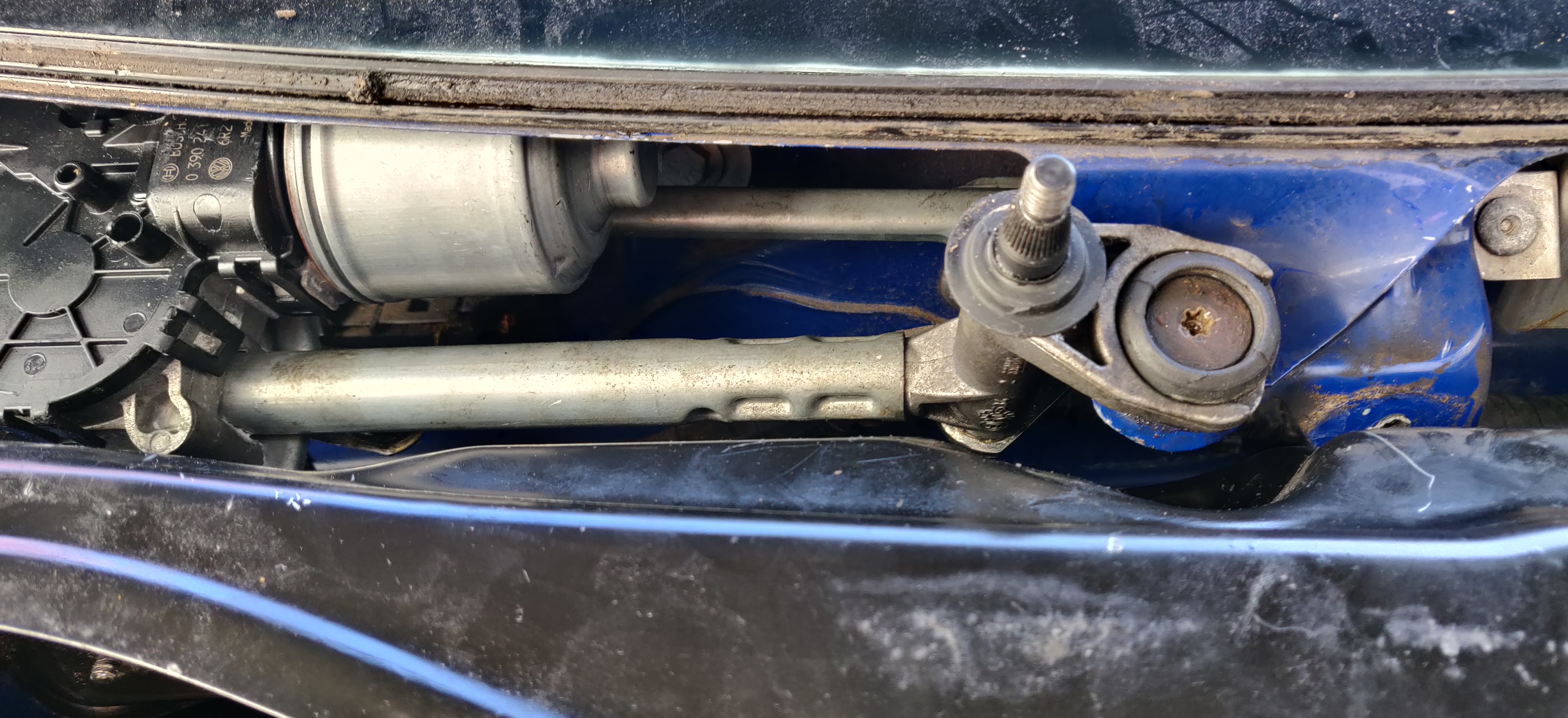

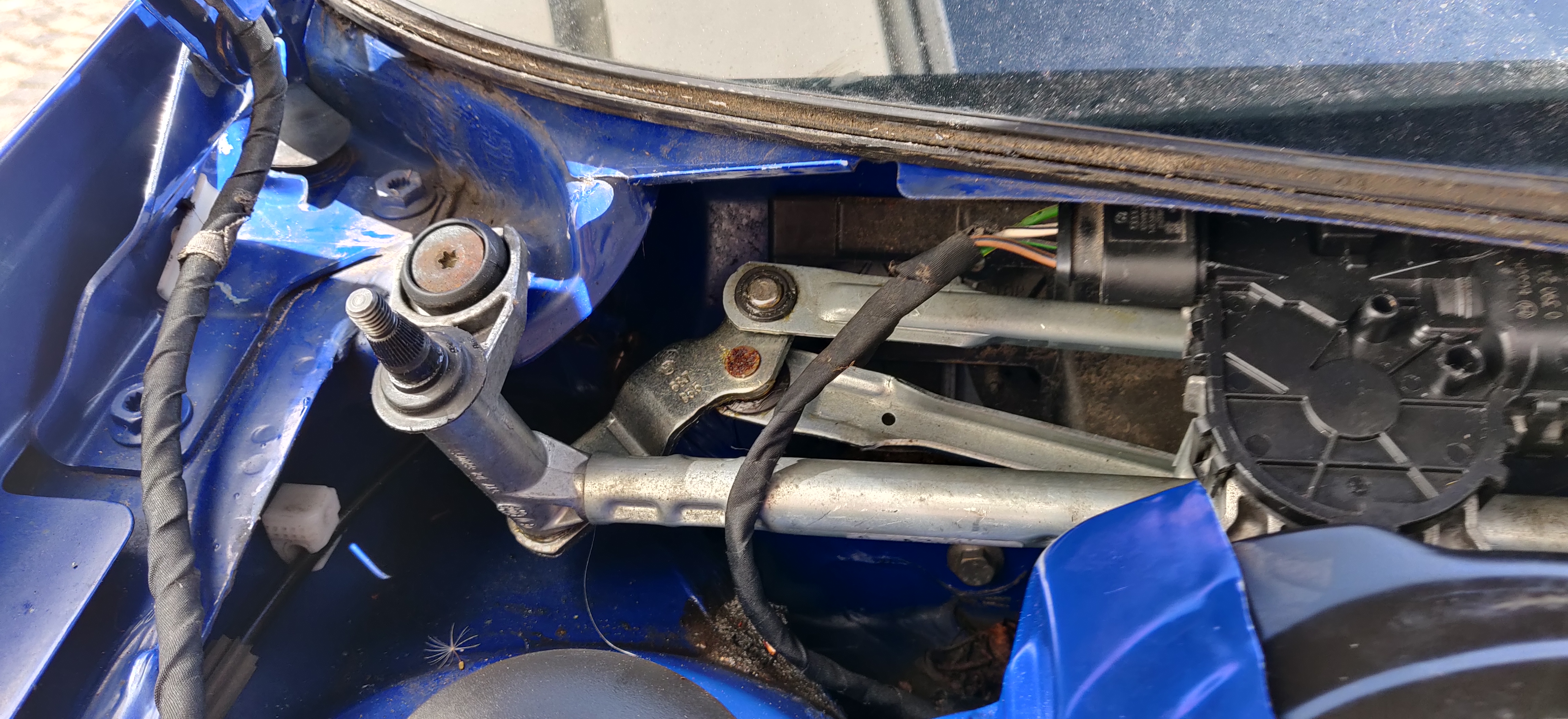

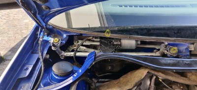

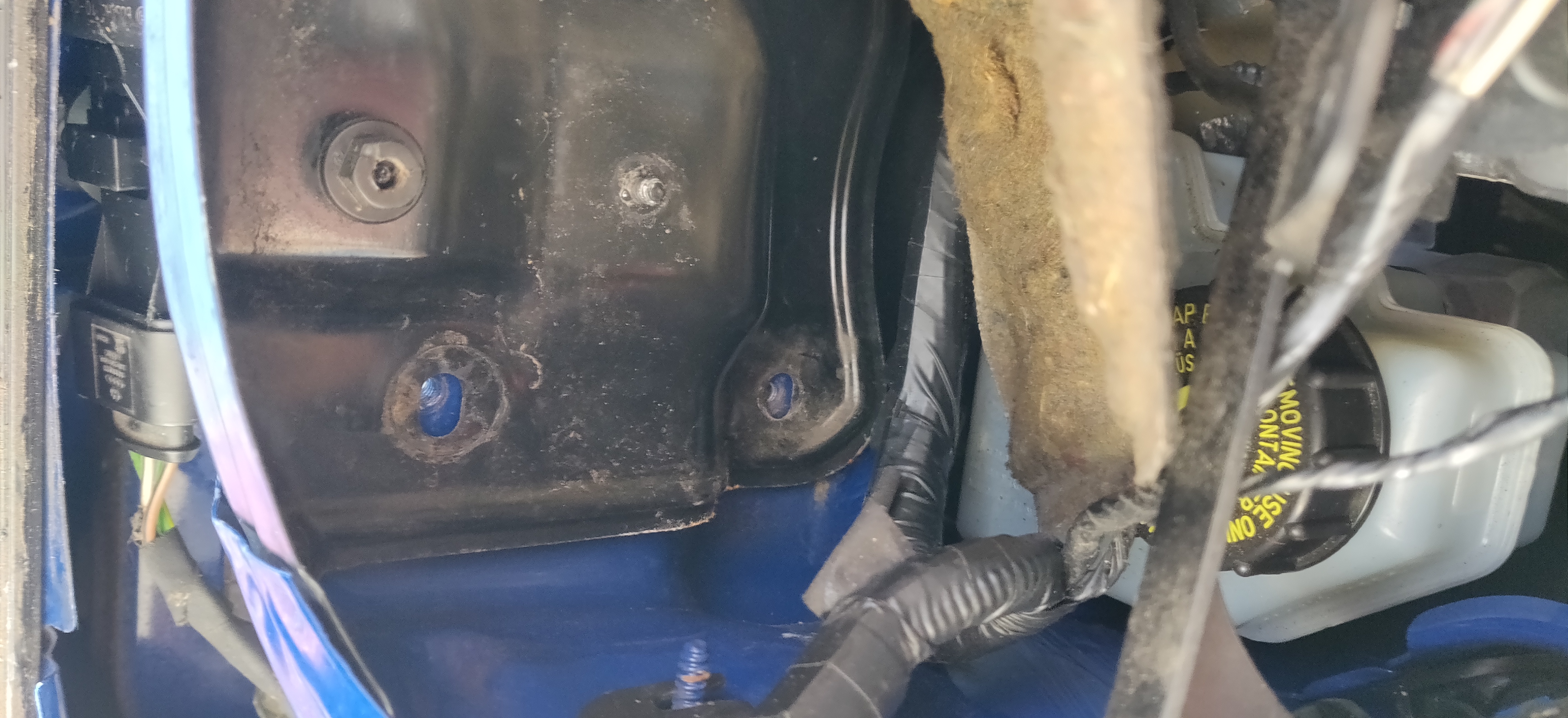

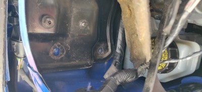

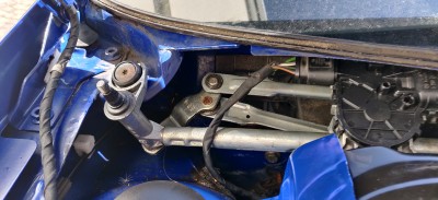

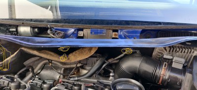

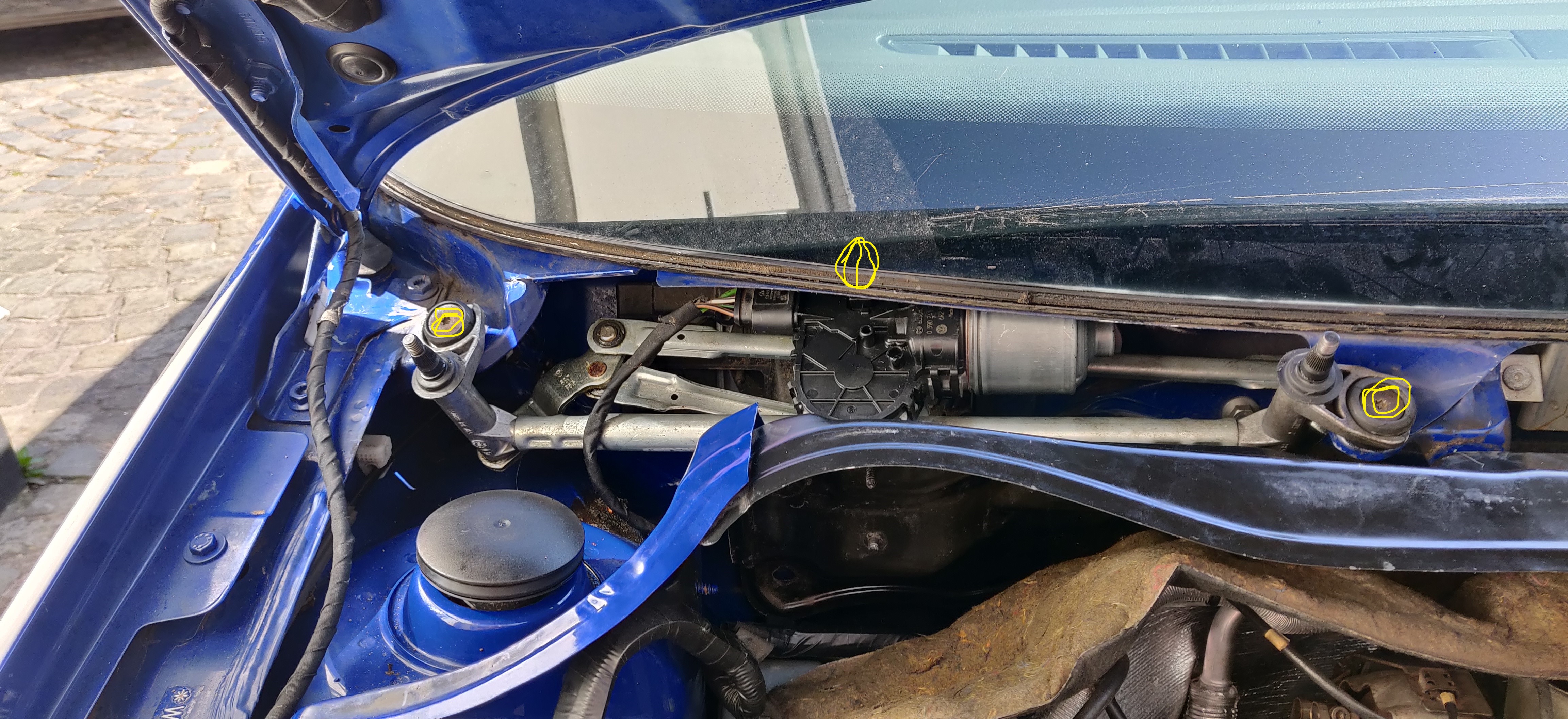

OK Finally managed to get this done today. Once finally managed to get the wiper arms off, process was this:
1) Remove foam rubber seal at front of the plenum cover, just pulls off easily

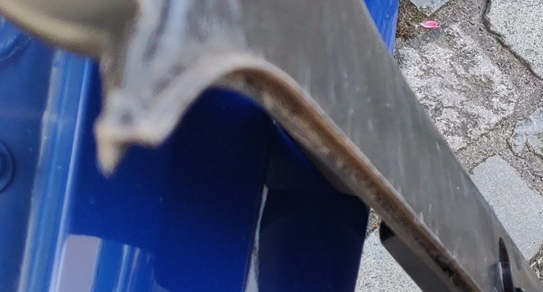

2) remove plenum cover this is secured at the back via a "tongue and groove" type fixing along the length of the cover, Start at one end from underneath and use something to push the cover up. I used a hammer shaft and then flat bat to lever it up. Was quite fiddly as theres not much room to the edge of the bonnet as it starts to seperate. Once you get the end seperated the rest is pretty easy. I Then cleaned the tongue and slot to make sure they would clip together again easily

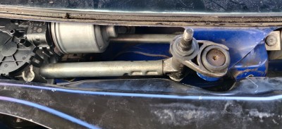

3) Remove the 2 star bolts holding the motor assembly in place and the electrical connection. You cannot remove the motor assembly straight away as its too close to the plenum bulkead so you need to create some extra space

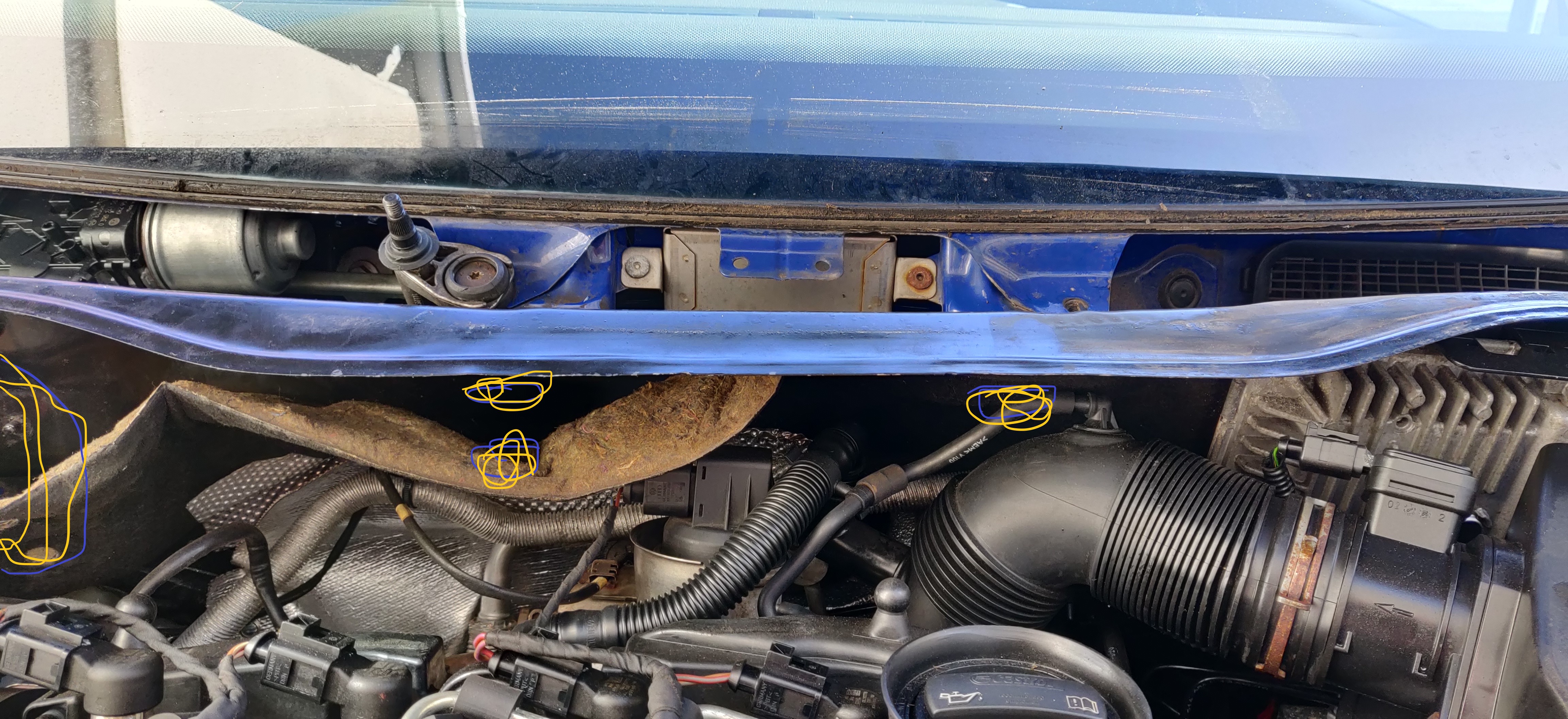

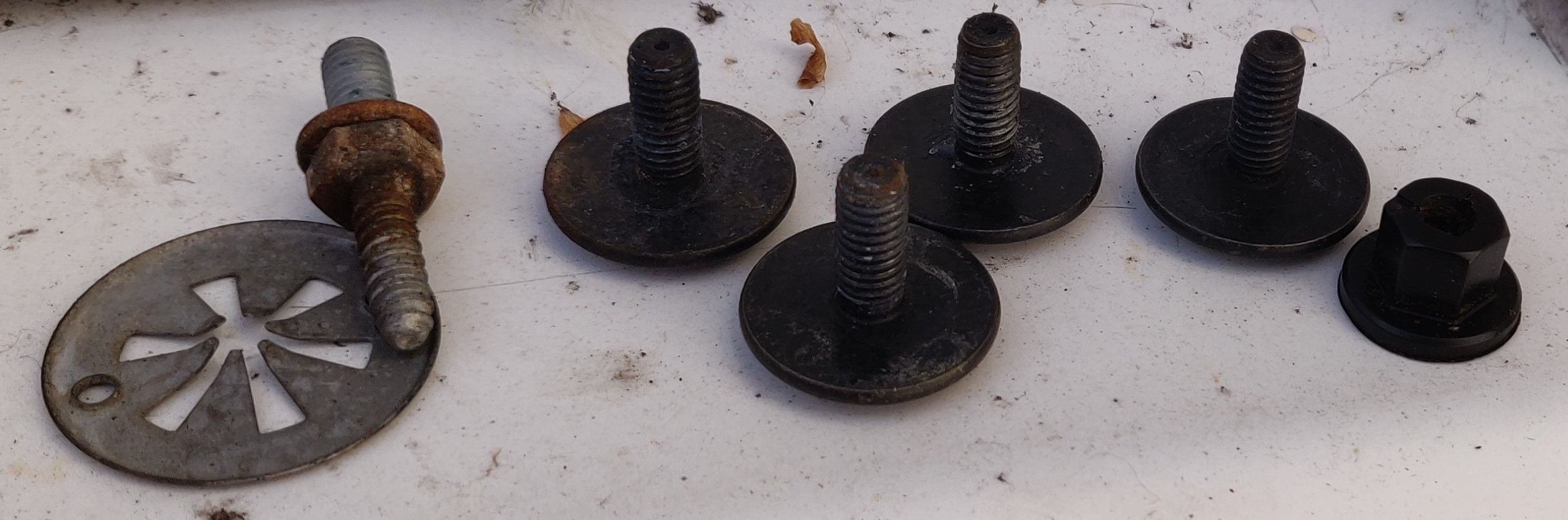

4) I didnt remove the whole bulkhead just worked my way from the left hand side (UK driver side). To get to the fixings you have to loosen the accoustic felt by removing to wide fixing, then there are some star bolts, a plastic nut that holds some electrics and a double ended bolt with 10mm nut in middle (see pic for what fixings I removed)

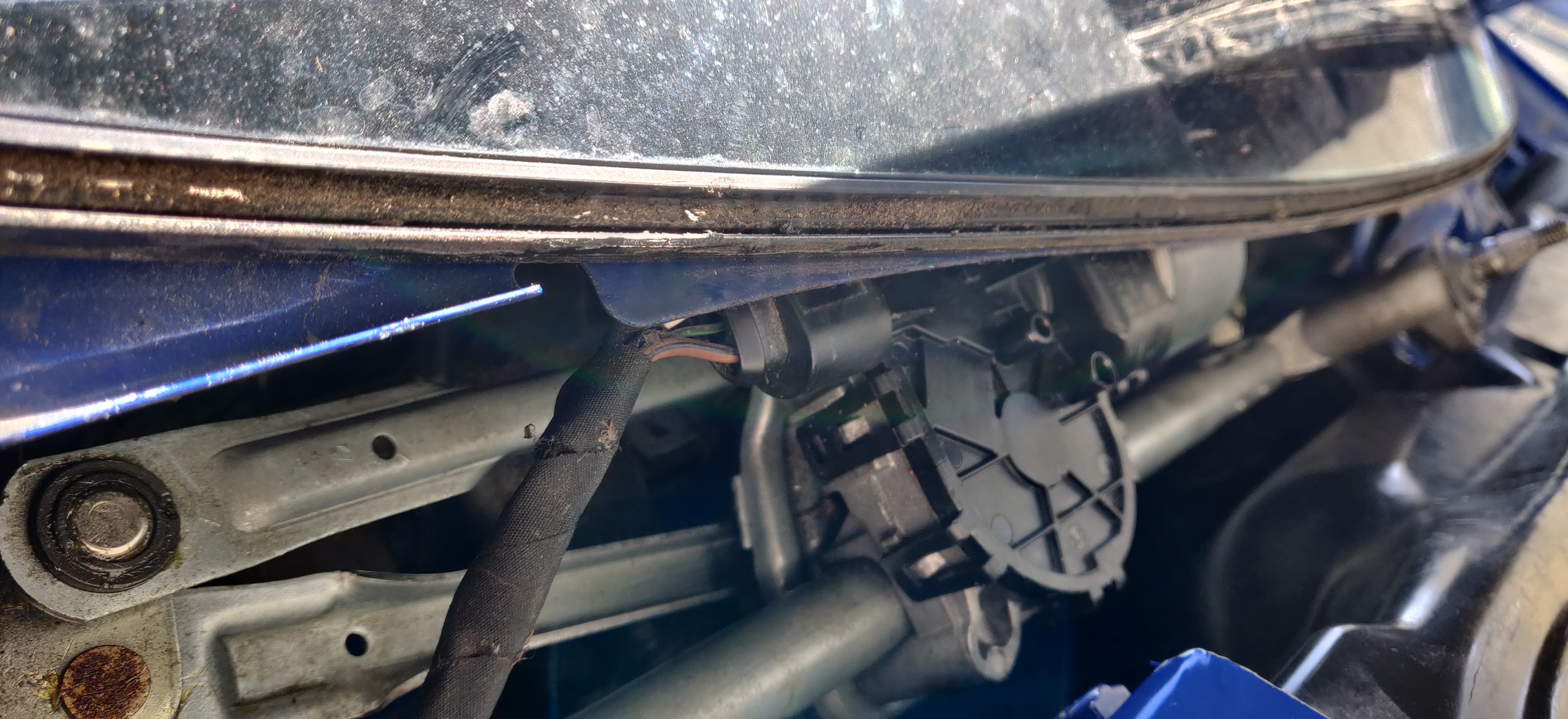

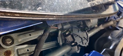

5) Pull bulkead forward and wriggle the motor assemble free, there's a location peg at the back as well.
6) Fit replacement motor assembly, bolts and electrical connection (TEST BEFORE GOING FURTHER)
7) Re-Fix bulkhead/felt
Fix plenum cover back in place and push foam front strip back in place
9) reattach wiper arms and align
Left hand rorating spindle on old motor assembly was really seized, impossible to move by hand, definately worth buying a 2nd hand spare (latest version "c") to have regreased and ready to fit
Some pics I took whilst doing it

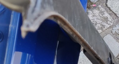

Lip on underside of Plenum Cover Locator groove for lip on underside of Plenum cover 2 Hex key bolts and location spike

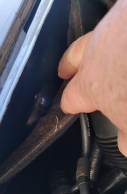

Pull felt forward once retainer and plastic nut removed Location of Bulkhead fixings I removed to allow it to be moved Left hand side of Belkhead with fixings removed Felt & Bolts removed from LHS of Bulkhead LHS motor assembly bolt RHS motor assembly bolt
