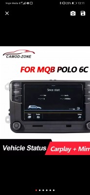

Hi guys..
An update on the radio :
Went ahead and bought an aftermarket radio from aliexpress (see pic) I disconnected everthing from the glove box head unit and connected to the new radio, everything works fine, only thing is the quadlock and fakra cables are too short to reach the dashboard location for the radio, so I've ordered extension cables for both, in the meantime I've connected everthing back up to the head unit but I'm left with a constant passenger air bag warning light on, thought I might have cleared it with an ODB 2 scanner but it's still there, other than go back to the garage to have it cleared its there any other way to clear it?
