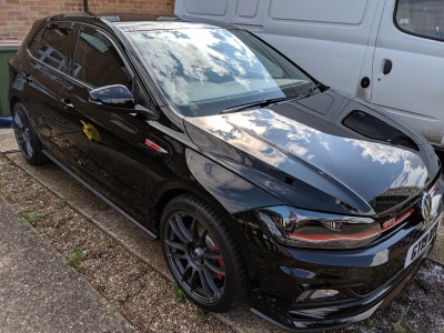

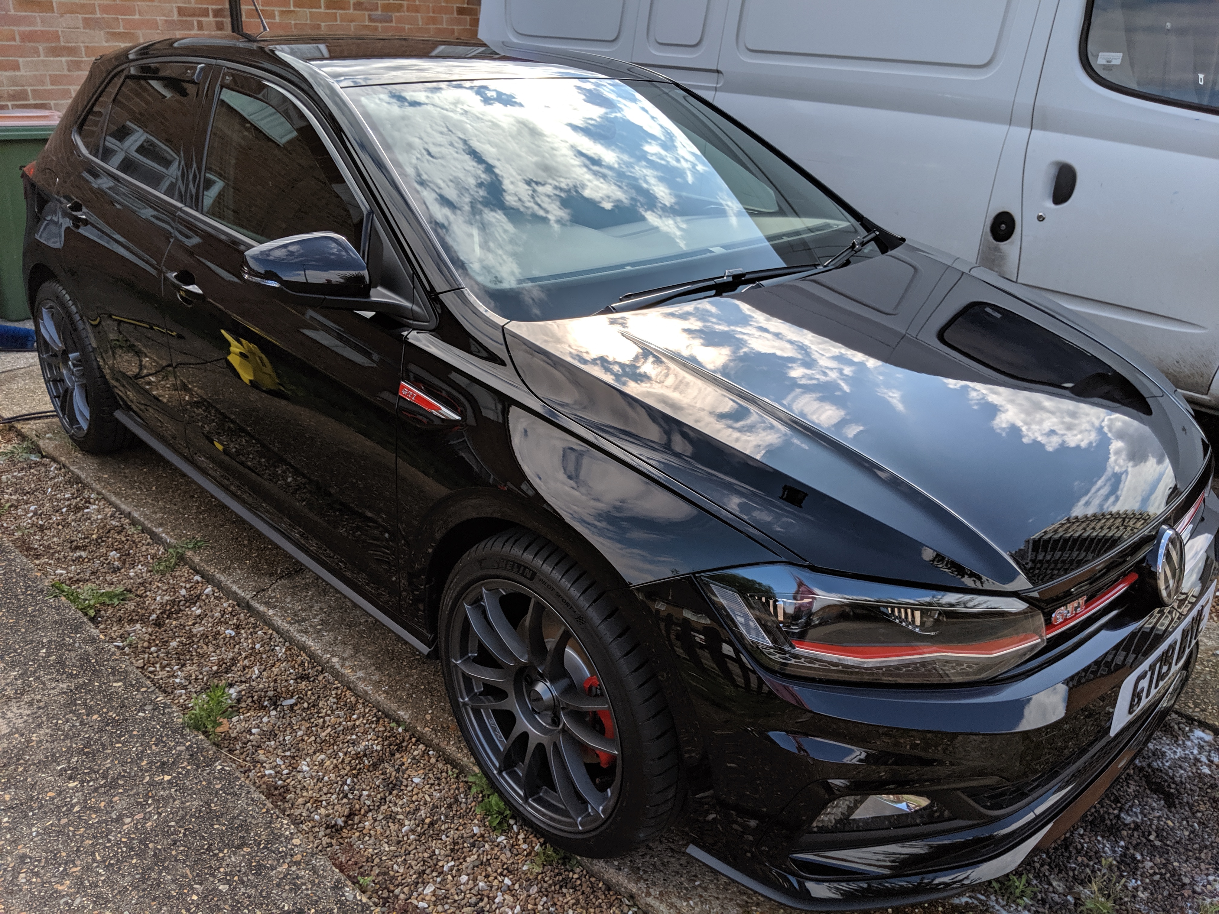

I got some new aftermarket wheels about 2 months onto ownership, that was going to be the plan all along and then I plan on selling my stock 17inch alloys when I get time. The new wheels were the exact same size as the old ones so can't really give you advice on how much it would interfere but I do know if the wheel size was all the same except the width being different at 8 instead of the stock 7.5 the alloy will be 6.3 closer to your suspension and have 6.3 more poke. You'll also need to consider your tyre choice if you want a wider alloy.
My recommendation is get some that are pretty much the same size as your currents unless you know someone who has an alloy you can test fit to double check.

Have you tried MyTyres as that is where I got my RC32 design alloys to the exact size as the stock alloys.The Random Dan wrote: Sun Aug 02, 2020 5:19 pm Tyre wise I’d have to go up to 225/40R18 as the rim would be slightly wider unless I go for the slightly ‘stretched’ tyre look and put my current 215/40R18 tyres on.
I just can’t seem to find an alloy I like the look of in 7.5j size, I don’t mind it sticking out a bit further as I’ve seen people running spacers on them and it looks good, just don’t want issues on the inside with wheels rubbing arches etc

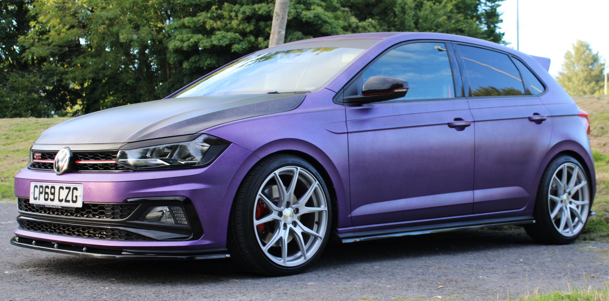

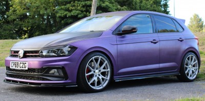

Bola b6 18" 8.0, lowered 35mm with no issues

What ET are those?RichTea wrote: Mon Aug 03, 2020 3:06 pm IMG_20200803_151129.jpgBola b6 18" 8.0, lowered 35mm with no issues

Not sure, ill check in the morning. The wheel sticks out of the arch around 1 - 2mmThe Random Dan wrote: Mon Aug 03, 2020 9:09 pmWhat ET are those?RichTea wrote: Mon Aug 03, 2020 3:06 pm IMG_20200803_151129.jpgBola b6 18" 8.0, lowered 35mm with no issues

18" Calibre Suzuka - Gunmetal 18 x 8.0" 5x100 ET45 with MPS4 225/40R18 tyres
Rears needed an additional 3mm spacer to clear inside alloy hub from brake calipers.
Because I waited so long for the car I had the wheels and tyres ready to fit since day one of car ownership.
