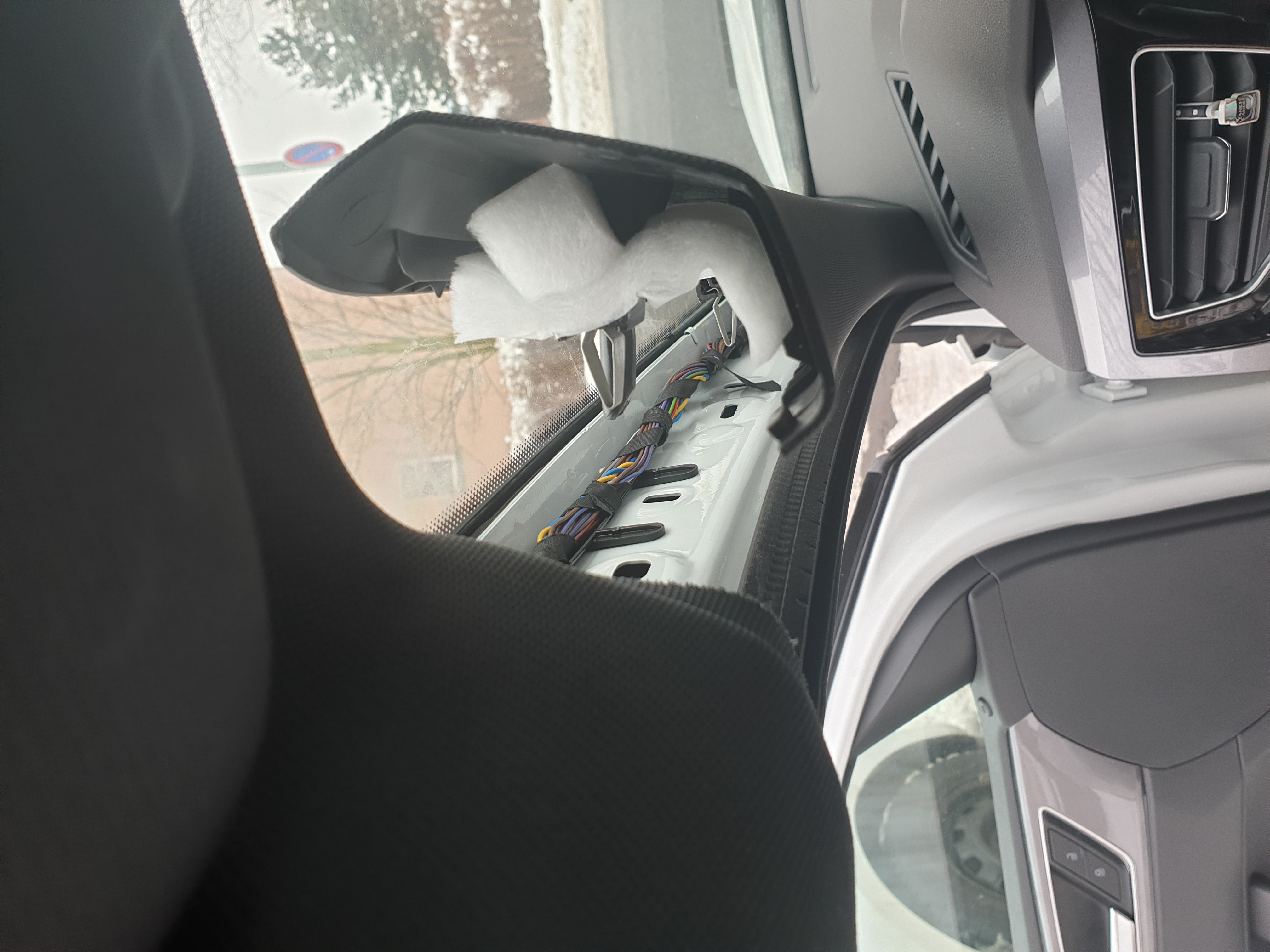

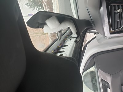

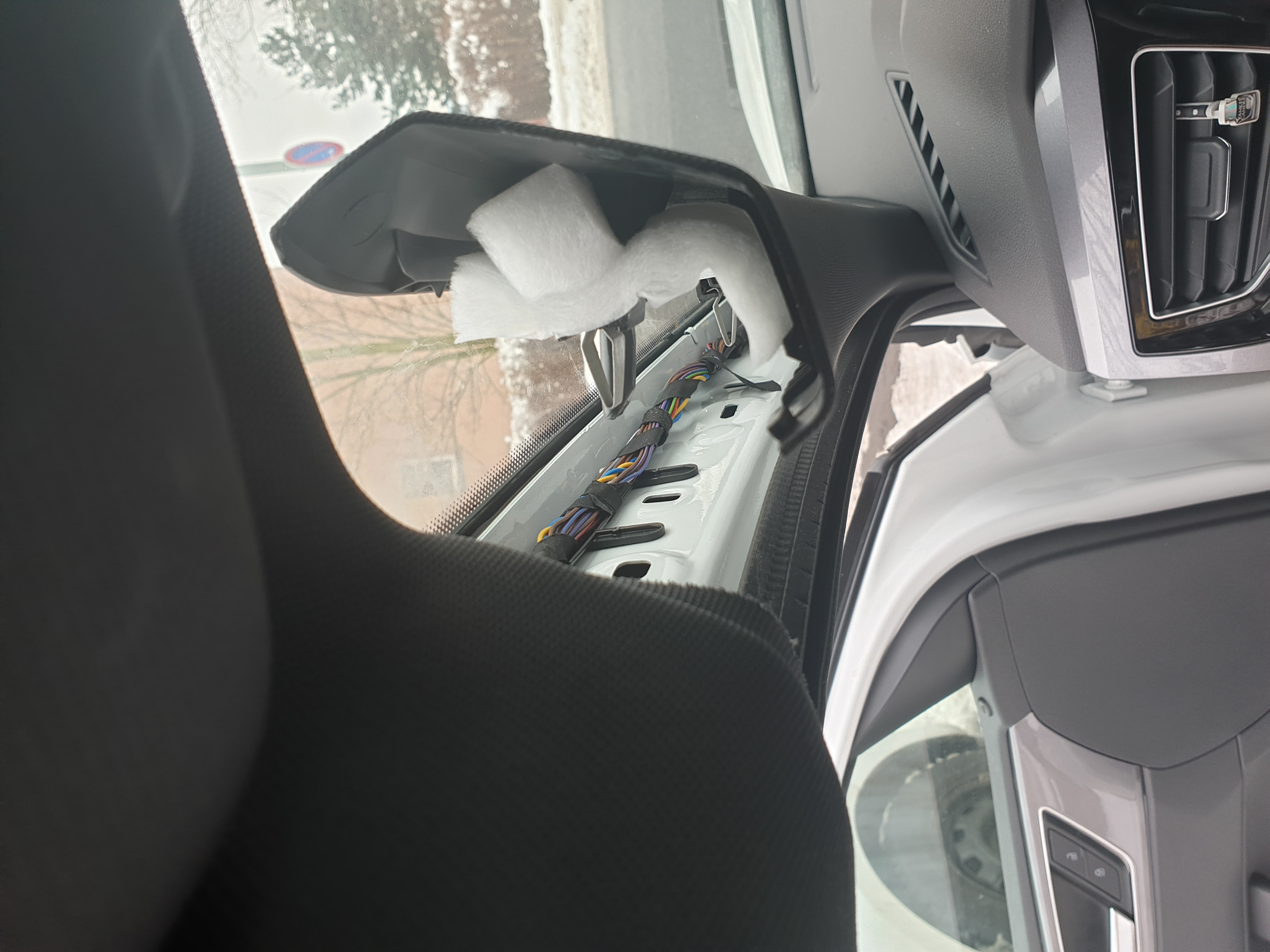

9: Tucked the cable in between the roof panel and windscreen. It does stay in place
10: I used the permanent sticky mount and got it behind the mirror. It has been pointed out the mirror will un-clip for better access. Cable wrapped around the mirror

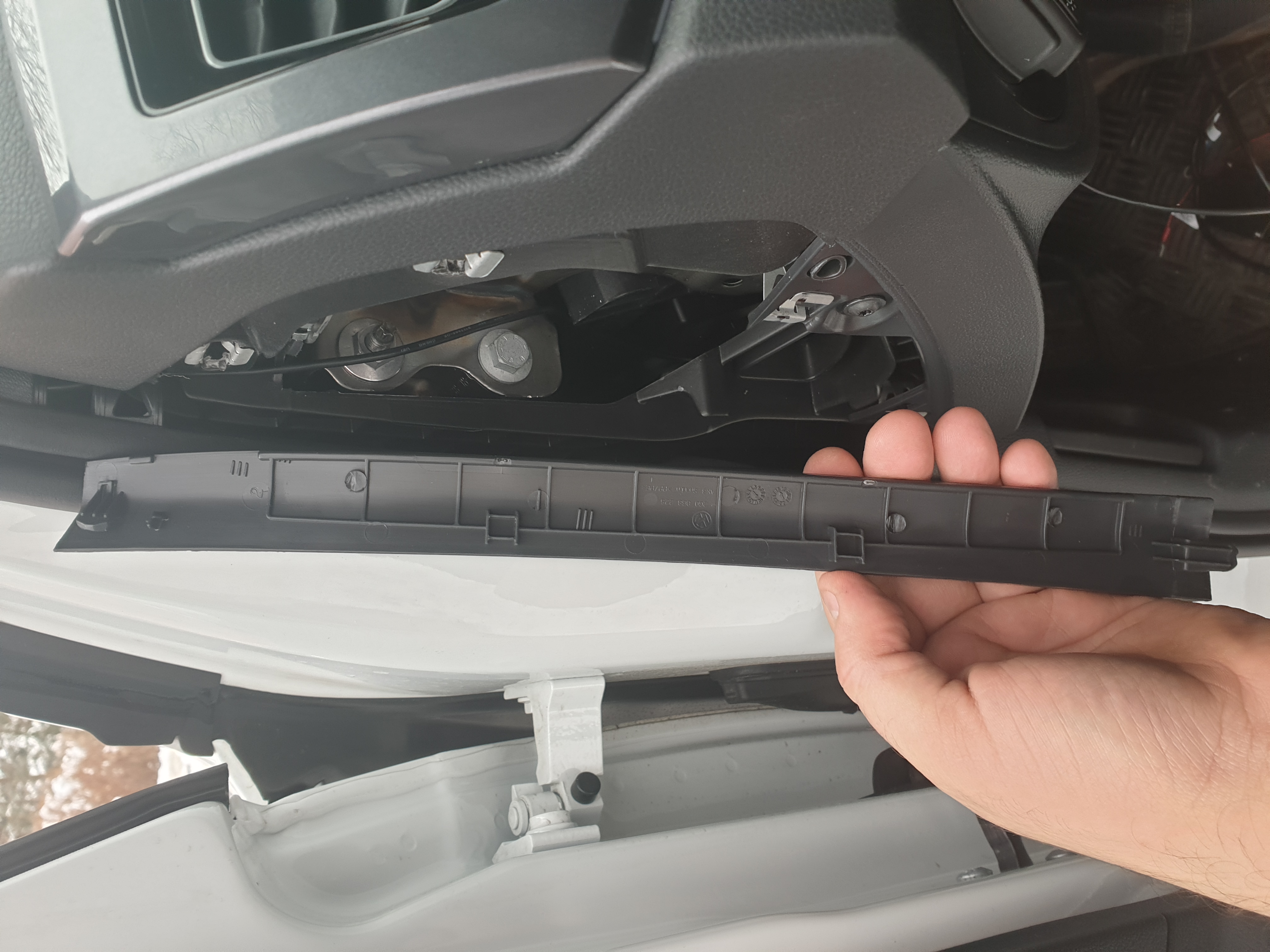

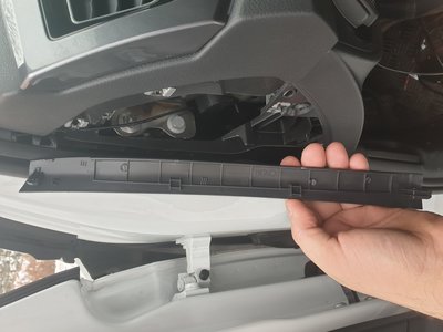

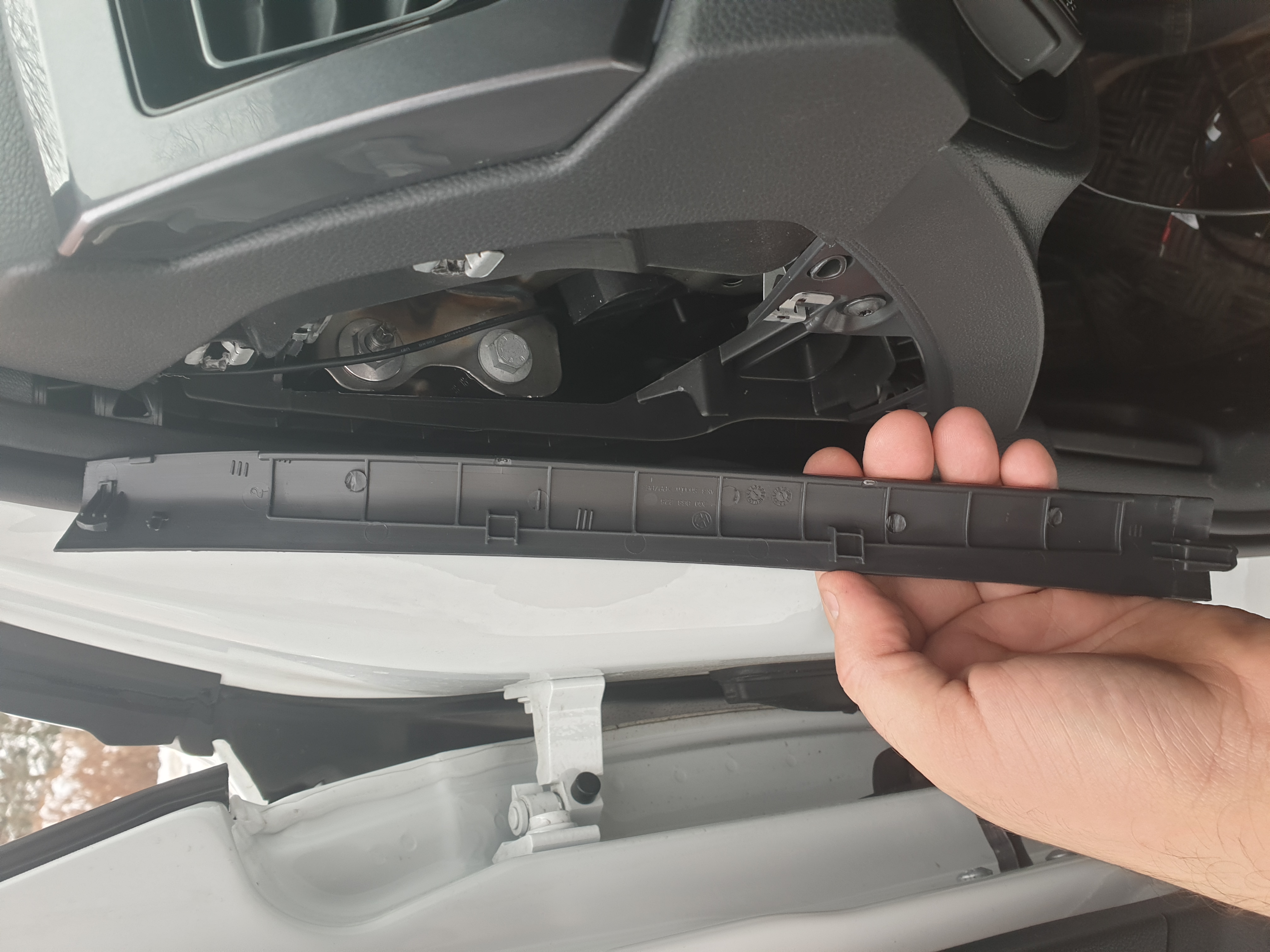

13: Panel popped off. Cable to go horizontal and pushed down behind clip
14: Cable in and behind panel. This was the hardest part clipping the panel back in. be patient, it'll go back in

I was wondering why you didn't tuck the wiring in from dashcam to the headlining before realising you don't have the auto dimming rear view mirror and the wiring cap and tube for it.
Step 14 seemed to be fiddly for you, it was one of the least fiddly for me - did your wiring sit directly behind the upper clip of the thin trim piece that sits beside the trim that caps the end of the dash? That would be fiddly to clip back. If you take the wiring along the rubber seal and then go in from further down the trim length (after untucking the rubber seal lip) it clips in and out easy enough. Then the rubber lip is overlapped again.

monkeyhanger wrote: Sat Feb 02, 2019 11:20 am I was wondering why you didn't tuck the wiring in from dashcam to the headlining before realising you don't have the auto dimming rear view mirror and the wiring cap and tube for it.
Ah yea, that would be why :roll:
The wiring ended up lower that the clip out of the way and then exited mid way down in to the opening. It was all trial and error. I found it hard keeping the bottom lip in whilst clipping it in at the top, a small space for a fiddly part
