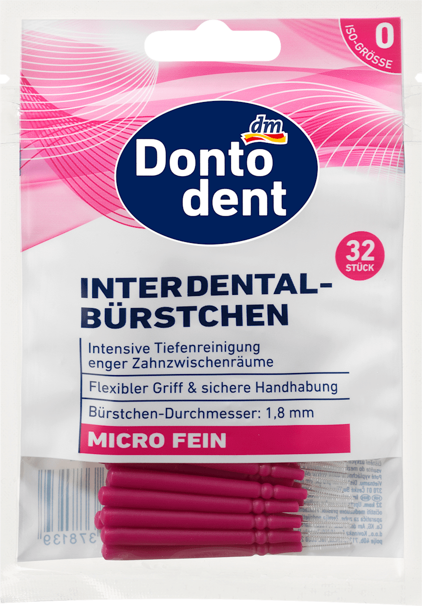

From some personal experience the connector often caused issues ( many vag models with age).
Maybe try removing neg battery lead, and clean the connector. ( I have found interdental teeth brushes to fit perfectly in various connectors and clean the without damaging)
You can find them in DM
Get the thinnest ones, + some contact cleaner. Let it dry then replug everything back
