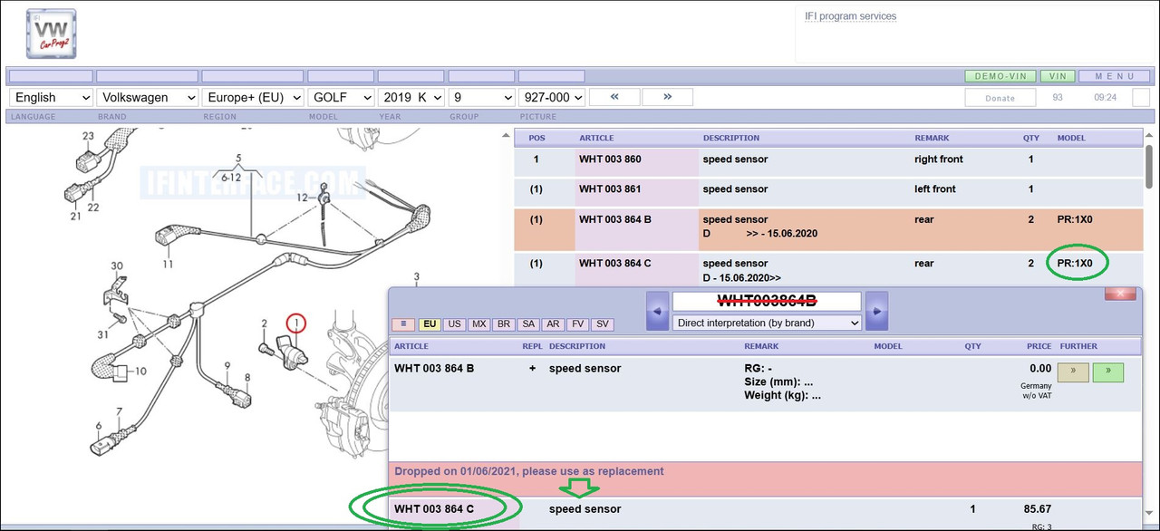

Since I'll be working on the rear axle sometime in the next few days :) , I'm going to replace the rear ABS speed sensors. It's something I've been thinking about and looked into for a while now.
The currently installed ones, version B, work perfectly for all the systems involved, but the new version C seems to be more accurate and effective.
Explanation from AI after some discussion :lol: and sharing my knowledge:
- Rear ABS Sensor Evolution MQB, etc... (1X0): WHT003864B vs WHT003864C (ETKA Supersession)
Quick technical breakdown regarding the evolution of the rear wheel speed sensors (ABS/ESC) for MQB platforms (etc.), specifically the supersession from version B to version C in ETKA.

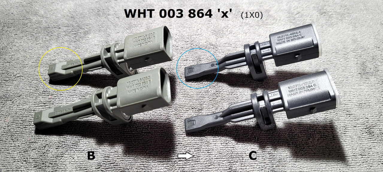

Even though ETKA states it is a direct replacement, there is a clear geometric redesign of the sensing tip: version B looks like a "golf club", while version C features a "cricket bat/paddle" shape.
Here is the engineering rationale behind this hardware revision:
1. Sensing Window Optimization (Active Hall-Effect)Version B ("Golf Club"): Focused the sensor element on a very narrow area. Highly sensitive to air gap fluctuations (distance between the sensor tip and the wheel hub's magnetic ring).Version C ("Cricket Bat"): Broadens the magnetic flux capture area. By widening the reading surface, the sensor becomes significantly more resilient to wheel bearing axial play or hub vibrations under heavy cornering/rough roads, preventing signal dropouts.
2. Electromagnetic Noise Immunity & Hysteresis. The internal circuitry of version C was upgraded to enhance magnetic noise filtering. Modern driver-assist features (ACC Stop&Go, Front Assist, Park Assist) demand an ultra-clean square wave signal. Version C minimizes signal "noise" that typically triggers intermittent dashboard Christmas trees.
3. Debris & Brake Dust Deflection. The flat, streamlined profile of the C-version tip alters the micro-airflow inside the hub cavity. This prevents brake dust (ferodo) and metallic rust flakes from accumulating on the sensor face—a common issue on the older B-version that caused sensor blindness over time.
🛠️ Installation Pro-Tips for Enthusiasts.
Compatibility: 100% Plug & Play. No coding or adaptation via VCDS/OBDeleven required.
Proper Fitment: Clean the knuckle bore thoroughly using a nylon brush and brake cleaner. NEVER use copper grease (suspended metal particles will magnetize, attracting debris and disrupting the Hall-effect readings). Install it completely dry or apply a micro-layer of 100% metal-free/dielectric ceramic grease only on the plastic body to prevent galvanic corrosion and future seizing inside the knuckle.
