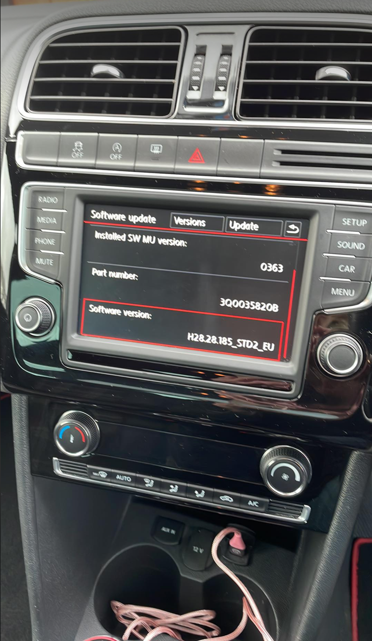

stevewb
Posts: 3
Joined: Tue Feb 22, 2022 10:21 pm
Drives: polo gti 6c 2017 (67)
Location: wolverhampton
Re: App Connect
Post by stevewb »
sorry for the thread revival, I've just bought a gti on 67 plate and I'm a bit disappointed it doesn't have app connect, been told by vw retrofit I need the headhunt changed at a cost of £400 , :idea:
Sabs
Posts: 10
Joined: Fri Dec 18, 2020 6:22 pm
Drives: 2015 90hp 1,2L TSI comfortline BMT 6C
Location: Copenhagen
Re: App Connect
Post by Sabs »
I got similar news. Also would have to change the glove box because that’s where the newer head unit lives and the other is just a screen. Also found out that there’s a 50/50 chance that if you get a head unit out of a junkyard car you might not be able to override the anti theft device inside and it’s hard to know which one you get since there’s two oem suppliers. Better off buying a new phone than upgrading the unit. It has Bluetooth anyway so you can hear the voice through the car speakers.
