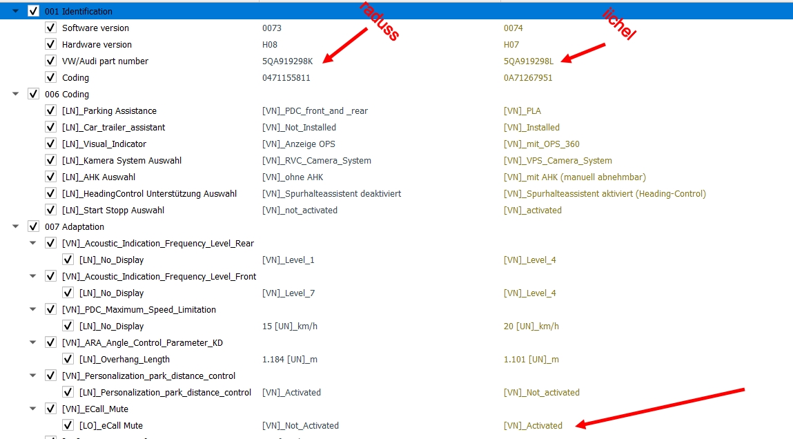

I compared mine and yours with coding + adaptations. Only I don't have PLA 3.0 activated yet because there was no time to install additional sensors, but I already have the module installed just activated under eight sensors
Zrzut ekranu 01-12-2023 20.40.59.jpg (284.37 KiB) Viewed 10980 times

That's a really cool comparison. Is that a publicly available tool or one you made yourself?

ODIS-Explorer

patil wrote: Fri Dec 01, 2023 5:24 pm Image
Check this adaptation channel in address 76 in ODIS-E. It shouldn't be active in your case. In VCDS adaptations list of address 10, this adaptation channel is not there! :shock:
Let's restore back the reputation of VCDS. :mrgreen:
The adaptation is there albeit with confusing label. ODIS adaptation is more clear though.
