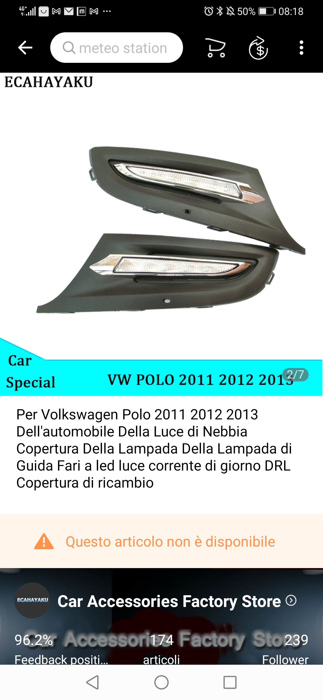

Hi guys I would like to buy the drl in the pictures below. Is there someone that can help me to find it? (I can't find on aliexpress)
- Screenshot_20210224_081847_com.alibaba.aliexpresshd.jpg (590.41 KiB) Viewed 1530 times
