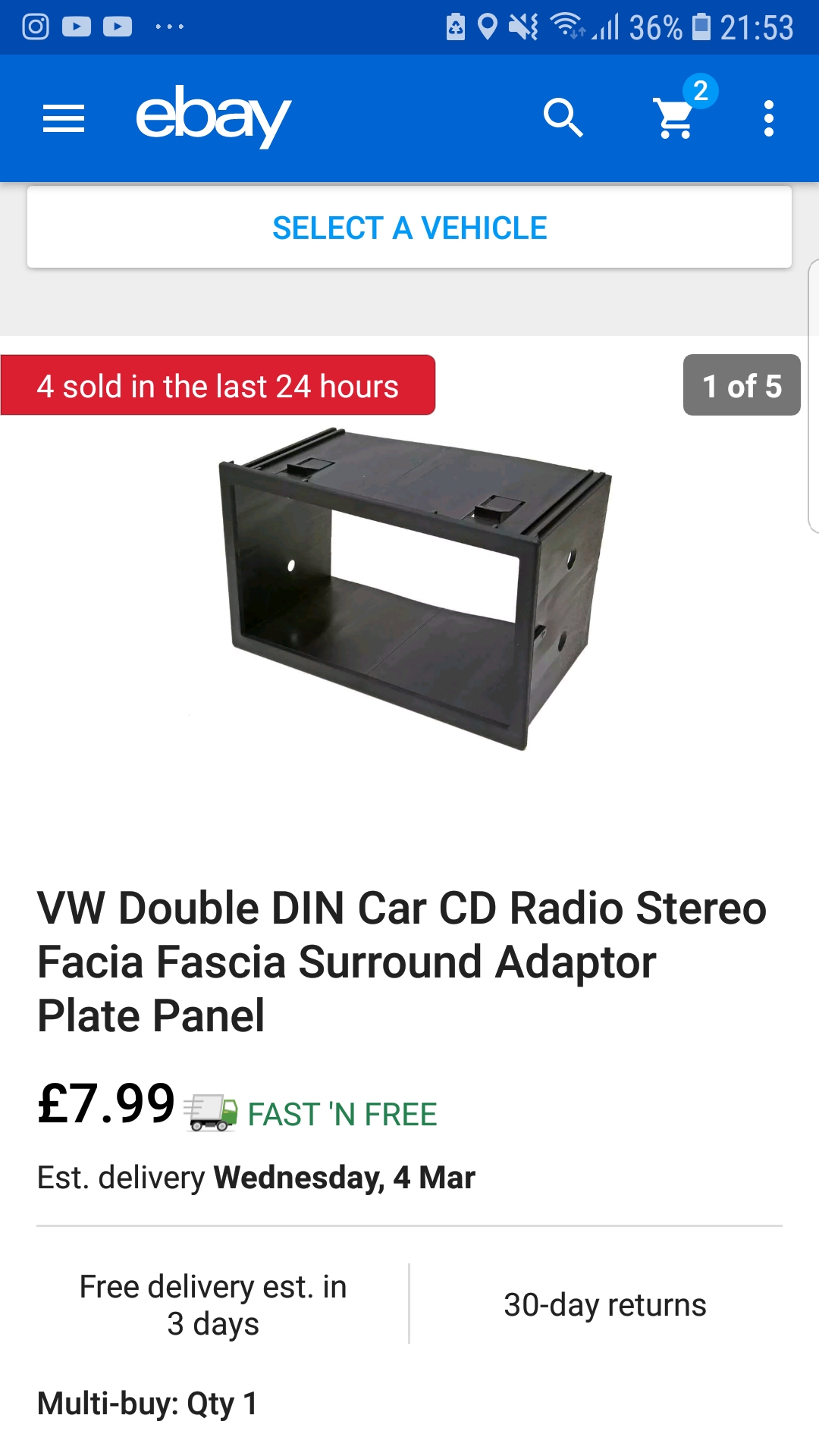

Hi guys so this is what I want my stereo as I'm replacing the factory to an after market single din. What case would I need to fit the single din stereo. As I've been hunting for and getting no where or not finding the right shape. Anyone know?bvs wrote: Thu Mar 22, 2018 12:21 pm We have an old Sony explode in our 9n,with a handy little cubby underneath
I cannot remember if I bought online or just popped into Halfords for it.
Honest M'lud - I did not do most of the damage on the dash - well it is an 02 car LOL
- alexperkins
- Site Admin
- Posts: 14873
Re: After market radio
Nothing additional. You already have the shelf
It’s just a standard single din radio you need and the appropriate lo adapter if necessary
If you don’t have the shelf you just need a universal single din shelf from eBay or amazon

I have the original double din stereo which I'm trying to convert to the single din. Just need to find the correct case to fit in but I can't find it anywhere. Or one that fits my cars model. Which one is the correct one?
- alexperkins
- Site Admin
- Posts: 14873
As I’ve said above, you need a universal single din pocket to fill the void then the cage for the new radio will just fit. Nothing specific to the car is needed apart from the pocket the radio and the loom adapter
All you need is this
https://rover.ebay.com/rover/0/0/0?mpre ... 1852608370
The opening is a standard DIN size so doesn’t need converting for the radio itself
