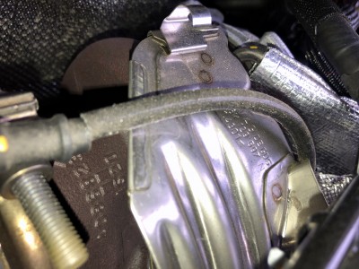

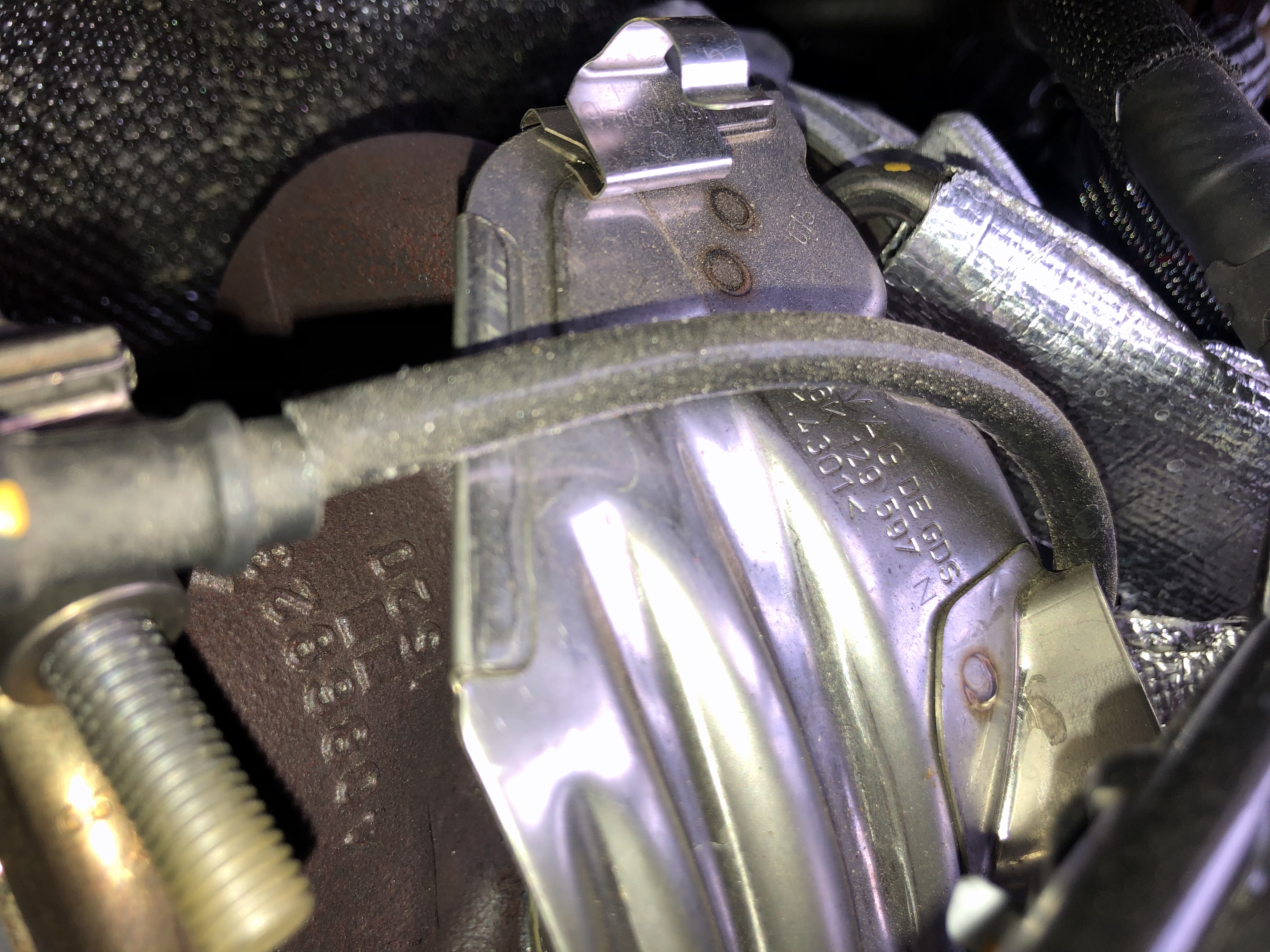

jylydesign wrote: Sun Feb 17, 2019 12:02 pm It's an IS20.
Sent from my SM-A530F using Tapatalk
No. Turbo is Continental raax.
https://youtu.be/lKPLqNUZWog

Hauki wrote: Mon Mar 04, 2019 10:55 pm
where did you find this information? Indications show it's a very good efficient design. Have been trying to research as much info as i can on the EA8883b and turbo so i know (once my warranty is up) what mods i can do (intercooler exhaust etc) to get some more power out

I reckon I can confirm that the turbo installed is not a Continental raax, but as we originally established that it’s the IS20.
Re: GTI engine specs
fazzy wrote: Fri Aug 02, 2019 5:38 pm I reckon I can confirm that the turbo installed is not a Continental raax, but as we originally established that it’s the IS20.
Just checked my 2018 pre-WLTP GTI+ and it's also got an IS20. Couldn't tell you what the new one has as the wife left it at work today to embark on a cocktail making "team building" exercise in an expensive Newcastle bar - my company wouldn't even buy me a lemonade!
