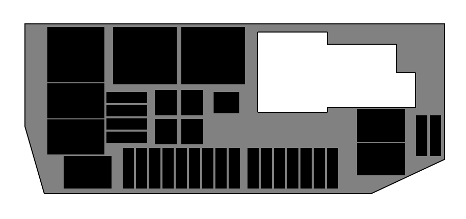

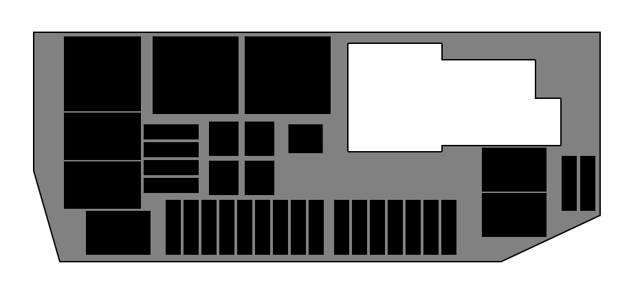

You should've bumped earlier, I meant to get you these but forgot all about it.
I have been fitting a dashcam today and have done everything but tap into the fuses (routing and hiding cables between front and back camera, trim removal and replacement) in the fusebox because the manual is so woeful. It only identifies a handful of fuses in the interior fusebox, and almost all of them are ones I don't have. 5 min job once I figure out which fuse to tap for the permanent live and which to tap for the ignition live. To complicate things, the manufacturer states that the yellow positive is the permanent live and the red the switched, but actually they do either way and I can't remember which way mine is! The fusebox entry is woeful - it is a nice size for a hand, which means there is no room to see what you're doing, and the fuses are so close together, you need needle nosed pliers to get them out.
Your attached list should help identify fuses I have.
I haven't go a pic of the battery fusebox as there is a ton of stuff in the boot right now.
Interior fusebox:-
Bonnet fusebox:-
Interior fusebox:-
Bonnet fusebox:-

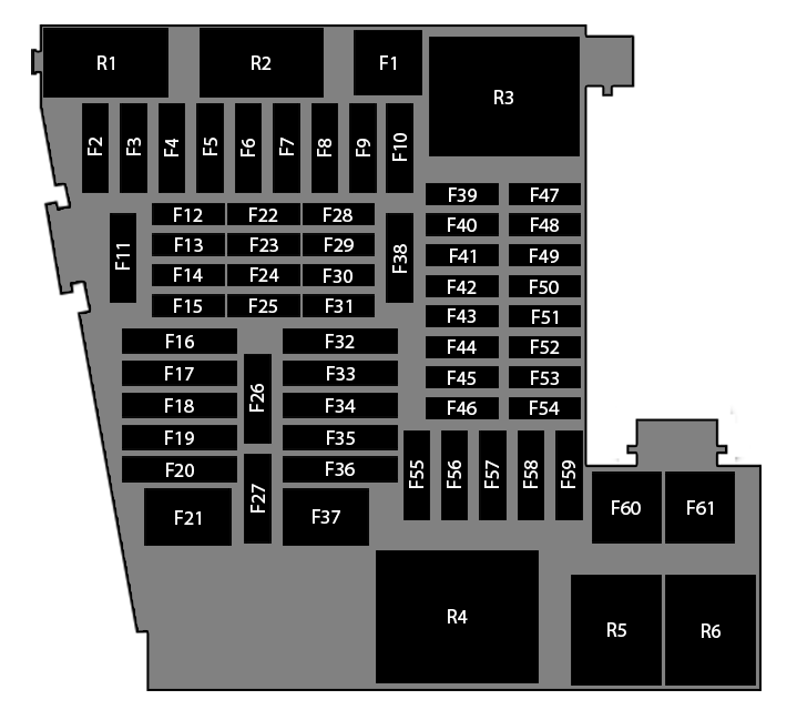

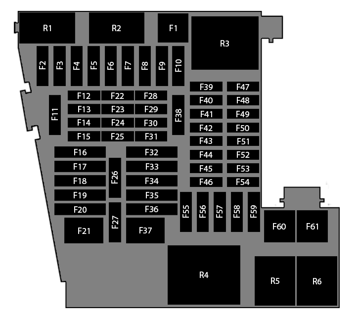

How about this:
The diagram in the manual:-
It's not that i'm missing so many fuses, its that I only have full size fuse taps to hand.
Hopefully among the following, I have enough to pick from that cover one switched and one permanent live rather than getting a mini tap or 2.
Full size fuses I have: F6, F16, F17, F18, F19, F20, F27, F28, F33, F35, F36, F38, F55, F56, F59. Can you identify all of these for purpose?
]The diagram in the manual:-

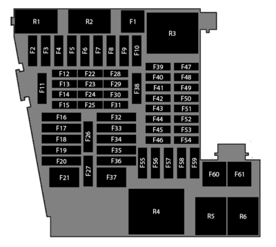

Hi I made this from photos posted by monkeyhanger. If anybody know labels for fuses in engine compartmen let me know
