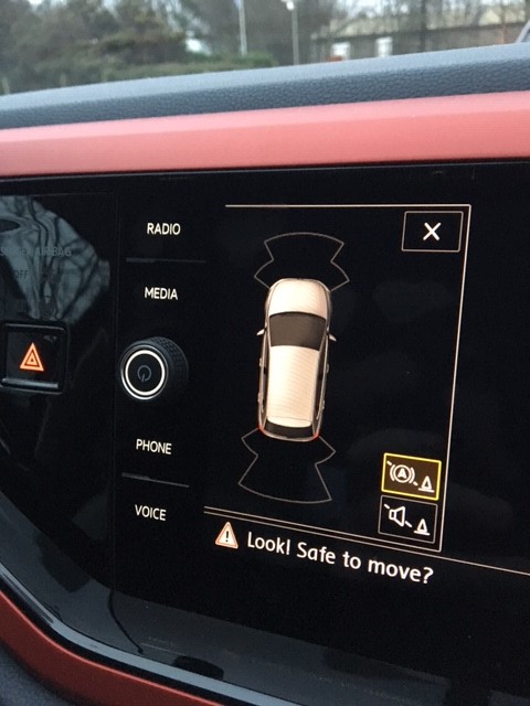

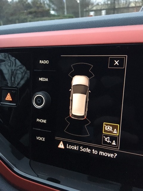

The front and rear beepers and screen display definitely DO trigger for people walking close to the car.RUM4MO wrote: Fri Mar 01, 2019 9:12 am Here is what should be an easy test/check as to if the parking controller is always active:- start car up when initially well away from obstacles - then either get out and walk round it near enough the front and rear bumpers to trigger the sensor alarms or get someone to do that for you while you remain in the car - if the OPS warns that there is an obstacle then they are always active, if not then I am wrong wrt the AW Polo.
I've had it happen loads of times when sitting waiting to pick up the kids from classes and people are milling around.
Here's a photo of mine triggering last night in traffic for absolutely no apparent reason.
If I were too close to the car in front, or the car behind were too close, I'd have expected the 'zones' in the display to show this.
But, as you can see, nothing in the zones to suggest there's a hazard...
Anyone care to hazard any guess as to why it triggered......

Don’t know if this is true or not, but I seem to remember reading somewhere that if a vehicle in front of / behind your car has parking sensors, the signal given off by their sensors can sometimes trigger yours. I’ve had my front sensors triggered in stop-go traffic and I’ve not been close enough to the vehicle in front to set them off. I didn’t notice whether or not it had rear parking sensors though.
My rear sensors sometimes beep after I’ve reversed out of my garage, and I’ve put the car into neutral / handbrake on while I get out of the car to close the garage door. There’s nothing behind the car or ‘within range’ to trigger the rear sensors though, it doesn’t happen every time and it doesn’t bother me.
