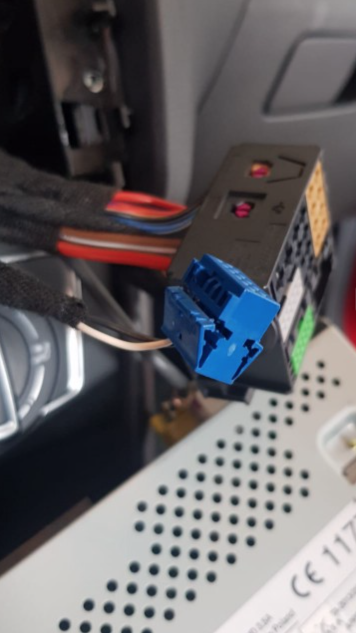

Dink wrote: Tue May 07, 2019 6:04 pm The brains are in the glovebox the display is just that.
I'm not sure from your post but did you connect it to the brains or the screen?
Ho Hum. My immediate reaction when I removed the screen was ... problem. I had expected a large infotainment module. I was certain I was on a road to nowhere, but the instructions said " clear wire to pin 6, Black wire to pin 12" on 12 pin connector. As there were empty pins 6 & 12 on a 12 pin connector that's where I went. Clearly now wrong.
But in hindsight (the only other word of instruction) are Radio/Navi Quadlock Green 12 pin connector So clearly I am in the wrong place.
I will revisit in the morning, But I wonder will this be OK. Does it sense the camera signal, or will I still have a coding problem?
Apologies for the errors, just totally new to the polo. feeling my way around..

You don't have to apologise for anything.
the main problem is the the 6r and 6c are both technically the same but the biggest change is the electrics, so instructions for 6r don't get changed to actually suit the 6c.
i'm pretty sure that once you plug it into the brains in the glove box it should work fine

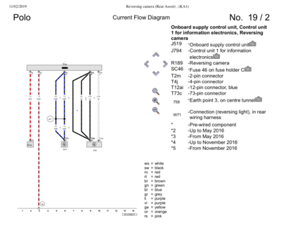

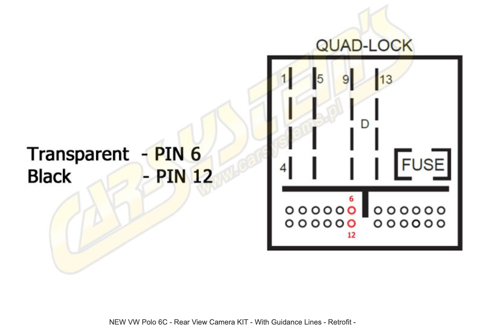

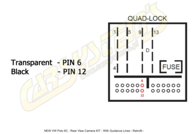

Hi fifty plus I was looking at a couple of sites that sell the rvc camera system and found these 2 images:

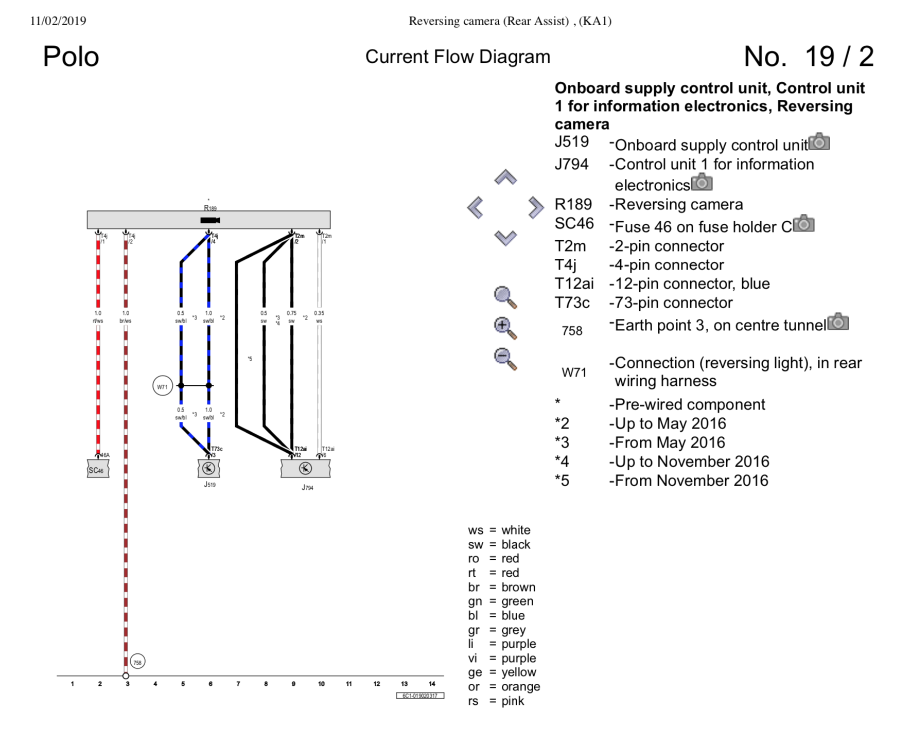

Also this is schematics for my rvc fitting guide:
So correct me if I am wrong but are the transparent and black cable, that are added to pin 6 and 12 respectively, suppose to go to the blue connector and not the green one?

massimo23 wrote: Tue May 14, 2019 11:36 pm So correct me if I am wrong but are the transparent and black cable, that are added to pin 6 and 12 respectively, suppose to go to the blue connector and not the green one?
Huge thanks. I have been busy so did not get back to this. I will revisit tomorrow.
I checked the "instructions" from VAG-tec. Definitely says green... :x
Thanks Again

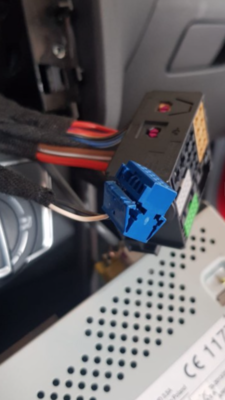

Re: Retrofitting Reverse Camera to 2016 Polo 6c Match
Posted: Tue May 21, 2019 3:02 pm
by FiftyPlus
Still no joy, getting a bit baffled at this stage
I had another look at this and revised the connection to the blue connector, pins 6&12 (thanks for that correction). I will post a photo later.
I was certain I had found my error: as well as the incorrect instructions that shipped with the camera I have ( it said to connect to pins 6 & 12 on the GREEN connector), I had been cheating by not digging out the reversing light wire to connect to the yellow wire and just connection to +12 to test, but suggestions are this causes a timing error and causes the "Park Assist unavailable" error that others have mentioned.
I planed to prove function before pulling off the bumper.
So now I have everything connected correctly ( pins 6 (transparent) & 12(black) on Blue connector, Brown to gnd, Red to +12 & yellow to reversing light.
VCDS coded on Steer/Park to "RVC fitted" and also on 5f infotainment to RVC fitted.
I have seen several references to this coding and it appears to be all that is needed.
But still no joy. When I re-coded and put into reverse, I got the correct revised screen layout, but no image: black space where an RVC image should be. Then I realised the hatch was not shut, so closed it fully, in case it expected that closed. Unfortunately it then reverted to the "Park Assist not available" message. I coded, uncoded, checked wiring multiple times, but no progress.
I am beginning to think I have a dodgy camera. I am suspicious of Vag-tec as while the website is lovely, I think it's a chap in Poland in a shed. (nothing wrong with that, but this chap does not reply to email...)
Thanks All!!
