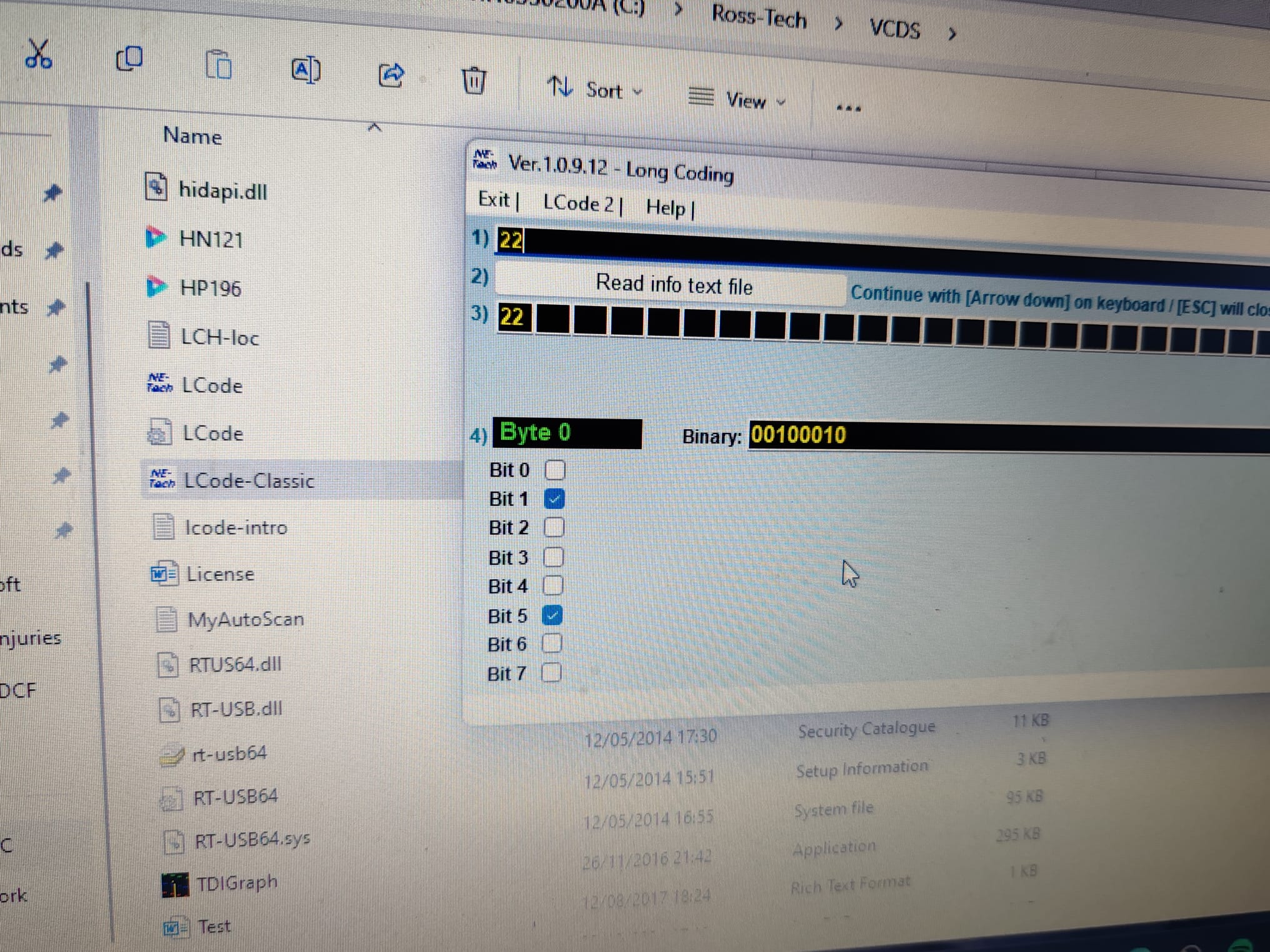

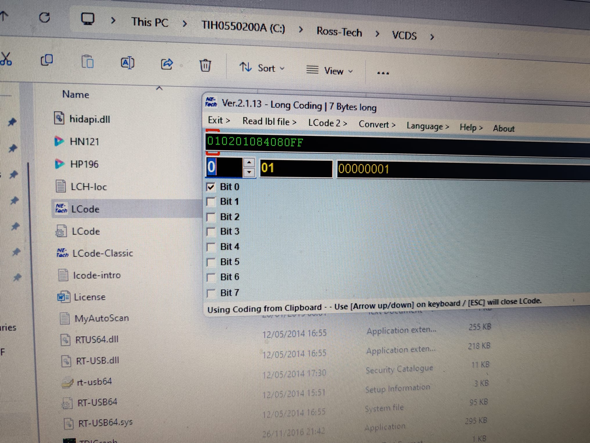

Re: Headlight problems, dip &full beam not working together,
Posted: Wed Nov 06, 2024 4:46 pm
by Heathcliff
These make any sense ciclo?

Posted: Wed Nov 06, 2024 5:52 pm
by ciclo
Those are the Ne-tech applications that are inside the ross-tech program and they make sense as long as you know how to use them. Better LCode than LCode-Classic.

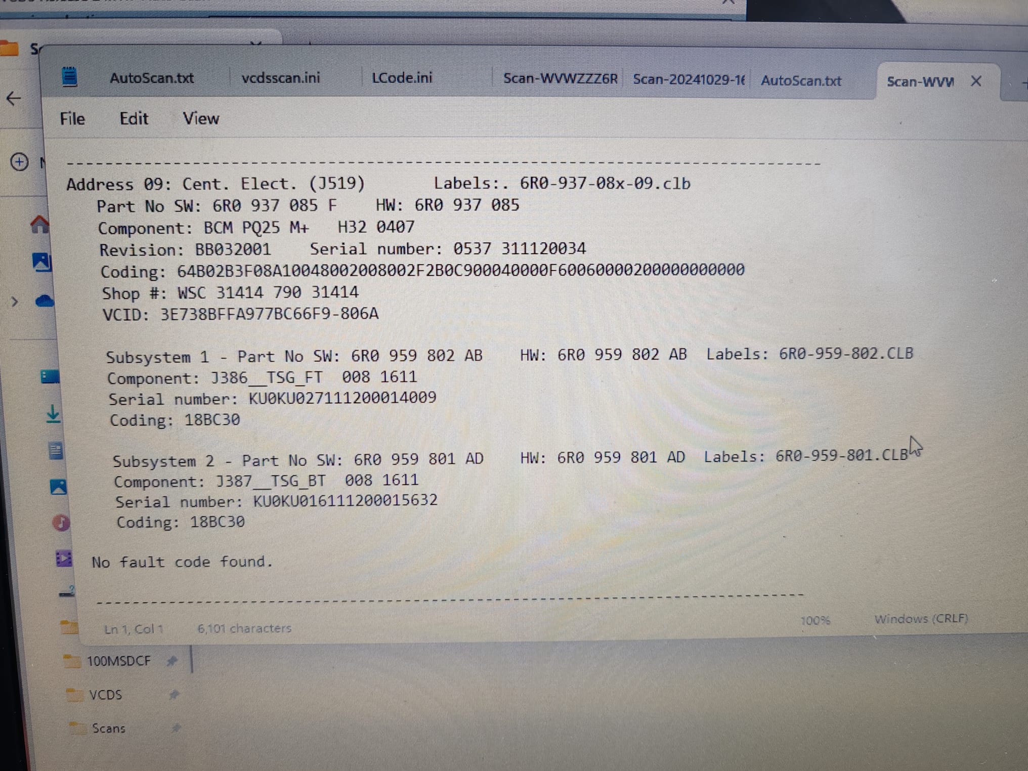

Posted: Fri Nov 15, 2024 1:51 pm
by Heathcliff
WhatsApp Image 2024-11-15 at 13.47.26_efc7affb.jpg (556.16 KiB) Viewed 2122 times

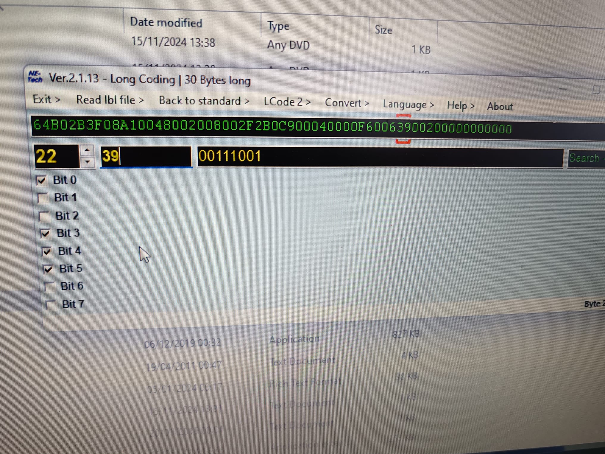

Posted: Fri Nov 15, 2024 1:52 pm
by Heathcliff
WhatsApp Image 2024-11-15 at 13.47.26_8855f281.jpg (575.52 KiB) Viewed 2122 times
Posted: Fri Nov 15, 2024 1:56 pm
by Heathcliff
Hi ciclo,
I've worked out how to perfom an Autoscan! I've attached the coding and the bit in question looks correct? What is the problem or is it still something I'm doing wrong?
Thanks for you continued support.
Posted: Fri Nov 15, 2024 6:36 pm
by ciclo
Hi Heathcliff.
The problem is that your 6R's electrical configuration is not correct, which is something I already told you previously.
Please, let me explain, according to your BCM, your 6R is not a Bluemotion model with H4 or H7 headlights, which is the model on whose BCM this coding (Byte22 Bit2) can be performed/applied and for which this thread was started.
Fortunately, there is a simple solution based on the original diagrams to install H7 headlights on non-Bluemotion models with original factory H4 headlights.
Links to the solution:
-viewtopic.php?p=508917#p508917
-viewtopic.php?p=529863#p529863
...and some more posts that I can't find now but that are exactly the same.
Everything will work perfectly forever if you or a workshop does it correctly. It is a simple operation that requires some experience and tools.
Show the picture to the workshop if you order it.
