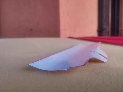

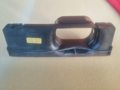

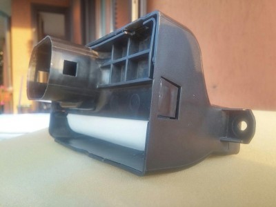

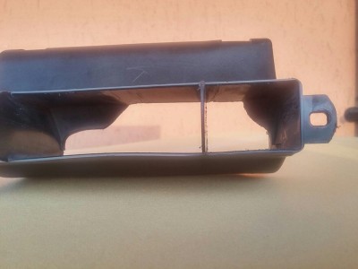

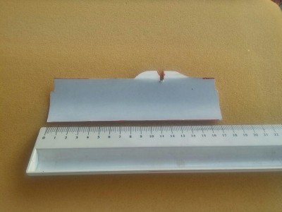

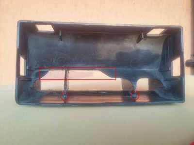

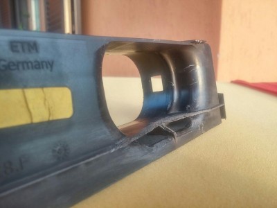

Yesterday I modified the intake with things I had at home, should work similarly to Jay-Jay one.
Only modified existing parts, and added a (not so) hard plastic conveyor (white paper template shown in pics)
finished assembly - the idea is to channel *fresh* outside air directly into intake hose without mixing with engine compartment *warm* air
trimmed areas to allow direct intake - note notched fins to keep the conveyor lip flush with the lower surface
view from straight in
conveyor paper template - note tabs to be placed into corresponding slots under the intake
conveyor paper template - note curvature<br />actual plastic piece was warmed to 60°C in water to better conform to shape
trimmed top mount - note two slots where conveyor tabs will go
trimmed top mount - note trimmed horizontal lip to let air flow by unobstructed
Materials used: 2mm thk (not so hard) plastic to fabricate the conveyor - was an old mouse pad (not spongy one)
Tools needed: metal saw blade, swiss knife, file, sand paper, cutter, scissors
Time to complete: 2 hours
Cool not to have used any screws to secure the conveyor, it holds positions just with its conforming geometry.
It's even a nearly totally reversible mod (save from the trimmed bits), just disassemble, take out the conveyor and re-assemble.
