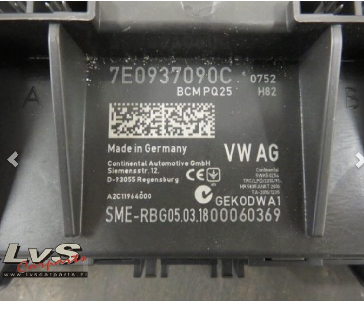

I found a few bcm with the correct part number, but I can’t find the so called PR code or the Z code ? Some of them didn’t even had a letter on the end...

This one ok ??

This one ok ??

8IT = LED Headlights
viewtopic.php?f=10&t=42713&p=466570#p466570
iichel or firegrafik can help you with this matter, it depends on what you choose.

IMO the cheapest way is to buy this directly from Russia, Alexander know some guys who can change BCM's software to make support Full LED headlights.
I bought my second BCM (090C) from RoFIREmaN: https://www.drive2.com/users/rofireman/
BCM - 4500p
Parameterization - 800p.
Shipping costs - 1330р.
Probably now prices can be better, and BCM in version D is already available
The PR Code is not visible on the part, so buying a used BCM you would have to be sure that it comes from a car with Full LED headlights (Buying it e.g. on an allegro is almost impossible)

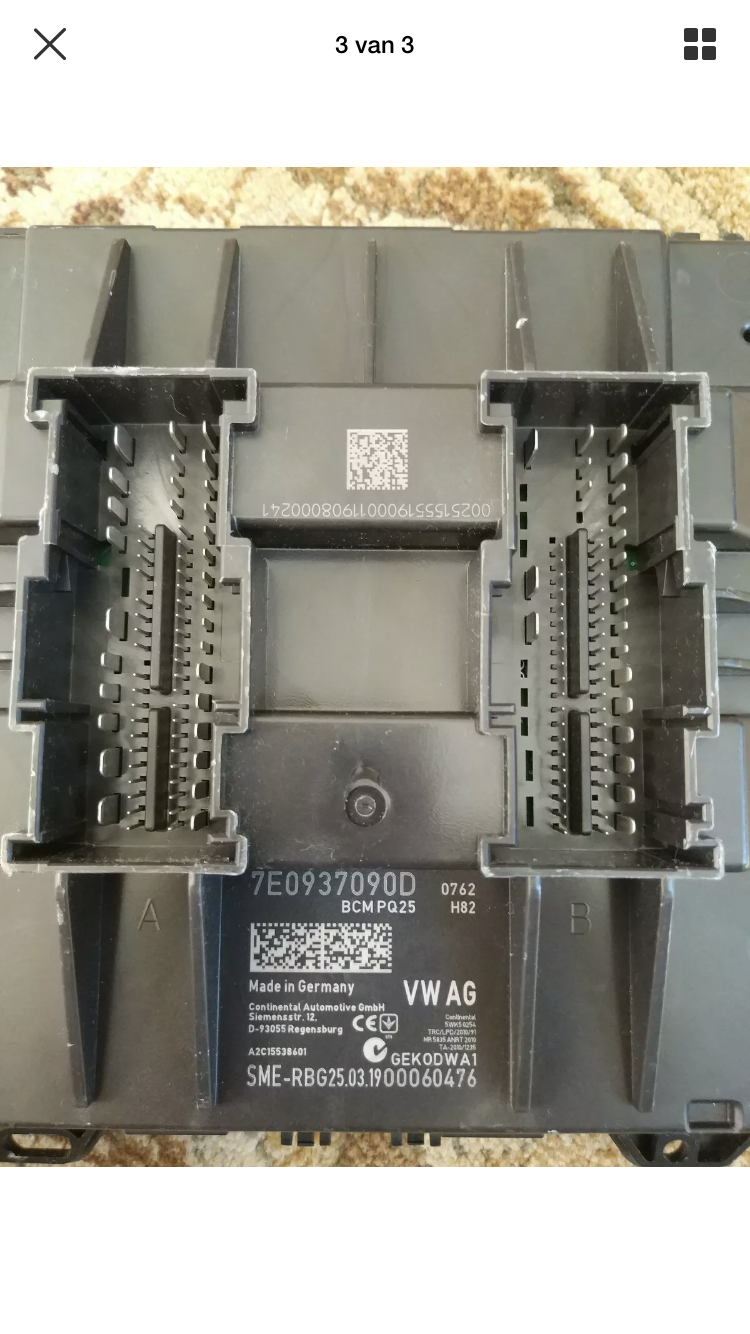

Hi guys,
I found the bcm D (picture)
What to do now, wiring ? Coding ?
Removing CAN, wiring parking lights etc

My suggested plan of action:
1 prepare for BCM replacement
1a autoscan with old BCM
1b adapmap from old BCM, CAN gateway, battery monitor
2 Install the BCM
2a remove the old external CAN gateway
2b wire CAN networks to the BCM (powertrain, diagnostics, instrument cluster)
2c wire 58d (1 wire from BCM to dimmer) + vcds coding
2d restore all the codings and adaptations to BCM, gateway, battery monitor
2e (if necessary) make adjustments to the BCM eeprom with VCP
2f adapt remotes
3 install LED headlights
3a install all the wirings necessary + adapters from 10 pin to 14 pin
3b do all the codings for LED headlights with LED DRL
3c install AFS
3d replace dimmer with headlight range regulation to dimmer only
