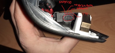

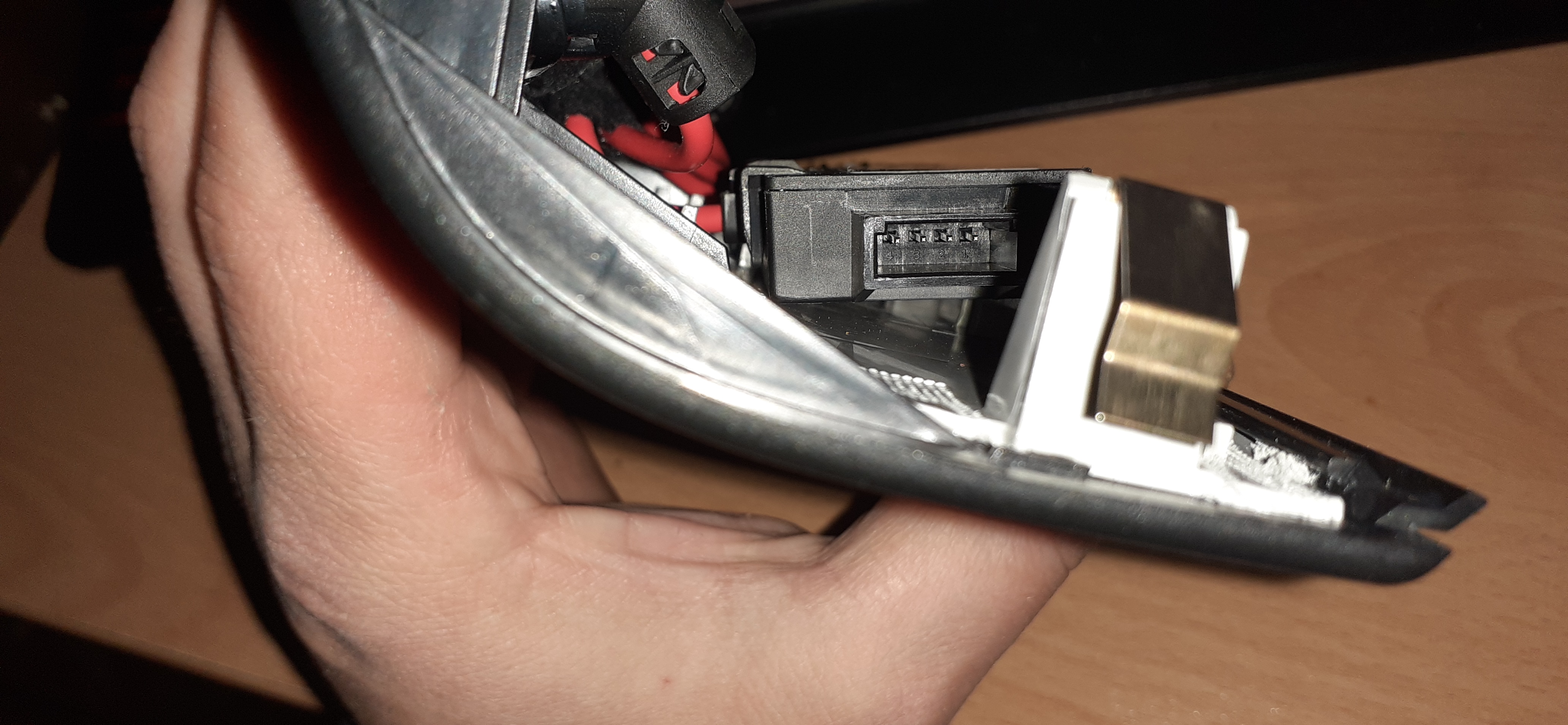

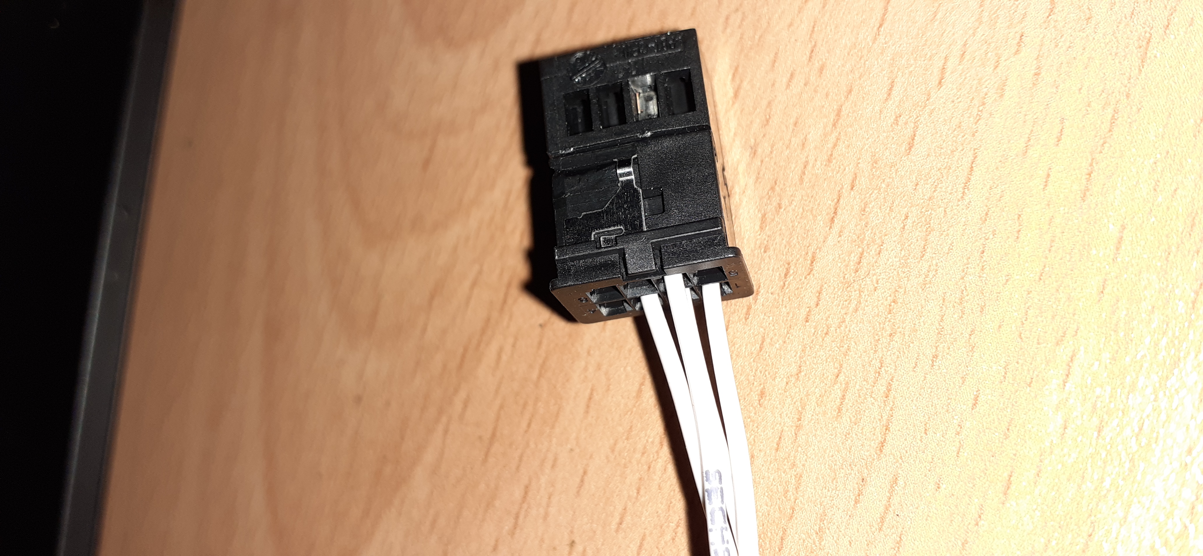

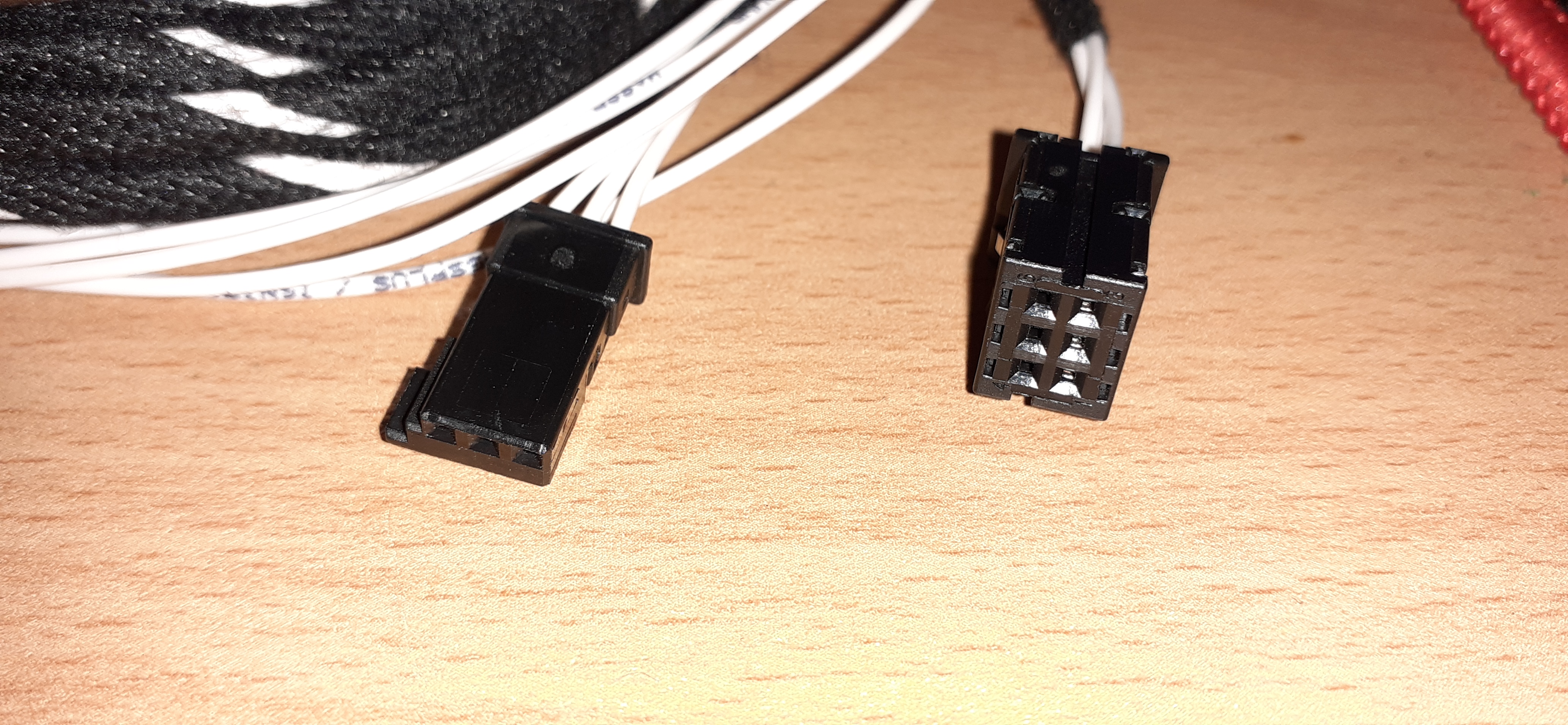

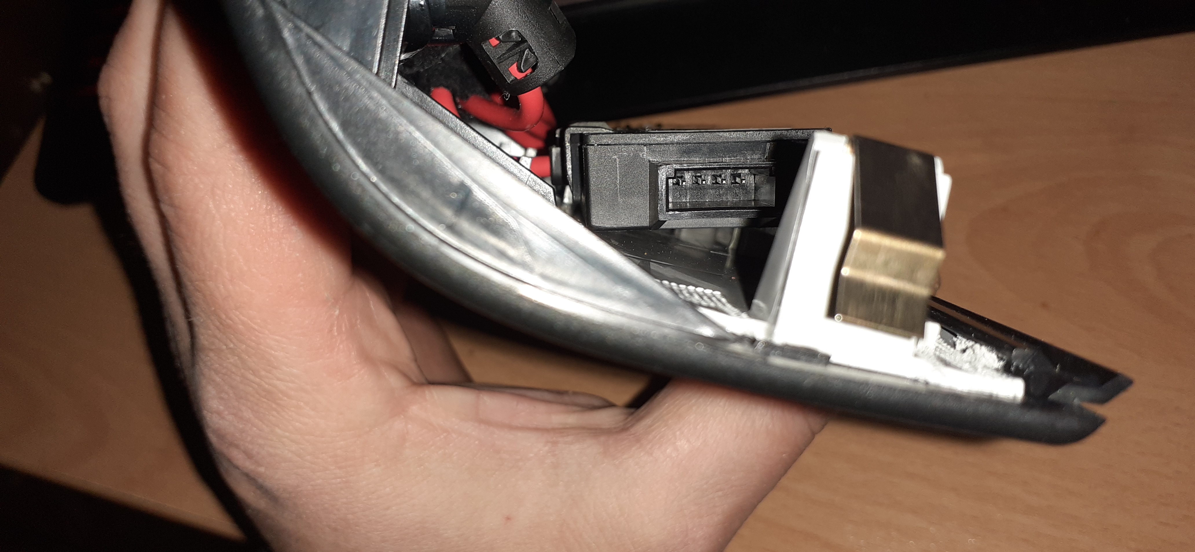

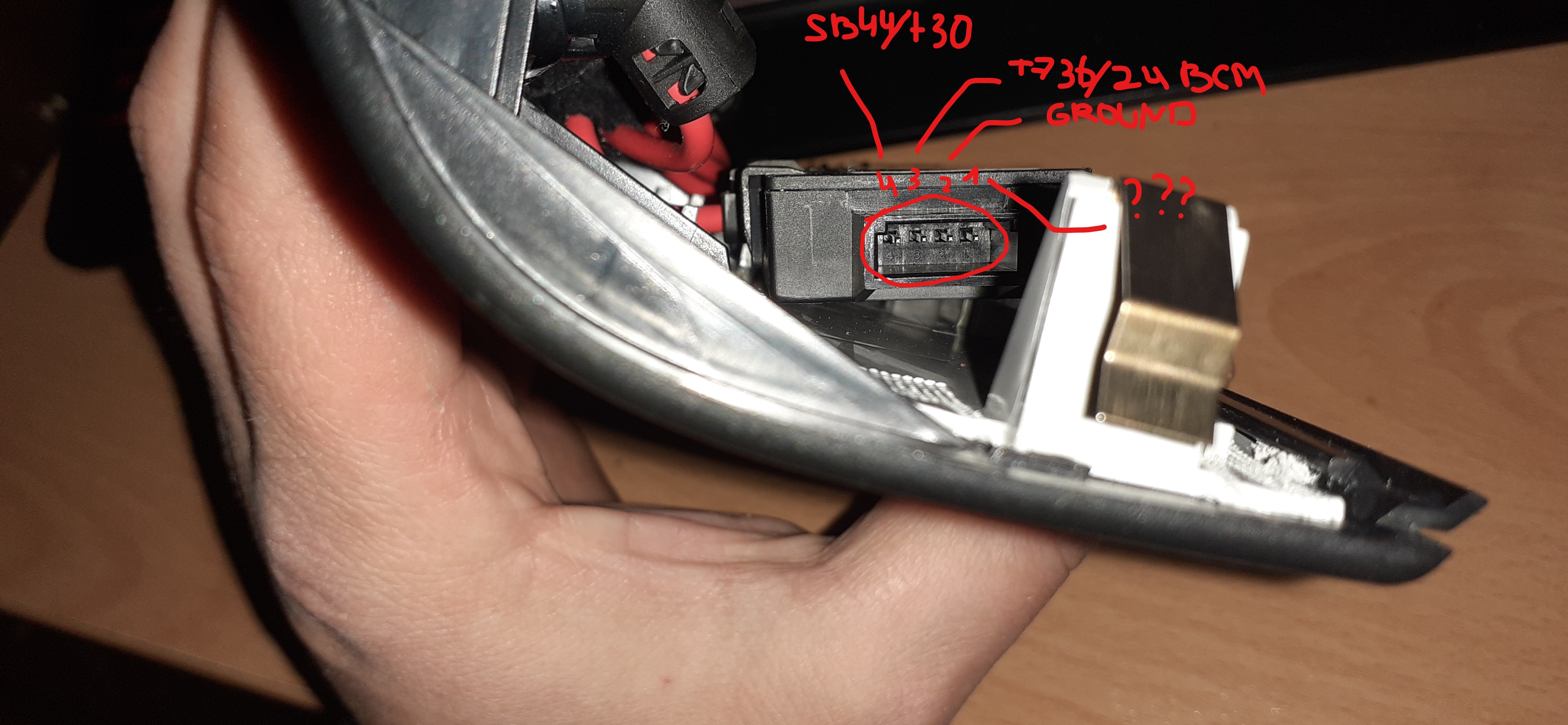

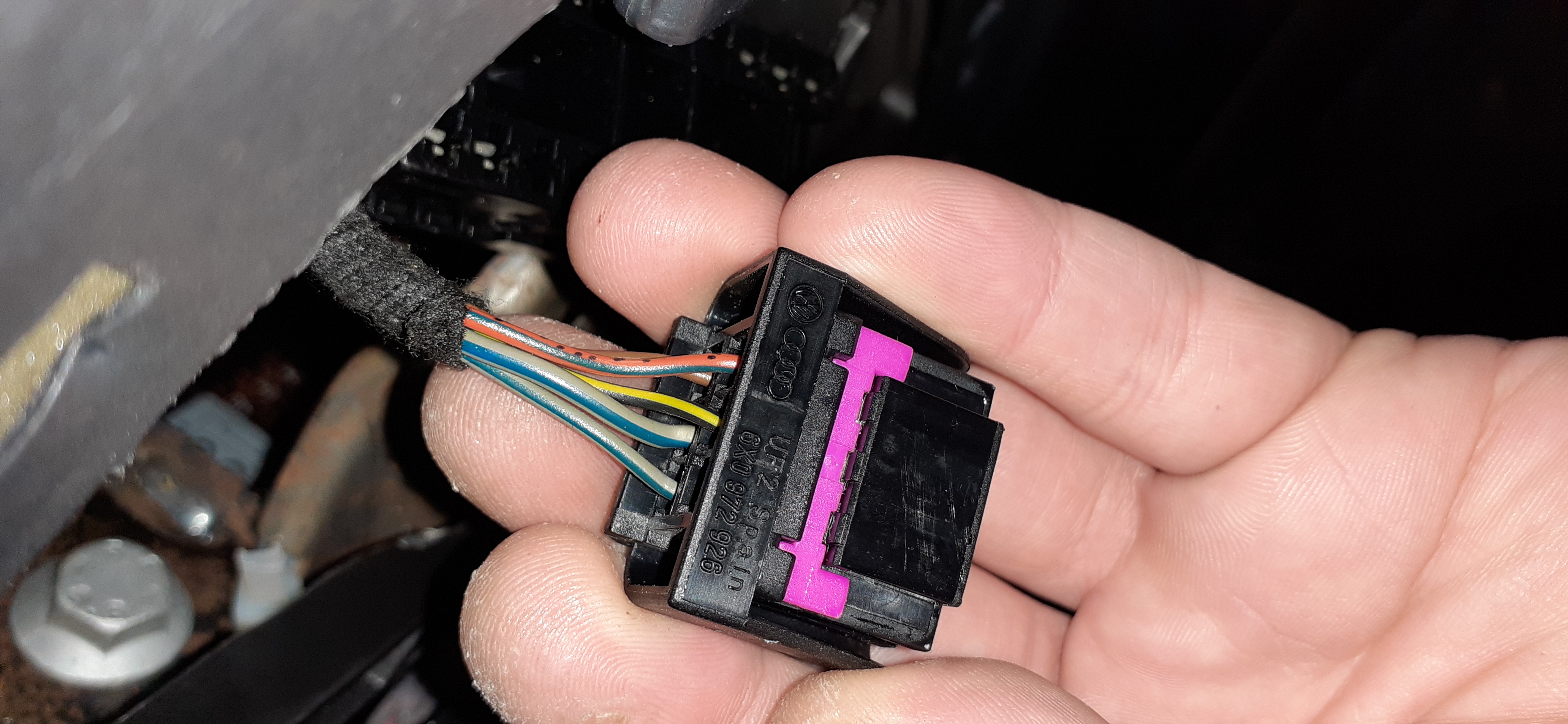

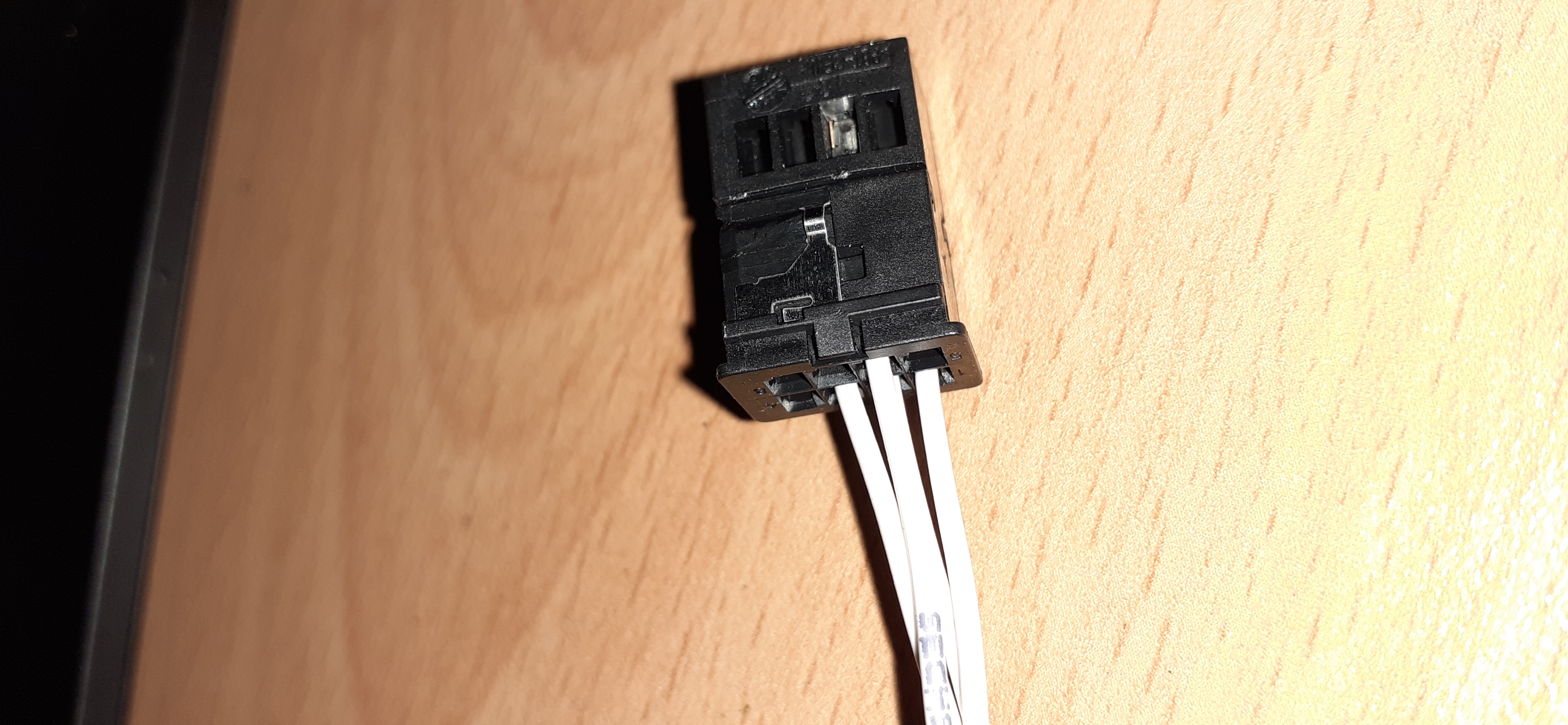

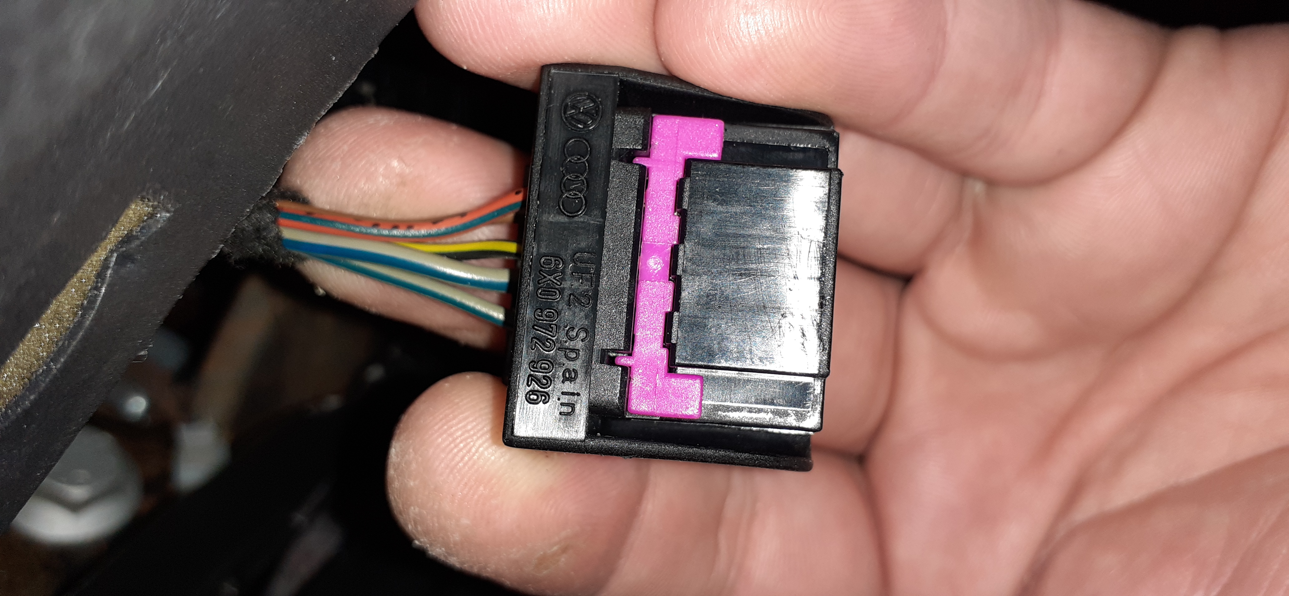

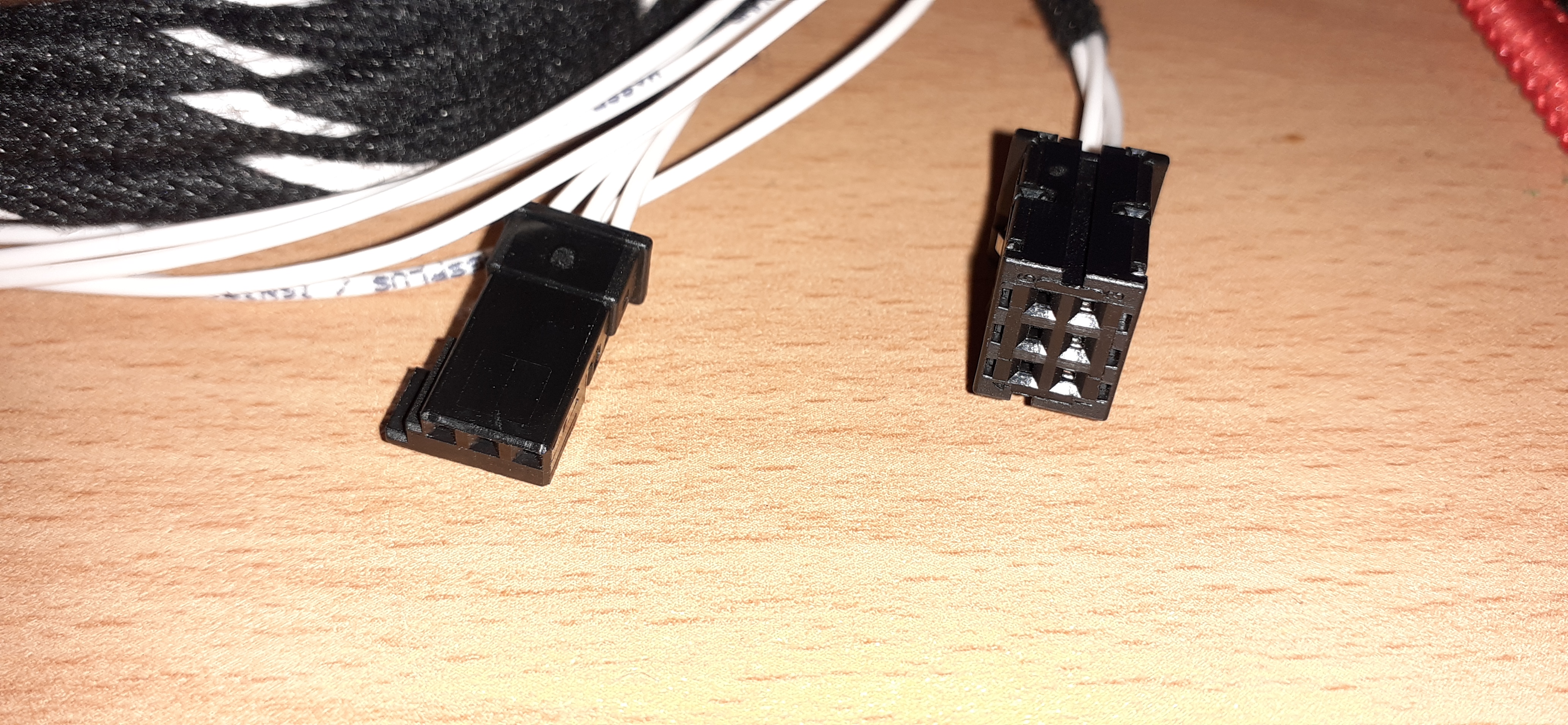

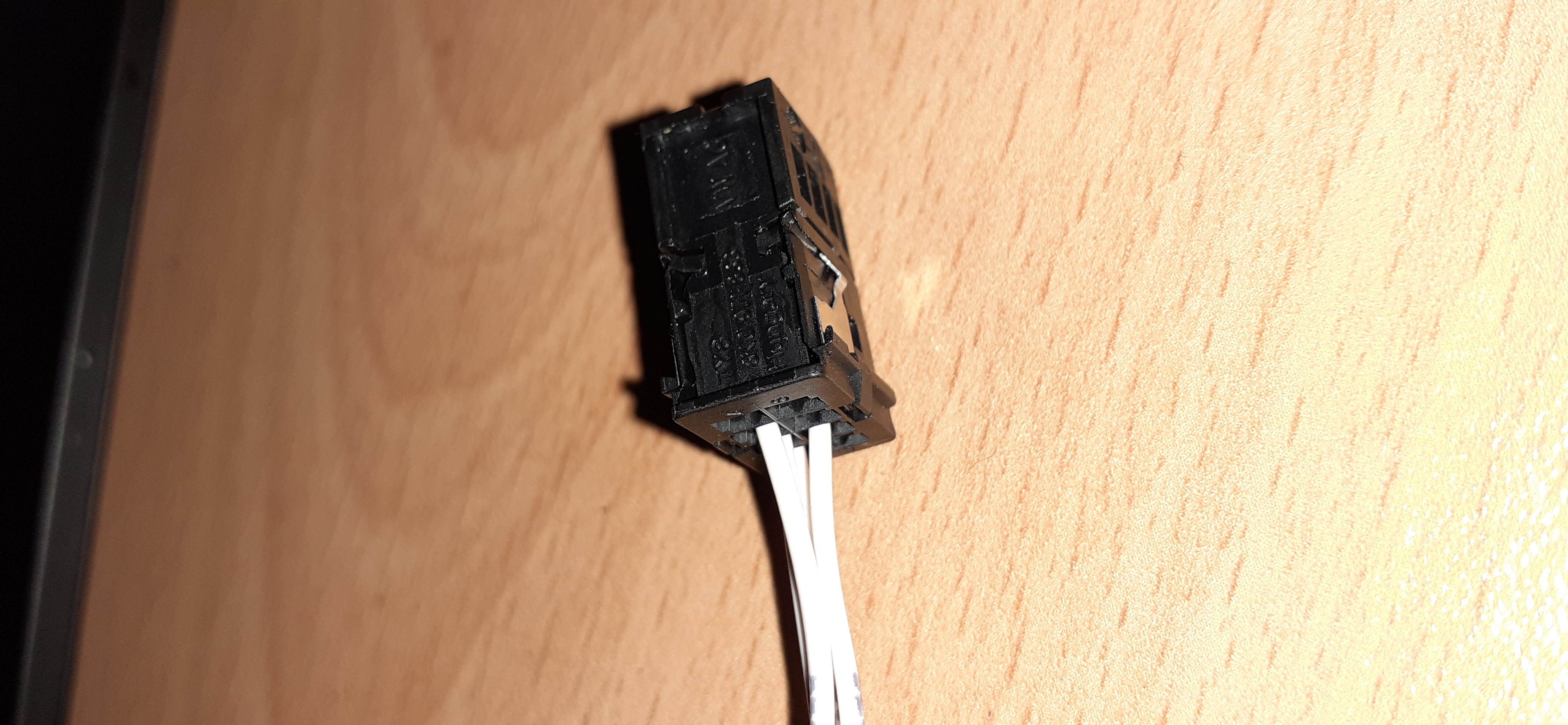

I also thought so, but when the cable set has arrived, i got this situation:
I also wondering is this retrofit even possible, 6c mirror is with 4 pins and 6r is 3
- Posts: 8996
Re: Reverse Lamp and Camera disappeared after BCM max Upgrade
Ah, so the image of kufatec is not correct, although it is specified that it is for 6R ...
No problem for installation, the correspondence/pin assignment/pinout of 8-p connector VS 6-p connector is exactly the same.

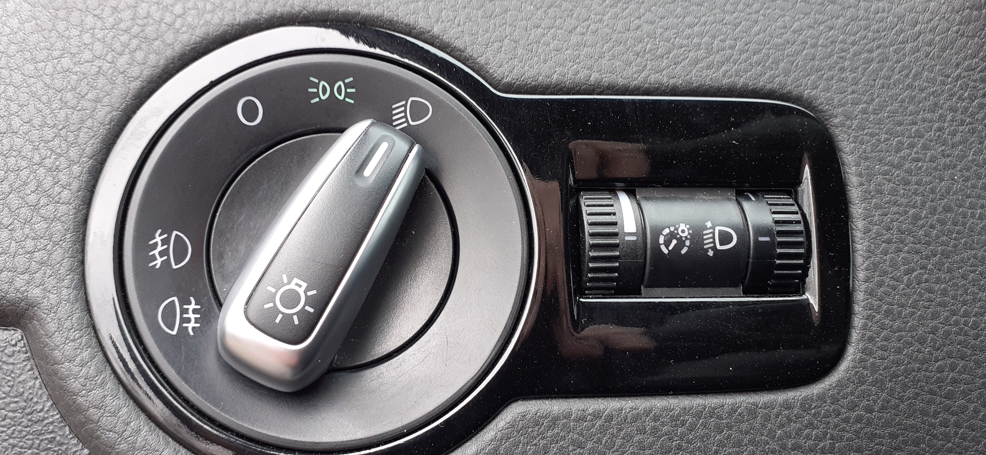

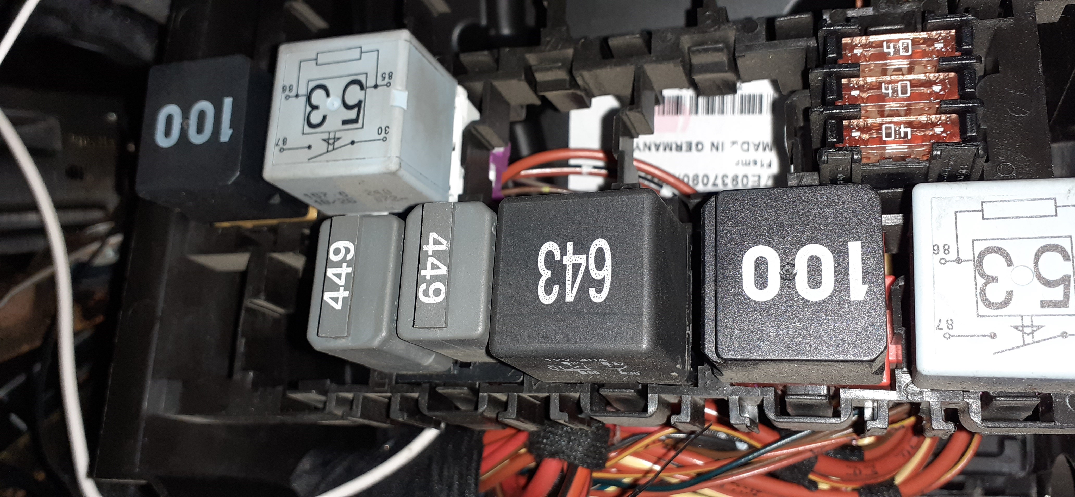

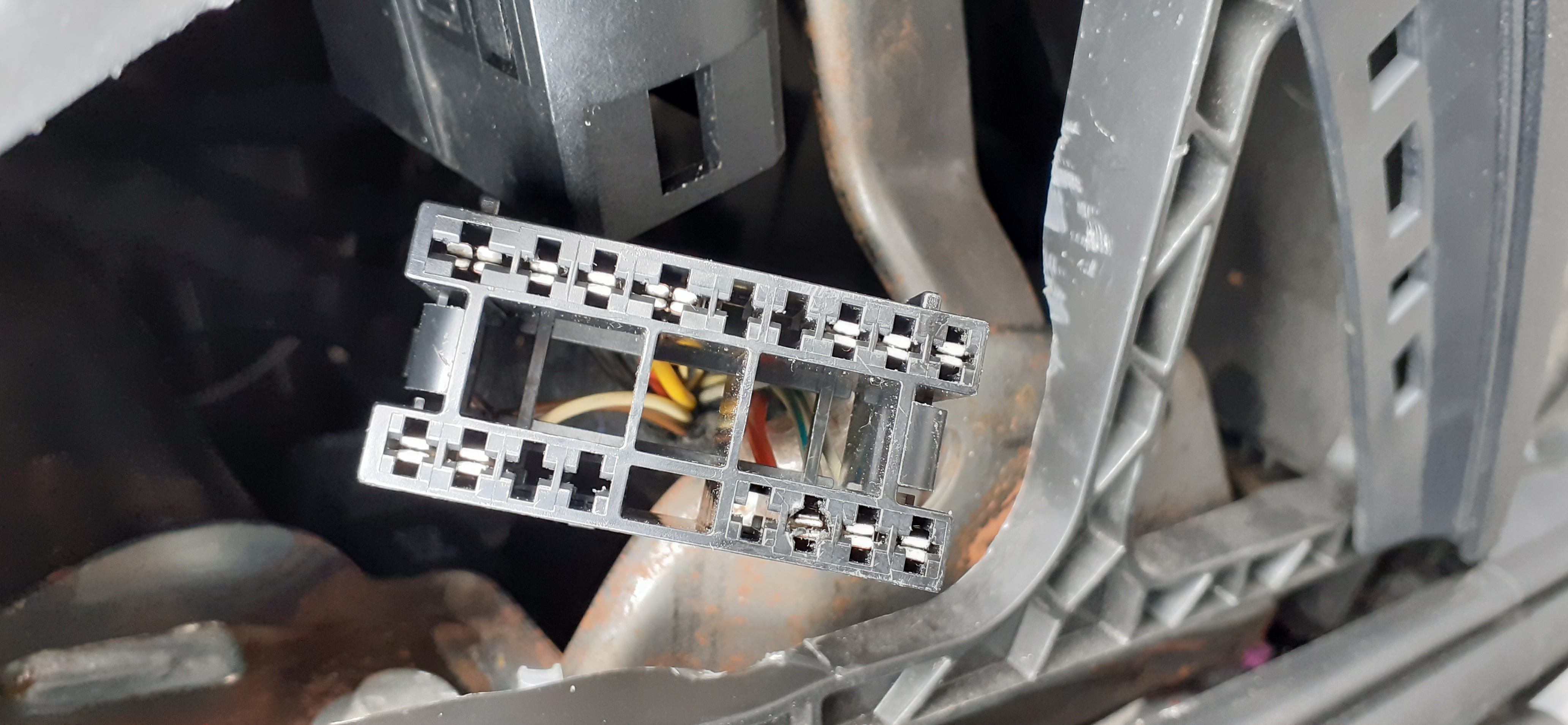

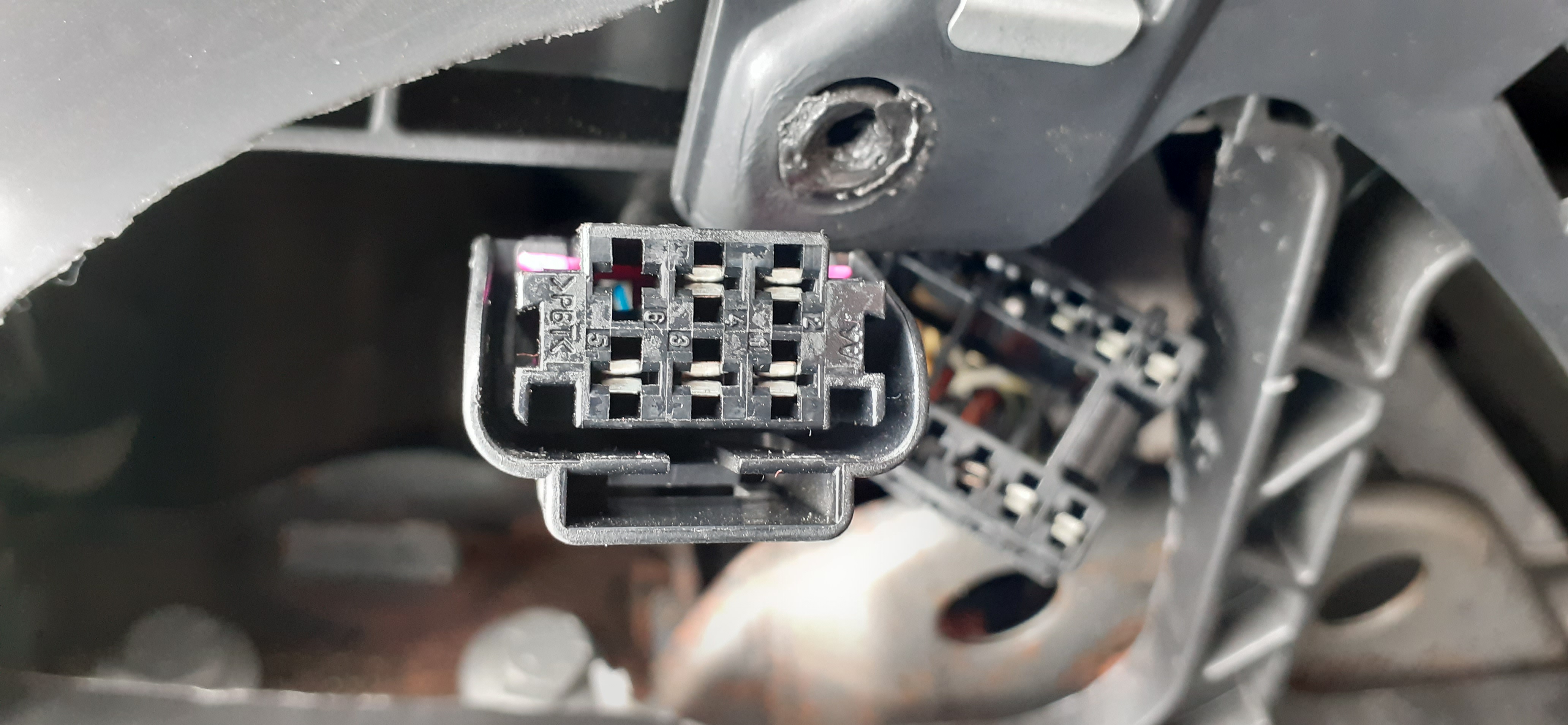

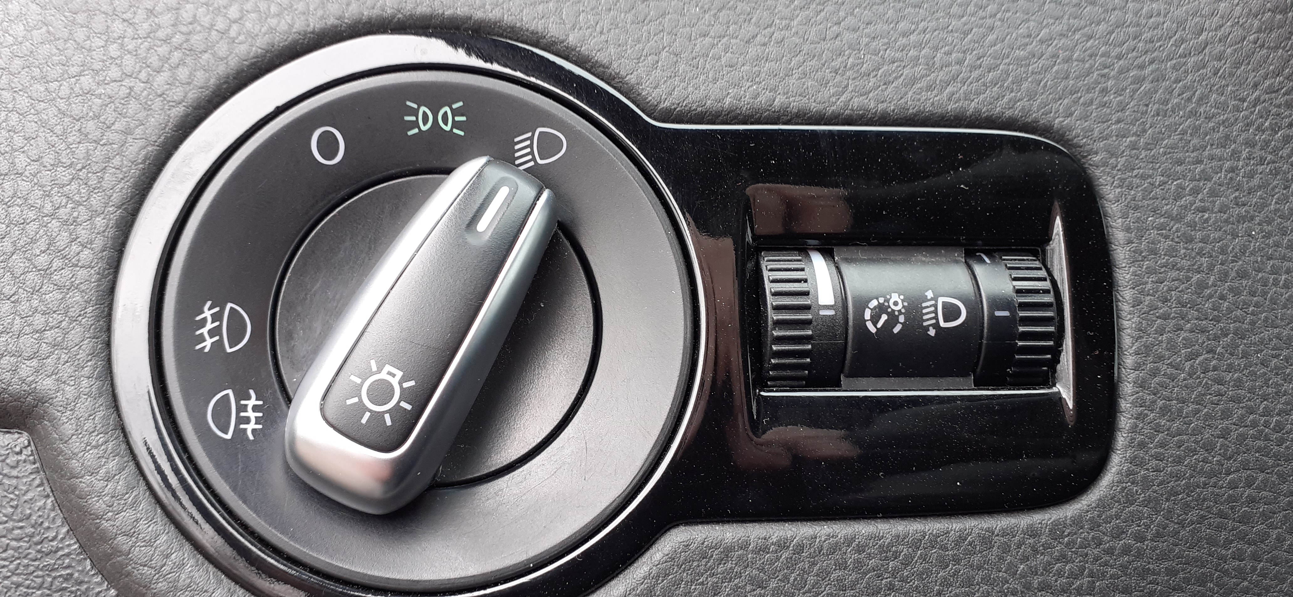

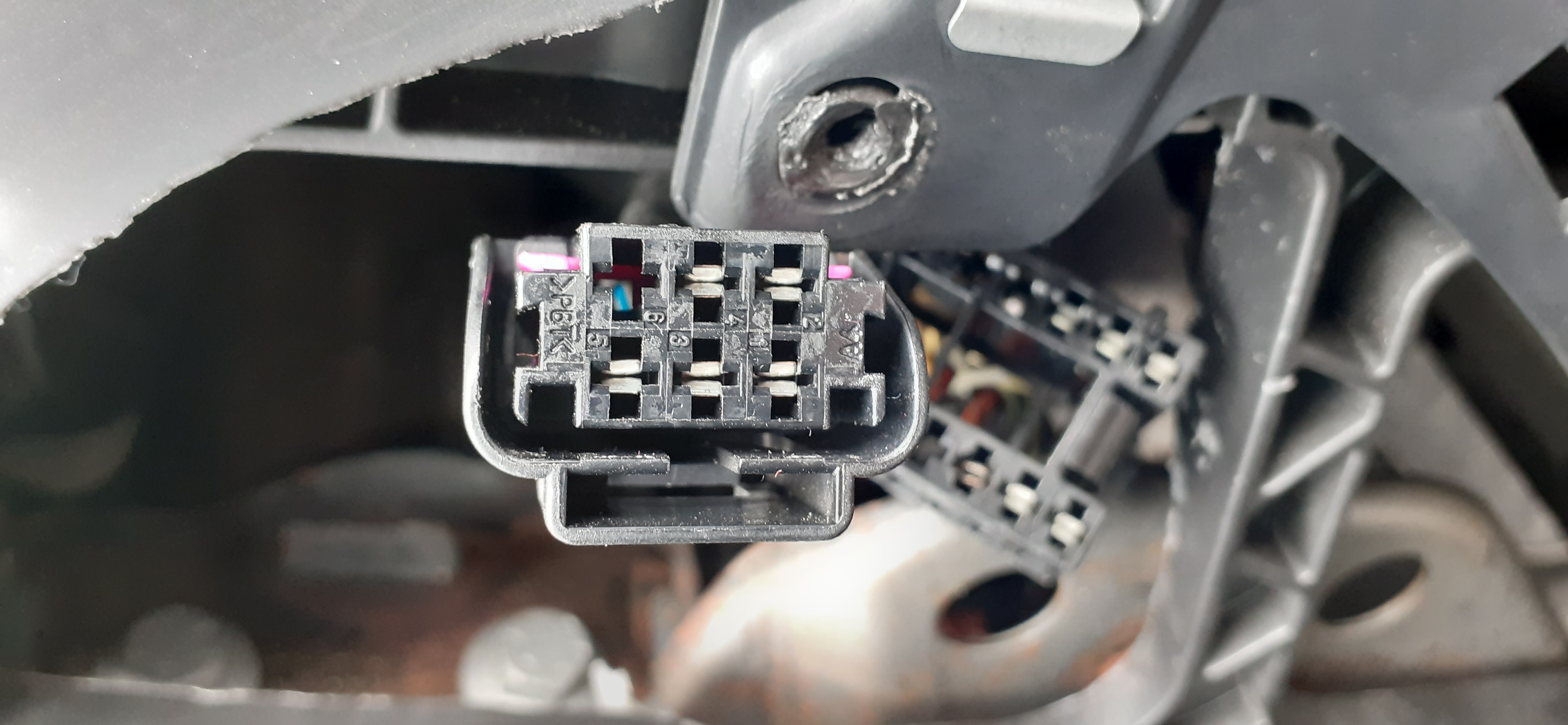

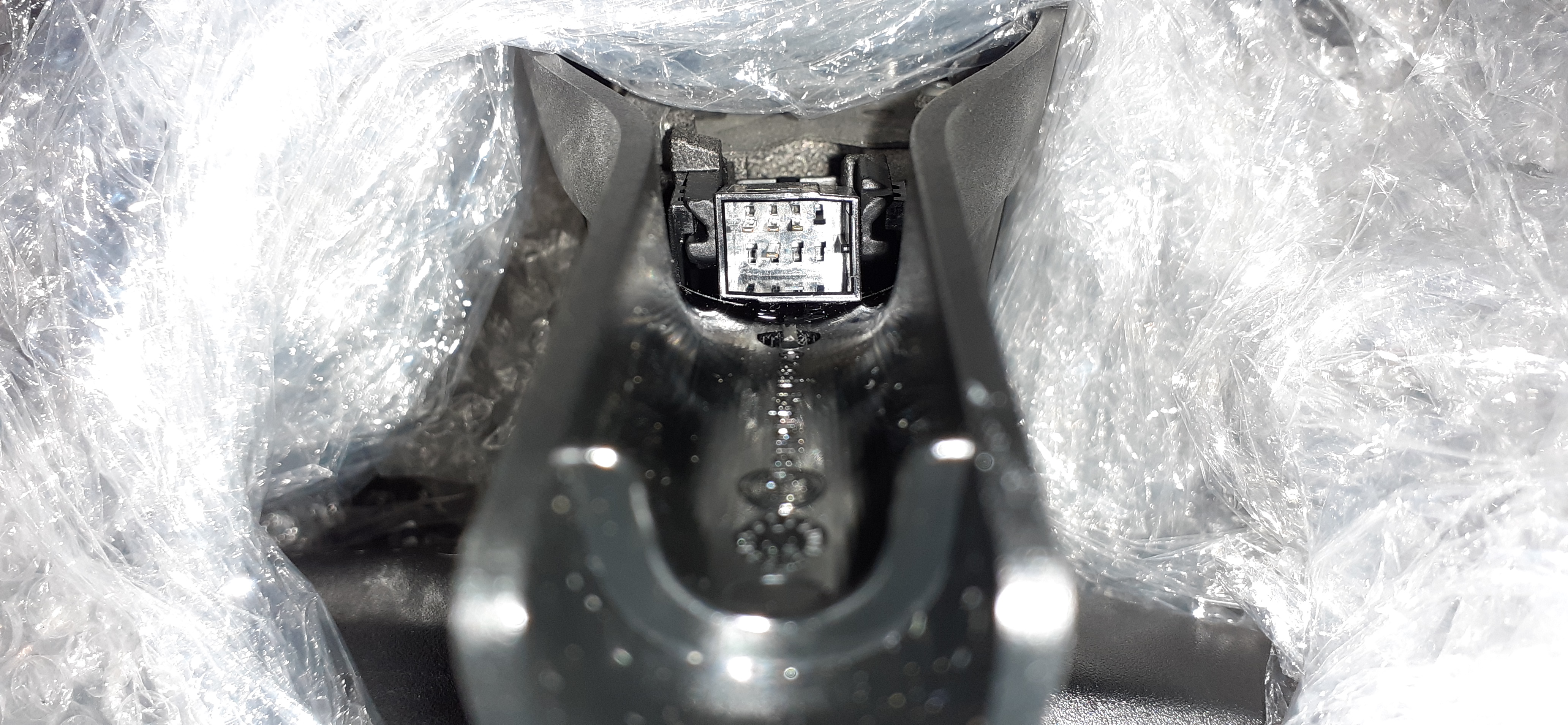

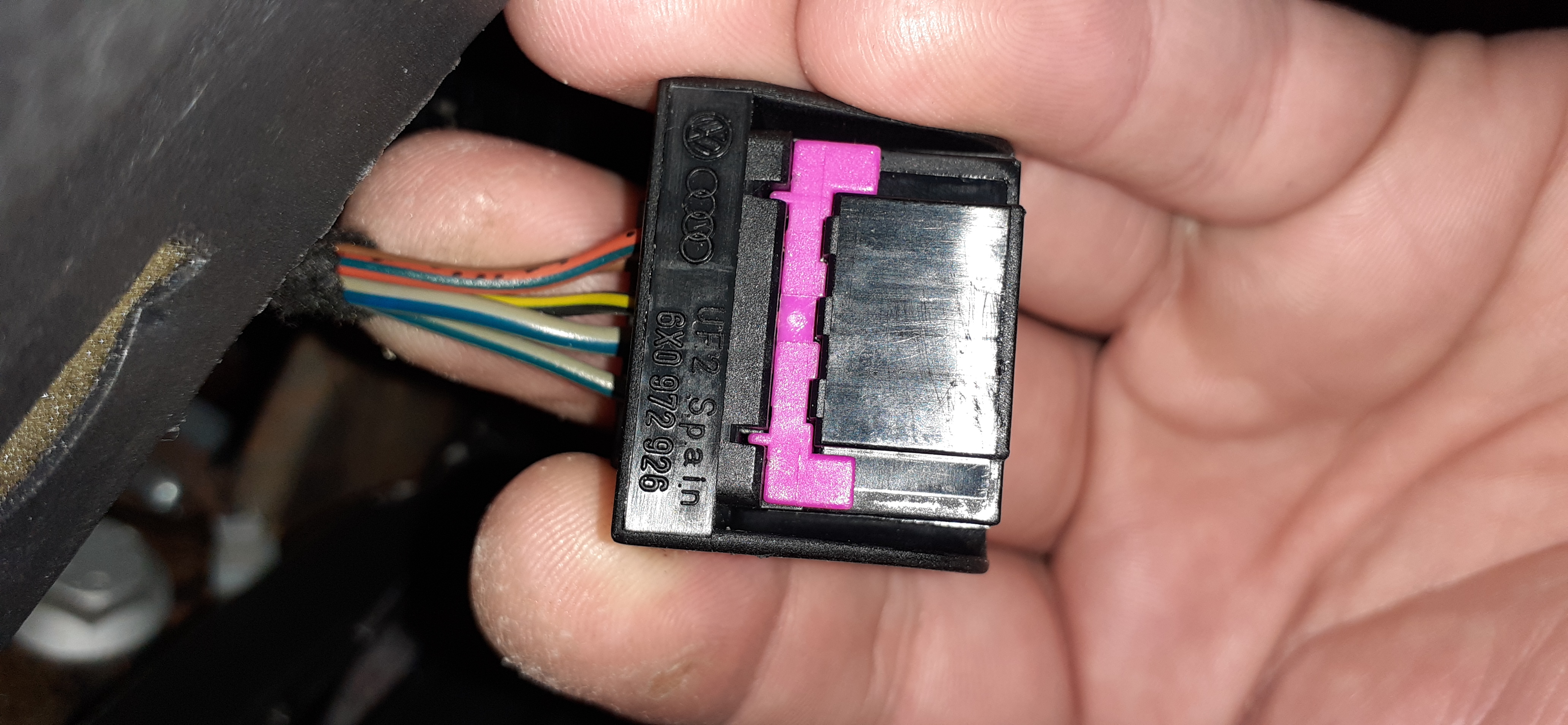

With that diagram and with the right connector i will handle with that rear view mirror retrofitting. Only one question is left - do i have all parts that i need? So far: have the mirror and the sensor, i will have wiring soon, i order this 6C0868168A 9B9 cover cop for the headliner, will order brand new windshield for 6C polo with sensor trim. Is any sort of trims that i need more?

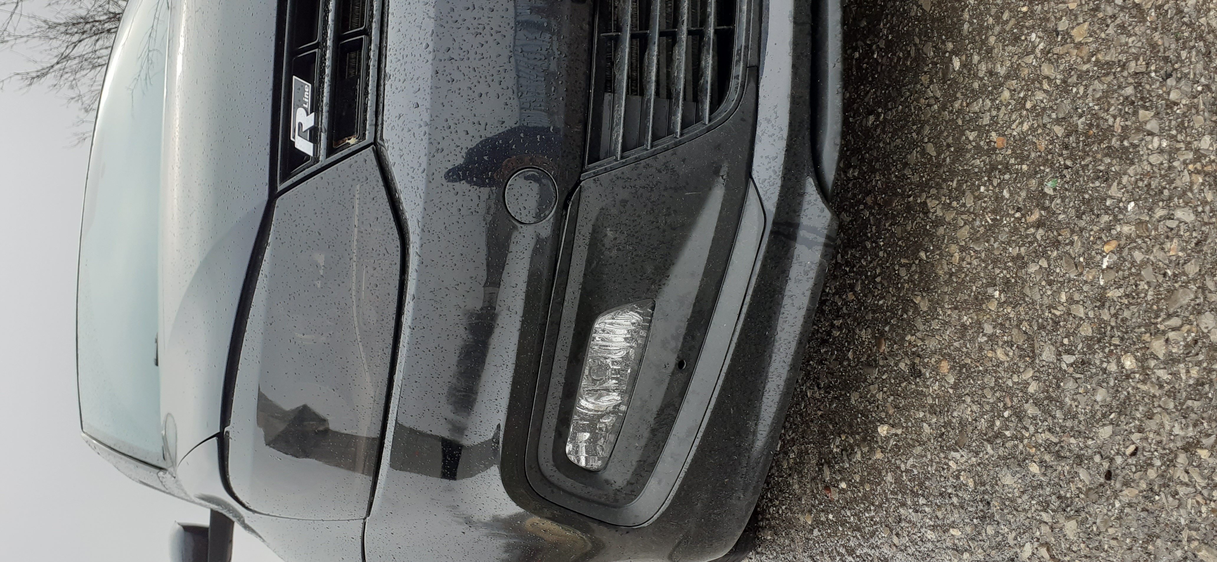

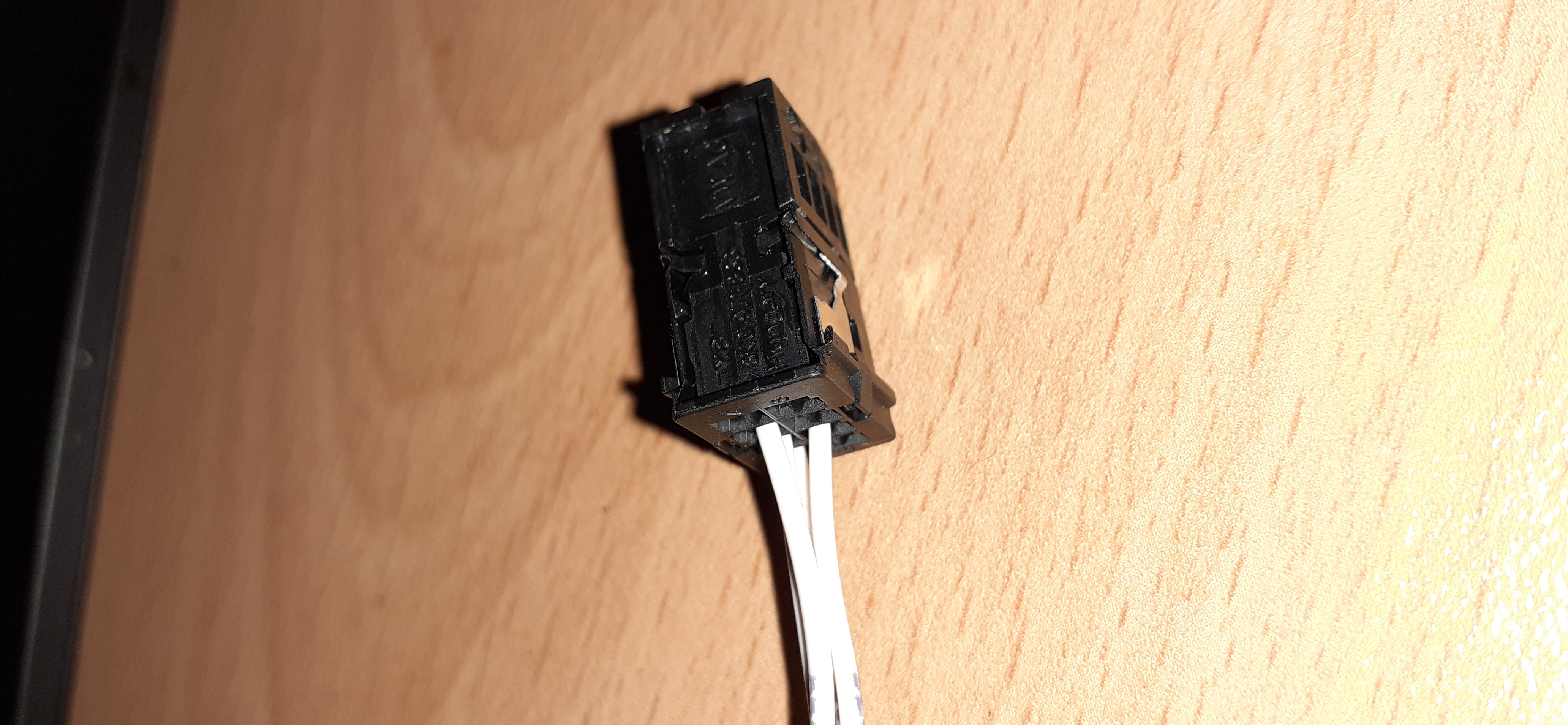

So, here is the pictures of my polo's parts as you request:
and the auto scan:
https://we.tl/t-1Zj3i1ncN0
and the auto scan:
- Posts: 8996
Thank you for the images.
You do not need anything else for the installation of the interior mirror.
In case you want to make a wiring transfer from the 6-p connector to the 8-p connector you must take into account that the contact terminals are not equal and the wires cannot be transferred. No problem! I will give you the contact terminals you need for the 8-p connector.
I have not received a response from my usual suppliers for the terminals that I do not have.
To not wait for the response from my suppliers, and for your information, I will buy these terminals from eBay. They are the contact terminals that I need and that I currently do not have to be able to manufacture your wiring for automatic lights.
As you can see, the shipping costs are higher than the price of the terminals ... I will buy twice as many terminals to have the feeling of paying half for shipping costs...

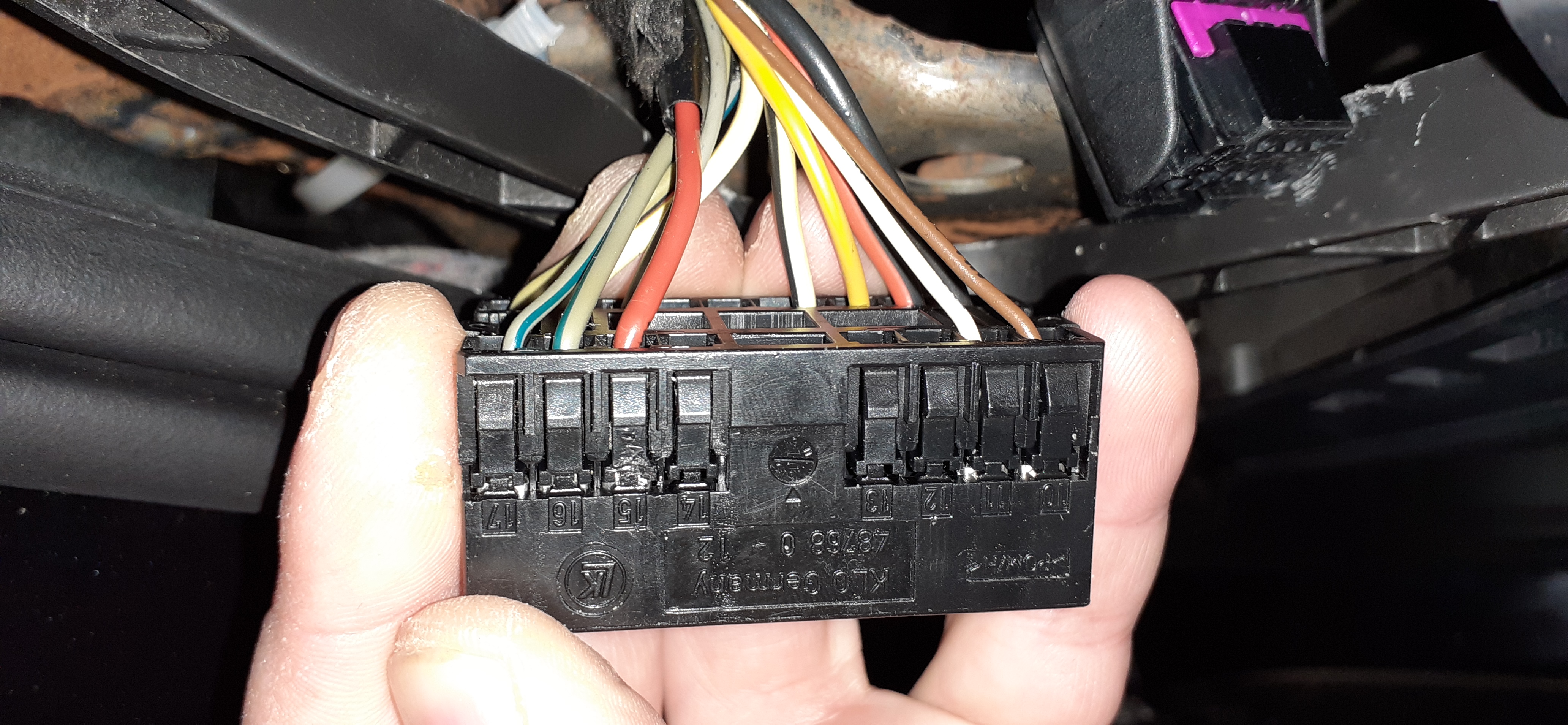

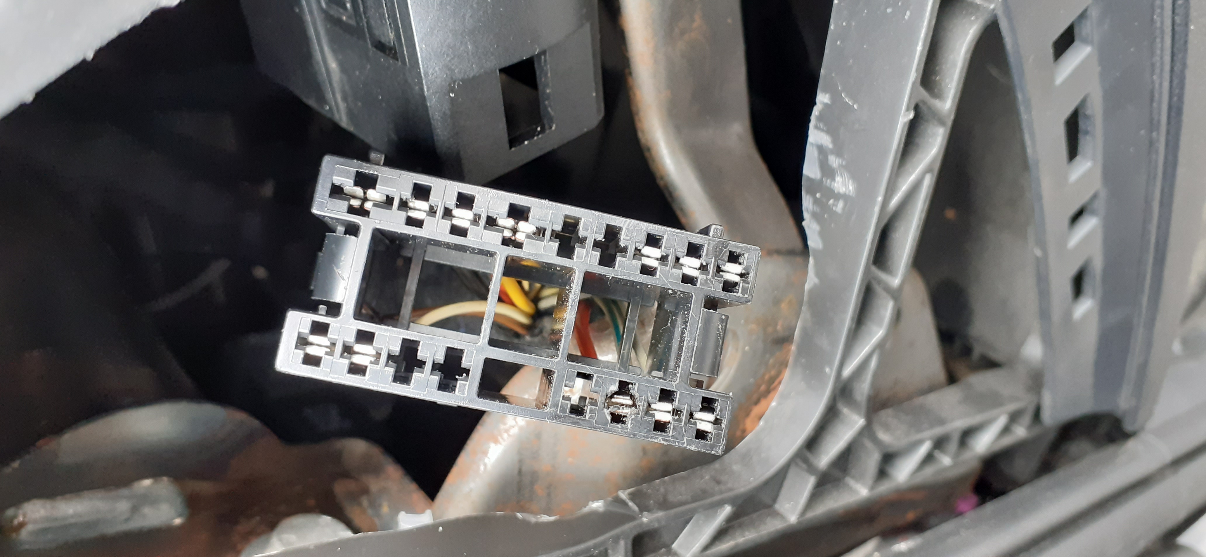

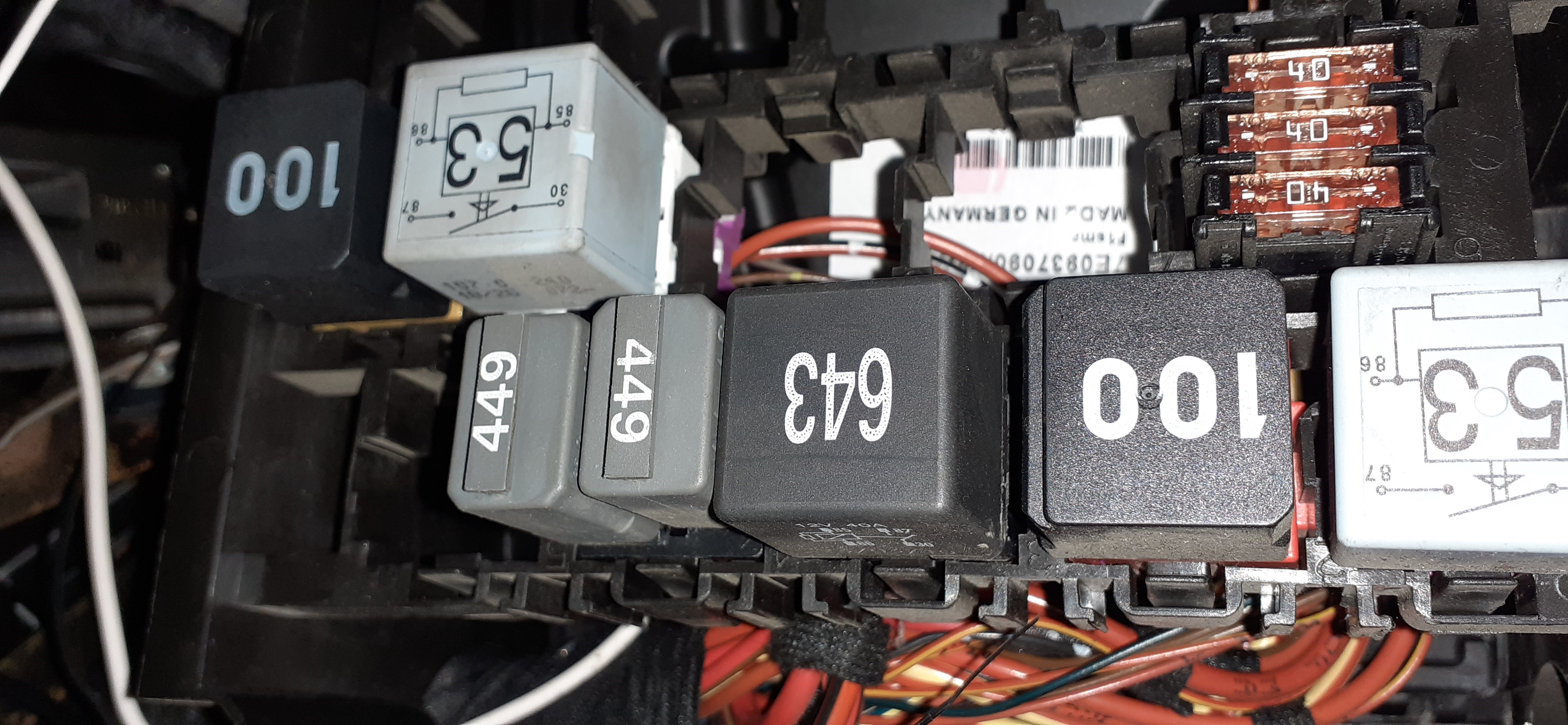

Some small clarifications you should do.

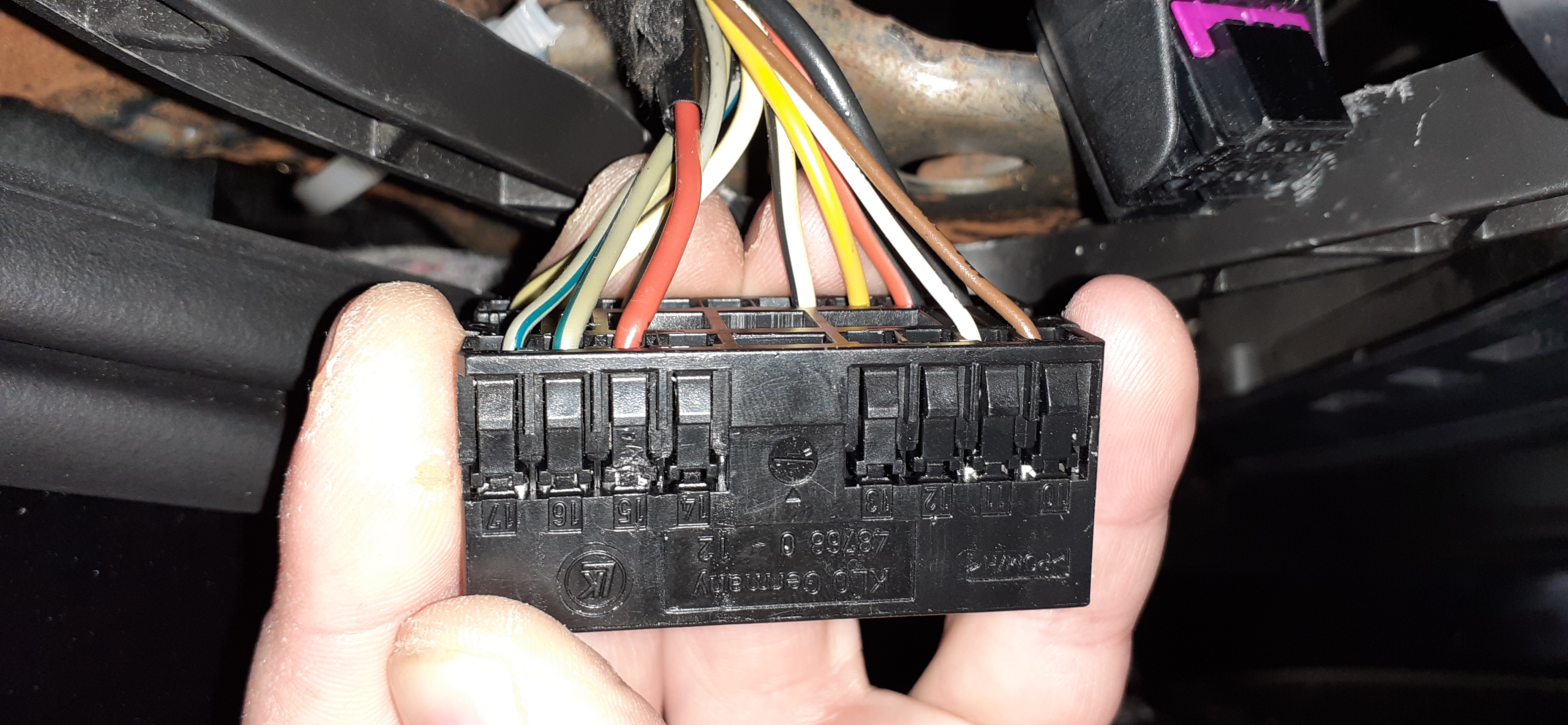

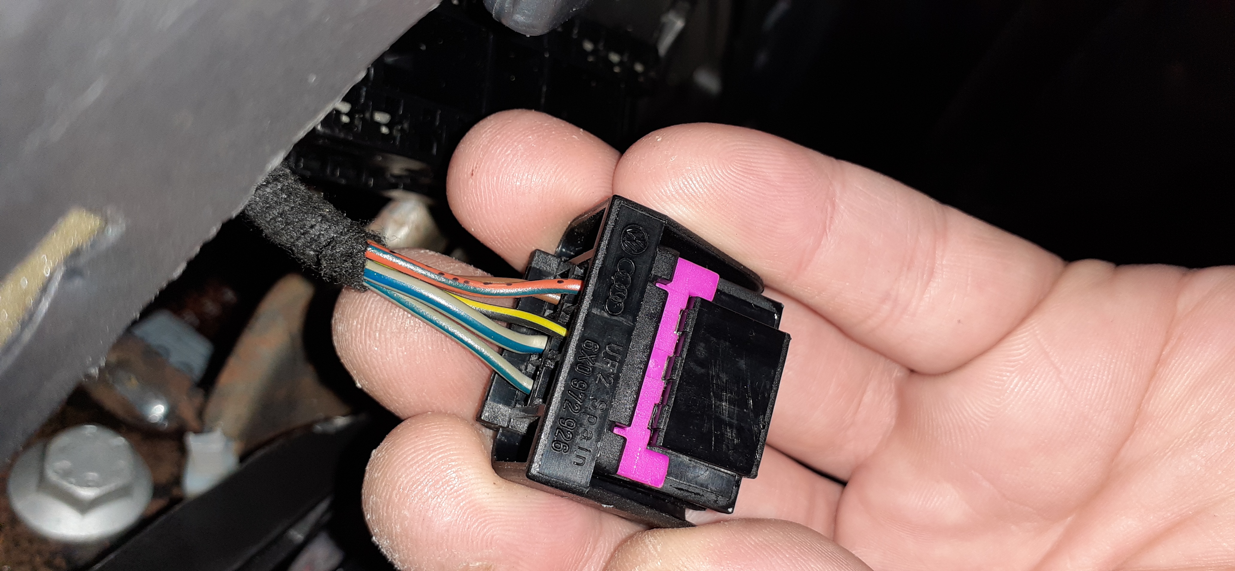

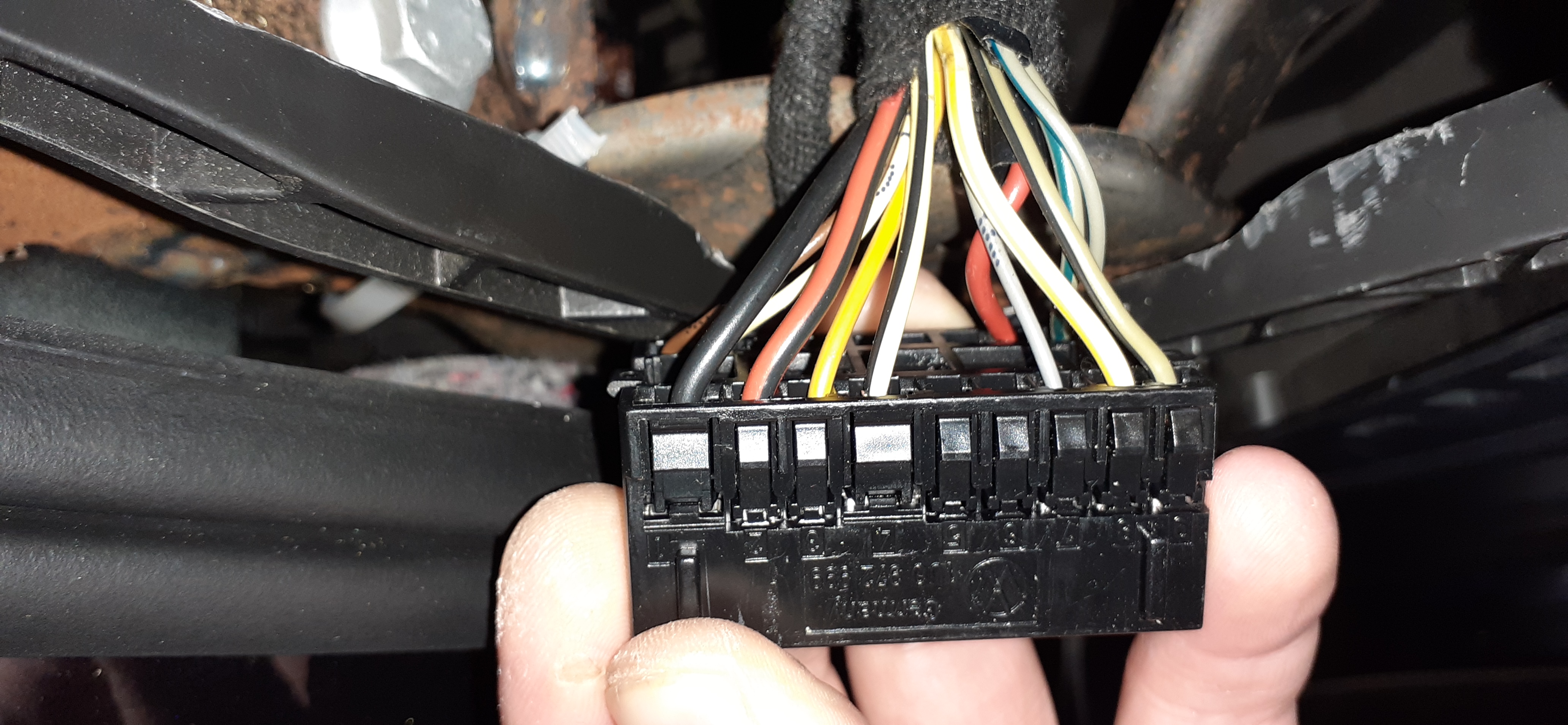

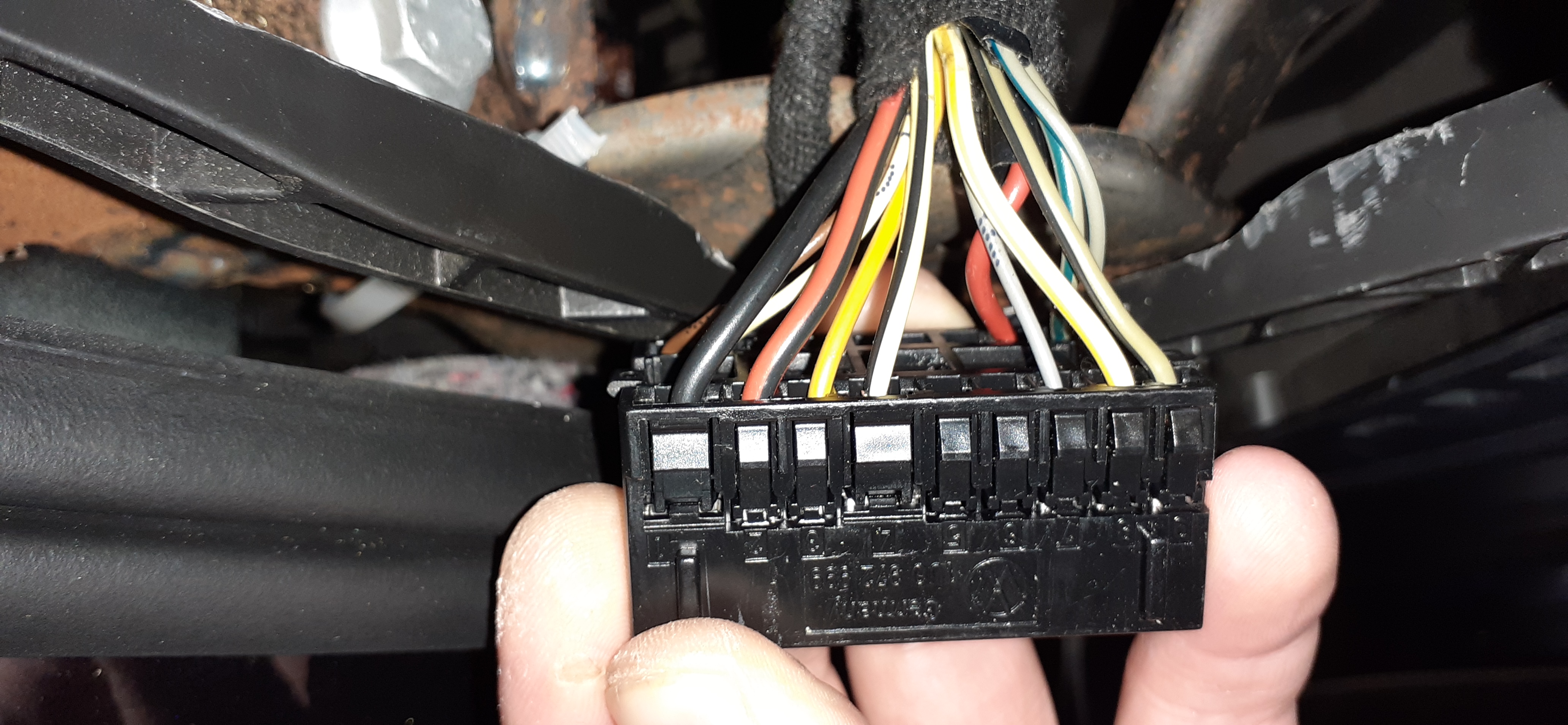

Please explain these splices:
In wire T17/17, blue/gray.
In wire T17/15, red.
The red wire, +30, is extremely important for the new installation, that splice seen in the image must be absolutely perfect.
You must verify it, and improve it to perfection if necessary.
Please consider this as the most important thing you should do in the next few days.
Thank you.
Thank you.

I attach to red wire (15) - wire from MFSW (according to this manual: viewtopic.php?t=54171), on the blue/gray wire (17) i attached wire from the Kufatec heated seats wires, according to their instruction. I solder them and after that isolate with tape.
- Posts: 8996
Ok, thank you very much for the clarifications.
At the beginning of 6R production, the MFSW unit worked with a +30 signal, then/later with a +15 signal, in both cases under fuse protection.
Well, because these splices you soldered are for a very low consumption and due to that any of the parts (MFSW buttons and Heated seats buttons) can be easily changed in case of faults/damages, they will stay as you currently have them.
So far there have been no failures reported due to these splices for the buttons, ... which were made in the same way in many 6Rs, logically.

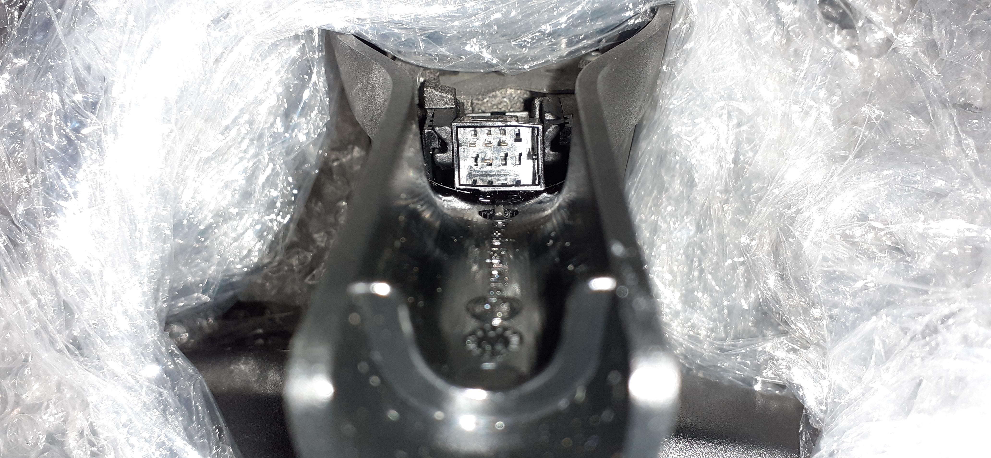

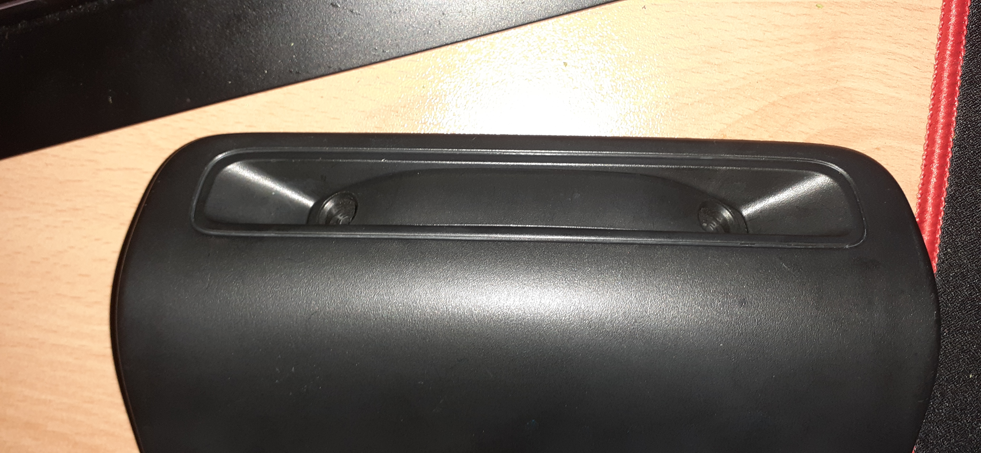

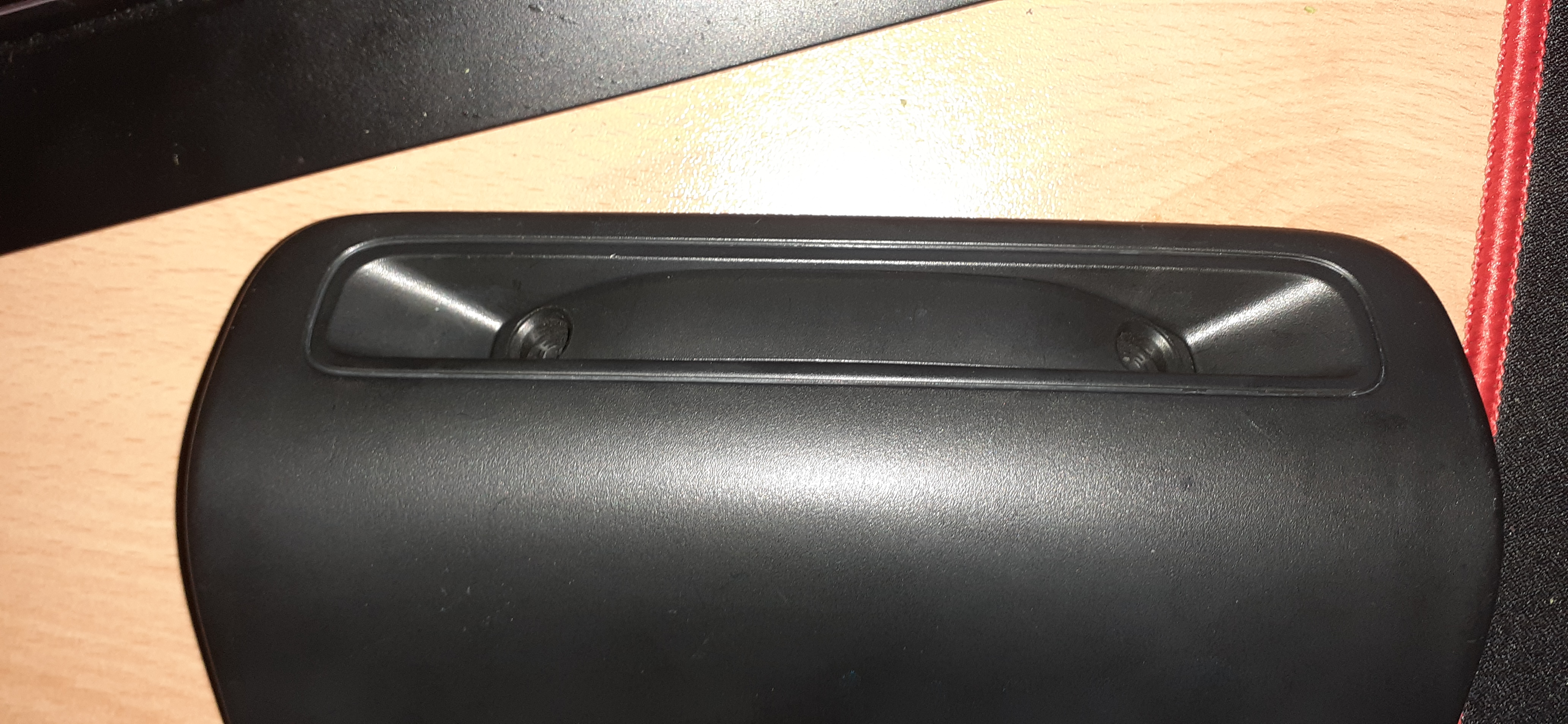

Look what i found in the box with the parts:

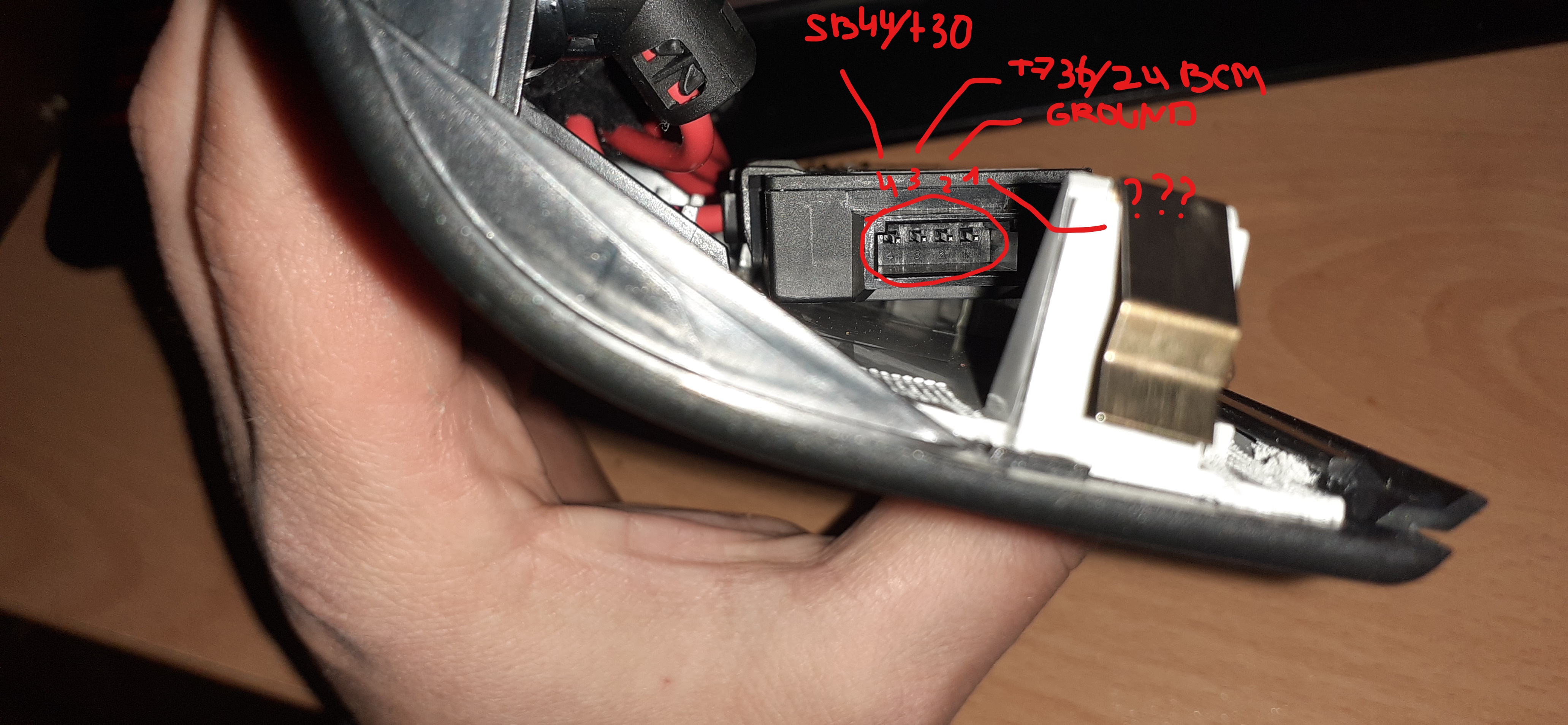

And according to diagram you provide for dimming mirror, i will try to retrofit those anti-thief sensors, and just want know connector and contact terminals numbers in order to complete this retrofit. Also today i receive this new cable set from kufatec for golf 7 dimming mirror, and i think to cut both connectors, and then to solder in the same order this new 8-pin connector to 6R rain/dimming cable set. On the 8-pin connector will cut and isolate that wire from 6th pin, and i just wondering what it is for.
- Posts: 8996
https://www.ebay.de/itm/Audi-Stecker-Re ... 1765473897
viewtopic.php?f=10&t=42713&p=466570#p466570
The 6th pin/wire in the Golf,etc has the function of avoiding the mirror dimming in case of turning on the interior dome light.
For example: (so I don't have to upload my diagrams
https://www.briskoda.net/forums/topic/4 ... fit-guide/ (... wonderful people out there)
ZahariGeorgiev
- Posts: 118
- Joined: Mon Dec 10, 2018 4:14 pm
- Drives: Polo 6R 1.6 TDI
- Location: Bulgaria
Thanks for the links, i will order that connector. Now my question is:, no wire on pin 1 according to diagram, right? And after that only coding or should i have to do anything else?
- Posts: 8996
Yes, there is no wire in slot 1.
The anti-theft alarm system consists of:
1- Anti-theft alarm sensors.
2- An external horn H12, different from the steering wheel/car horn/s.
3- Internal button/switch for monitoring off/deactivation. Used in case of leaving the pet, tigers, lions, elephants, cows, pigs, rats, kangaroos, etc / passengers, husband, wife, etc / grandparents-dinosaurs / children-aliens inside the car and you want to leave the car closed.
4- Bonnet contact switch (already installed).
To know how it works, check out the vehicle owner's manual.
If you install 1 you must install 3.
2 is not absolutely necessary.
BCM coding is necessary (at the end of this whole process).
Download the PDF document that I have sent you by private message (6R WD), and look for E183, G578.
