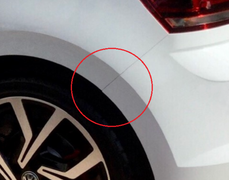

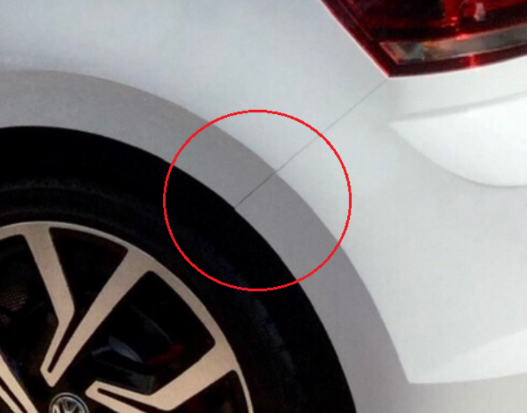

Check the bumper to wing, and bumper to quarter panel alignment as well, I've seen some really bad ones :shock:

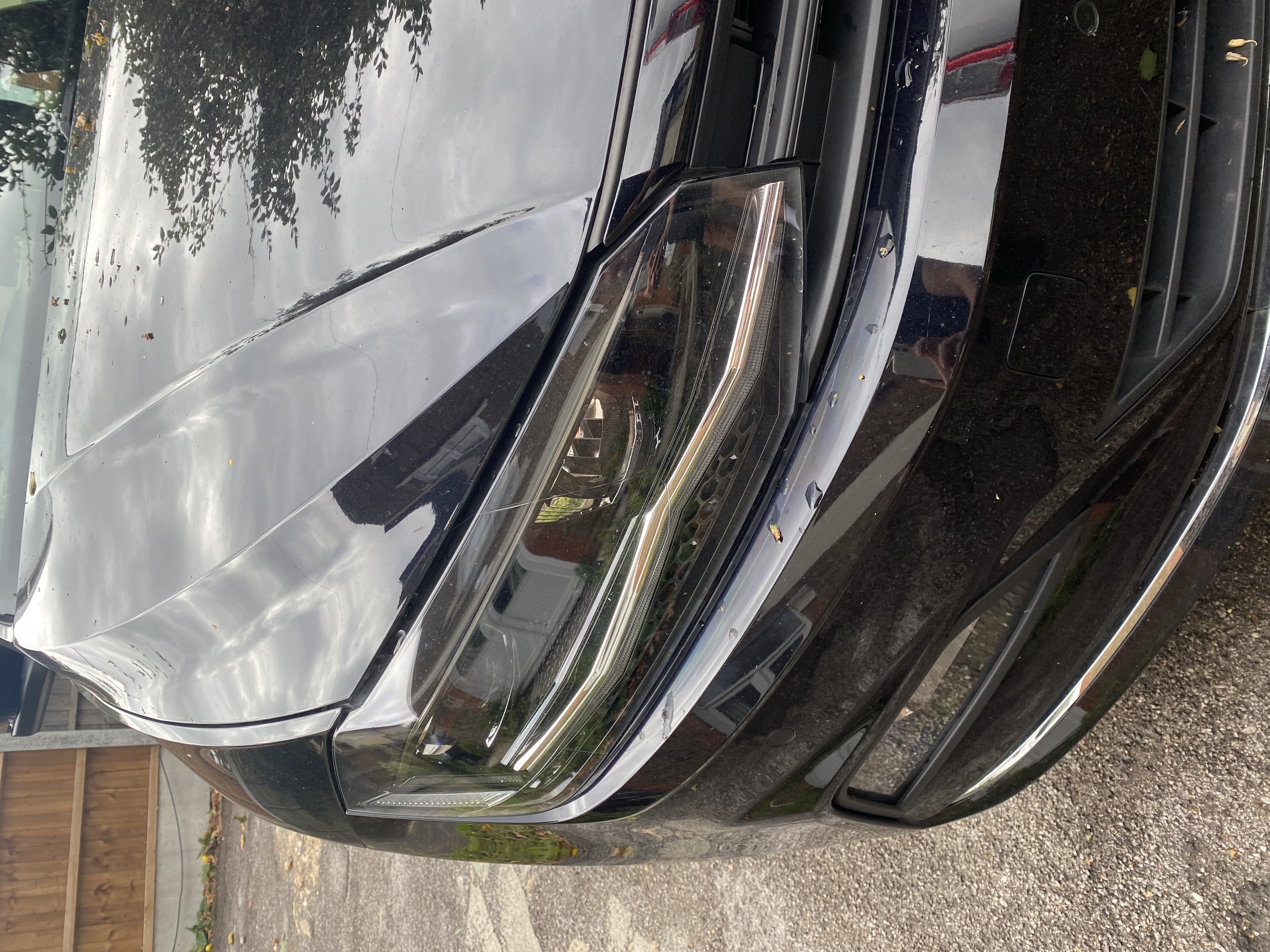

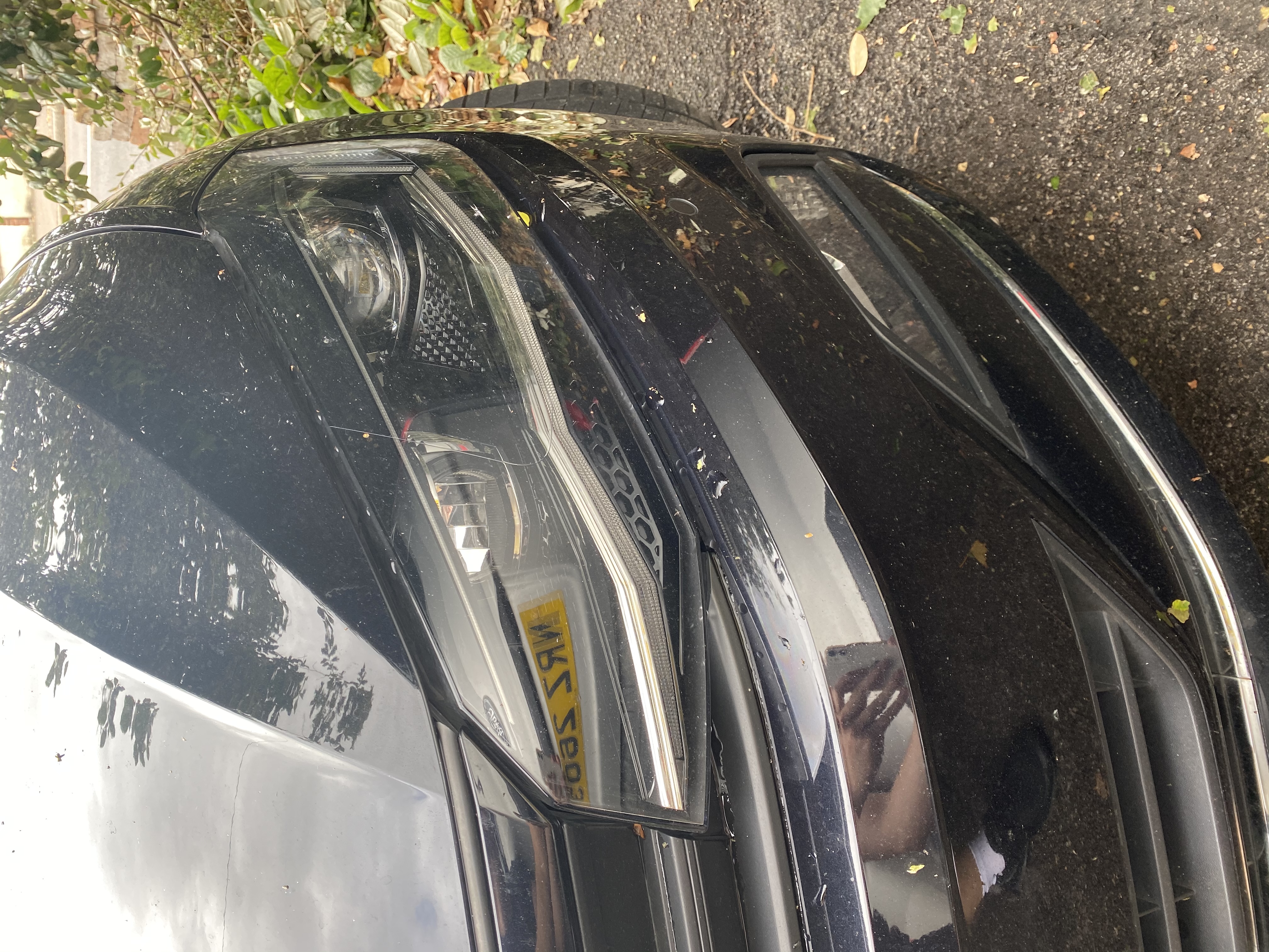

So it’s booked in for 3 weeks time, the reception man came out and immediately noticed it, especially where the grill red strip touches the near side light but about 5mm clear of the offside light. Also the bonnet is noticeably lower than the wings so the wings poke out at the ends. I think the wings might be ok it’s the bonnet, lights and grill that need adjusting. Also I’ve pointed out a knock noise from the drivers side rear suspension which they are going to look at.

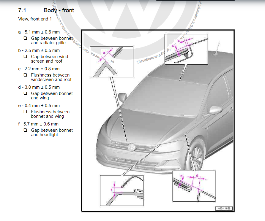

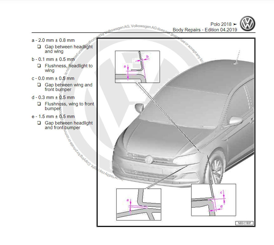

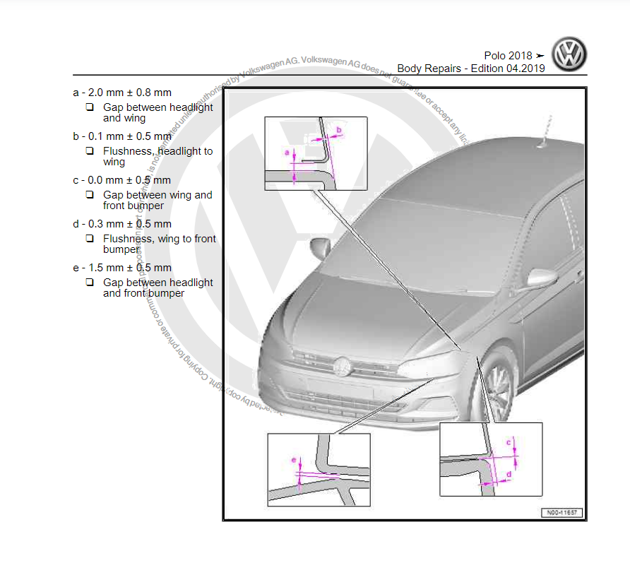

For reference, these are from the workshop manual recently posted in another thread >

Thanks for that I’ll print them out and leave them on the passenger seat for them to “notice”!!

So just thought I would update front panels bonnet etc all been adjusted and I’m now happy. Although still dont have car back as they are investigating rear offside knock noise. So far they have replaced top mount and spring but noise still there so they are thinking maybe somewhere further down in the bodywork. It’s annoying as although it’s nice to drive the entire VW range(so far had a arteon, tiguan and now onto a golf) I just want my car back!! Can’t fault Ipswich Wolsey though they have been more than helpful.

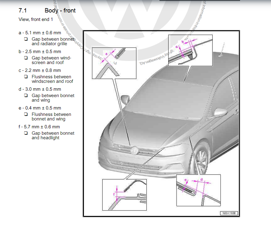

Here are mine for reference.

How do you alter that gap between the bumper and rear quarter if there is a gap ?

POLO Clive wrote: Wed Aug 26, 2020 7:35 am Check the bumper to wing, and bumper to quarter panel alignment as well, I've seen some really bad ones :shock:
How do you alter this gap between the quarter and bumper gap ? Mine has a gap more on one side than the other
