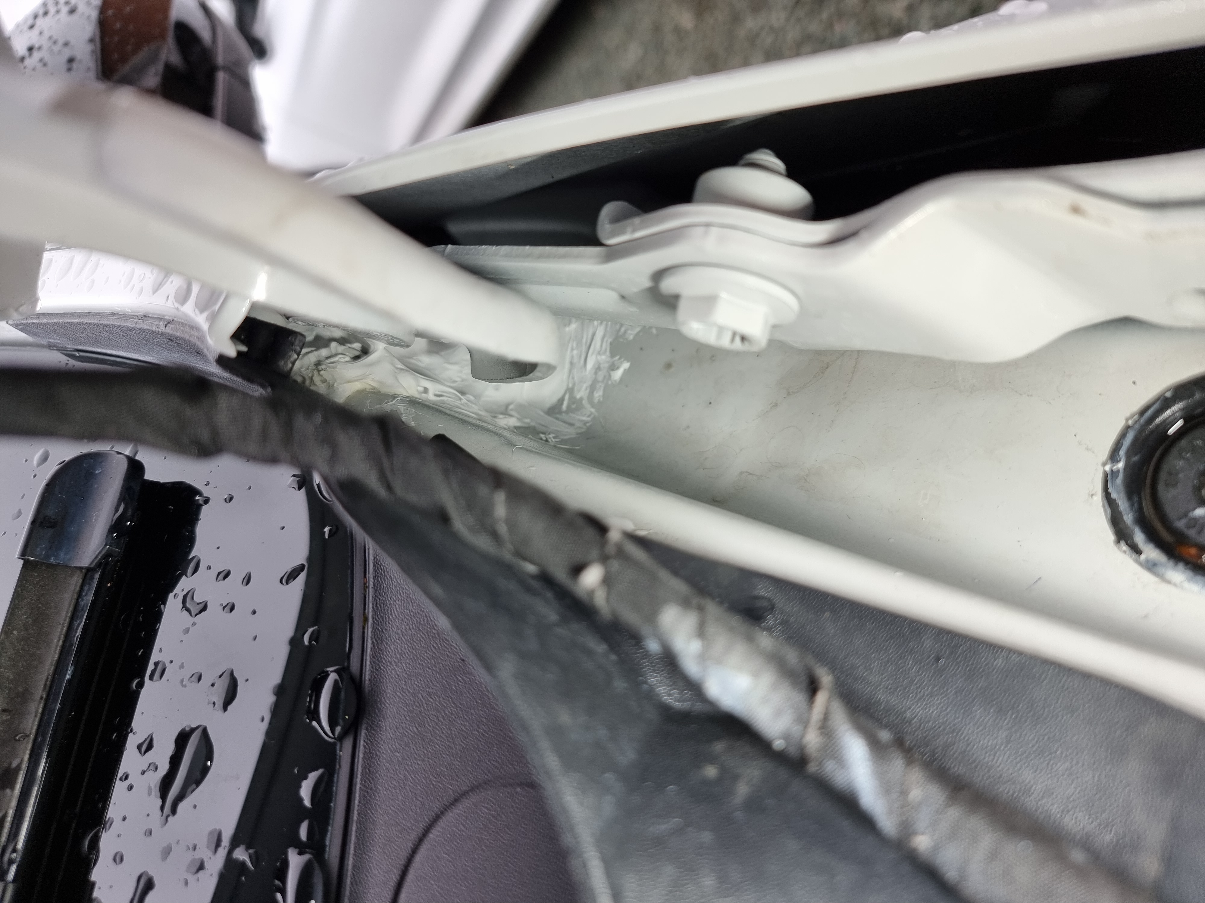

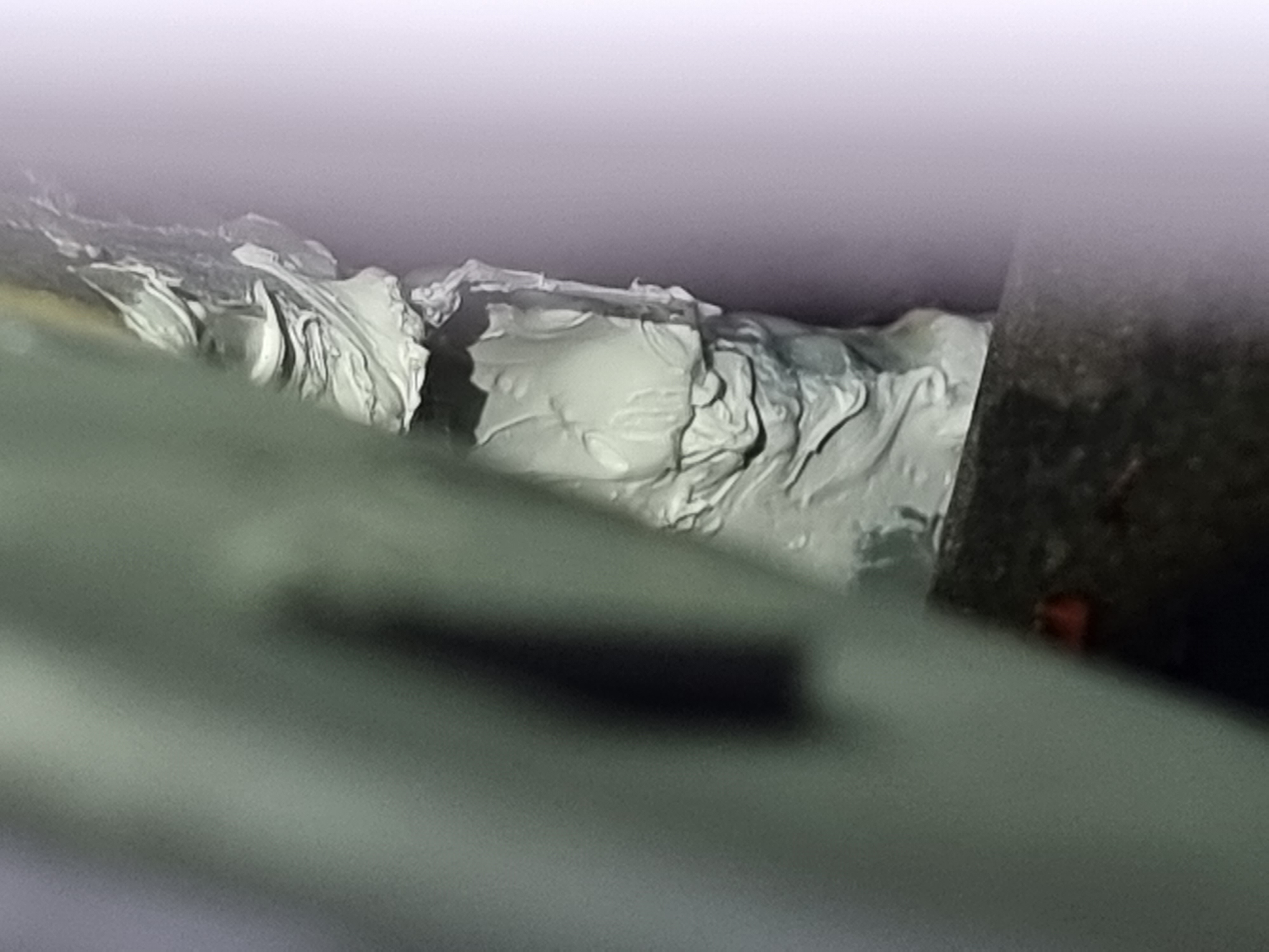

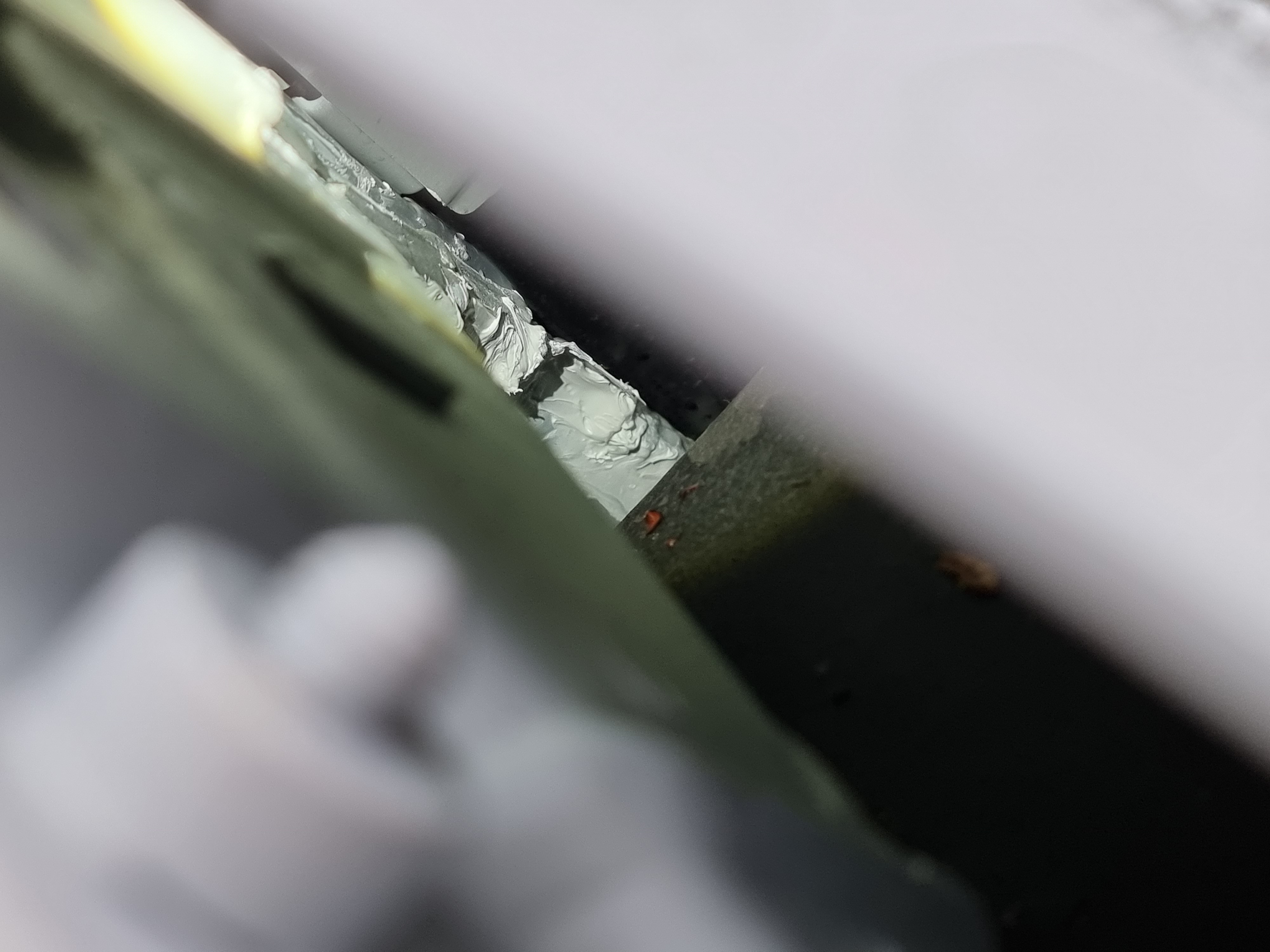

Hi, I haven't posted on here for a while due to the fact I've been waiting for answers and parts from vw. So vw agreed to change my carpets and underlay under warranty due to the water ingress damage, I had to wait and month and a half for parts to be delivered. The car has only done 2800 miles and just turned 7 months old
I noticed another water ingress issue on the front passenger side of the vehicle whilst waiting for the parts to be delivered and a fitting date. I informed vw of the new water ingress issue when my car was going for fitting, they were going to investigate the issue. The water leak was coming from the behind the dash and leaking in the the dense insulating foam which is tacked all the way behind the dash and it was wet up to half way. VW had my car for just over a month whilst sorting all of this out. So they did a water test on the vehicle to find a leak below the windscreen which was sealed, then another water test was carried out but the water ingress issue was still present. After more investigation they found another leak coming from the nearside wing area, they sealed that area up but still no luck and had to do more investigating. They carried a deeper investigation into where the leak was coming from and found out that the nearside wing box section was missing the sealant from the factory allowing water into the vehicle, so they apparently sealed this up to vw standards which is questionable? Also this seam which the sealant was missing from runs from the bottom of the wheel arch all the to the top near the windscreen. This has made me think what else have they missed off in the manufacturing process and how is the vehicle structurally sound. Also they dried out the foam with heaters and told me to replaced the foam it meant taking the whole dash out of the vehicle. I have finally received my car back from vw today and hopefully everything will be OK with it. Whilst my car was with vw I had a courtesy car which they sold, which meant going back to pick a new one up.
I have contacted vwfs for rejection of the vehicle because I don't think a vehicle should have this many water ingress issues and bits missing from the manufacture processes. They have told me it will take up to 8 weeks for someone to assigned to my case, if anyone has anymore info about rejection it would help please. Also I wanted to make people aware of the issues I've had with the vehicle and the missing sealant on the nearside wing, incase anyone encounters anything similar with this model.
I have attached photos of the sealant done to vw standards apparently
