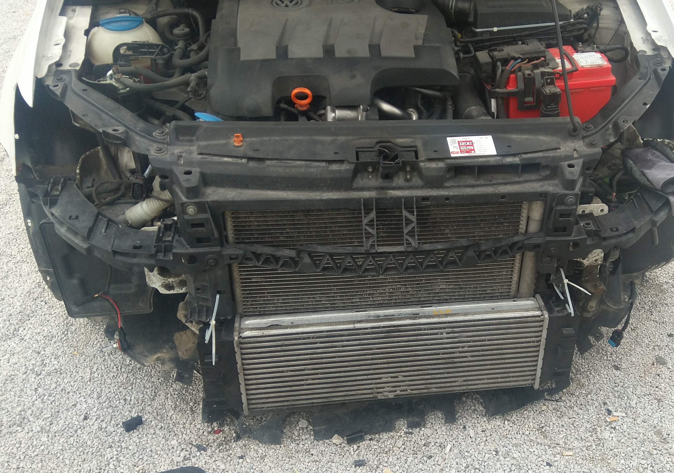

Well guys more surprises :|
Sorted out the panel gaps finally and was installing the screws at the bottom of bumper to be greeted with broken plastic which I never noticed before.
Anyways removed the bumper again to find that the whole rad slam panel is broken from underneath :shock: :roll:
Is it a common thing on the 6R's? Also without removing the whole radiator, can the slam panel be replaced?
Going to price the parts tomorrow at VW's :( Don't want to buy the cheapy replicas on ebay.

You dont need it hahaha. Btw. Keep the holes where the bumper clips in. I cut mine almost half the way up. Just make sure the radiator support brackets are ok.
Yeah all out job. But when you remove the support beam 4x 13 mm bolts, and 4 tx30 for rad support when you put it back add firstly the bottom 13 mm bolts and then 2x tx30 rad support then pull the cross beam up. Then add 2x tx 30 and top 2x13 mm cross beam bolts. Make sure that you pull the cross beam up, ot just mark it position before removing.
( These tx30 can spin so get a wrench and hold the nut insert from the back).
It is crucial for gap aligment! Close the hood before you put the bumper back!

Thanks for the suggestion mate. You made it sound easy enough. So basically I want to avoid disconnecting the radiator. I am sure I can replace the rad frame without the disconnecting?
Are you saying yours was also broken? Did you just leave the bottom bracket in place? Seems like a common issue in 6R's?
Re: 6R Headlight mounting
You cant without removing the radiator. ( At least i dont know how) I think it not possible.

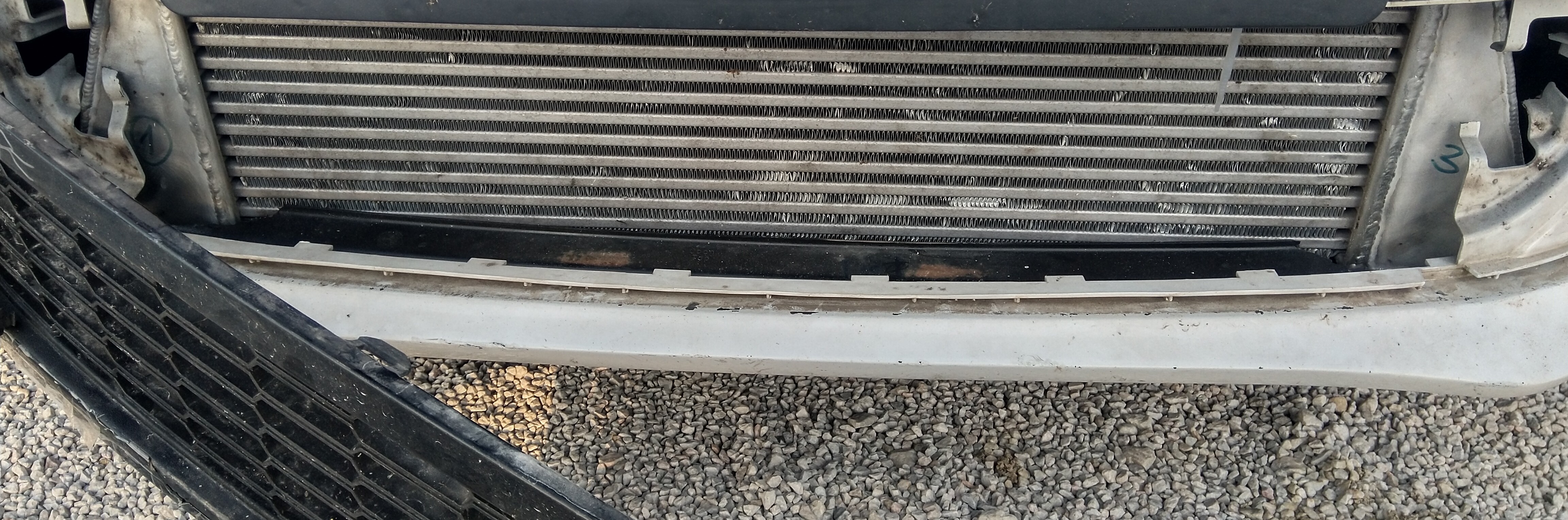

I have trimmed my "radiator support" almost half way up to be able to squeeze a big intercooler. I have no issues.
I know that where your part is broken that it screws in the front lip of the bumper ( aka spoiler).
I have even cut the inside bracket on the bumper. If you dont want to change the broken part cut it off, or patch it up. Just make sure if you are running the plastic belly pan to secure it so it doest fall off.
I will insert a photo when I was mocking up the IC position, so you can see how far up I have trimmed the plastic radiator support and no issues at all.
I personally think if you cut or fix that part you wont have any issues. But if you want a perfect car change the whole thing.
Yeah, i made a mistake buying then measuring :mrgreen: . But my core is 210 mm tall and 80 mm thick. Its from a 2008 Sprinter. If I was to do this a second time i would buy a thinner core ~ 60 mm and height ~ 170 mm would be perfect.

Well just priced it with dealer for a brand new panel.... guess what?!?! £250 :shock: :oops: I am fixing the car on a budget and it will have a massive impact when it will come to sell it.
Think I am going to have a go at plastic welding. Every used frame on ebay is either cracked or broken. Seems like a design flaw imho. There are replica parts which I don't want to invest in as I already had a bad experience with replace headlight bracket.
So as you say, the radiator doesn't rest on it entirely?
Go ahead weld it, add pieces of wire to make it stronger.
Yes the bottom part doesn't matter, there are bolts from the side that tie in the cross beam to the radiator support and in your case these points are not damaged.
It will be all fine.
That part probably broke because something hit your bumper and pushed it in a little bit.
Make sure that the pipes for the condesor that are behind arent damaged this ( or your AC wont work)
