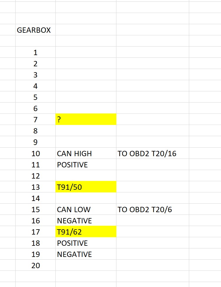

This what I have so far

Do I need T20e/7 (speed signal)?
Re: Polo 6R PQ25 to MQB
I don't know but on these diagrams the wires are almost always indicated with a reason.

T20e/7 is connected via T14/13 to T105/8, like I wrote here:
viewtopic.php?p=592997#p592997
Powertrain canbus is not taken from the OBD2 plug but best taken from the orange/brown and orange/black canbus wires at your ECU.
Positives are divided into permanent positives (terminal 30) and switched positives (terminal 15, 75, etc).
It looks like T20e/11 and /18 are permanent positives.

iichel wrote: Fri Sep 09, 2022 7:57 am T20e/7 is connected via T14/13 to T105/8, like I wrote here:
The dq200 already have canbus wires coming from ecu so thats luckily sorted, next issue I will be facing is adapting the immo of the dq250, Volkswagen South Africa just said "no they cant do it", do you know of a way to get it sorted? Immo off can also be a option, however I would need to read the current tcu and ecu mac, cs and powerclass, which I dont have the tools to do so

T20e/17 would be Terminal 15 if im correct according to the BCM
