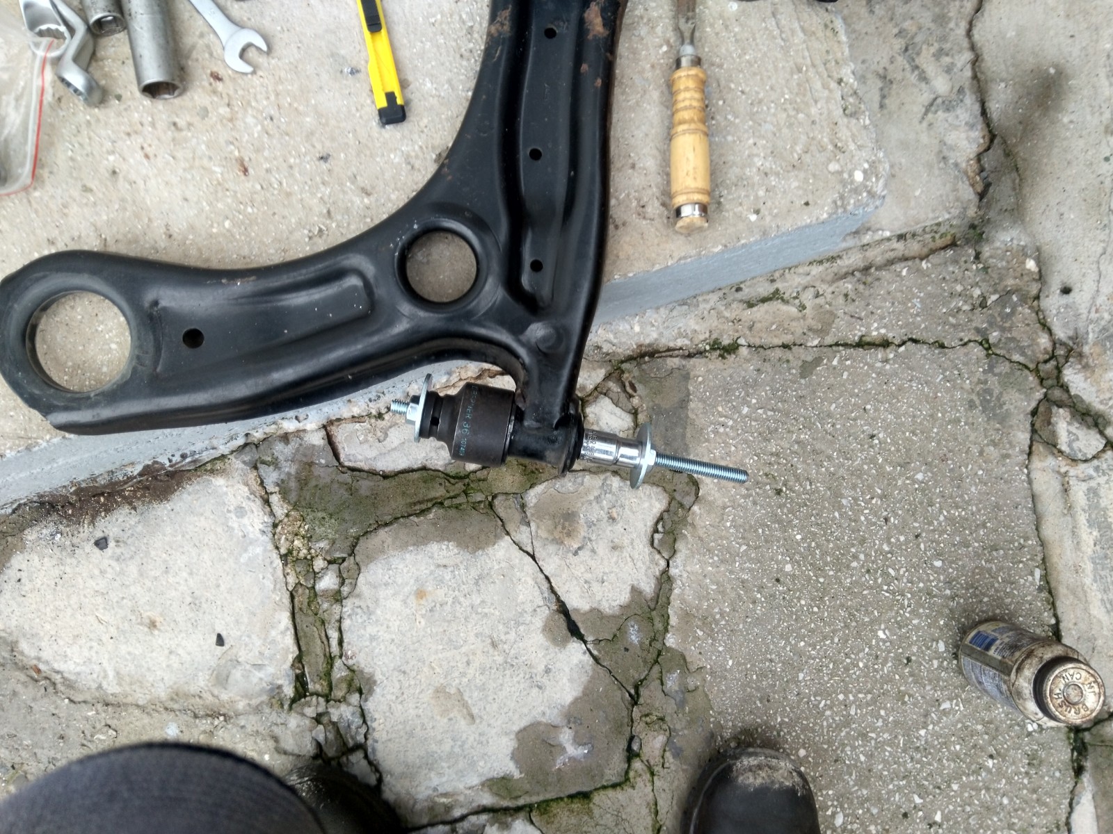

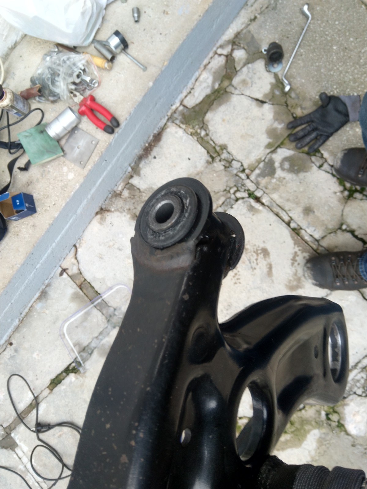

I finished my swap yesterday
I recommend spraying the bolt thats with a nut night before with WD-40. I must say it's tight like a mf. I did mine on the ground.
Be sure to measure the distance from the center of the fender arch to the middle of the wheel before dismantling everything.

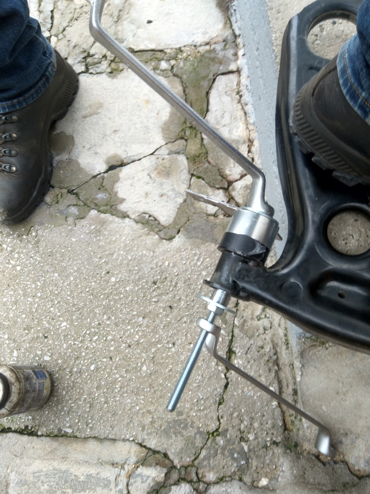

Sliding out the front control arm is easy job! And pressing out the small bushing just use a m10 threaded rod, socket 36-36 mm, 13 mm socket, two nuts and washers. Installing the new one is easy. I used A 50 mm pipe, but 36 mm socket works great but it isn't deep enough for bushing removal. For installing it's works great!
For the larger one you will need a cup with inside diameter not less than 66 mm. - I cut out the rubber piece, and scored the aluminum ring with a hacksaw and punched it out with a chisel and hammer. It was easy!
You press in the bushing from the top of the control arm ( you can see it is coned shaped and has to lines - these are used to align the factory bushings).
To reinstall the front control and, jack the car up by the disc. This will allow you to slide it in straight, first the larger bushing end. Then put a bolt and the nut, then slide the smaller end into the subframe ( use a large screwdriver under the wishbone to pry it up to help you align the holes for the bolt). Thread the bolt in. ( if you are going to reuse the old bolts, clean the rust very well from them).
Be careful ( on the side with the longer driveshaft) when you jack up the wheel ( while the ball joint is not connected to the control arm) it wants to wander off and pull the CV joint from the axel. ( Ask me how I know, I had to remove the boot to tap the CV back on to the axle) So zip out the 36 mm nut for the cv joint. And then Jack up the disc. ( You only have take this precaution on the longer axle side).
Then bolt down the ball joint to the control arm. Jack the disc again to the length that you measured before you dismantled everything. Then torque the control arm bolts 70Nm+ 90 deg.
Use a jack stand!
I did this all on the ground with the jack that comes with the car.
Good luck! Don't sweat it!

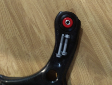

I'm looking at chucking a set of Ibiza Cupra arms on rather than replacing the bushes individually to get the solid rubber rear bush. Is there any difference in the arm at all other than the rear bush?

Cupra has solid mount, gti has hollow. Solid mount came on TT....
they the same

If you want longer lasting bushes get the Ibiza cupra arms (linked above) as they’ll have a solid rear bush, but this will increase NVH to an extent.
I put Ibiza cupra bushes in my previous 9n3 and found the main difference was that shock loads like cats eyes and potholes were more severe but steering felt much better with no increase in road noise, but that was a different style of subframe and LCA.
