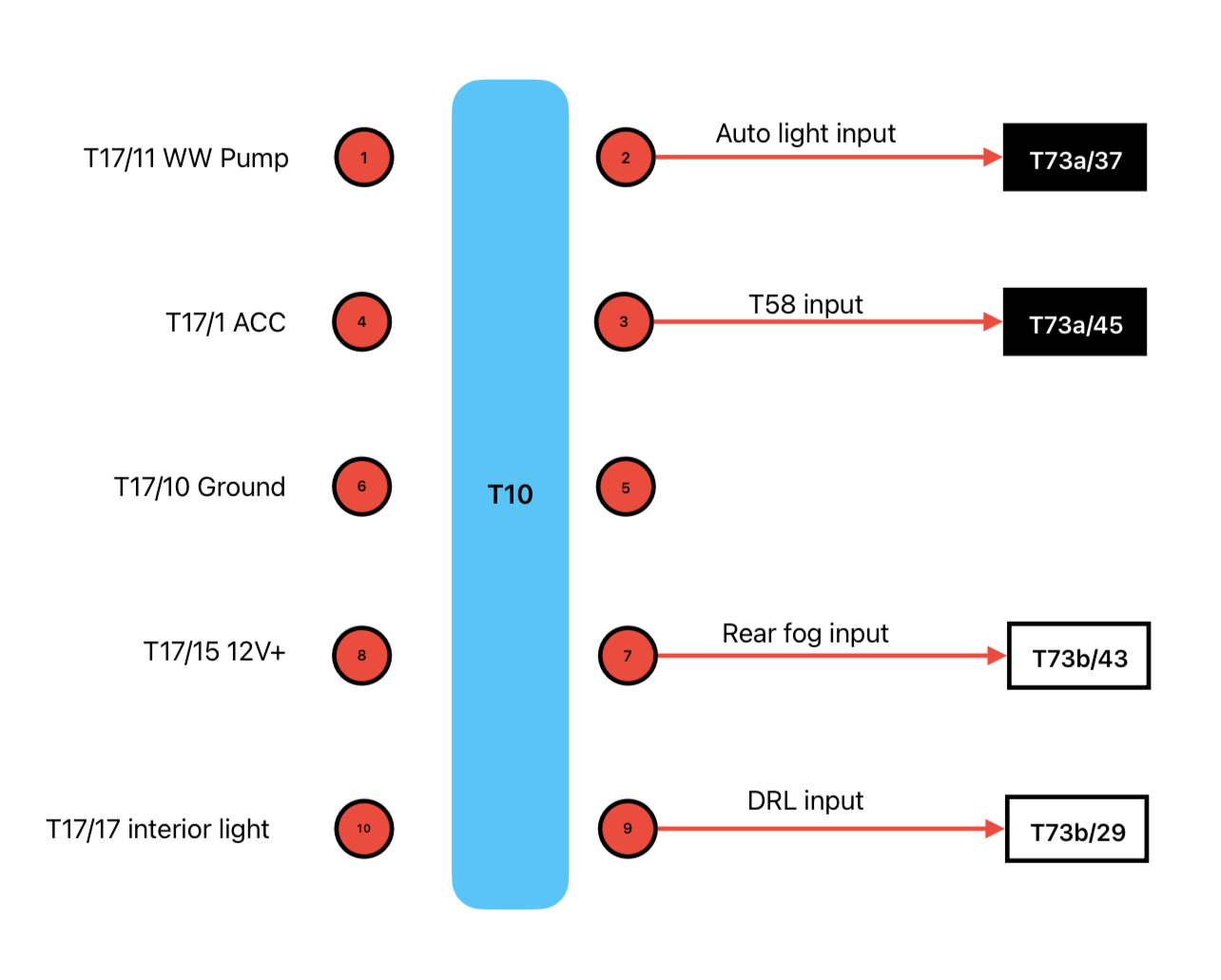

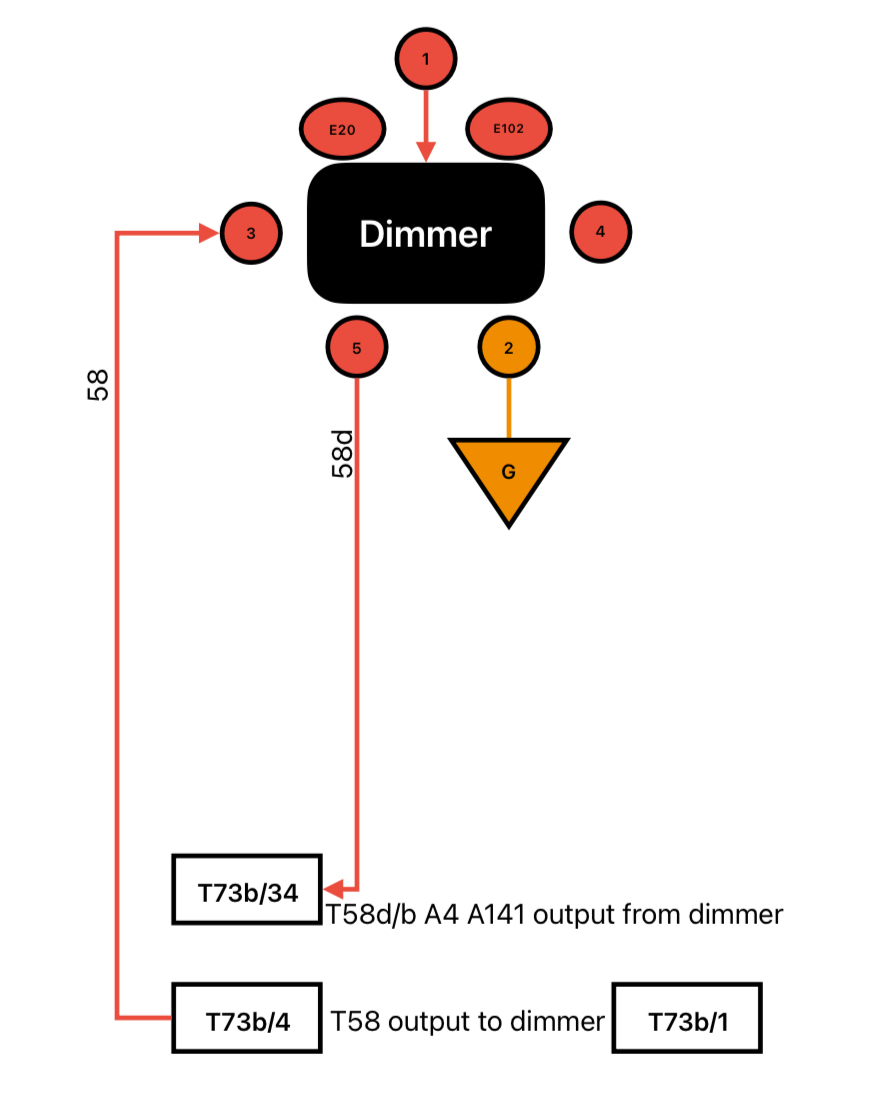

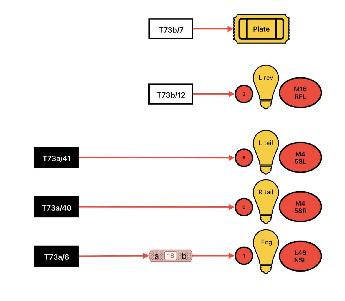

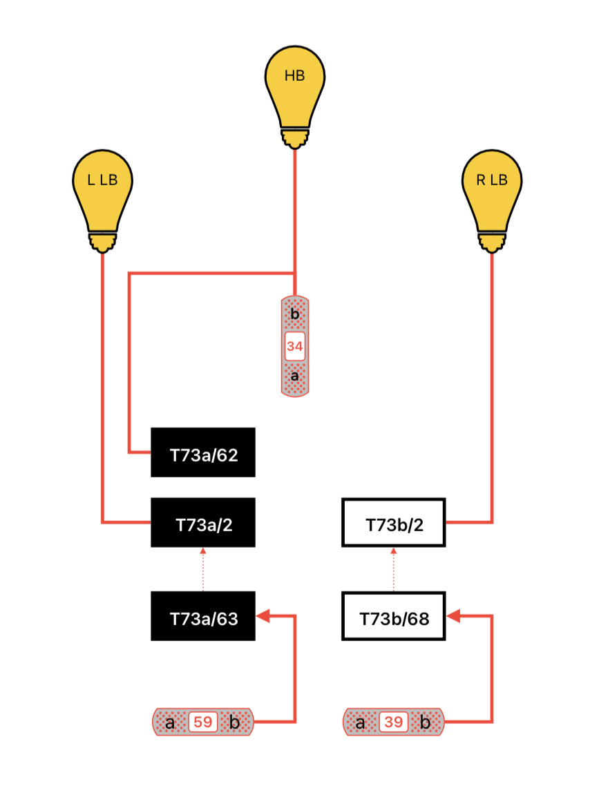

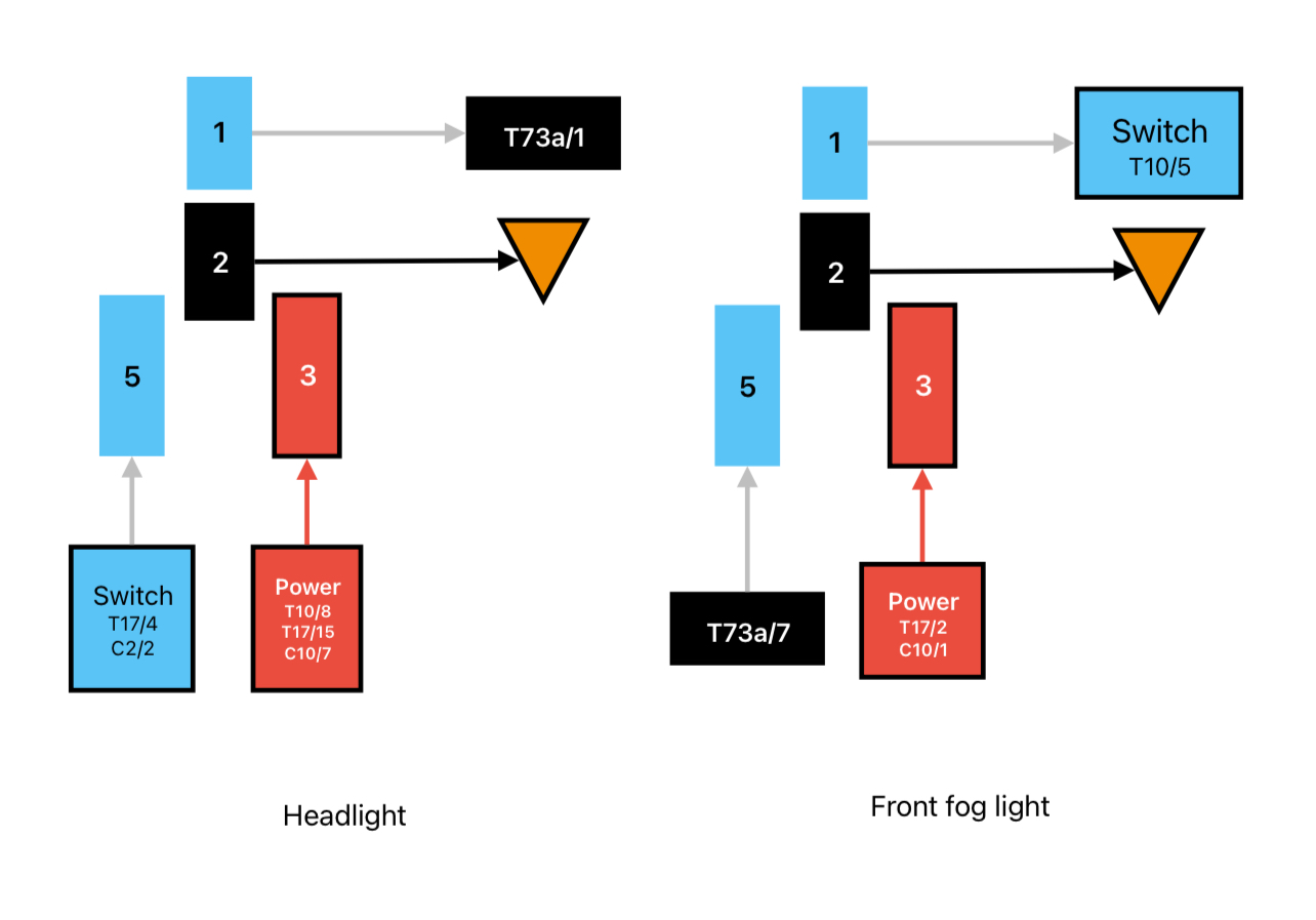

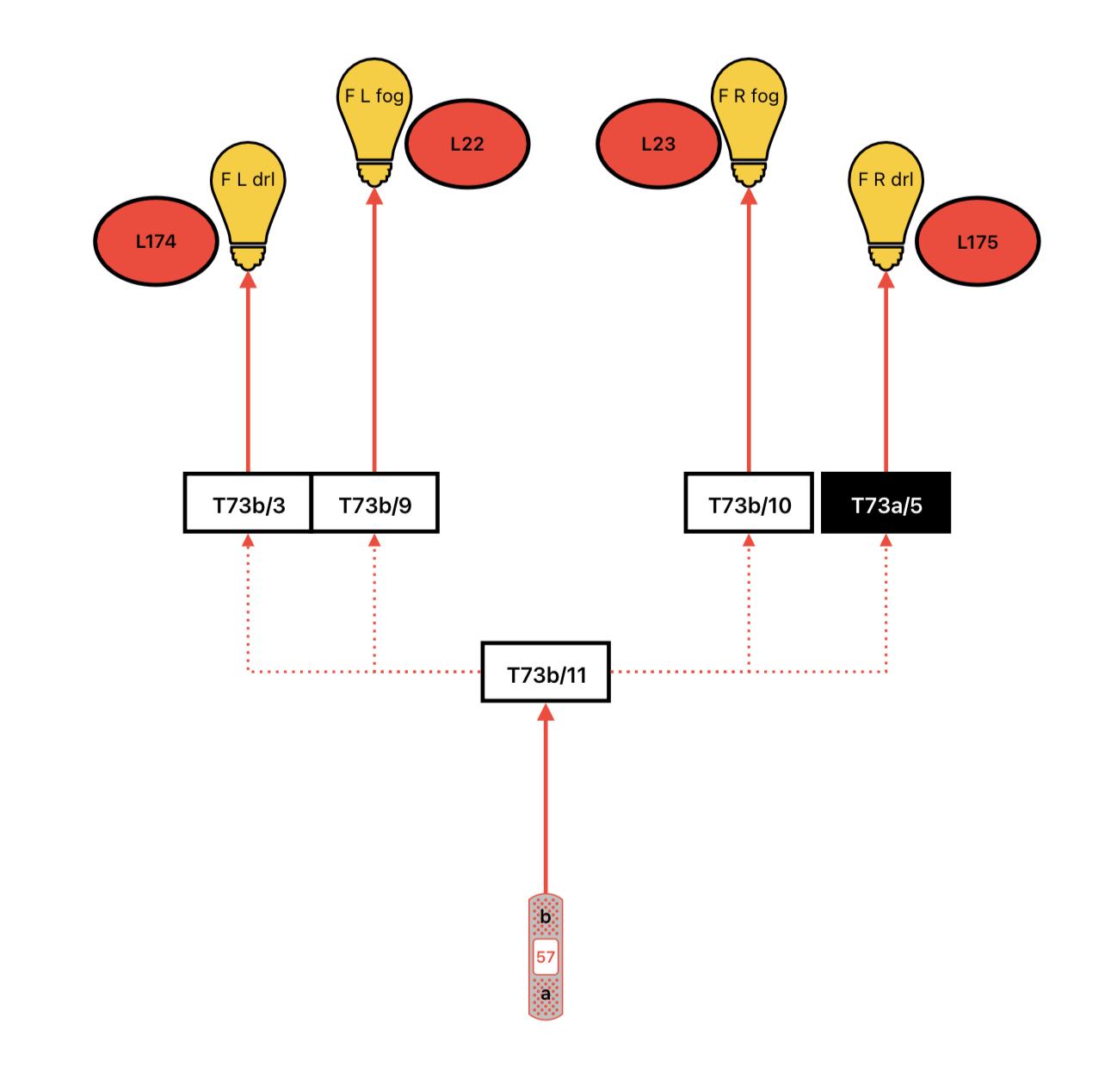

Here are some files that I created while I was doing the wiring.
Wiring diagram (from fuse to BCM to light bulbs etc)
I have compiled BCM pinout numbers and their interpretation but it is in excel/pdf but I don’t know how to upload. I know these info can be found on internet but it’s compiled everything into 1 file so hope it will help better.
I also have the VCDS coding interpretations (I tried different language of VCDS versions to compile into complete information) and it is also in excel/pdf.
Please let me know how can I upload them.

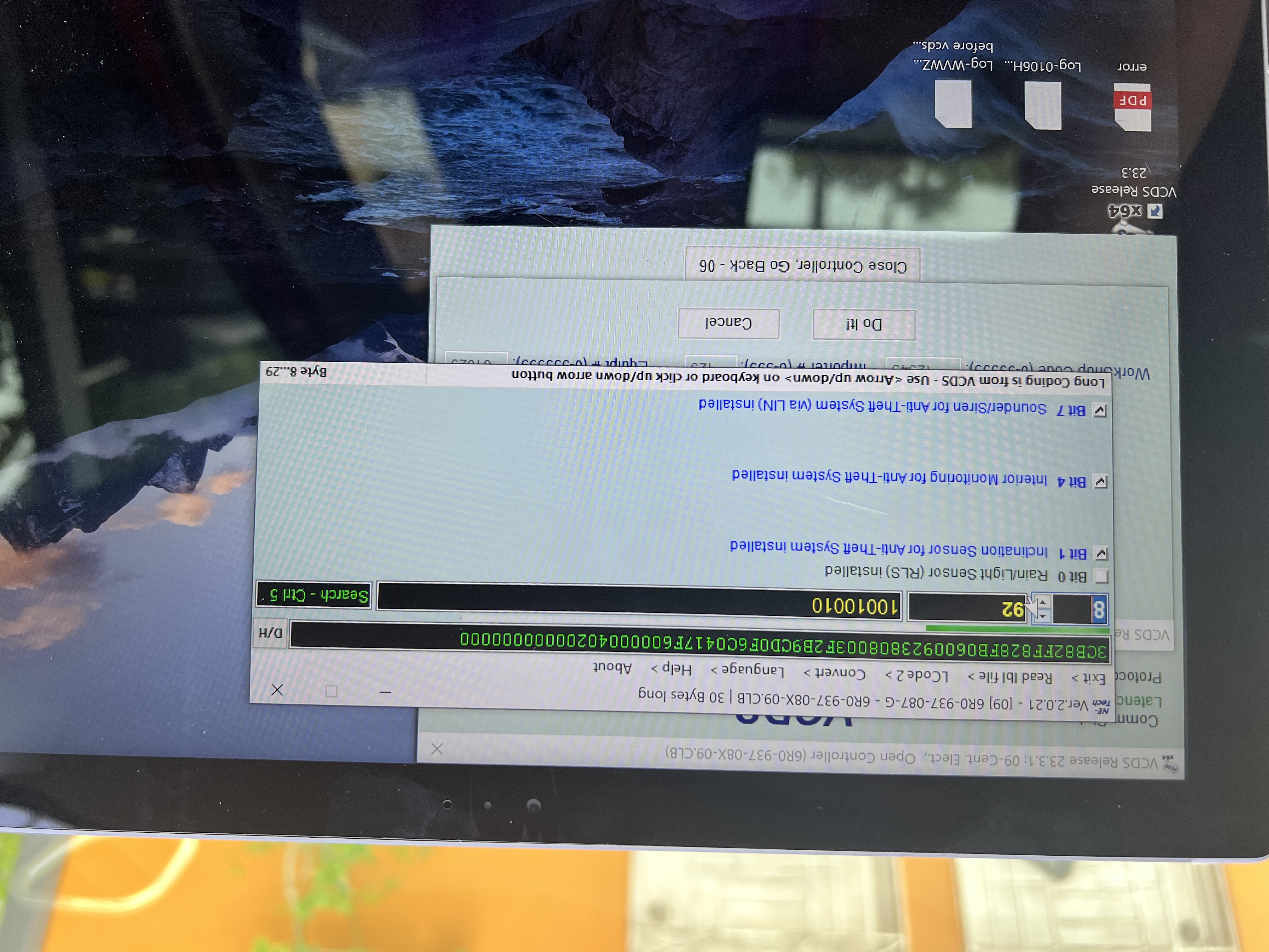

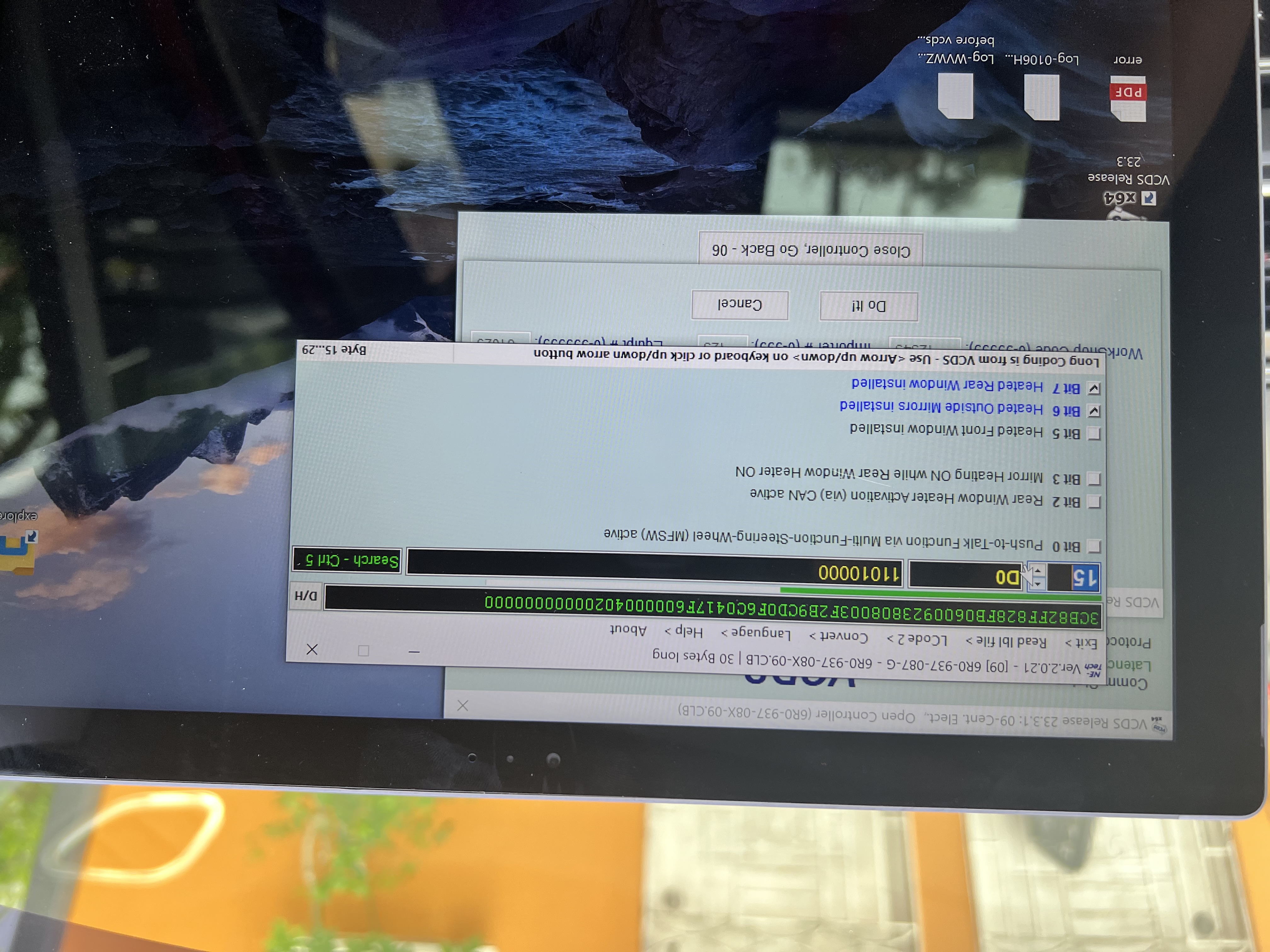

Sorry I don’t know why the pictures don’t get uploaded.
Here’s the pictures

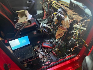

My current situation
VCDS coding
VCDS coding
T10 headlight switch
Relays
Relays
Front fog/DRL
Front fog/DRL
Dimmer
Dimmer
Headlight - H7
Headlight - H7
Rear lights
Rear lights
Posts: 8992
Re: BCM Upgrade and not able to match the key
Taking a quick look at your posts and without looking at the Autoscan it seems that they are coding problems, I'm on a trip now and I won't be able to take some time to see what's going on in your car until next week.
Nice schemes. 8)

Posts: 8992
How are you feeding the 'a' inputs of fuses 39 and 59? +30 power is required.
Have you permanently/4ever removed the J331 relay?
'Example' for J331 relay (page 7):https://drive.google.com/file/d/0B2nv91 ... QkQNBJAwgQ
Auto lights.
Are you sure you have installed the wires in the relay adapters correctly?
Any special reason for a 6R LHD to be in Jamaica?

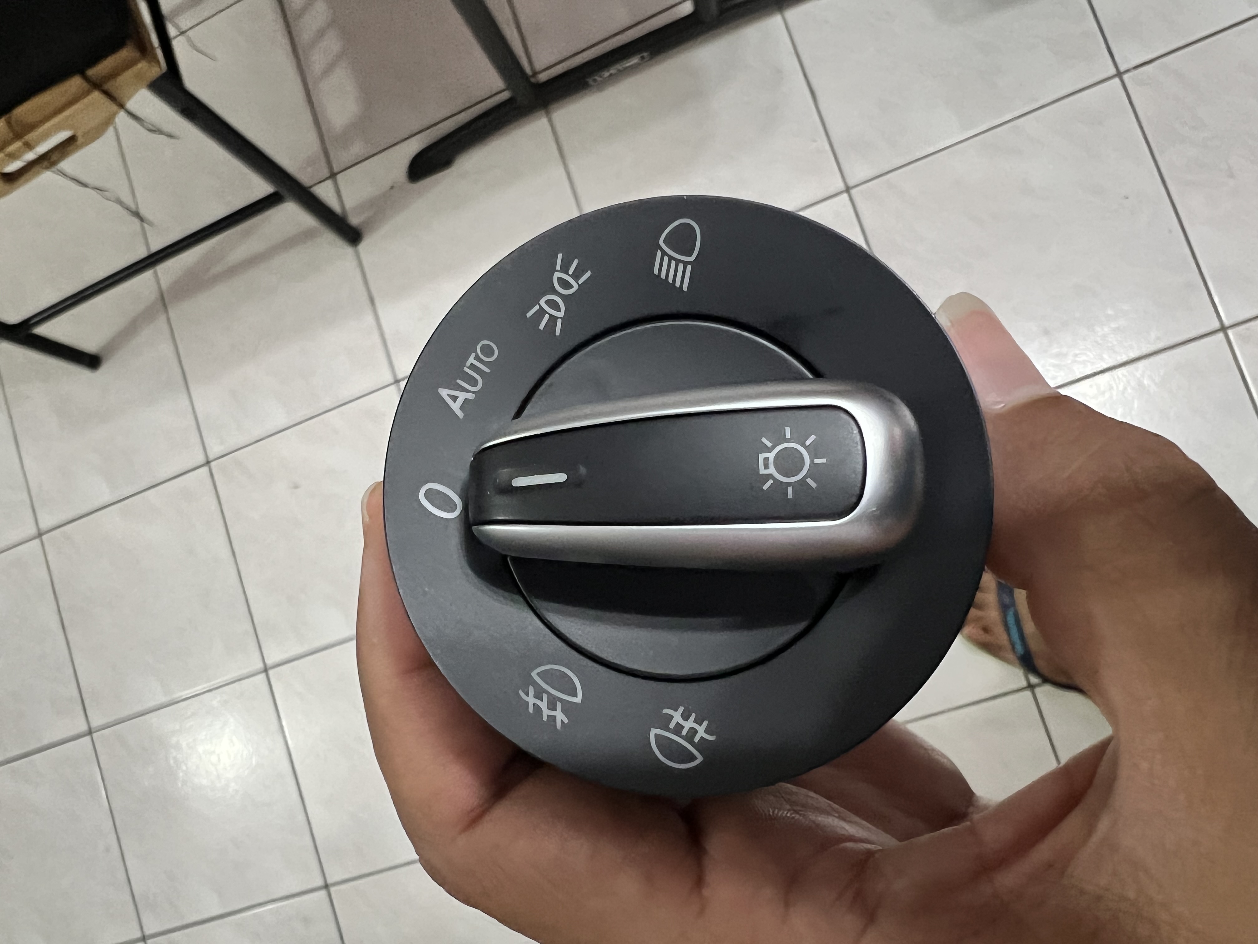

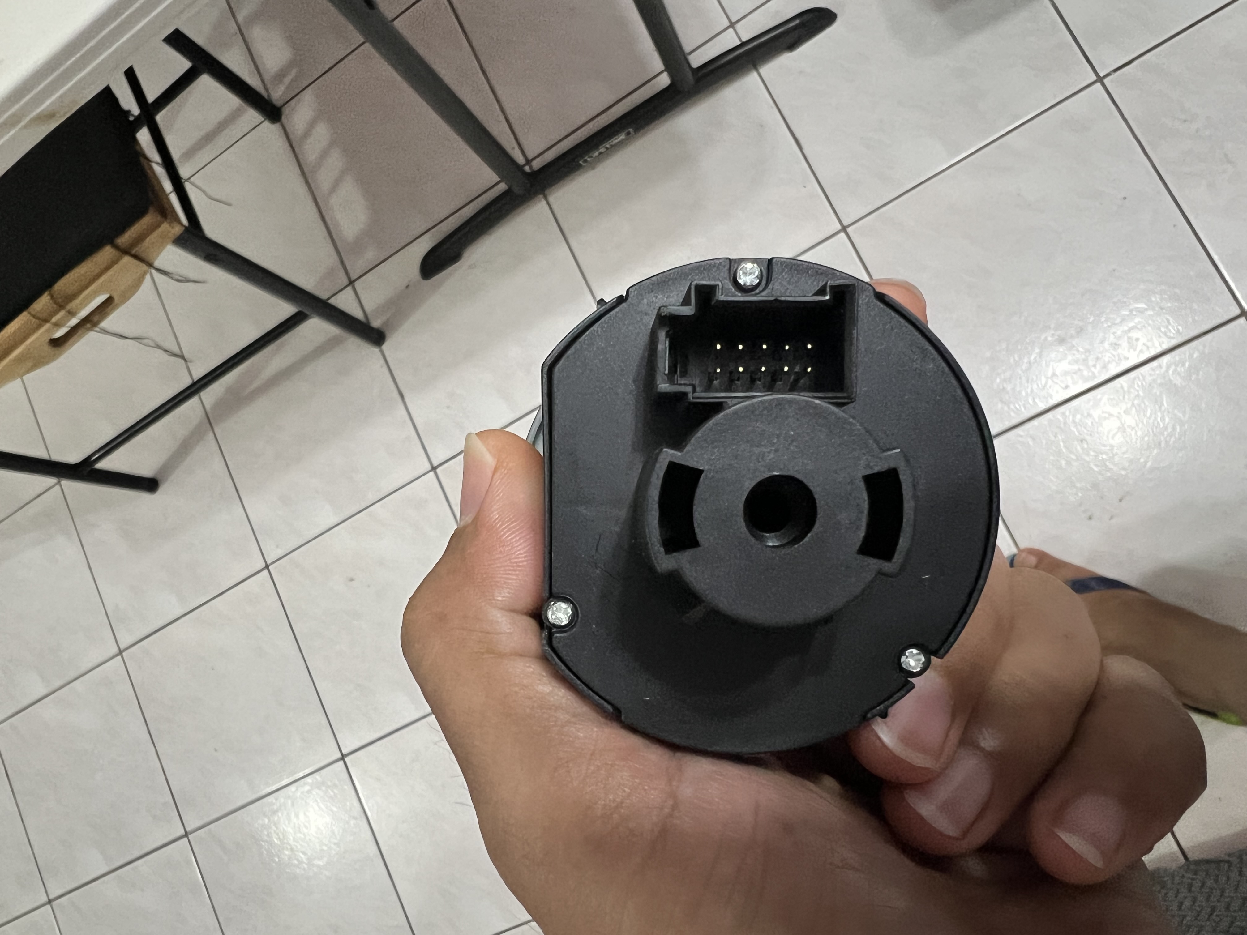

Can you show us the Auto light switch you are using (pictures of the pins and the Auto light switch already installed)? Ref number?
Who has done the coding of the 'new' 7E0 BCM Max?

Coding.
GW coding is correct as long as it is a 6R LHD 5 doors.
Latest BCM coding posted:
B8904AB868F30700913806F07CEB96D1FFC067FF608D30F1200000030000
New BCM coding: (provisional)
B8904ABF68F32400B33806B07CEB96D15FC0612F608C20D1200000020000
In addition to doing the new BCM coding and showing us the result whatever it is, and whenever possible, do the following:
1- :arrow: https://drive.google.com/drive/folders/ ... drive_link
Post the resulting file (link) here so I can see the BCM adaptation channels values.
2- An autoscan with the old BCM installed... (it is impossible to know the specific equipment installed regarding the central locking without knowing the original factory coding).
What the ....?

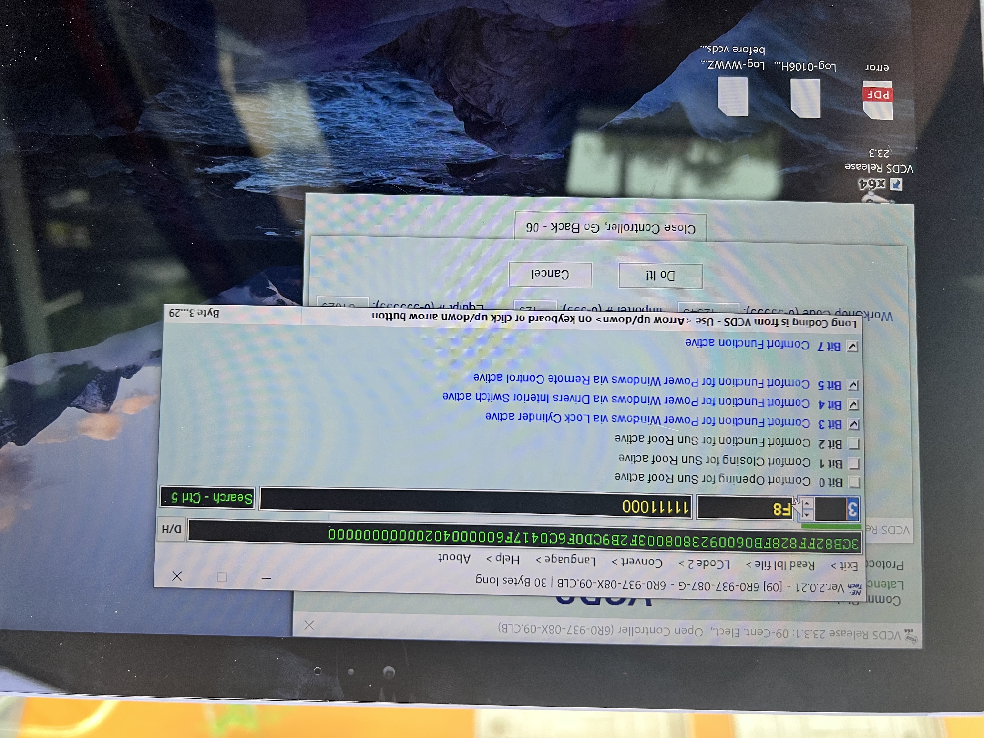

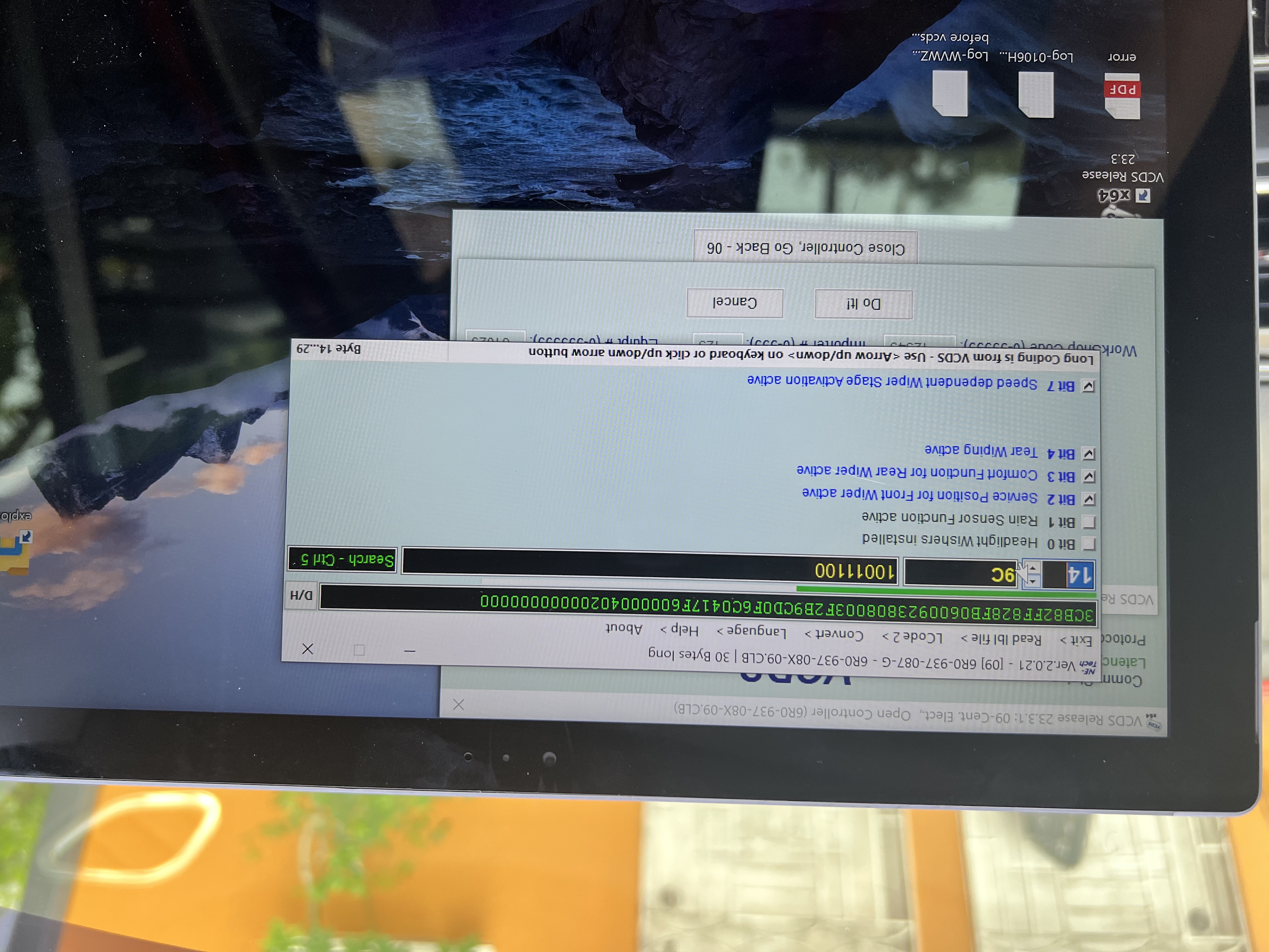

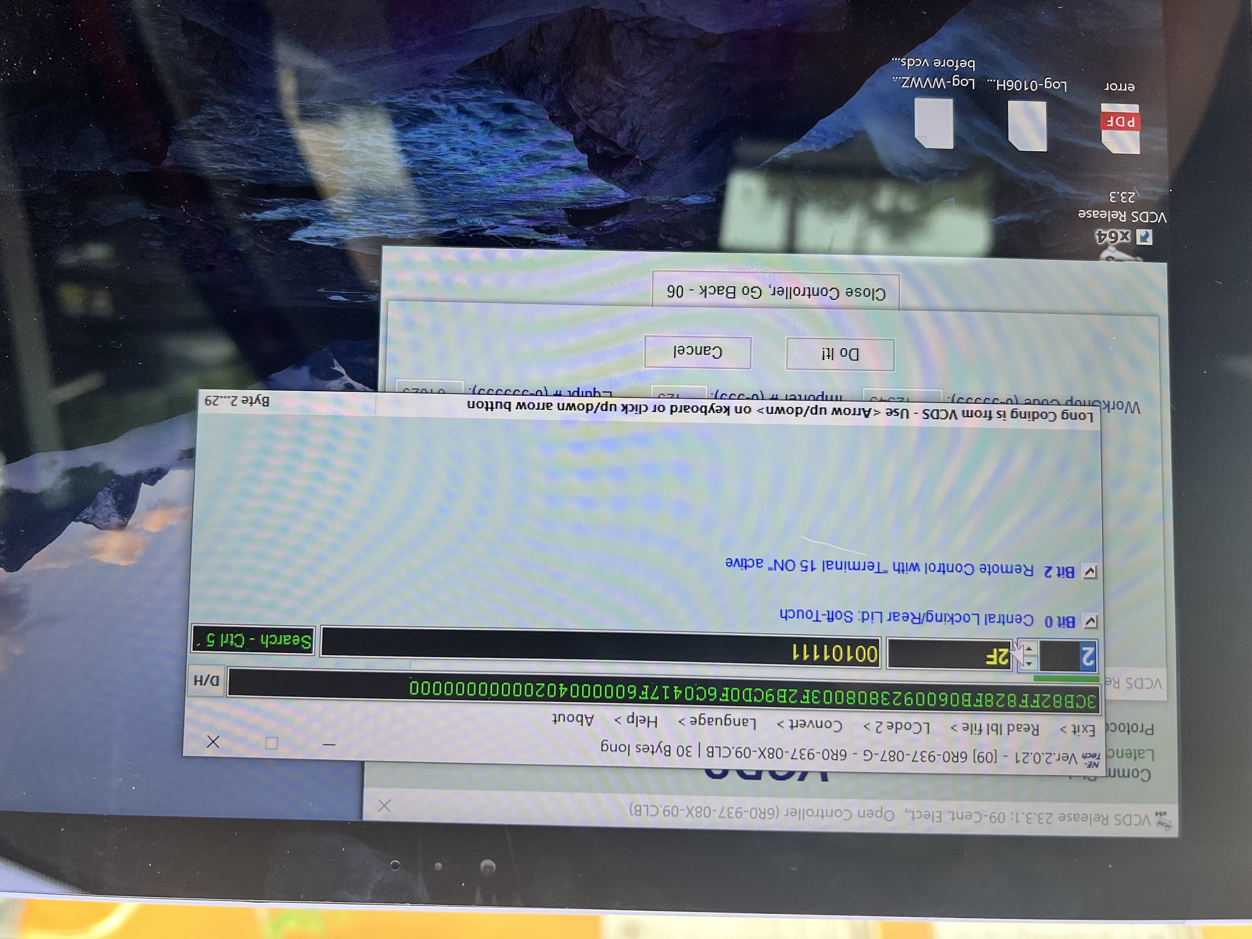

This is the auto headlight switch that I have.
Hiroki
Posts: 47
Joined: Mon Feb 27, 2023 5:34 pm
Drives: 6r Polo 1.2 TSI 2011
Location: Jamaica
Post by Hiroki »

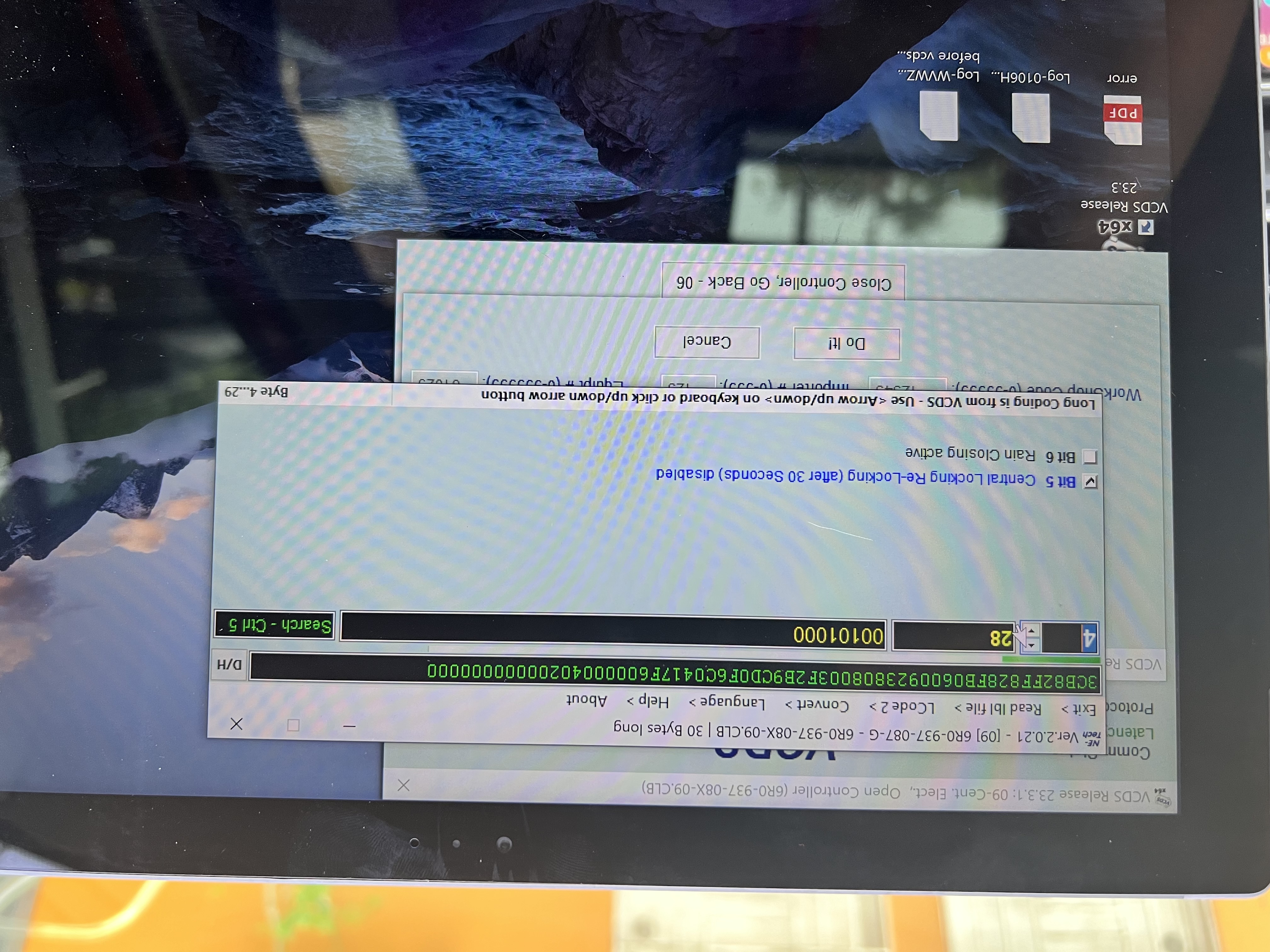

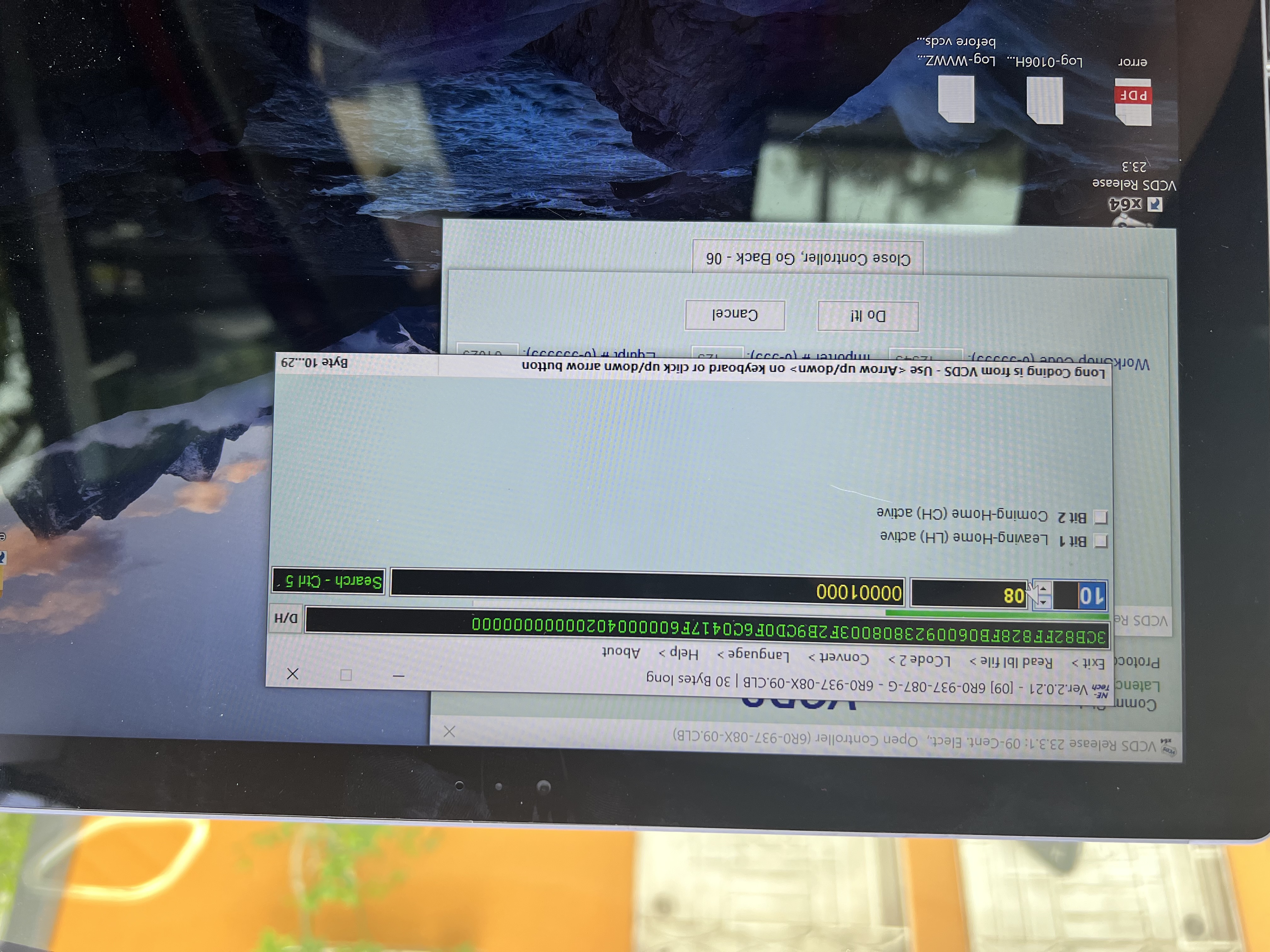

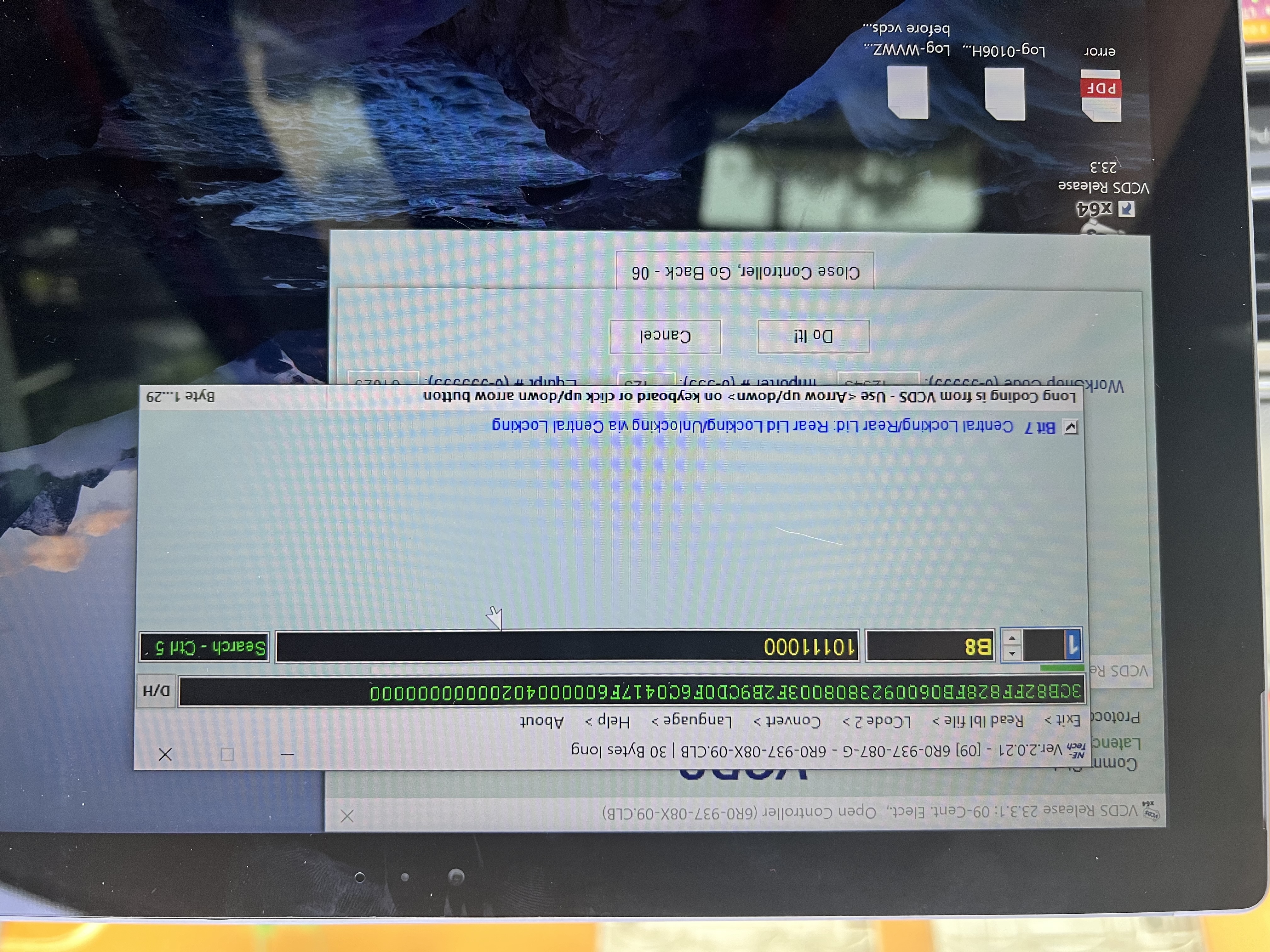

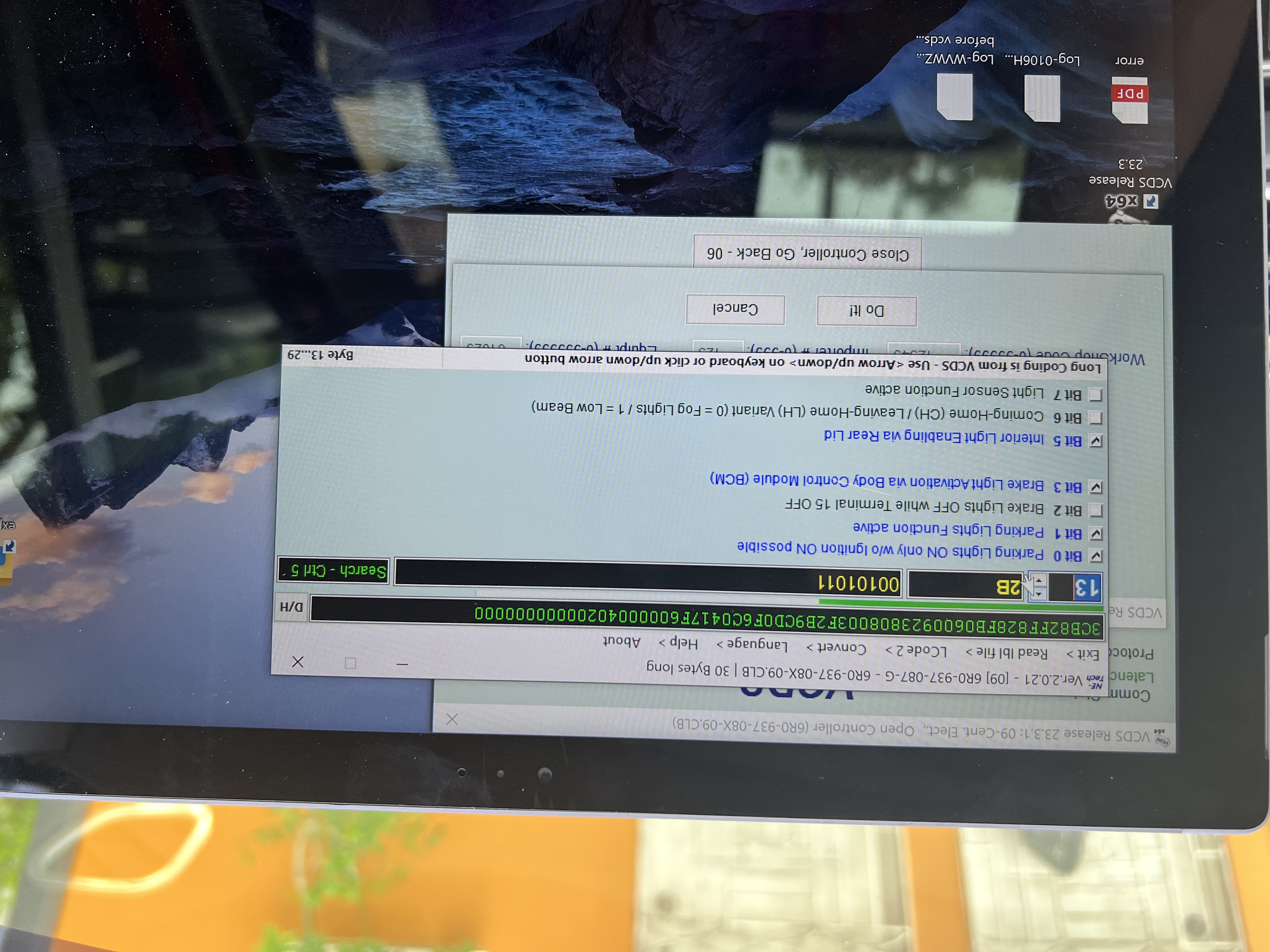

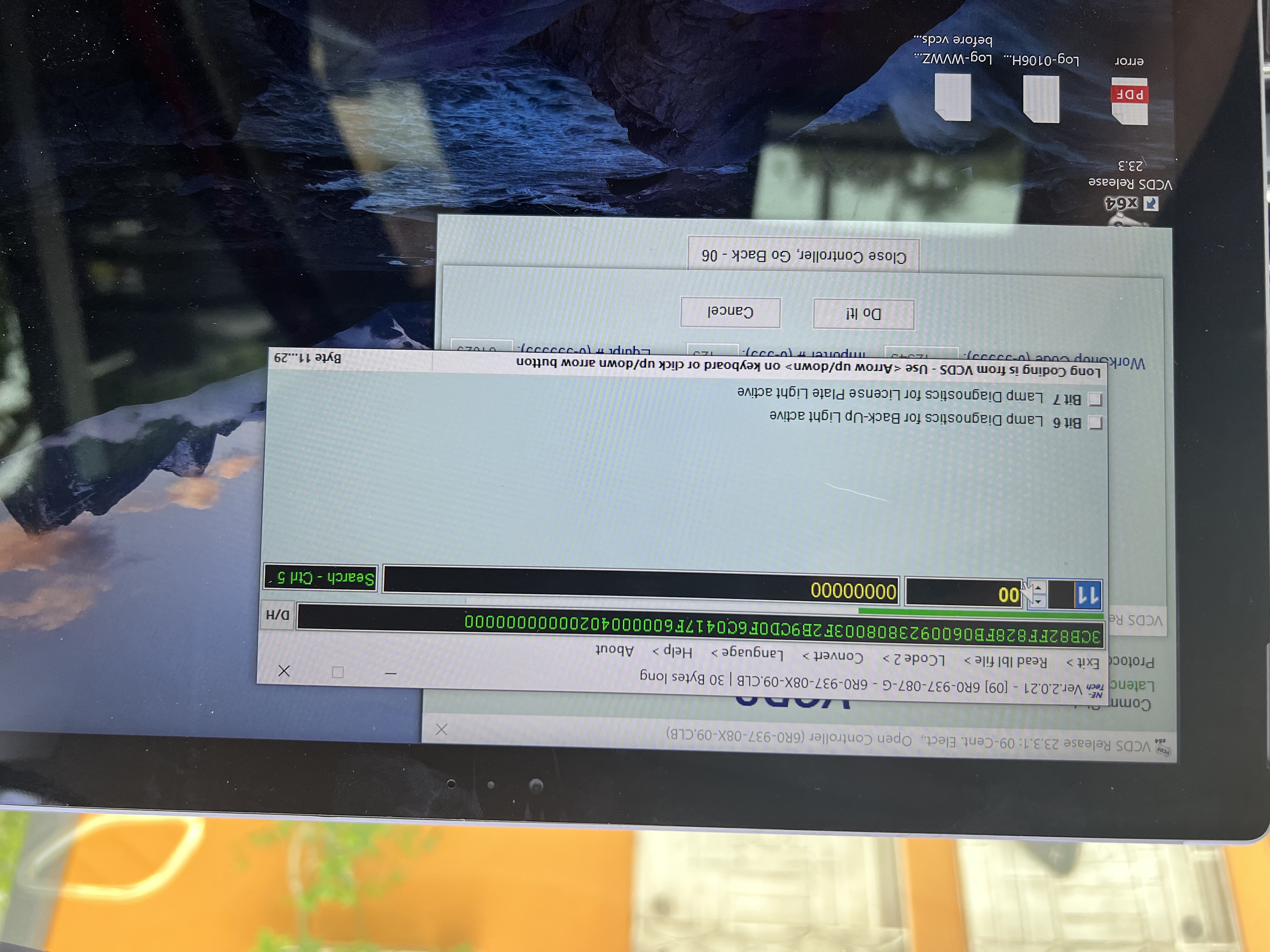

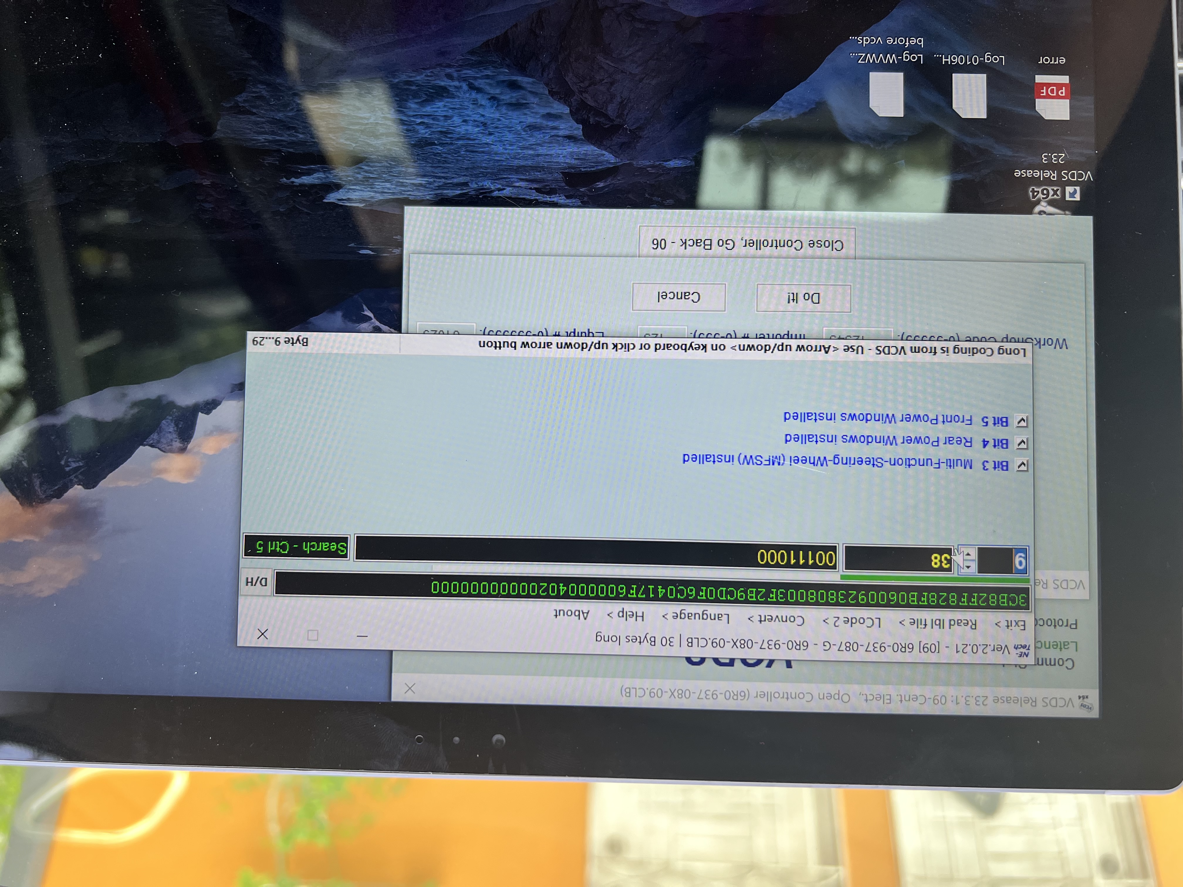

I’m not sure I can still put back the old BCM and start the car to do the scan but I will try it and will let you know.
This is the old BCM coding that I take screenshots before the swab.
