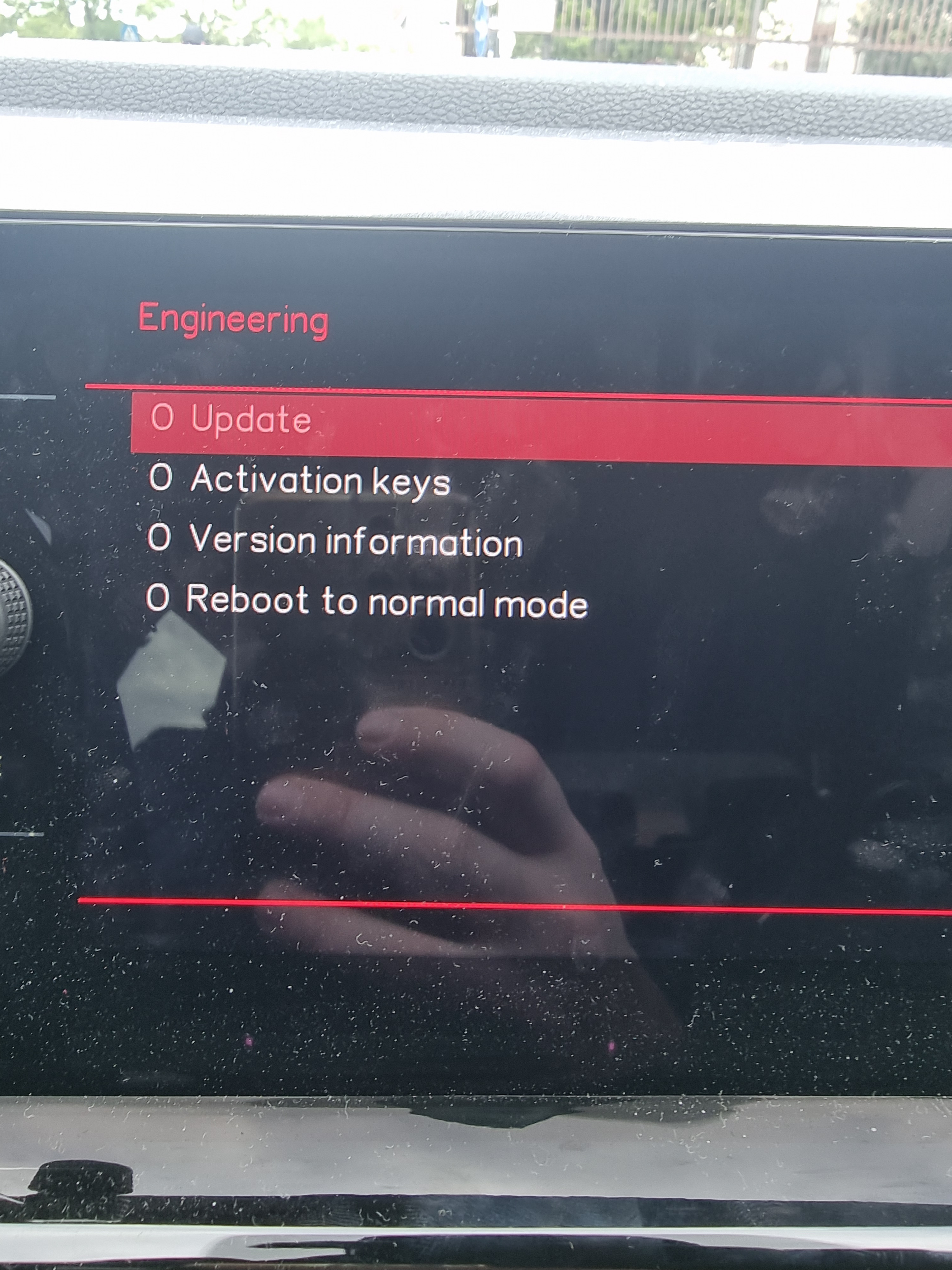

To exit the menu, reboot to normal mode

Polo 2610 wrote: Sat Apr 27, 2024 9:33 am Press the menu button for a few seconds until it appears
When I press the menu button it displays the clock (2 to 3 sec push)
10 sec push just restarts the unit
Can you point me in the right direction?

@Maaten,
On a facelift 2022> defo service mode is accessed by holding the MENU button for 3-4 sec of more
To get the clock displayed after 2-3 sec push and restart after 10 sec push are you not pressing the power on/off button instead?

Yeah, I mixed up the power and menu button :lol:
Found it now, no update present in the Polo and the T-Cross.
Maybe later on in the year
