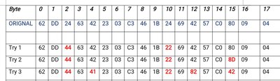

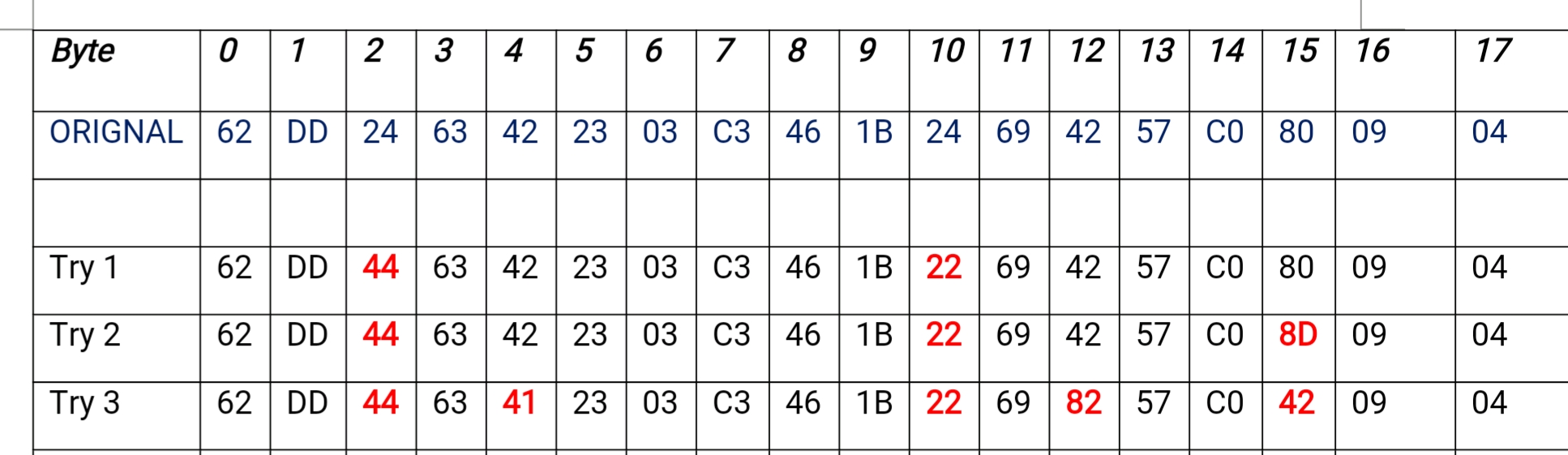

Posts: 6689
Re: Polo 6R ABS CODING
Please try these two codes:
62DD4463422303C046172271425AC0800904 #1
62DD4C63422303C046173271425AC0800904 #2
62DD2463422303C046172471425AC0800904 org

iichel wrote: Fri Jul 06, 2018 1:48 pm Please try these two codes:
Just tried both of them, with and without security access. It’s still giving me the “Request out of range error.” Any other coding or procedure possible?

Thank you so much! Same here, I'm not a fan of coding it wrong but getting the right code for the brakes I feel is important. But I'll give these a try and see. Also the logs I mentioned above are all RHD, so you can add to the list of engine codes for RHD to byte 15 as well.

firegrafik wrote: Thu Jul 05, 2018 5:55 pm Does your abs unit have ESP?
Anyway, on practice, front 288 and rear drum brakes configuration I have met only on Skoda Rapid. So VW ABS control unit firmware could not be prepared for such configuration, and that's why it doesn't accept such coding.
Mine ABS control unit with firmware 6R0 907 379 AS also doesn't accept such coding. So the only advice I have is to retrofit rear brakes to the disk type.
Hi firegrafik, i am trying to do the same coding on polo 1.2 tsi. It has same setup like phillip mathews. 288 mm disc at front and drum at rear. I have tried differant coding with differant engine options but nothing is getting accepted. I am ready to flash skoda rapids abs 9.0i firmware on my module if harware is supported. If anyone here can send me autoscan of rapid with 288mm front disc and rear drum then i can get required firmware and try to flash.
I am attaching codings which i tried
