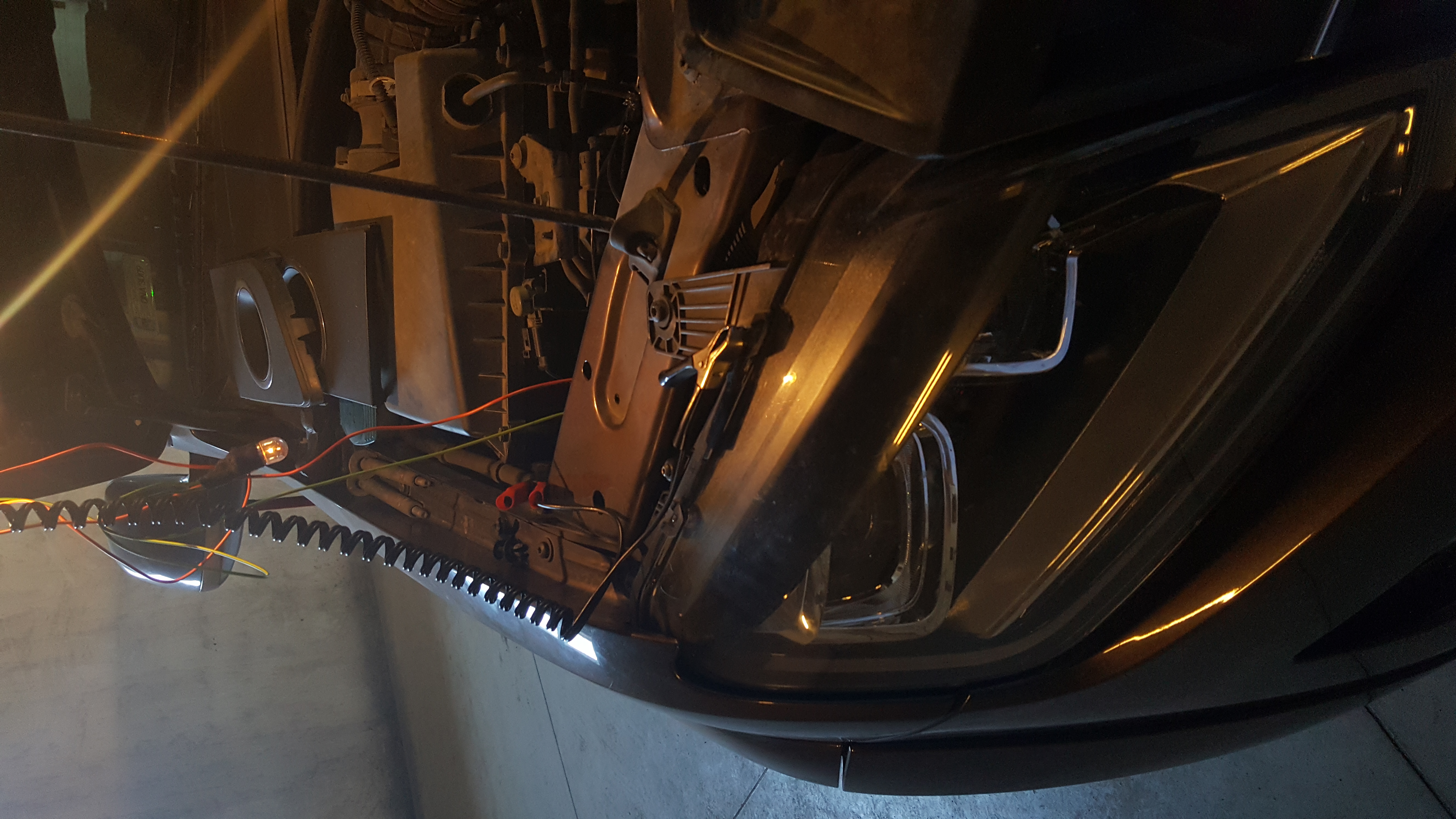

Remember that i have changed the Bcm. What Bcm do You have. The guy who helped me is an electrician at Vw dealer. But without Ciclo’s help it was impossible. My car had basis electrical wiring.
Re: Amarok Oem Bixenon retrofit
Hello! I have changed also the bcm to 7H0937090D .(also added the additional wires)
I have taken my car again at service with headlights, i do not find a service till now to make a scan or to try to resolve the problems.
The guy who is working on it is asking for an engine code from a factory fitted xenon headlights.
How can i found one?
Also if he can not make annything to my car i will ask him to give me the full auto scan.

I finally have the auto scan. The daylight drl is working but when i turn on the lights the drl stops working! What could be wrong?
If you can see i have a small bulb to check the electricity and it has lowerd in intensity when i turn on the xenon or parking mode it does like the drl should do to lower the intensity.
- Posts: 7851
- Location: Earth ♥, sPAIN, Magiclands (Mordor).
OMG!...
The first thing you have to do is install the new CAN lines for the instrument cluster.
Two wires from the instrument cluster to the BCM, in this way.
1st step here.
At the moment it is the main problem that is reflected in your Autoscan due to malfunction of almost all units.
1st step here.
