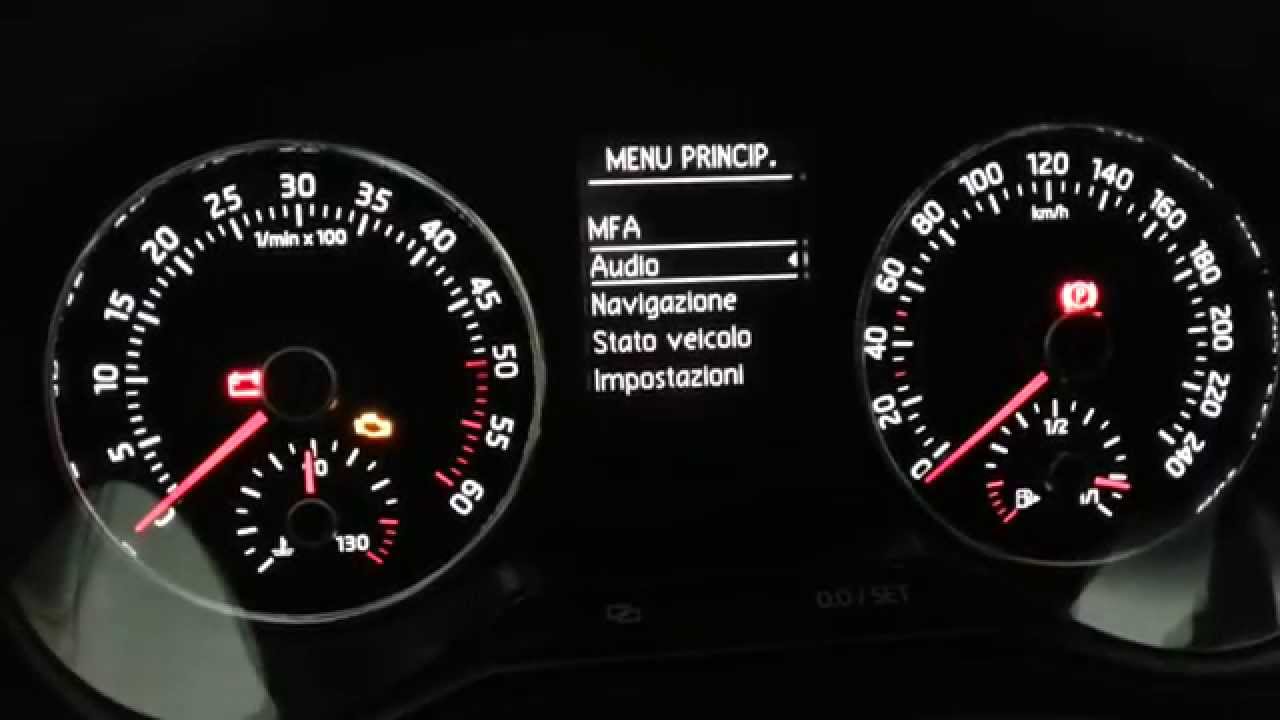

https://www.youtube.com/watch?v=WZSKZsT ... e=youtu.be
Did it :!: :D :mrgreen:
It would be nice if it was possible to have the navigation futures in it to, to show the road when navigation is on, compass and that stuff.. :cry: :roll:
happy holidays :lol:

Marjacic wrote:https://www.youtube*.com/watch?v=WZSKZsTZ ... e=youtu.be
Did it :!: :g :mrgreen:
Hello Marjacic what is the reference of your tacho? Did you used the amarok tacho or you found a reference for the polo?
If the amarok one how did you changed the circumference of the wheel, the volume of the deposit tank and how did you changed the pictogram for the image of the polo?
Thank you! :D
Thank you! :D
Hello gpeixoto109
i used the tacho from an Amarok part no. 2H0920871 without any letter at the end, if you buy ex: 2H0920871"A" then it is not possible to fit because of the software is to new.
But you have to find a guy in the German forum called potatodog, he have the tools to fix the tachos and do som Eeprom and change the pictogram :lol:

Yes Navigation features, with Rns 510 , like in the pics you see

Marjacic wrote:
Thank you! :D
Hello gpeixoto109
And how did it worked? You sent the tacho to him, he did everything and sent you again?
Posts: 8867
Re: ciclo's Polo. R-line 1.2 TSI 90hp 119gr.
iichel wrote:You can mail me whenever you want :oops: :P
:wink:
Marjacic wrote:Yes Navigation features, with Rns 510 , like in the pics you see
maybe i have to do some wiring from the rns to the tacho? :roll:
Do you have RNS510 installed?

yes i know but i haven´t got time for it yet .. will do soon! :)
and thanks again :)
my autoscan

gpeixoto109 wrote:
Marjacic wrote:
Thank you! :D
Hello gpeixoto109
check PM 8)
Posts: 8867
Marjacic
Rns510 New coding
00000402000000812000
Check MFD
Tell us the results...
Marjacic
Posts: 23
Joined: Mon Jan 05, 2015 10:25 pm
Drives: Polo 6R 1,6 TDI 105 hk Highline
Location: Denmark
Post by Marjacic »
ciclo wrote:Marjacic
Rns510 New coding
Check MFD
nothing happend :(
