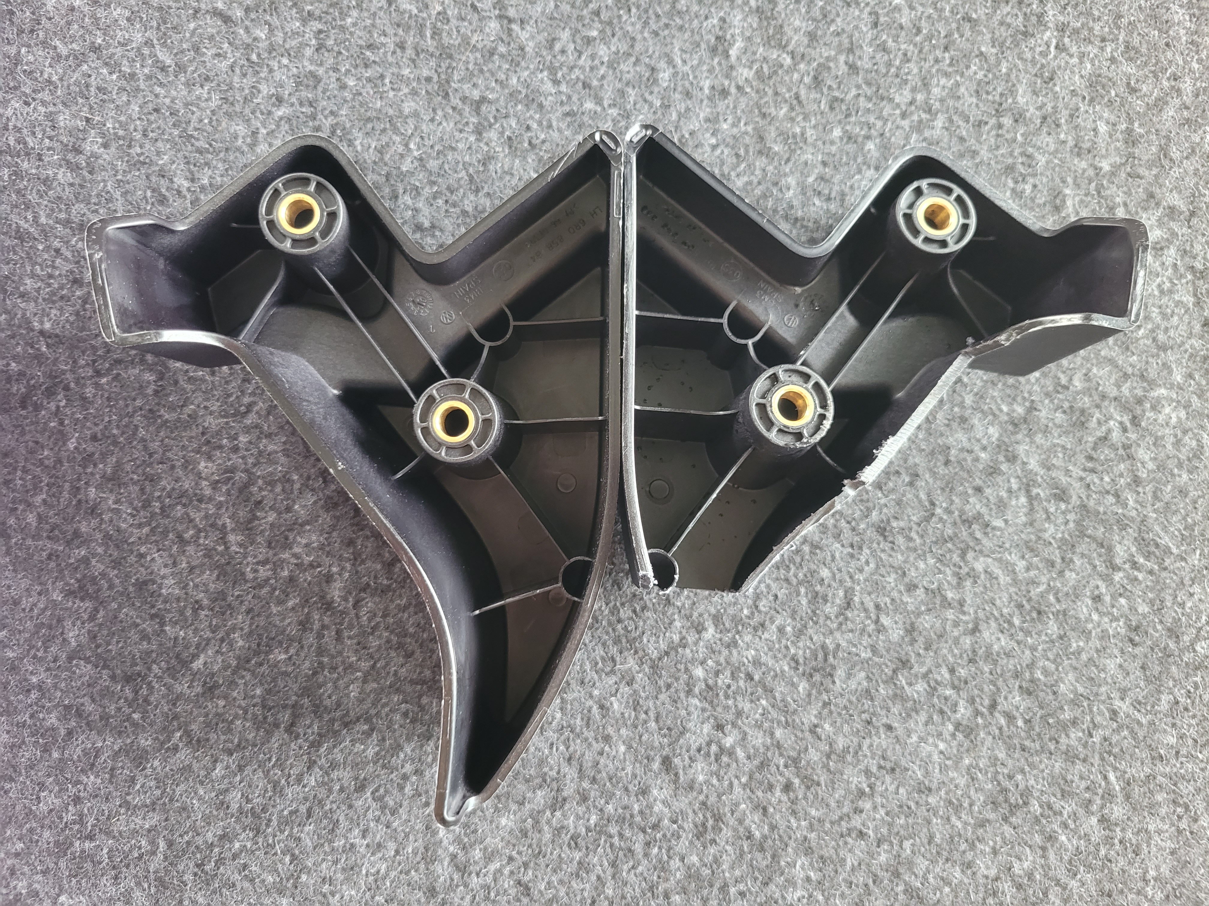

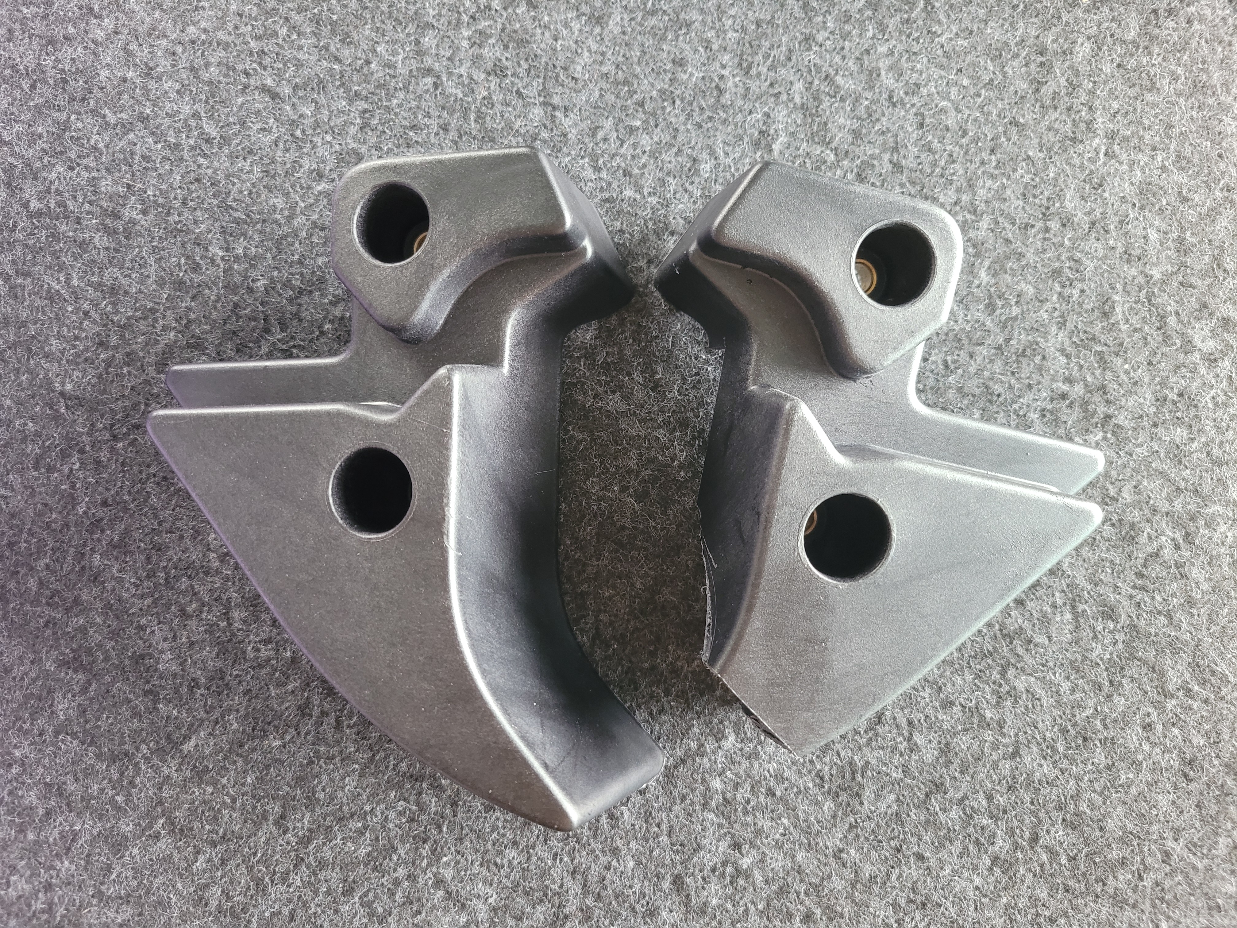

Noticing my car boot sides does not have grooves. Upper tray would have been difficult. So thought atleast we can get corner support fitted so tray remains fixed.
Theoretically missing pieces were corner plastic parts (6R0858847-6R0858848) and screws for same.
But ....

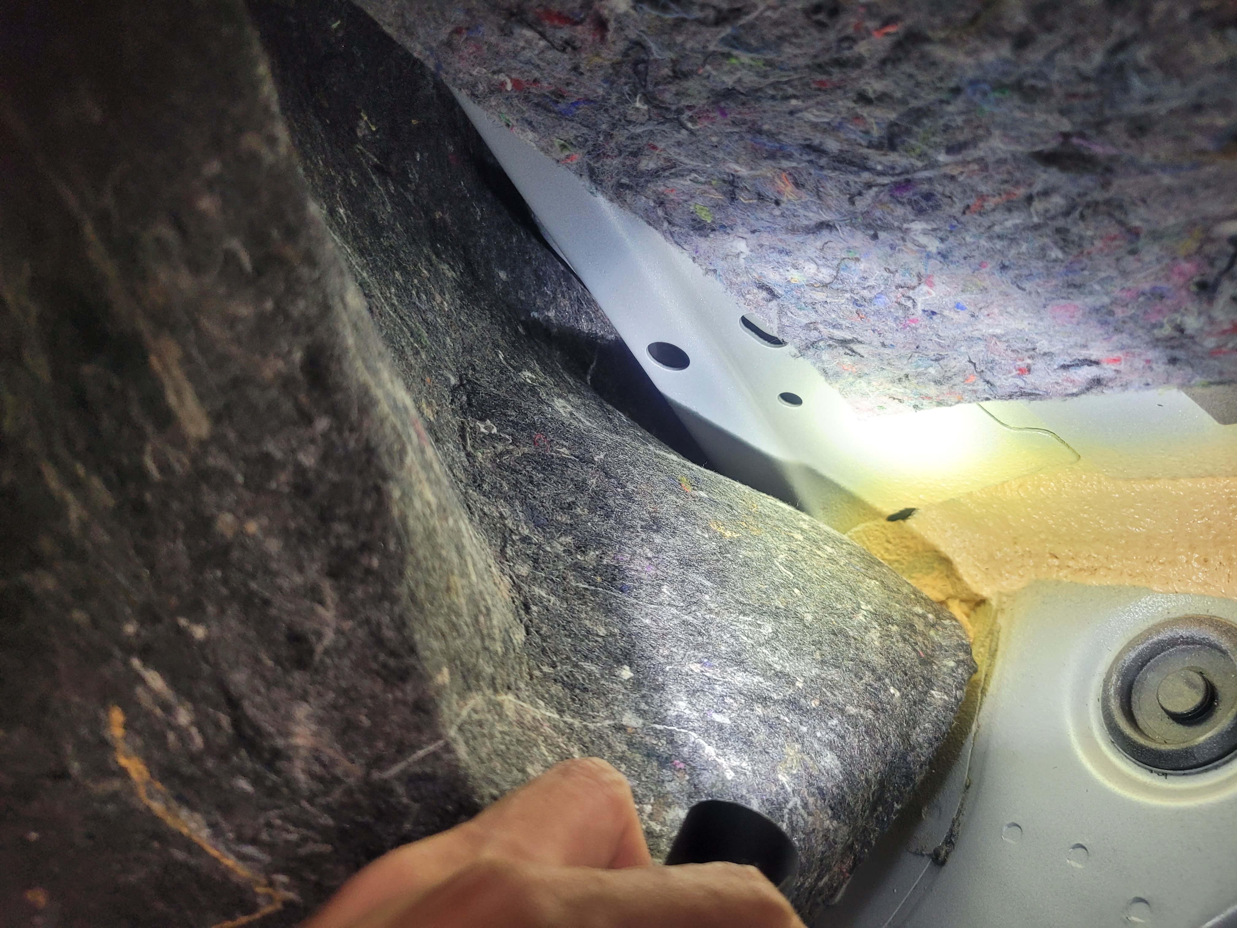

This is how my boot looks. (Rear bench is not 60/40 but entire one folds)
Check the corner behind rear passenger seats.
They are sort of cross member of chassis/frame.
When I tried to put them for support, they would not align. Try any position, angle it wont fit.
One thought was just cut of some part and then screw fit them. But there are no holes on the side metal panel.
Spaces to be filled in addition to corner behind back seat.

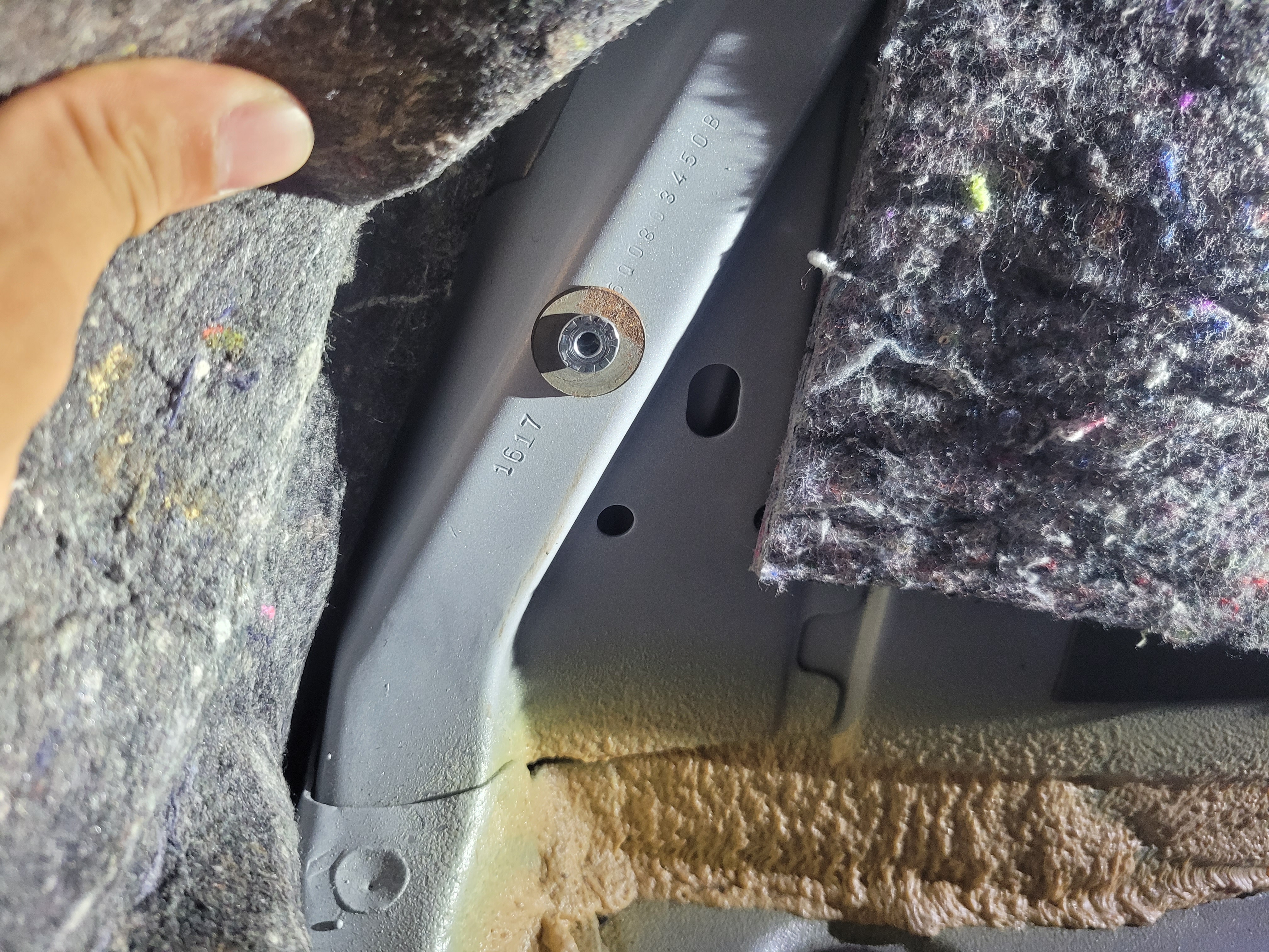

I have the same POLO and I also bought the same parts.
I found a hole on the car body, which might be used as a screw hole.
I am planning to cut a section off the plastic parts (6R0858847, 6R0858848) to make them fit properly.

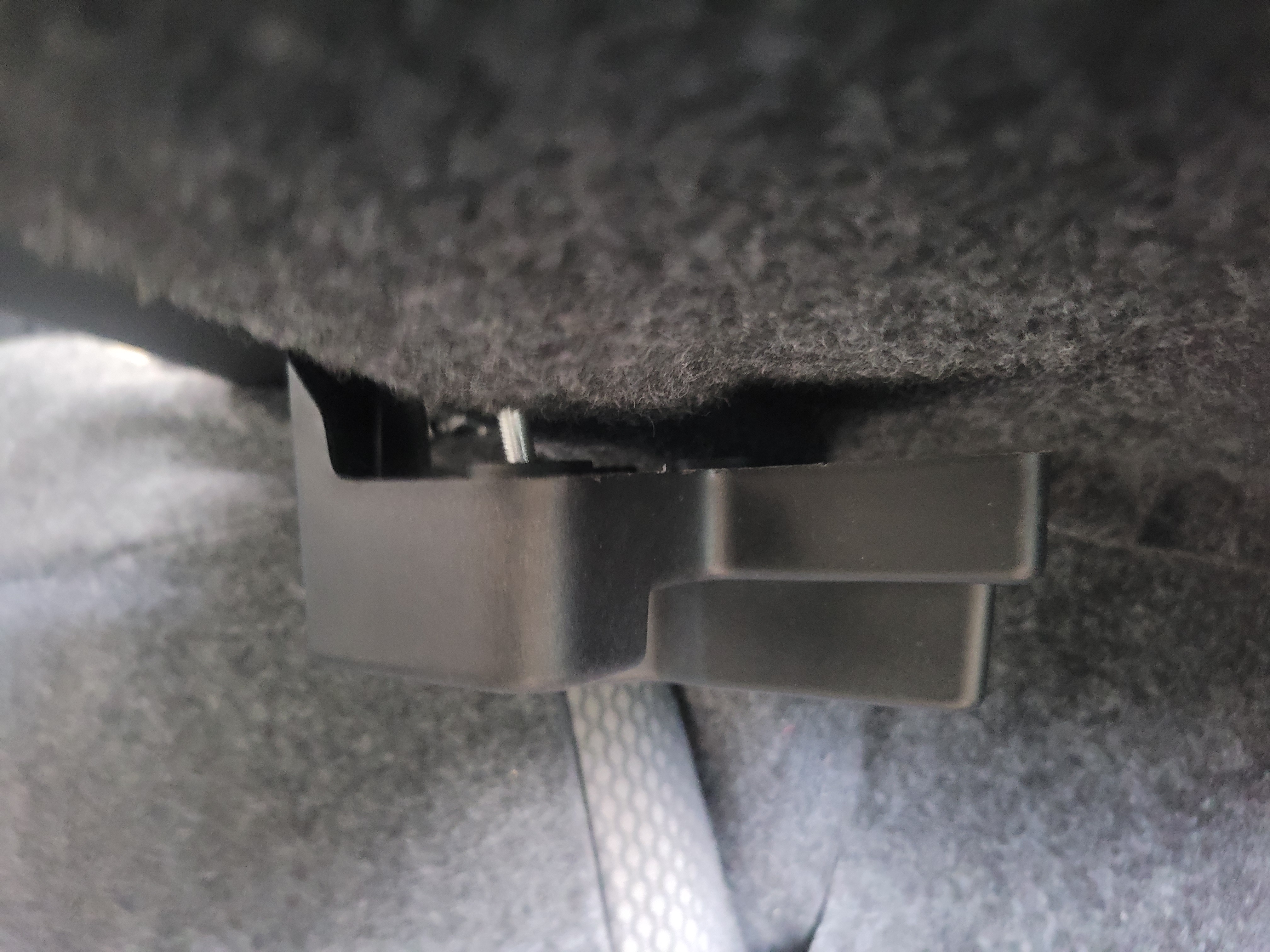

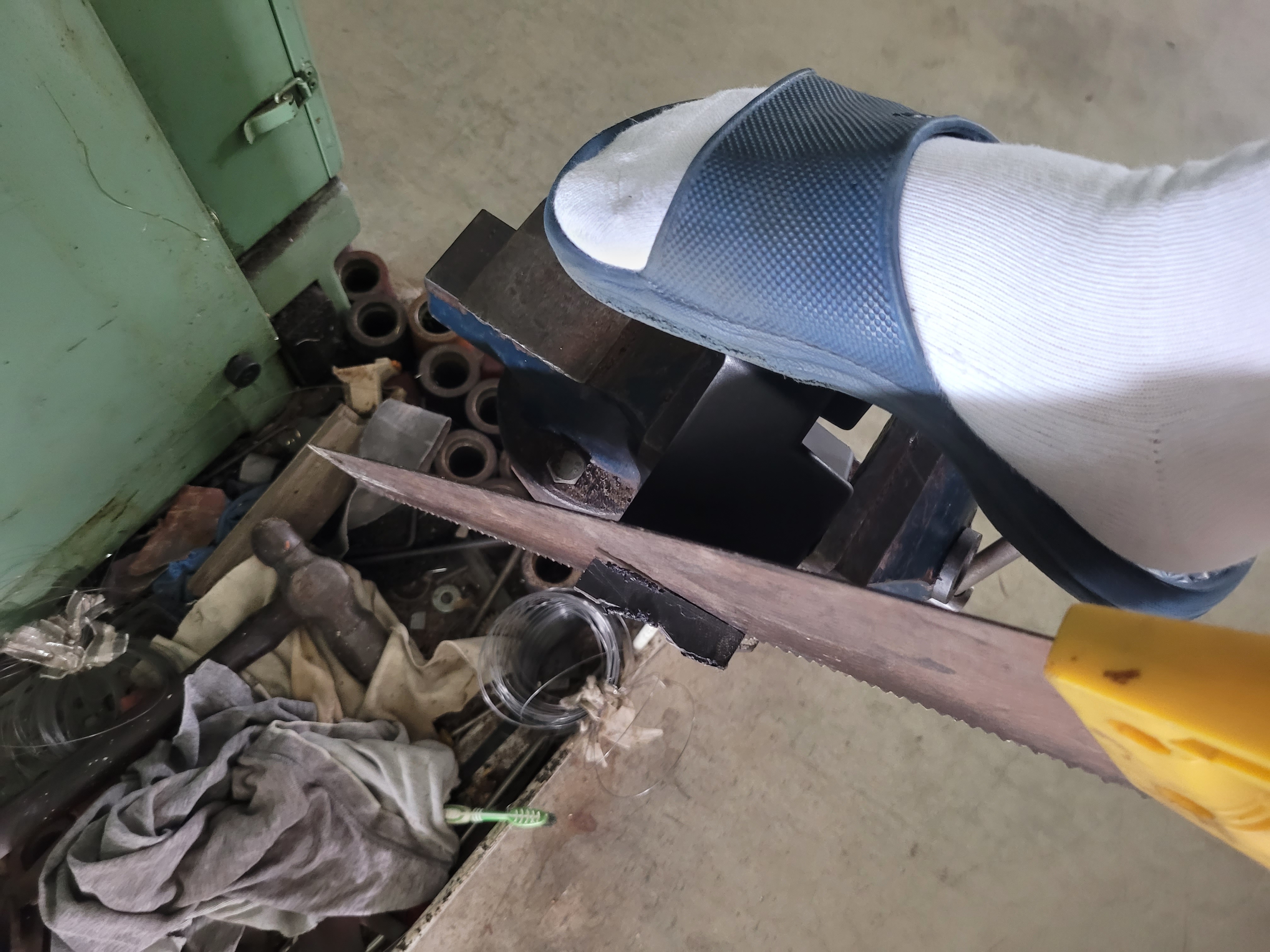

Cut and fasten with screws
Just like the native one
