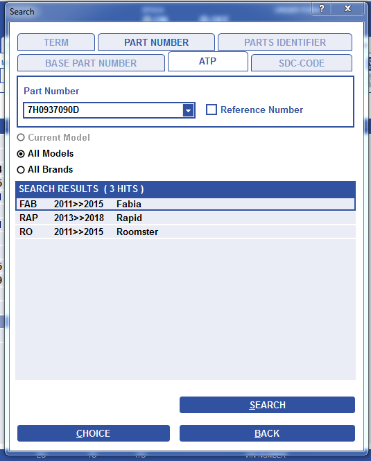

ciclo wrote: Fri Oct 11, 2019 10:04 am According to ETKA it would be possible... btw.... have you learned to use it?
According to Elsawin, I don't know because I only have the wiring diagrams for Fabia II until 2013. I don't have them until 2015, which is when the Fabia II production for Europe was finished and that is when the 7H0937090D model was being installed.
The wiring diagrams for Sk Fabia II 2015 are necessary to know how to install this BCM.
Good evening Fernando, as I know my Fabias production stopped since 2014 .
Fabia 2015 is Fabia mk3 , I don't think that is the same platform .
Am I wrong ?
But from a small research that I have done , this bcm works on Fabias from 2011 since 2015, so the question is , why 2011 model must have differences in wiring diagrams with 2015 mk2 Fabia ?
Posts: 8866
Re: Skoda Fabia VRS 2012. Auto lights retrofit OEM
VASILEIOS1972 wrote: Fri Oct 11, 2019 2:23 pm Good evening Fernando, as I know my Fabias production stopped since 2014 .
Fabia 2015 is Fabia mk3 and mk2 , I don't think that is the same platform .
Am I wrong ?
But from a small research that I have done , this bcm works on Fabias from 2011 since 2015, so the question is , why 2011 model must have differences in wiring diagrams with 2015 mk2 Fabia ? Evolution. HW, SW, parameterization according to peripheral units of the vehicle in which it is installed.
Currently, your Fabia VRS is ready for 7H0937090D, but minor setbacks may arise. You must experiment if we want to know what will happen with the J745 unit.
This is not an invitation to do it, it is my particular way of seeing the whole of this matter (due to lack of information).

Even ETKA already warns that a physical inspection of the old BCM is necessary before placing an order.
This has a great meaning of how complicated it is to define all this.
