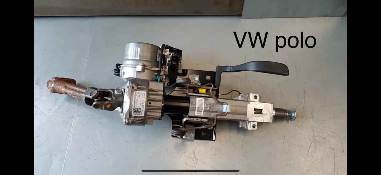

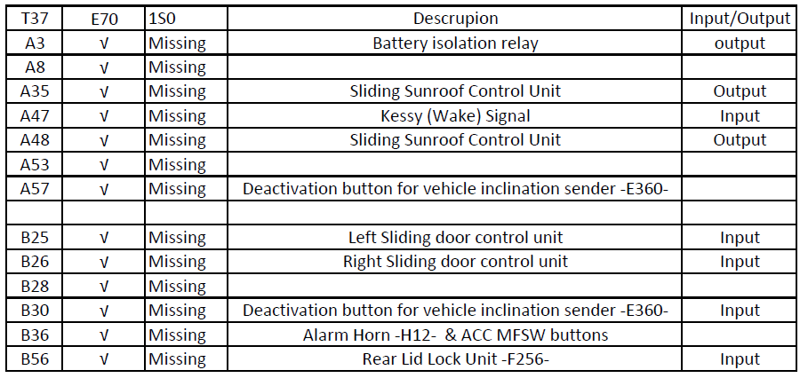

EPS is the same, A5 camera is the same. So the question is gateway or dashboard? Or both of them at all? We'll find out soon =)

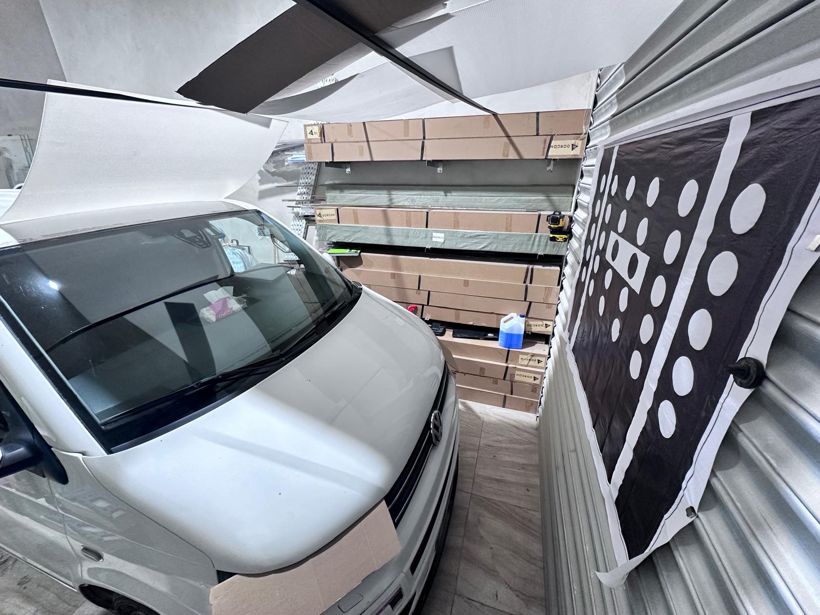

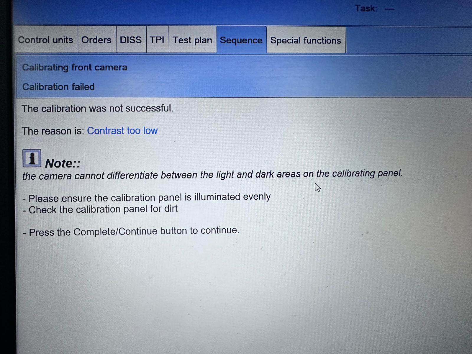

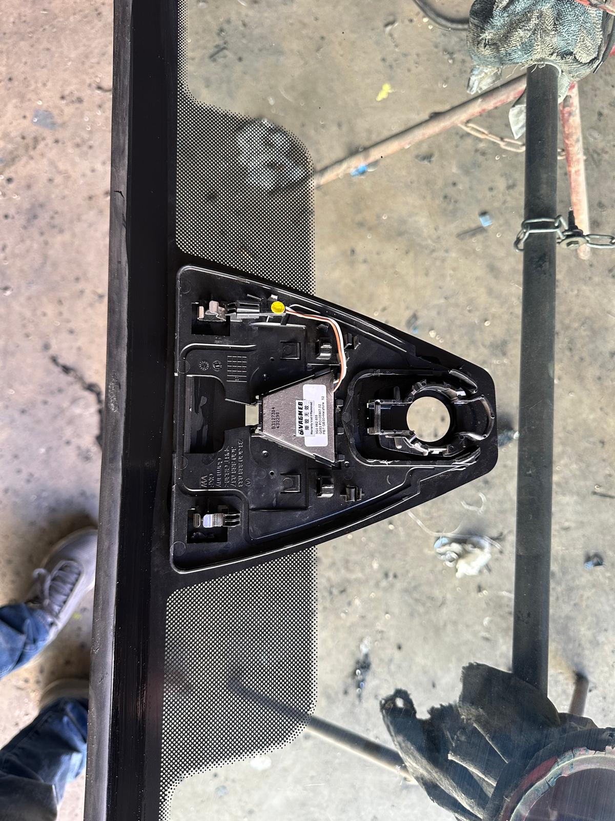

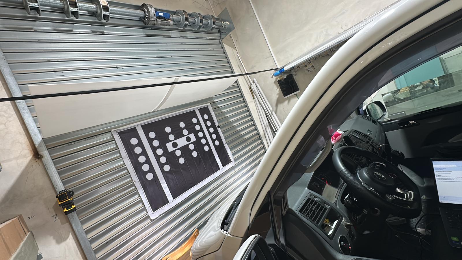

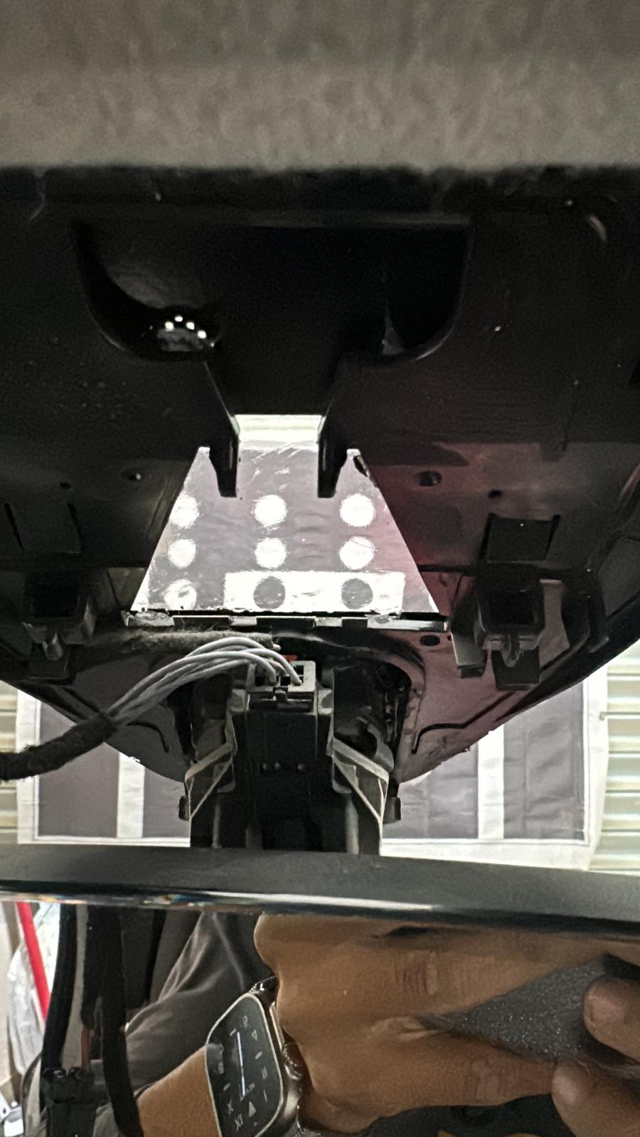

Hello all, yesterday I have a free time, so have started to try to calibrate A5, the light in my work shop was too bright so I had to dim it
After a couple of try's I got this faul :-

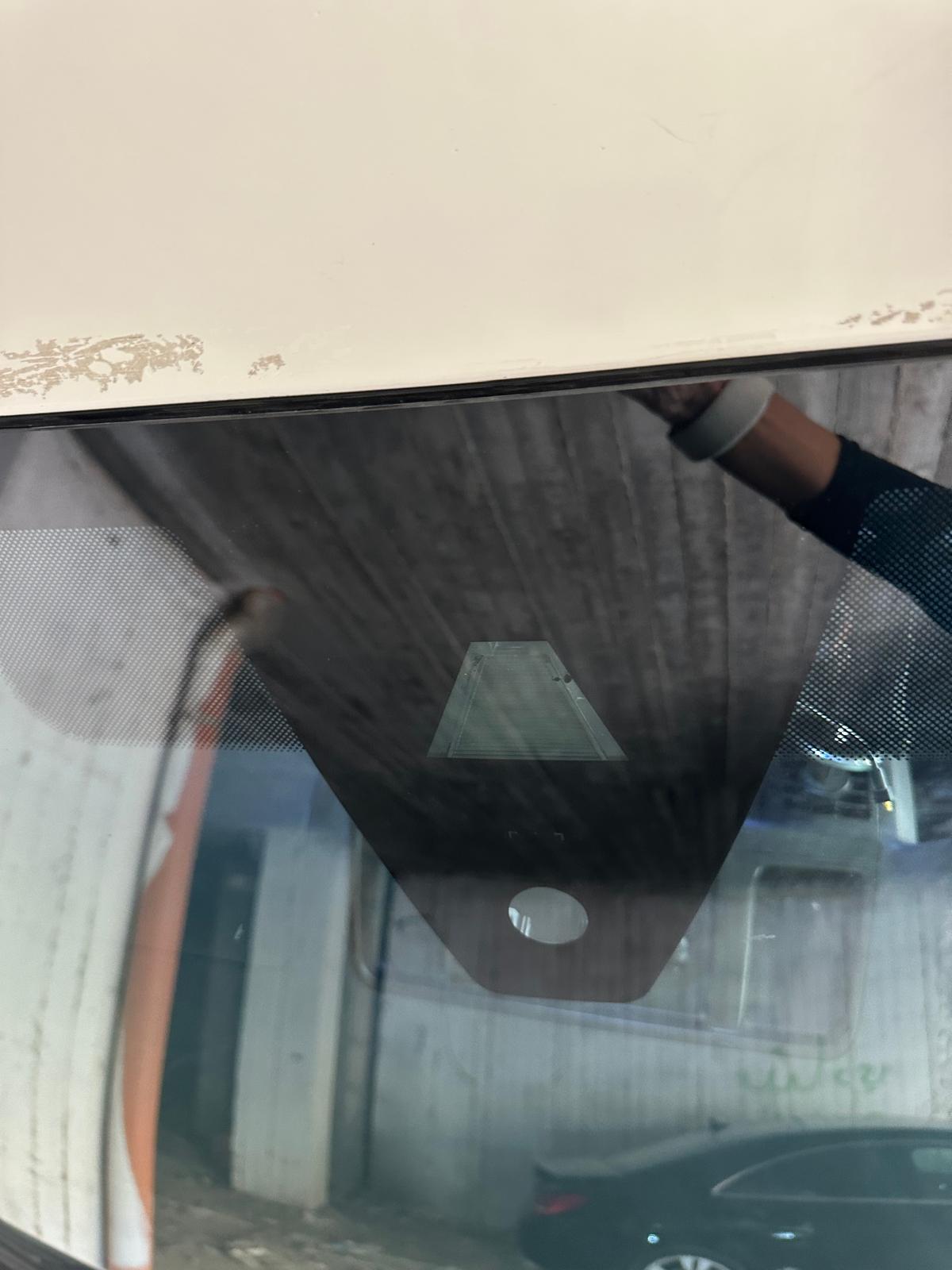

when I saw it I double checked the glass transparency in front of the camera

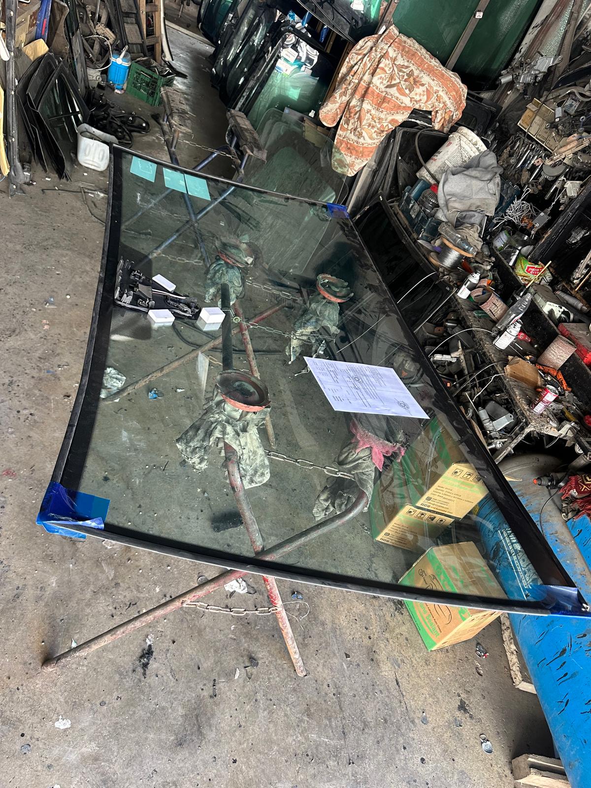

I could say its not 100% clear, Saw I have decided to change my front windshield to T6.1 with Camera bracket, then modify the bracket to fit 3Q0 Camera
This will take some time :|

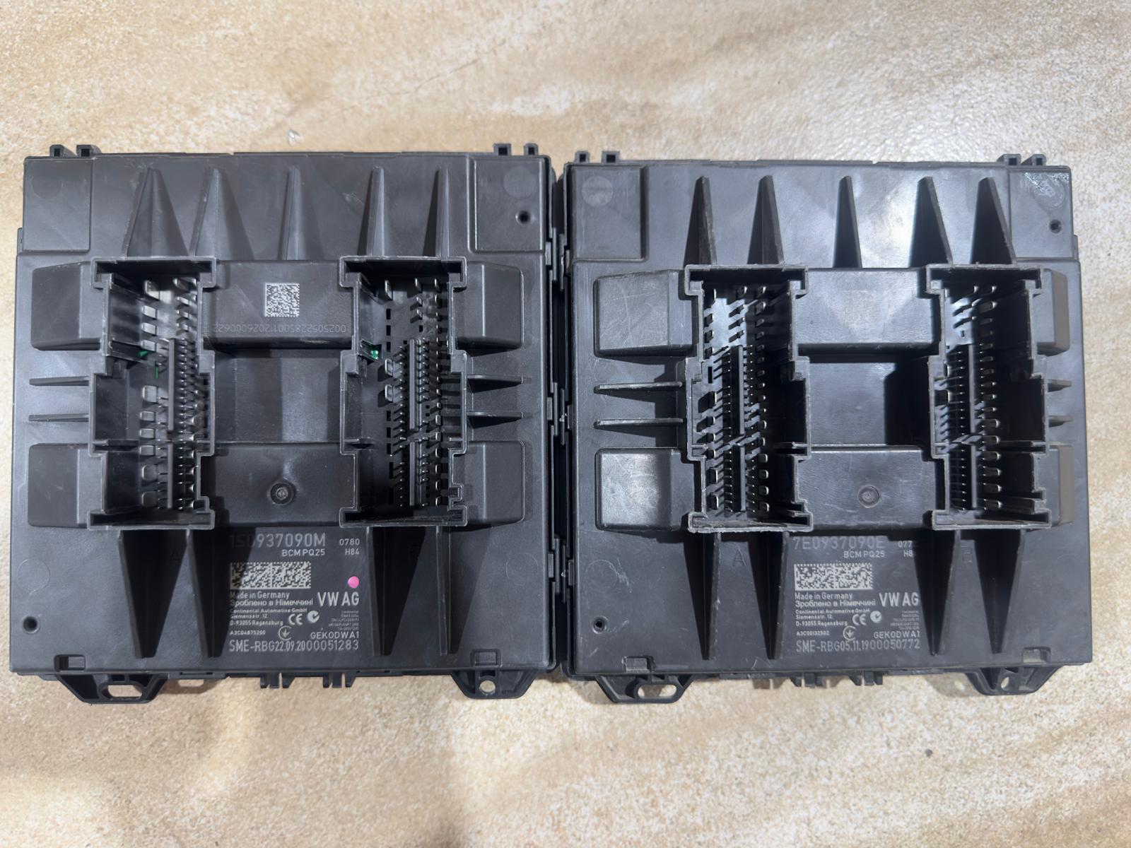

Regrading Adapting 1S0 BCM :-
this is a scan after coding and adapting key to the new BCM :-

this First two things that I had immediately noticed that the MFSW is not working at all, According to egor LC 29,06 needed to be checked in coding for mfsw to work
after some try's it seems impossible to activate it
the second thing kessy had a fualt with kessy wake-up line (short to ground)
the only thing that maybe a good sign was the fault the can getaway, it seems that this BCM had a totally different Eeprom
at this moment I decided to Compare the Pins On both 7E0..H84 and 1S0..H84
I was chocked :shock:
WhatsApp Image 2024-10-25 at 09.49.16_9e498843.jpg (242.37 KiB) Viewed 6236 times
Screenshot 2024-10-25 084251.png (62.04 KiB) Viewed 6237 times
A lot of missing pins..
I think this is a dead end for this BCM, 7E0 is way alot better to stick with

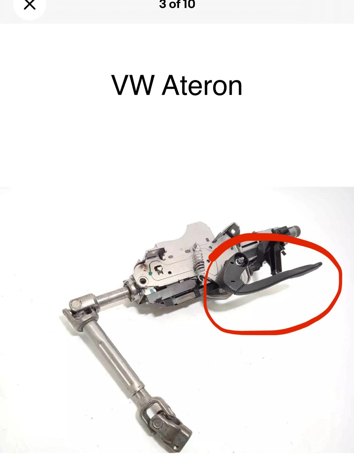

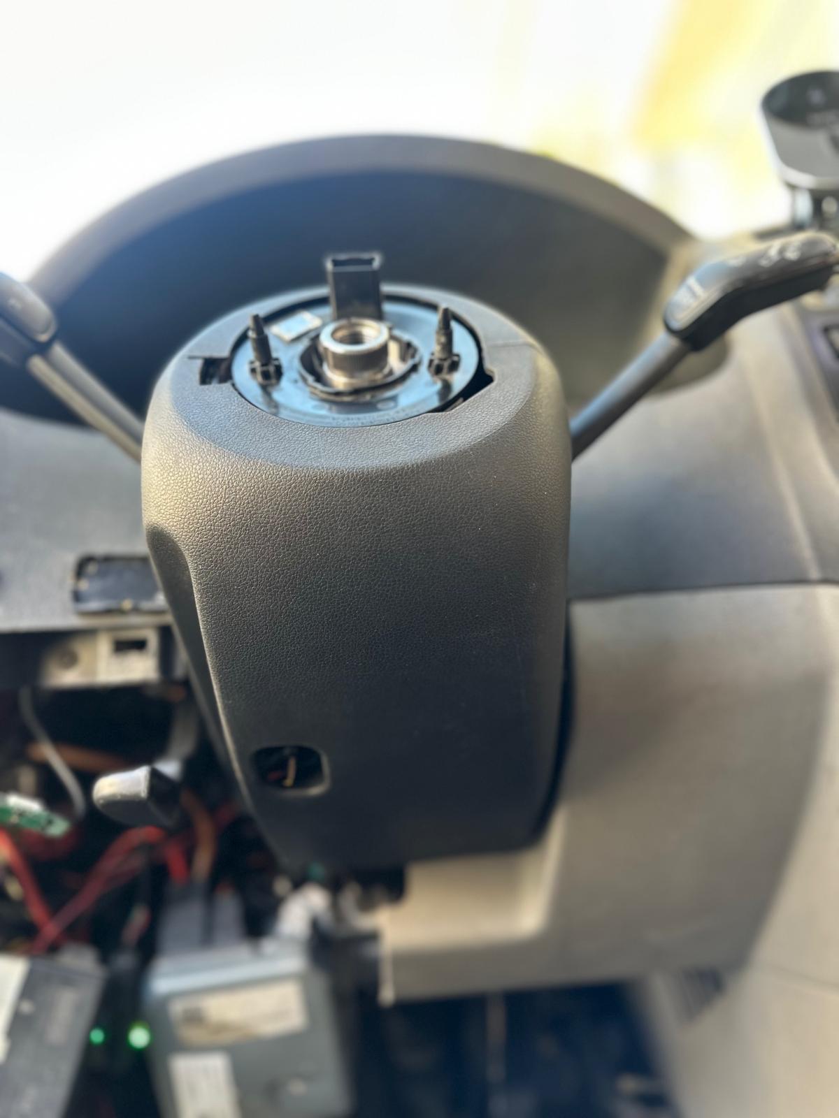

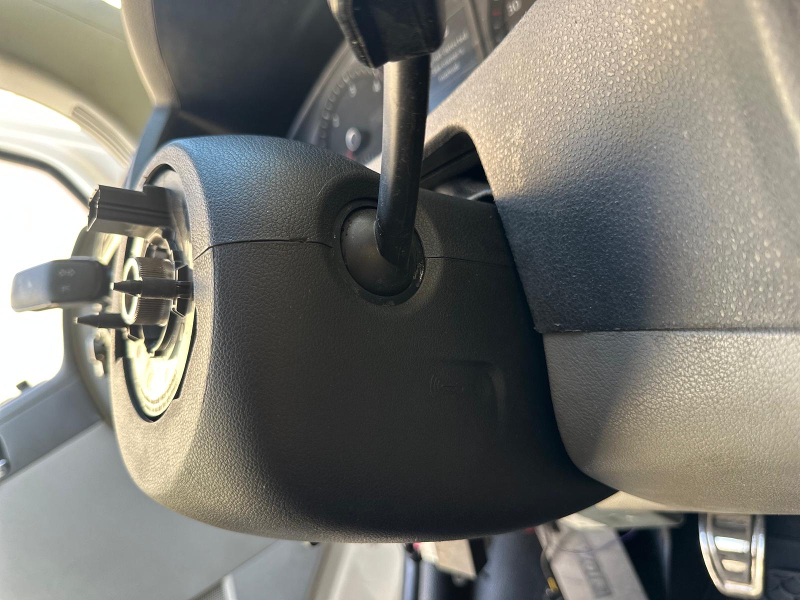

A new Trim for steering column :-
this trim is from VW Ateron PR: 3G0858559D
the reason why I choose this trim is because it had palce for the adjustment handle (similar to T5) as the handle in my current steeing column will disturb the dash lower cover
WhatsApp Image 2024-10-30 at 21.06.21_fe1ba9f4.jpg (67.91 KiB) Viewed 5516 times
WhatsApp Image 2024-10-30 at 21.06.21_ca398729.jpg (80.57 KiB) Viewed 5516 times
I hope is will fit perfectly or I will have to make my own handle

replacing the front windshield :-
WhatsApp Image 2024-11-17 at 09.19.20_ecadbd6e.jpg (410.84 KiB) Viewed 5226 times
WhatsApp Image 2024-11-17 at 09.19.20_fe6ebcef.jpg (309.55 KiB) Viewed 5226 times
WhatsApp Image 2024-11-17 at 09.19.20_19906f7f.jpg (111.98 KiB) Viewed 5226 times
after replacing the windshield I had modified the camera parameters in adaptions, the basic settings fault had disappeared
the Suprise was that the lana assist started to work on the dashboard CAnbus, but sadly there is no notification on the dashboard about lane assist at all
https://youtube.com/shorts/gFeS2VHeYW8? ... aRnIIXqqBl
still need more digging to try to display it on the dashboard :D
