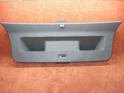

Quoting myself...iichel wrote:Mod that I'm planning to do, it might suit you too. Since you like lights a lot too![]()
6Q0947291A 82V
6R6867601A
893 971 633
You already have the permanent plus (RVC), ground (RVC or somewhere else) and ground-if-hatch-is-open (T5/1)
Edit:
maybe a set of 8KD 947 411 next to the lock as well![]()
http://www.aliexpress.com/item/4Pcs-OEM ... cb25caf3de
It works!! Pictures later
