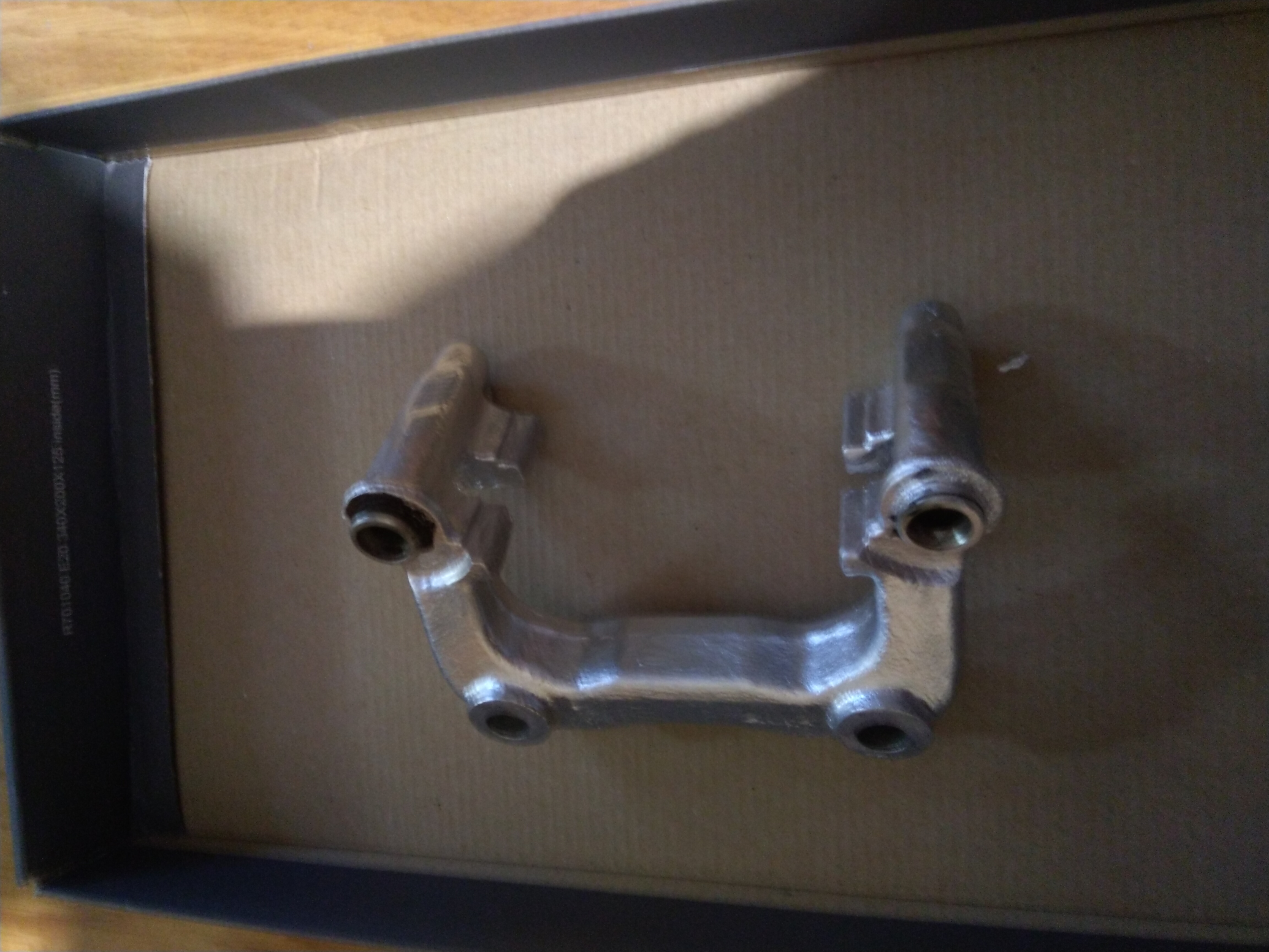

Sourcing and assembling the parts:
Rear axle and its components: I bought the used rear axle undamaged in excellent condition from scrap market here for a cheap price, and got it refurbished from a mechanic friend. The new axle as I mentioned above is very expensive around 1000€ just for bare axle!!
I decided to by new hubs with bearings and used stub axles from axle I bought, as they were in good condition. The OEM hubs are very expensive, so decided to buy aftermarket from OE manufacturer FAG. 2 sets including shipping from eBay Germany costed me less than 1 set OEM. VW asks too much just for 2 alphabet engraving.
Brake parts: With the help of iichel, I could able to source callipers with carriers, callipers repair kit, brake cables, hoses, springs and handbrake. Remaining parts I ordered from eBay and from my dealer.
My country Post has been savage lately, damaging the parts and have lost few.😐 I noticed a missing glide pin from one of the calliper carrier!
Unfortunately the caliper glide pins are not seperate part, they are part of calliper carrier and don't have seperate part number! But luckily the OE manufacturer TRW sells glide pin repair kit as aftermarket. I bought such a kit from eBay.
Now if we notice the glide pins carefully in above picture🧐, 1 pair is different from the other by design!
Now the question arose, which pin goes where into the carrier? According to the manufacturer, if the callipers are installed rear facing.. the glide pin with 3 horizontal circles goes on top and vertically sliced pin goes at the bottom& vice-versa if the callipers are installed front facing. For 6R, the callipers are installed rear facing so I followed the former. See below(credits to author from drive2).

patil wrote: Tue Nov 08, 2022 9:50 pm
Thank you for this, I was having issues with my rear brakes since i got the car. And All was put new by mechanic ( calipers, pads, discs) and the pads weren't touching the disc.
Decided to disassemble the carrier, clean and paint.
Put new pads, and guess what the pins were rotated not in correct position. Fingers crossed now it will work!
