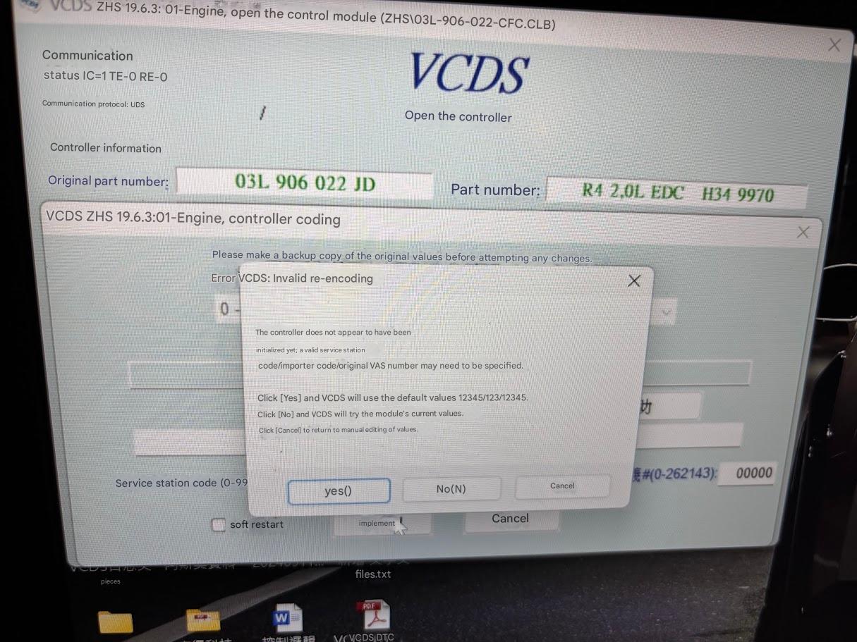

This is the steering wheel I installed. Currently all buttons and DSG paddles are invalid.

Have you tried to code the buttons on that steering wheel? It's a subsystem of the BCM. What coding did you use?
You must post an autoscan. Host it on a server or in the free space offered by your email account and post the link here.
Direct posting of an autoscan on the forum requires having at least 10 posts on the forum.
It's not the same steering wheel as Shadow109, his is from a POLO 6C* --> T6 and yours seems to be from a Golf 7 or similar.
The CCS via the rocker buttons on the left stalk must be activated in the BCM and ECU, you should not have coding problems if you did the wiring installation correctly.
ECU coding must be, ing ON eng OFF.
Address 01: Engine (J623-CFCA) Labels:. 03L-906-022-CFC.clb
Part No SW: 03L 906 022 JD
(not knowing how to use a diagnostic tool has been and often is the real problem)🤷‍♂️
WSC? = YES

I have removed CP fault in 5f and other several faults but I am stuck with one last fault
