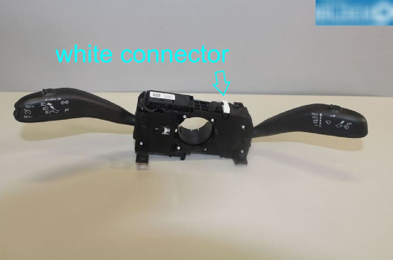

Thanks Ciclo! i don't find the way to reply your private message. I'm trying to find the right stalk i need, but only can buy in my country due to customs policies. I found some Stalks from Amarok, it's really complex to me understand VW codes, there are so many !!. The right one that i need is without rear wiper and without trip. I was watching 6R5953507B or (6R5953521F whit ring from factory), the other one is 7E0953507F or (7E0953503DB whit ring from factory) seems it's the new version, and yes, i need to change the ring. The concern i have is the little white connector that amaroks's stalk has in the upper part, my original stalk doesn't have it. On the other hand, i will have to manufacture my own loom (cables). Too much job to do, but in the end it will pay.

the white connector on top is nothing else than a coupling point for the wires to the TRIP computer and the intermittent wiper switch on top.

@BARBUDO, everything you have said about references and combinations with rings is correct.
The different stalks - 5U0 vs 6R5 vs 7E0 - have specific rings and they are not interchangeable, ...you can install the combination you like the most.
As for the white connector nothing to worry (as iichel said), it's due the constructive characteristics of the model 7E0 (new model) with respect to 6R5 ("old model" - for understand us-).
